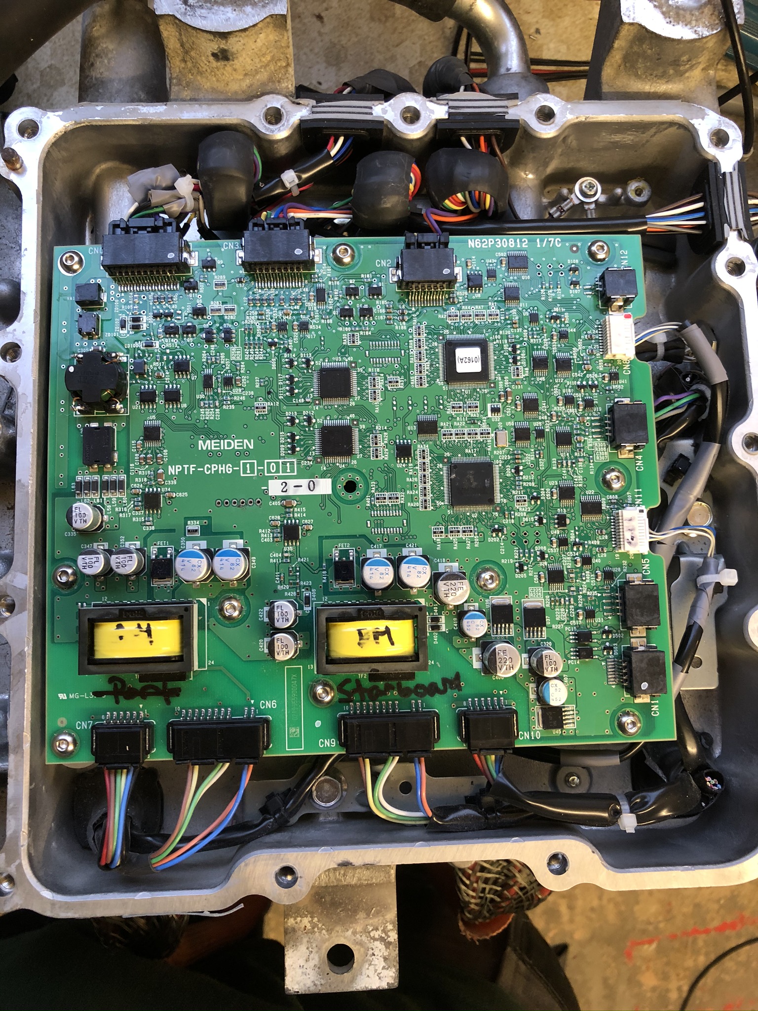

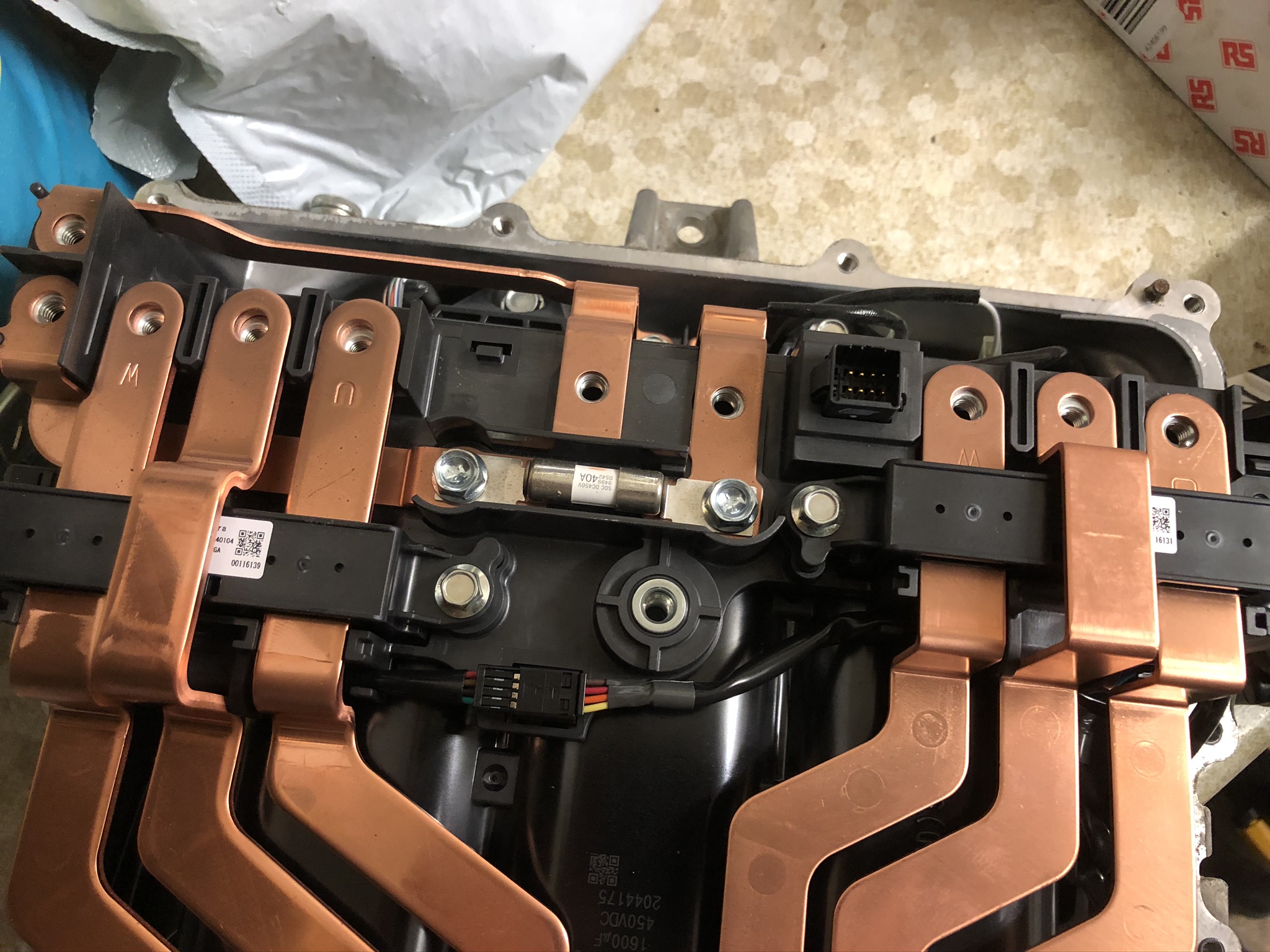

In case anyone else is looking to do the same as I am doing here is what I have found out stripping down the front inverter to replace the logic board:

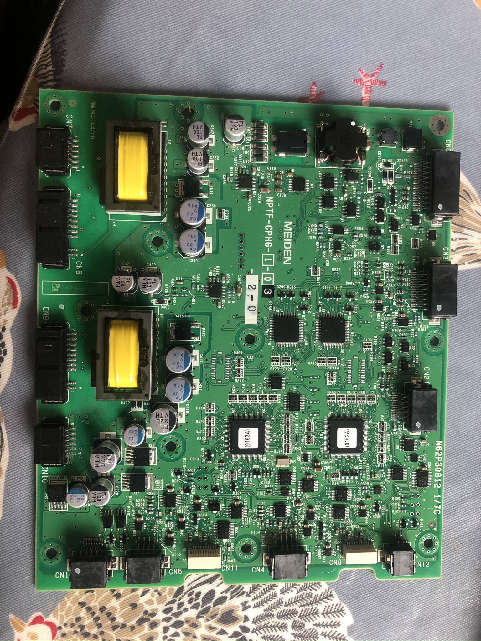

Here is the logic board, easy to see how the board is split into distinct sections for the motor and generator.

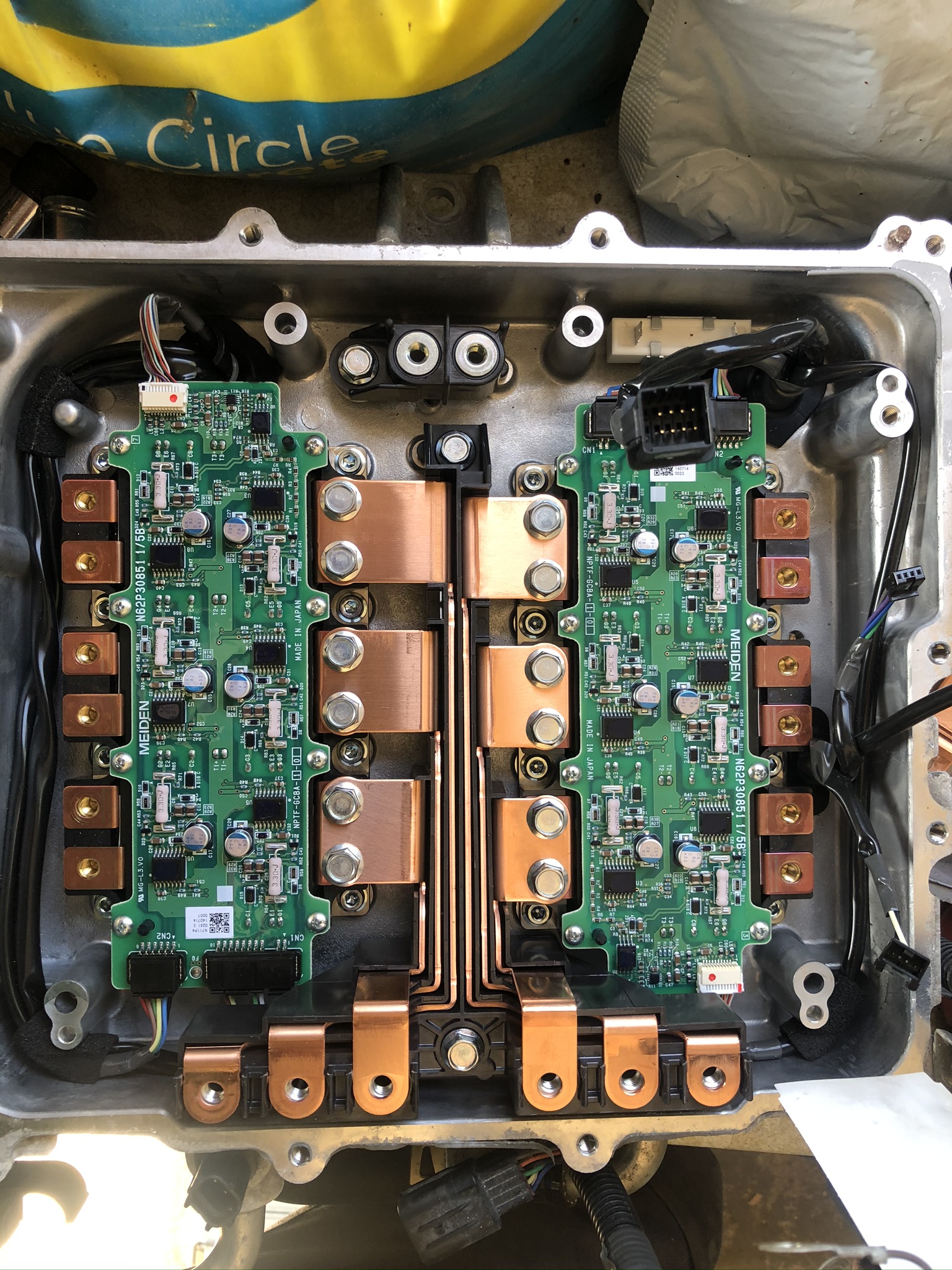

Here are the IGBT driver boards, as far as I can tell these boards are identical to each other and also to the board in the rear inverter. It is worth noting that they are reliant on power from the SMPS transformers mounted to the logic board to power the IGBT side of the A34JT opto couplers. Each board has three heatsink thermistors and a C87AT opto voltage sense.

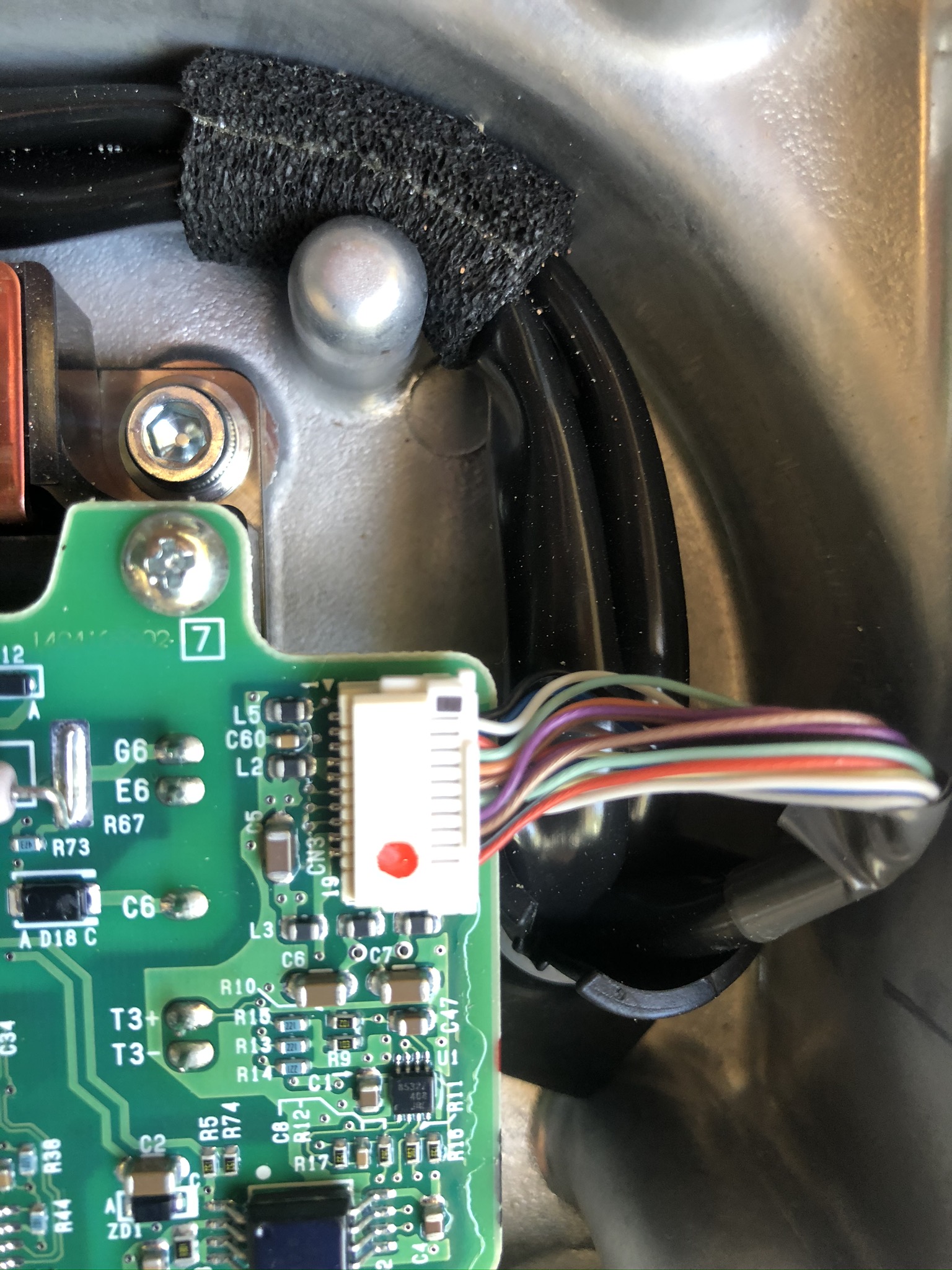

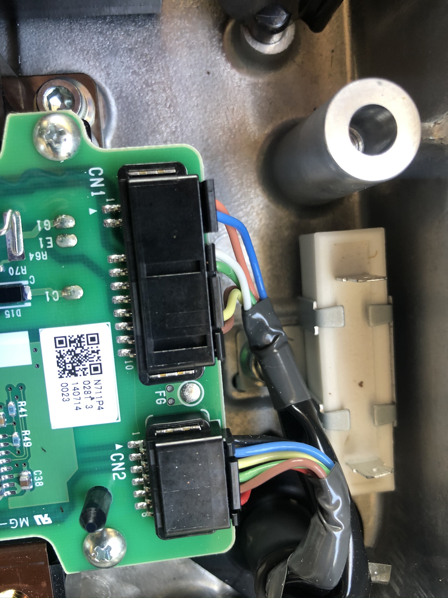

This pair of conectors provides the 22v floating power from the transformers for firing the IGBT gates, 12 wires: a pair for each IGBT.
This is the 20 pin connector for the optically isolated side containing the PWMs, temp sense, voltage sense, UVLO, FAULT (desat), 5v+, 15v+ and ground.
Here you can just about see the Nipon/Nicera current sensors, 2 phases monitored per motor. From what I can tell so far they are four wire: 5v+, 0v, sensor 1, sensor 2 with 2.5v on the output lines denoting 0 amps.
I have done a spreadsheet with all the pinouts for the logic boards and driver boards and how they might map to a V3 main board but I will post that in the morning...

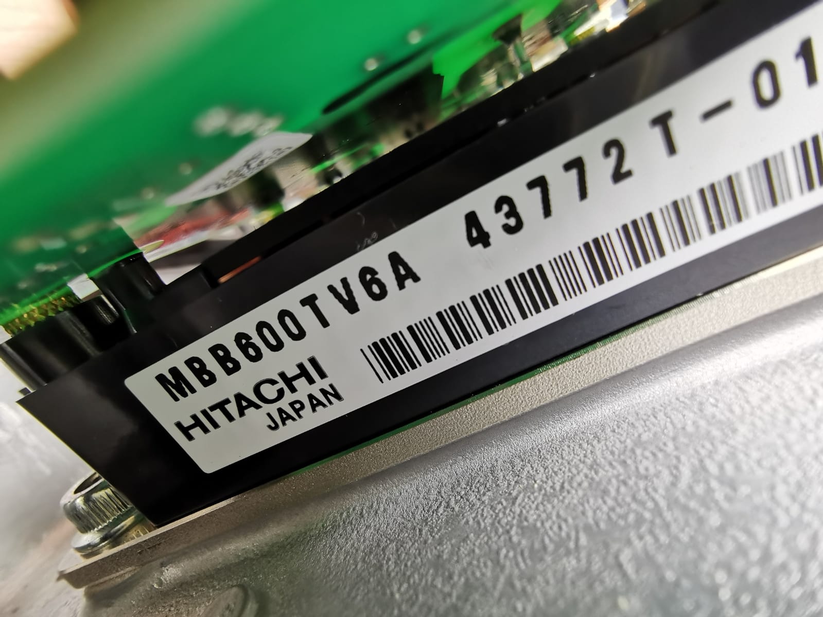

Can you get the P/N for IGBT module? That can show us what front drive is capable of. I will see the same for the rear drive...

Hitachi MBB600TV6A 43772 T-017

650v 600a

Very similar to Volt inverter power stage. I bet the real limit to Outlander is not motor but batteries.

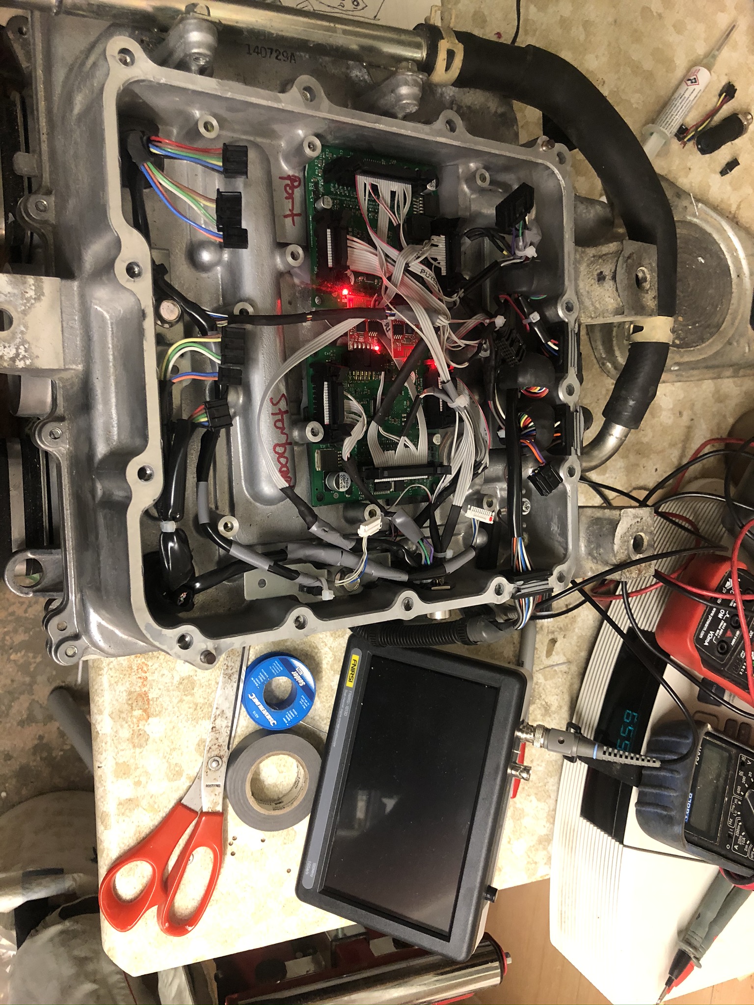

My current plan is to leave the original board in place, pick off the signals I want from the connectors and plumb them into the Hubner boards mounted over the top with a spacer plate to move the bottom cover far enough away to stop contact with the boards. The Meiden board continues to provide power no mattter what you do to it so even missing most of its inputs it will just become a power stage. I did investigate making up my own power stage with a whole set of isolated dc-dc converters making enough space in the casing for mounting the new brains but that would mean using 14 individual DC-DCs!!! Or unsoldering the original SMPS transformers and placing them on a new board putting in some new SMPS driver chips but that all takes time and I want to get my boat moving so I will try the simple route first.
I agree that CAN bus would be far easier but the software wont allow reverse direction of the generator motor (as far as I am aware) and for the boat I want full independant control of both props.

The V3 boards are in and working as much as they can be without being connected to a motor. The next few days will hopefully see them spinning a propellor. Damien sent me two of the model 3 modboards which I thought would be perfect but in the end getting the resolver exciter to work with the resolver to digital chip was proving tricky and leading towards needing another external signal converter board so I ended up modifying the inverter case to allow the Hubner boards to fit.
Original logic board fitted back on top on spacers. Only mild clearancing of the cover plate to clear the transformers.... :?
Now, things I have found out about the Meiden logic board:
It uses a resolver to digital converter, Tamagawa AU6802N1, this drives a resolver excitor ciruict using 4 transistors driven by a set of op-amps.
The sine-cosine is then fed back into the chip, converted into a digital position and sent to the main MCU via seriel. The main MCU is a Renesas R5F7147FPV.
In a previous post I mentioned that there is a connector on the board, CN1, which I couldnt find a function for. I have now found that it it a RS232 programming conector for both of the Renesas chips.
1. Boot mode, feed 5v to pull MD1 (pin 76) to ground - Drive motor MCU
2. RS232 Tx - Drive motor MCU TXD1 (pin 65)
3. GND
4. RS232 Rx - Generator motor MCU RXD1 (pin 66)
5. Boot mode, feed 5v to pull MD1 (pin 76) to ground - Generator motor MCU
6. GND
7. RS232 Rx - Drive motor MCU RXD1 (pin 66)
8. RS232 Tx - Generator motor MCU TXD1 (pin 65)
The loom from this plug on the logic board leads up to a connector accesible from the cover plate over the phase cables so gives access to full programing of the original logic board without disasembling the whole inverter. There is a flash programing tool on Renesas' website that seems like it could be used for this. When I have more time I will have a play with this.
