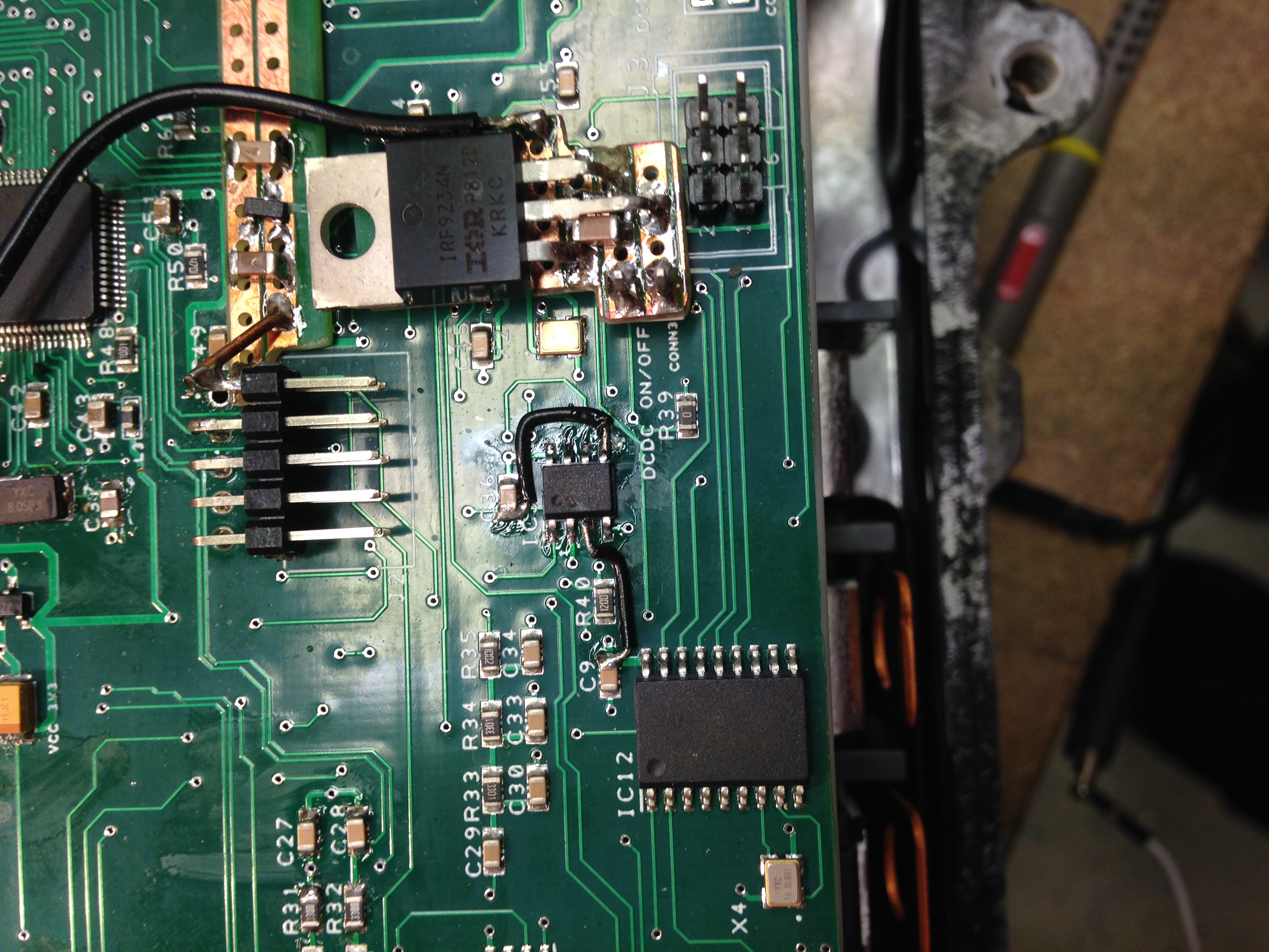

Started by measuring 3,3V current draw (voltage drope over a 1ohm resistor) of the board excluding the WiFi-module.
Just below 120mA. So with the load of the WiFi-module the 3,3V regulator has to work hard.
So I patched in an separate 3,3V regulator to power the WiFi-module, and now the spikes are gone from the angle plot.
I also discovered another source of disturbance, the CAN tranceiver. When running the board alone the tranceiver sends out messages every 550us as it never receives reply. So when probeing C43, or VDDA, the result is 30mV pk-pk ripple. In normal case this will only be seen every 100ms (or 10ms) when messages are sent out.
This will also have a negative effect on all ADC measurements so I plan to swap out the present 3,3V CAN-tranceiver for a MCP2562-E/SN. This MCP tranceiver can be powered from 5V for all power requiring stuff and then has a separate I/O-supply that allows 3,3V to be used for the low current I/O (Rx, Tx pin). Will report back when this is tested but will take some time as I have to wait for component delivery.
I think it is a good idea, for all boards, to use a separate supply for the WiFi-module. It will be much harder to try to filter out this type of disturbance then to simply use on extra LDO and two ceramic capacitors(1uF input and 10uF output).

Finally I have replaced the CAN-tranciver to a MCP2562-E/SN with 5V supply and I/O running at 3,3V
VDDA with old CAN tranciver.
VDDA with MCP2562.
Now I can't find any periodic disturbances on VDDA so I call this done.

Post by bexander »
Adding a picture of the CAN-transceiver mod of my board.

Re: Large jitter on angle in resolver and sincos mode
Wow, thats actually rather surprising! So you go from 30mV or 1% jitter (assuming 3V resolver amplitude) to maybe 10mV or 0.3%. I mean either will work but it still looks better :)
bexander
Posts: 897
Location: Gothenburg, Sweden
Has thanked: 78 times
Been thanked: 102 times
Post by bexander »
In normal case the VDDA would make a dip and rise every 100ms when a CAN message is sent. When I run the board on the bench there is no reply on CAN and the transceiver repatedly sends messages causing the continious triangle wave.
This voltage dip on VDDA causes spikes in ADC measurements.
Now the dips caused by WiFi-moule and CAN transceiver are removed. I have not checked in car yet as I'm doing a bettery change as well as motor/inverter change so it takes some time before I can test resolver and current feedback for hopefully no spikes.
For future logic board designs it might be a good idea to consider using a 3,0V shunt voltage precision reference supplied from the 3,3V bus, to supply the VDDA. This will require HW adjustments on resolver signals (to keep the below 3,0V) and maybe current and voltage feedback as well but should give a solid supply to VDDA.
