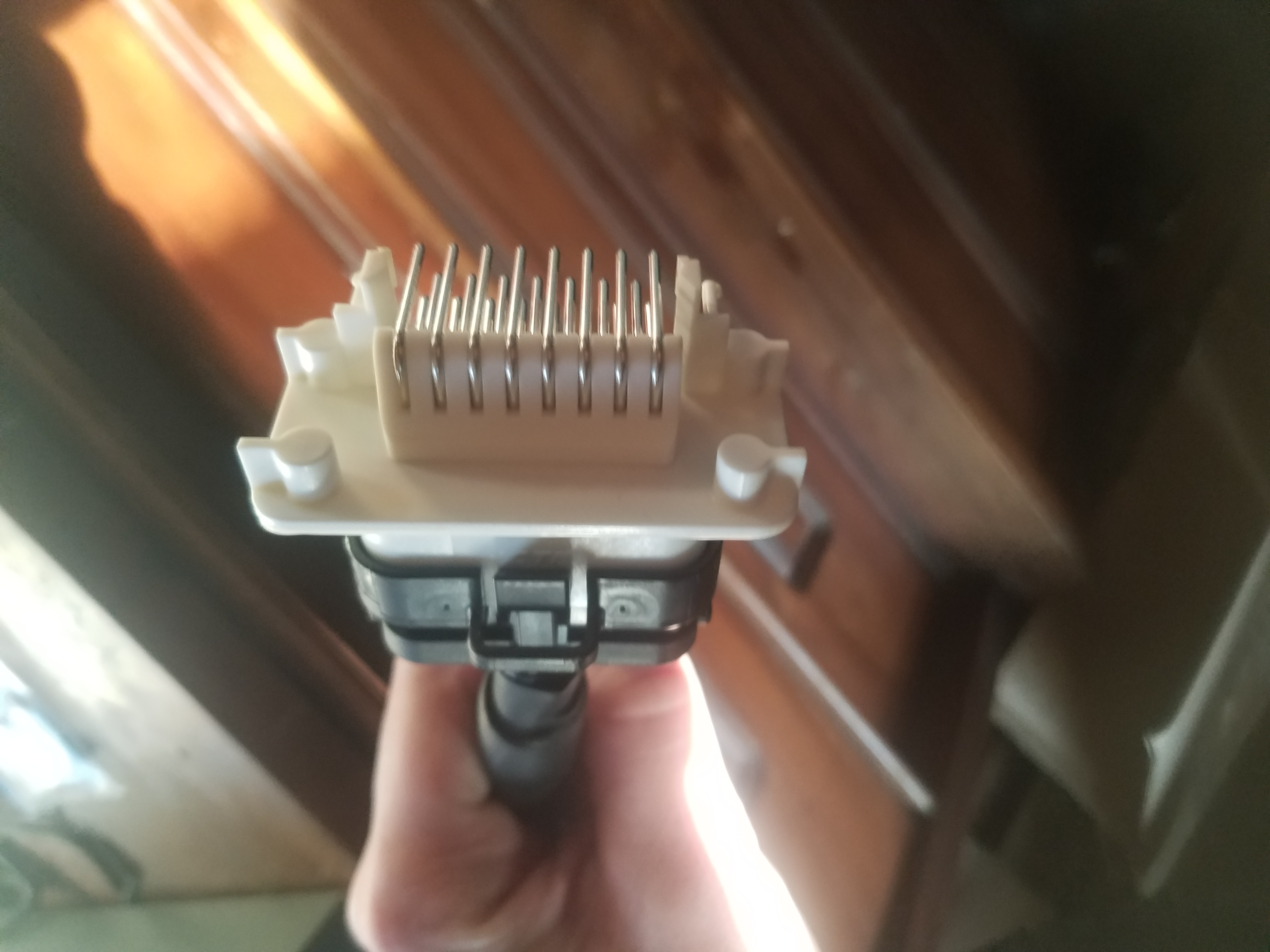

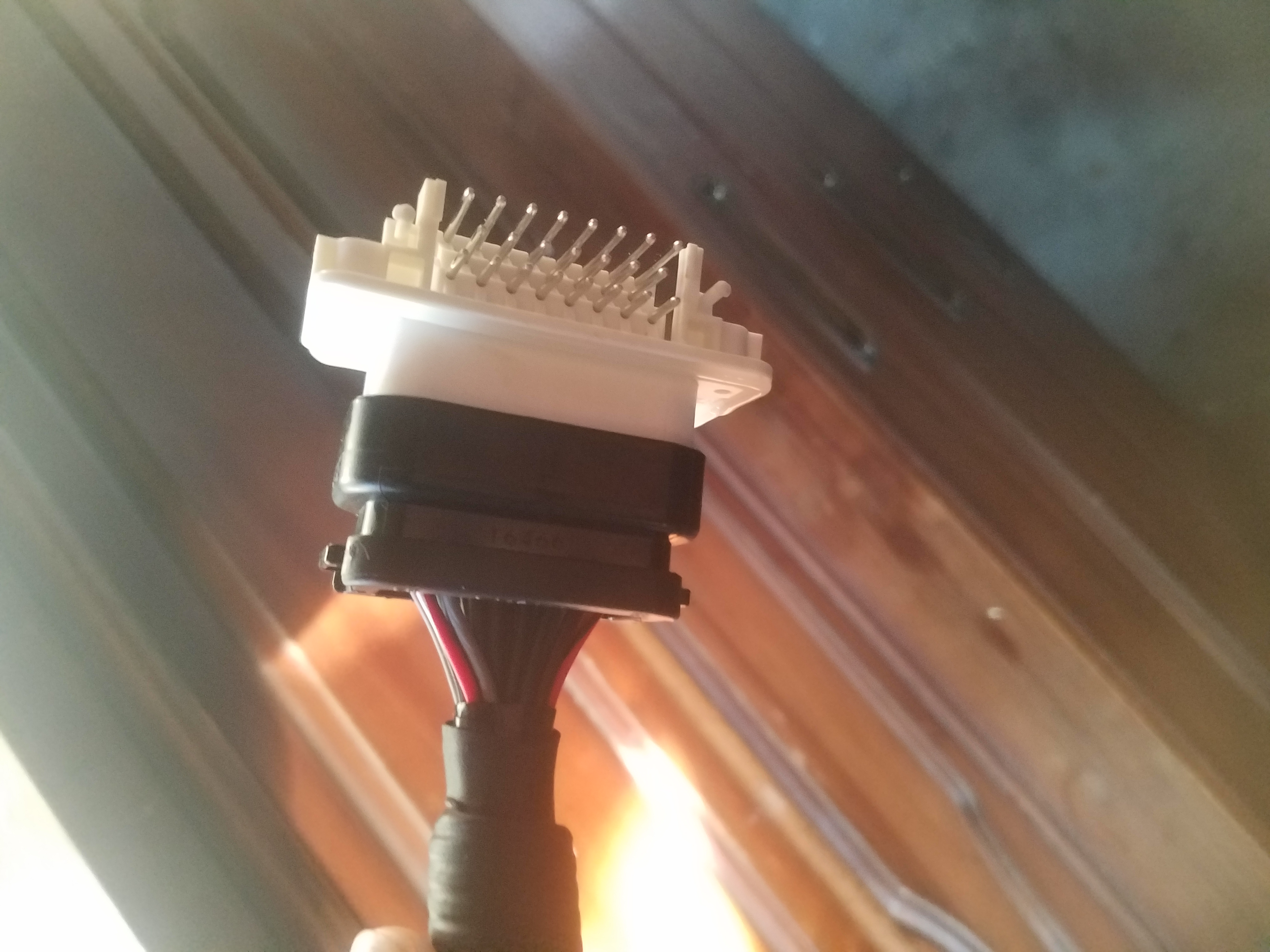

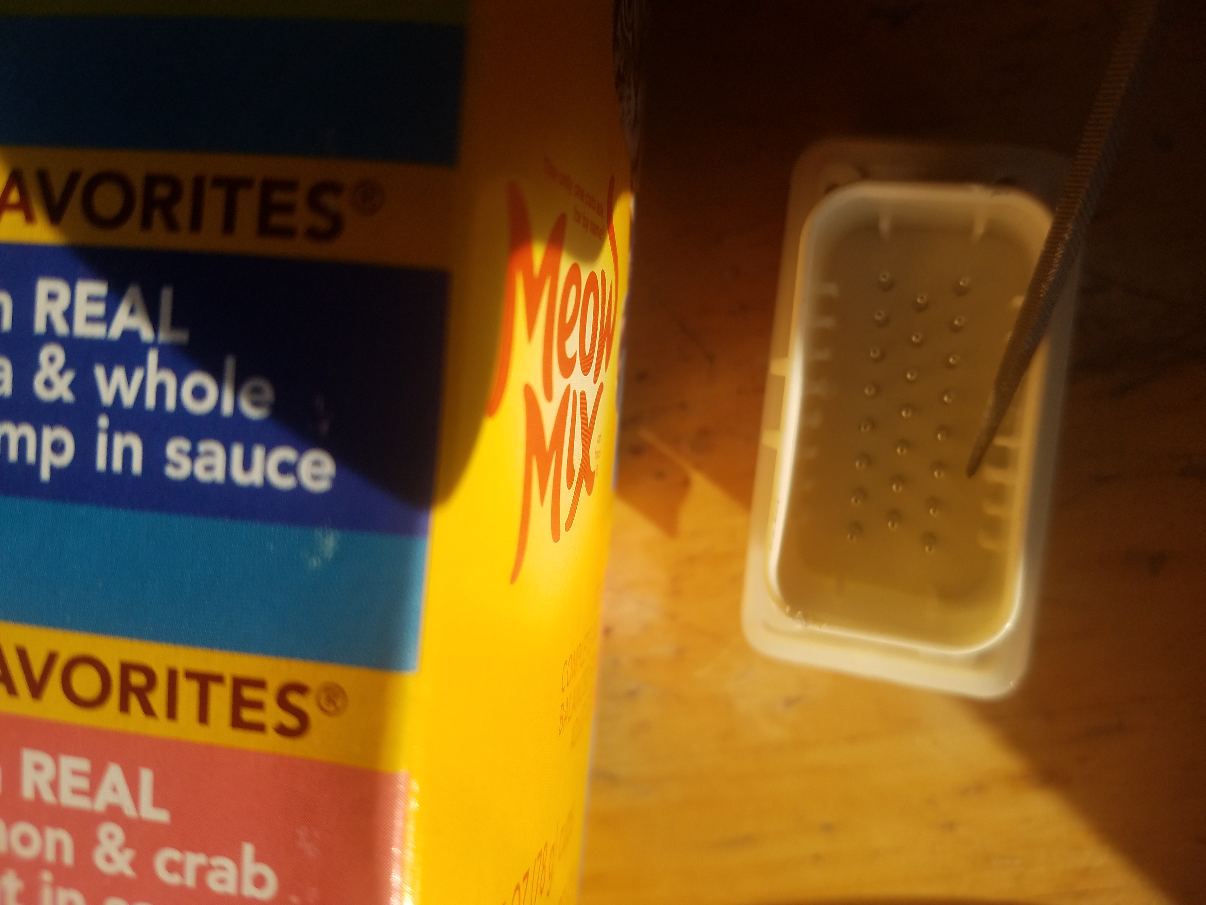

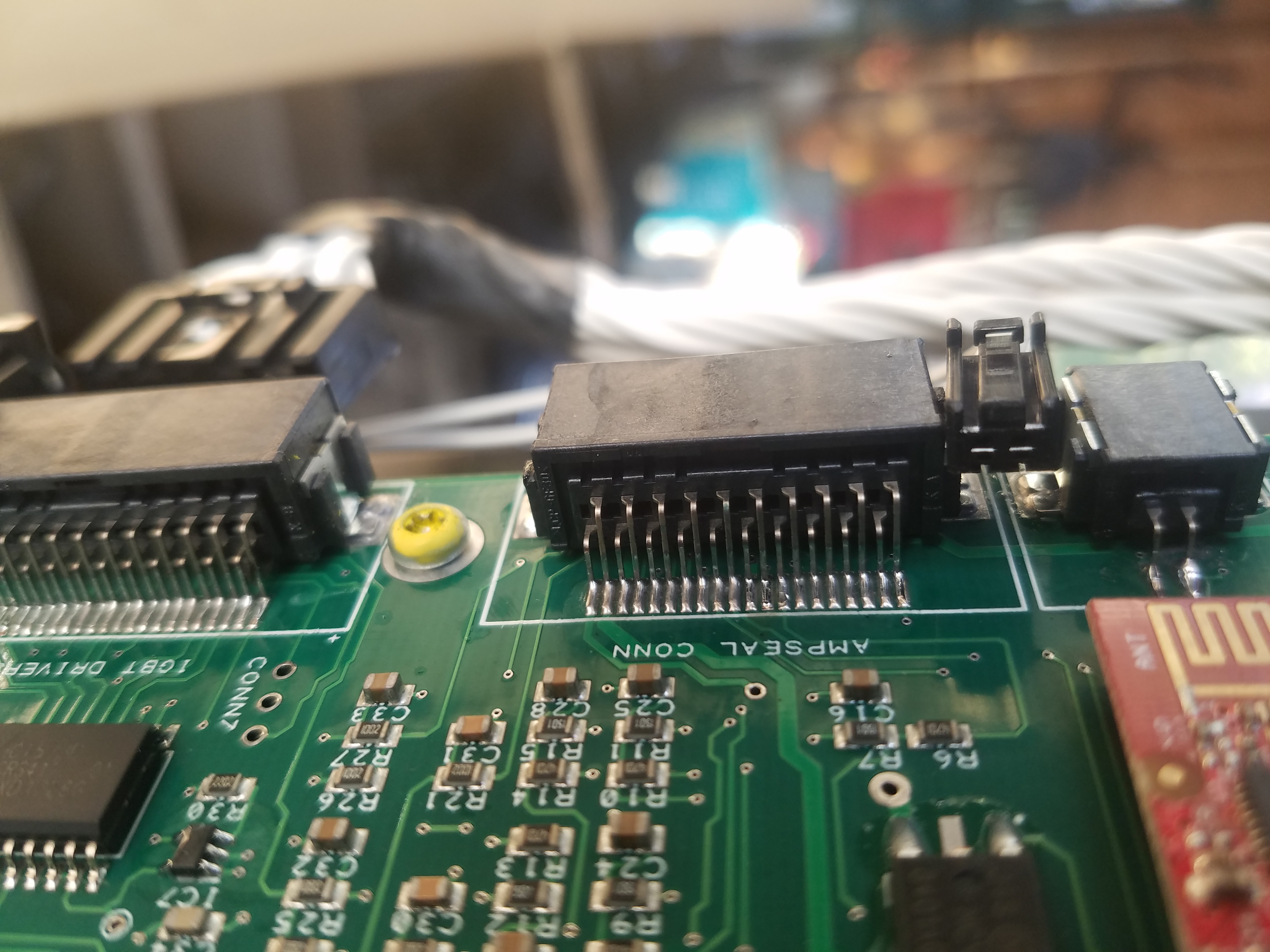

Sure bud! Today I finally figured out a way to get my 23pin ampseal 90 degree female connector mate to the male connector. The plastic prongs on the edge on the inside did not line up so I took a really tiny file and sawed it all the way down and now they fully connect together.

This 90 may give me the clearance I need to close the case according to Tomdb. Might not hit the phase terminals. Excited to finish my harness, solder the cables to the 23 pin connector 90 degree and see if it will fit.

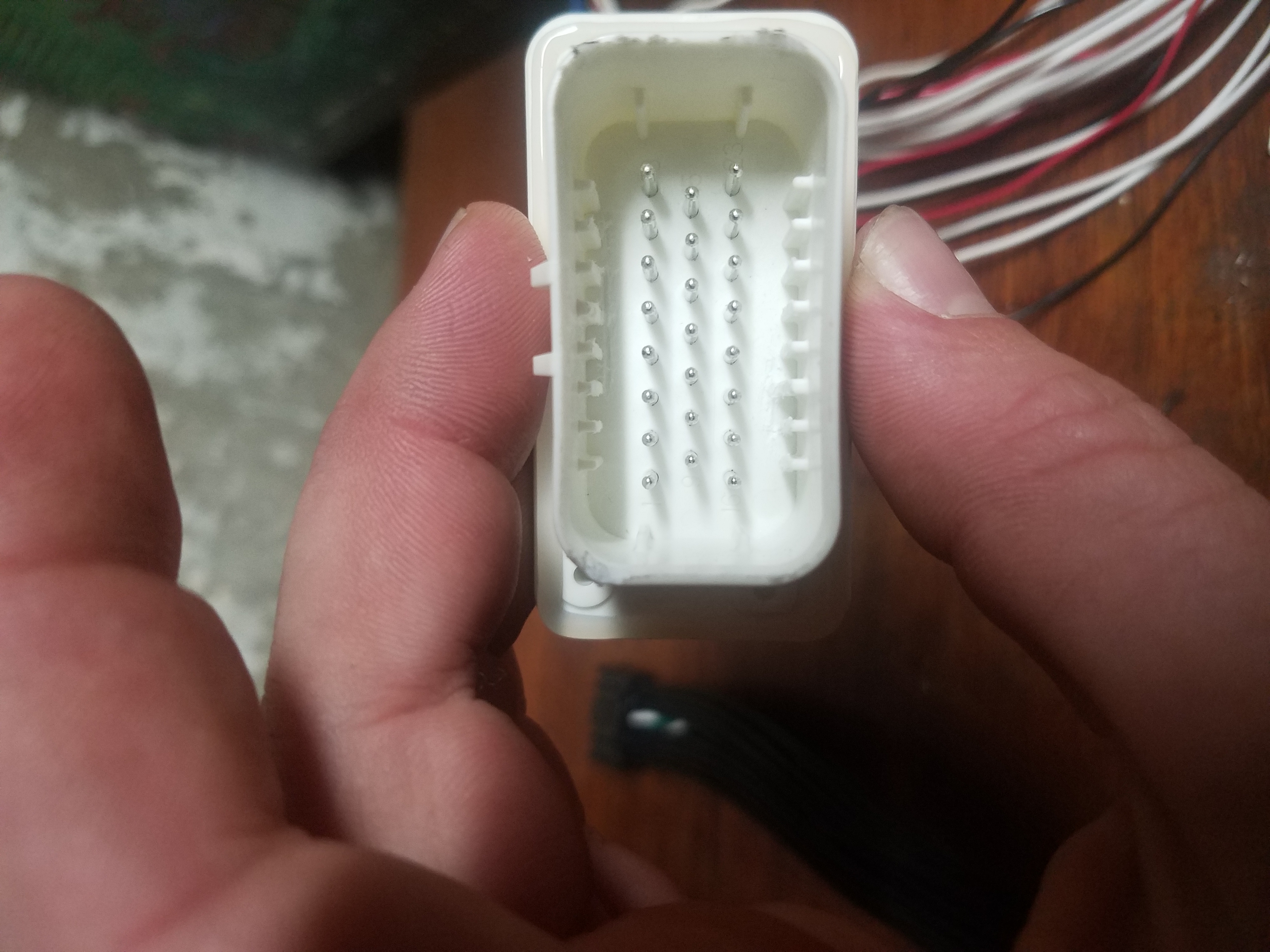

leman2112 wrote: Sun Aug 23, 2020 1:26 pm Ok think I ordered the right female connector with the 90 degree header just like Isaac and Tom have recommended. The picture on the website looks like it makes the 90 degree bend! I am so stoked! Thank you electric friends!
https://www.mouser.com/ProductDetail/TE ... WvWw%3D%3D
This is the one I bought

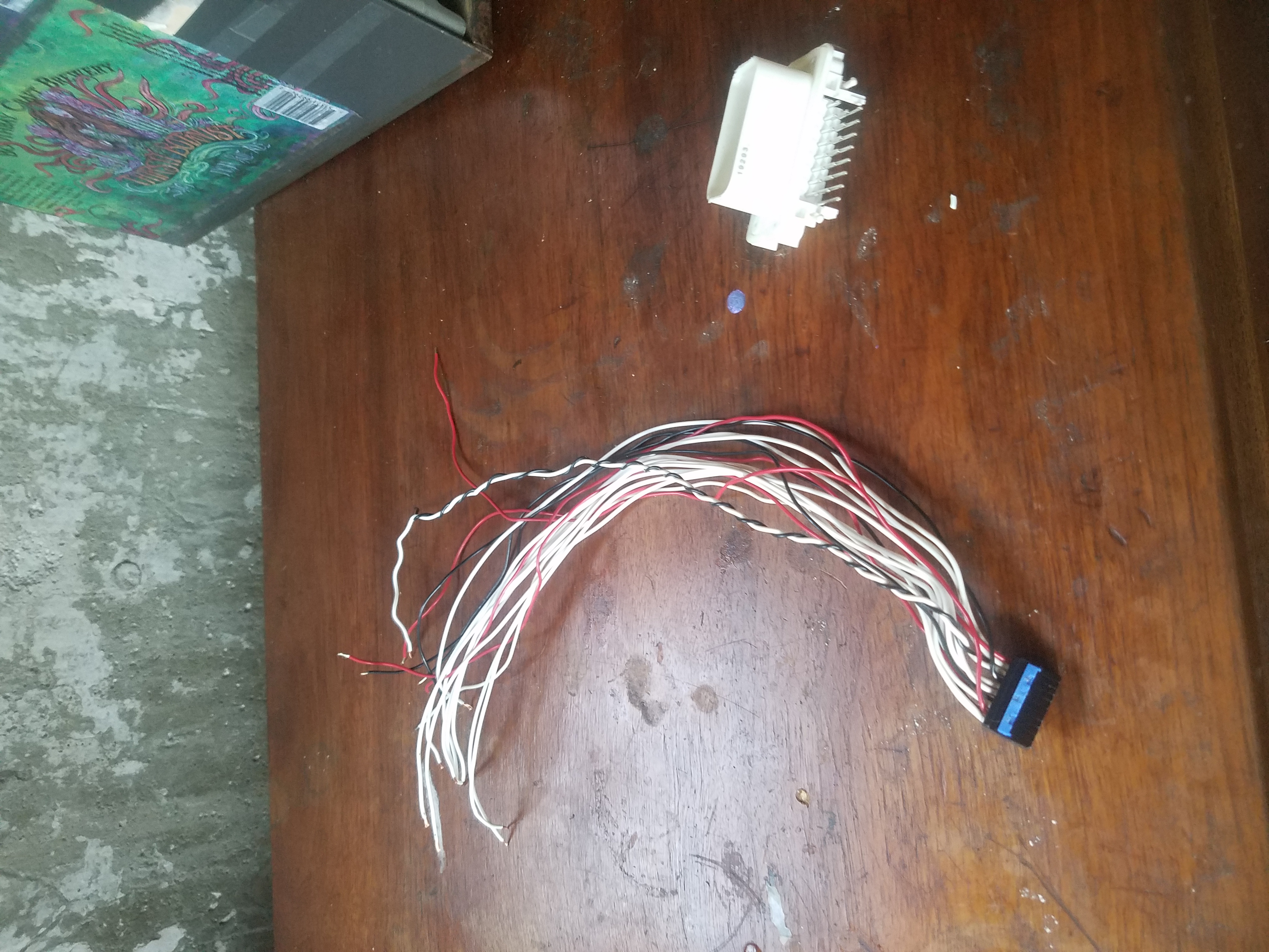

Also need to modify the JST connector on the end of the harness so that it will except the extra wires that are required for a tesla style 23 pin ampseal connector.
Connector for the logic boards is: JST 24CPT-B-2A
Pins are: scpt-a021gf-0.5

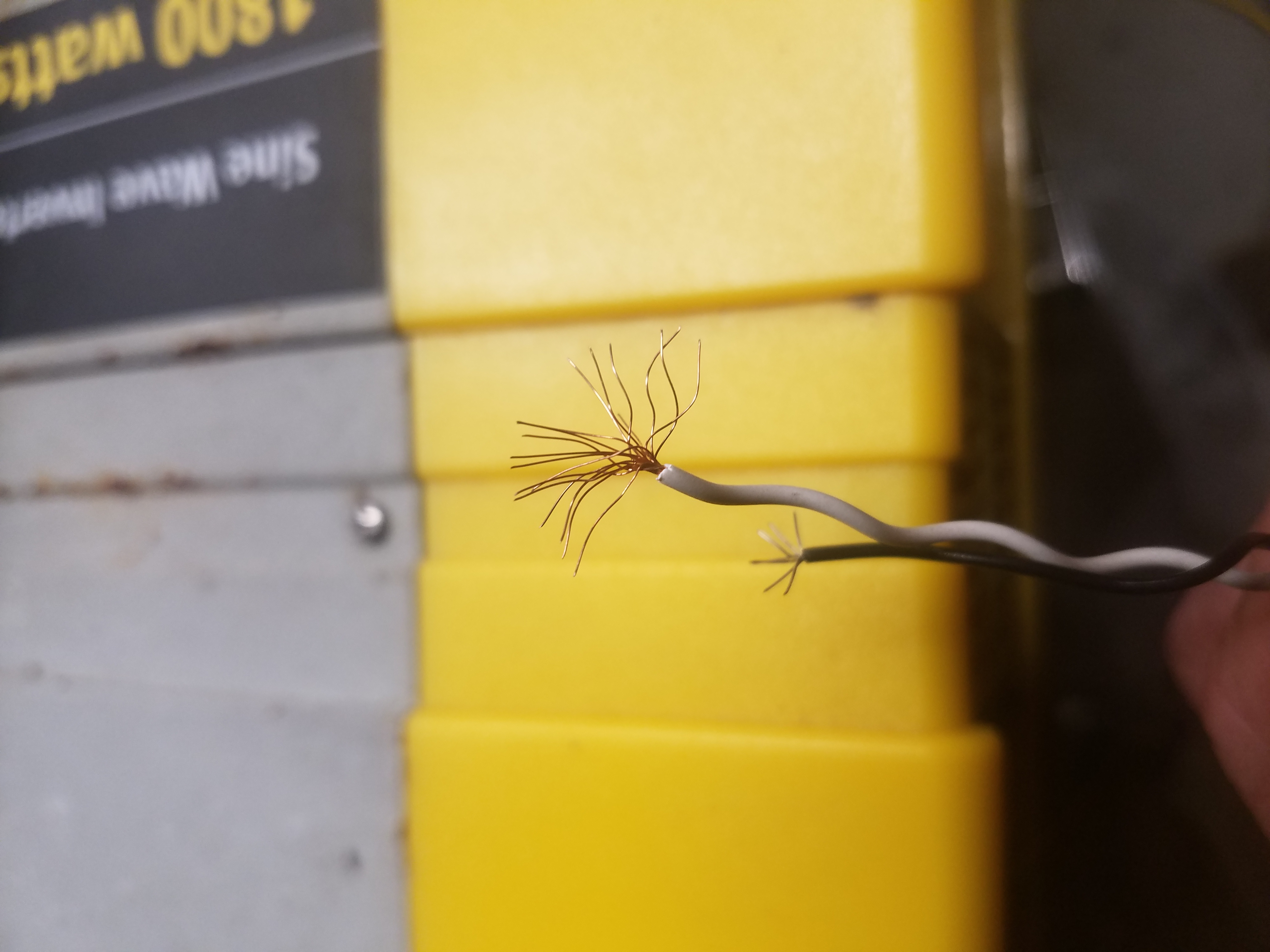

So I made some more progress. My belden 22 AWG cables came. Must say the quality of the original Mercedes Harness seem like better cabling. I can count like 8 strands on the belden and the mercedes had like 20 strands. Hmmmm anyone know a more similar cable brand to go with? Kinda want the same stuff.

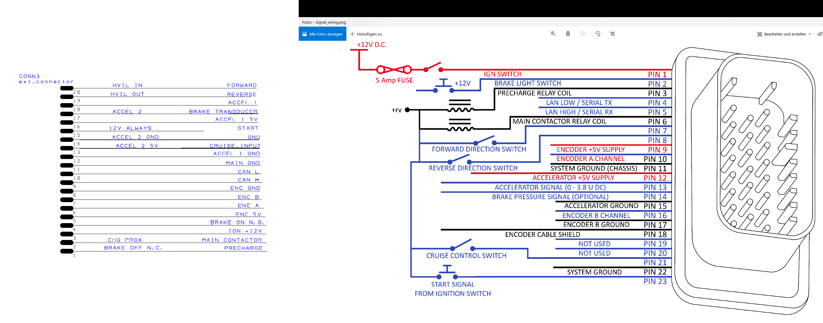

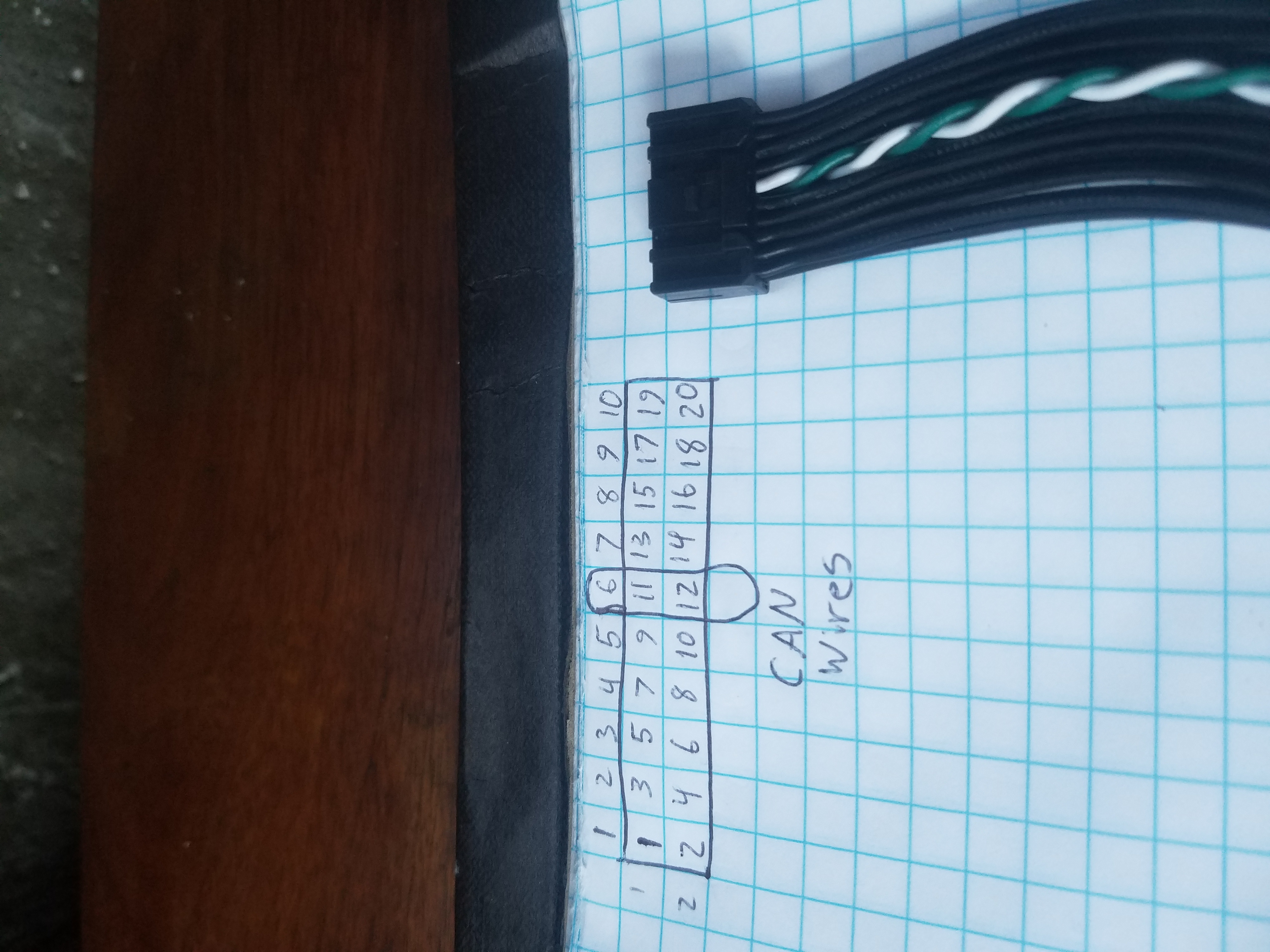

Also trying to figure out the order of the pinouts. The diagrams that are given dont exactly describe the order in my brain yet? Derp... do I just read 1-20 left to right top to bottom just like a book?
Also realized that the harness makes a total twist on my zero ev harness that I bought to help use as a referance.
leman2112
Posts: 173
Joined: Sat Dec 21, 2019 10:30 am
Location: United States
Has thanked: 29 times
Re: Mercedes-Benz B Electric - motor support
Post by leman2112 »
Top to bottom left to right?
leman2112
Posts: 173
Post by leman2112 »
Top to bottom, left to right?
muehlpower
Posts: 698
Has thanked: 14 times
Been thanked: 144 times
Post by muehlpower »

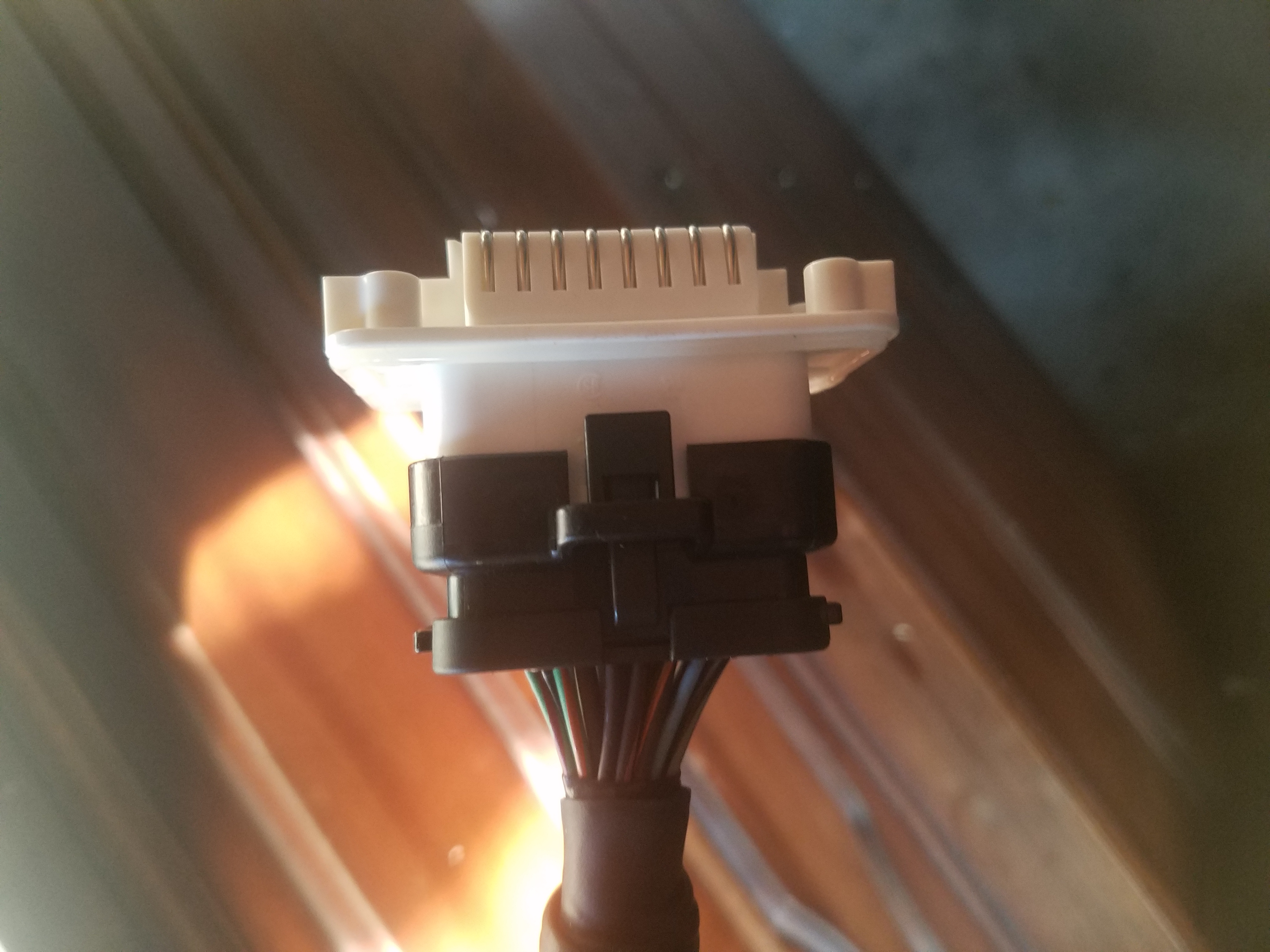

By the way, if you had bought the black plug, the coding would also match!
Amperseal.pdf

Alright awesome Thanks for the ordering of the pinouts! Yeah the black one plugs right in just doesnt have the 90° angle that will help the connector stay clear of the inverter terminals.

TE Connectivity AMPSEAL part 776087-1

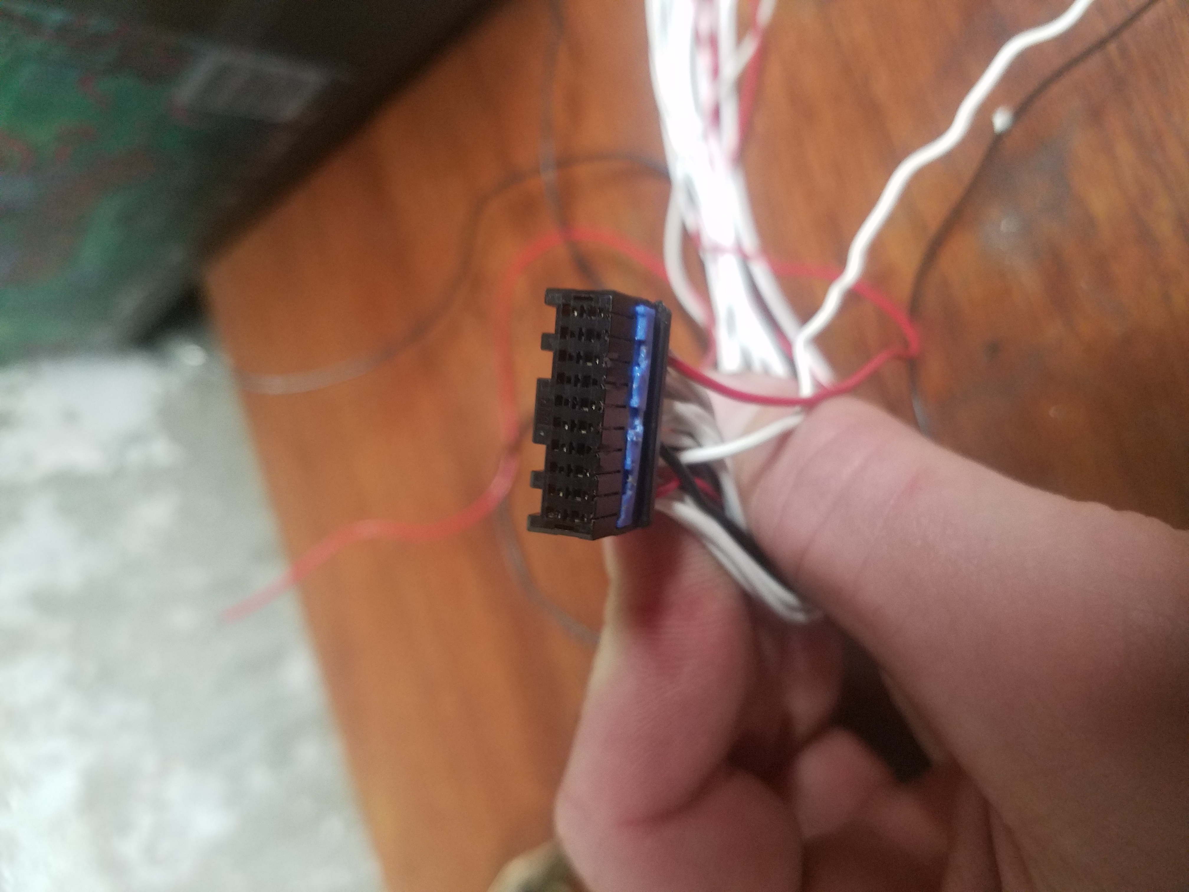

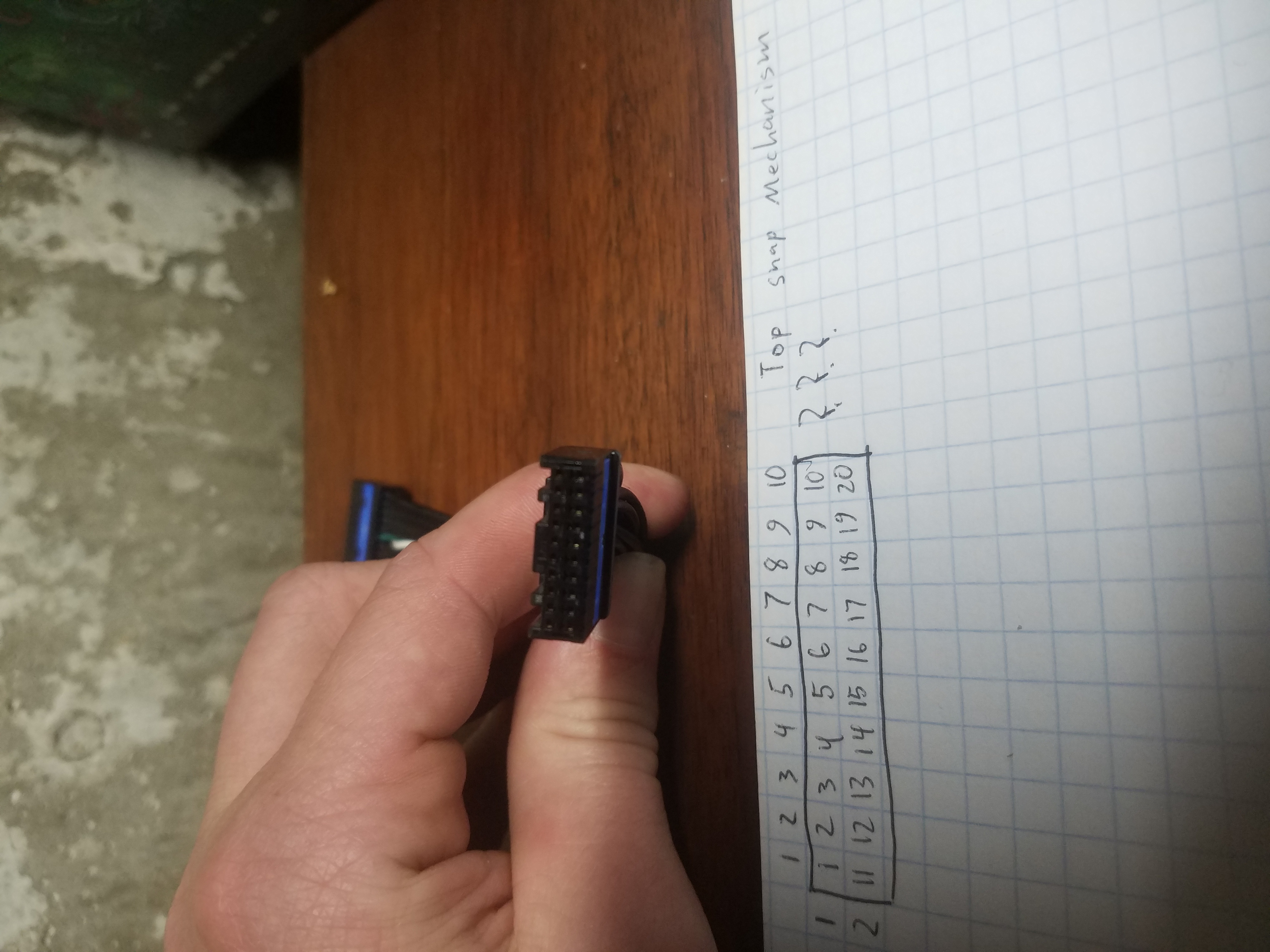

How is the pinout for this JST connector ordered? Like this?
Want to start soldering but dont want to connect them to the wrong pins.

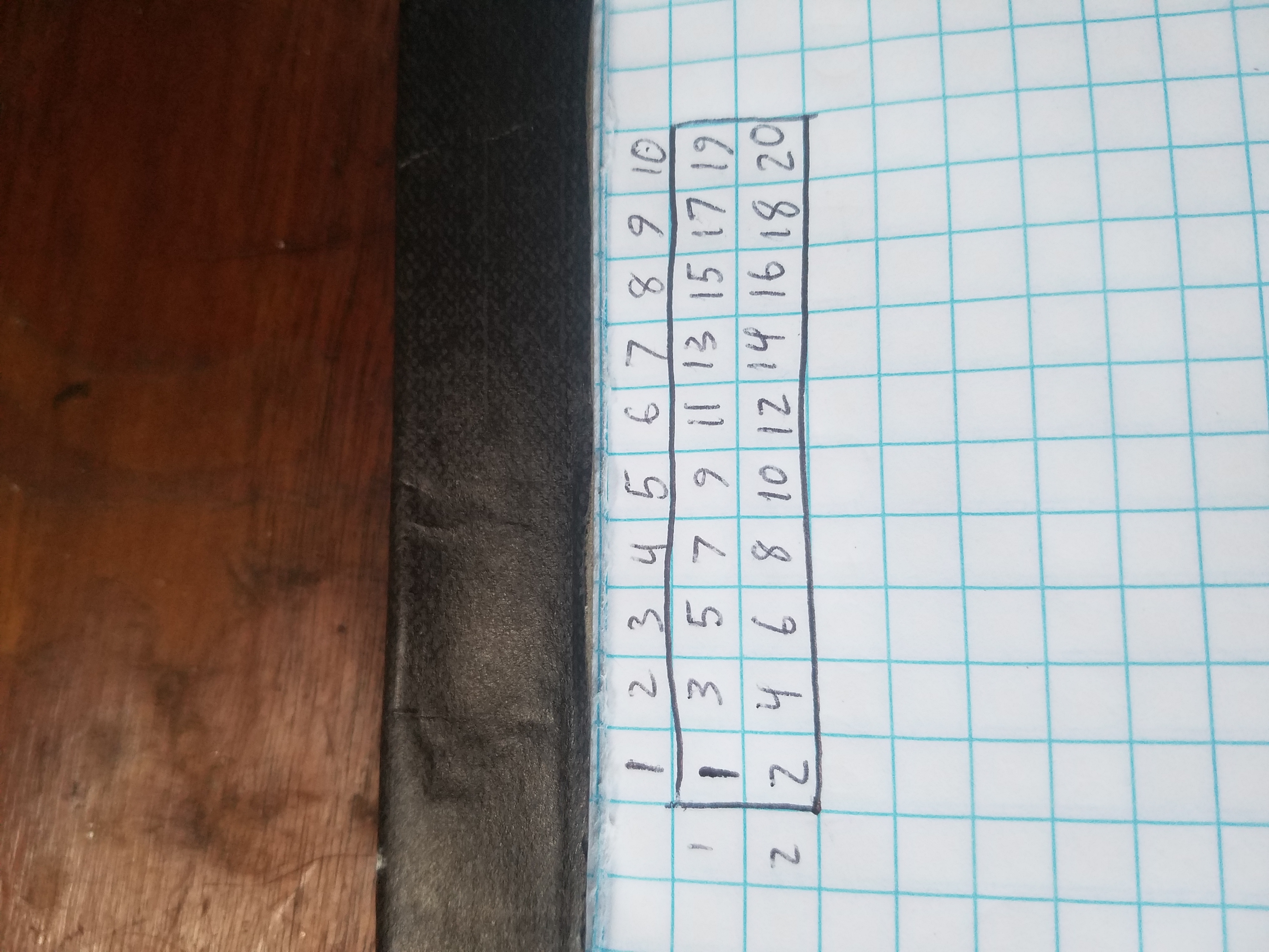

Post by leman2112 »
Think I got it figured out. Just gonna need to look at the logic board and I bet I will understand the pinout finally.

Post by leman2112 »
Ok I think I got the pinout ordering now that I have a visual on the back of the JST connector and the chart provided to me from you guys. Thanks.
