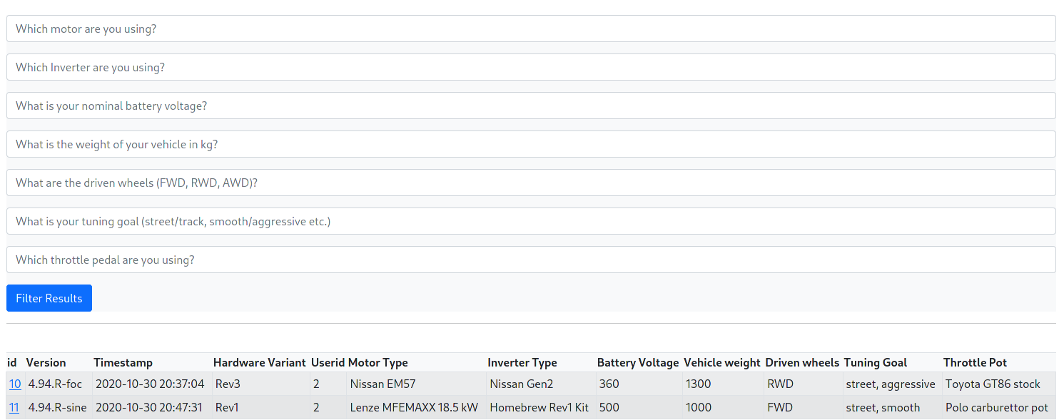

So, as discussed earlier I want to implement a parameter database as soon as the Patreon goal is hit: 2 more $ needed
So in this thread I want to discuss the design.
  • Only forum members can post parameter sets to avoid spamming
  • Hitting a button on the web interface will transmit your current parameter set to openinverter.org
  • You will then be asked things like "What motor do you have, what inverter, what battery voltage"
  • Your parameters will be stored to a database and categorized by the data you entered above
  • Should it be linked to your forum username? This is a GDPR question merely
  • The web interface will be extended to carry an offline copy of the parameter database, I think json.gz should fit the flash
  • The advantage: you DON'T need to be connected to both the internet AND the ESP module to use the database
  • You can update that database
  • You can then choose something like "Apply inverter parameters of inverter X to my controller". Likewise for motor, throttle pedal etc.
  • There will also be the possibility to browse the parameters on openinverter.org
More ideas?

johu wrote: Mon Oct 26, 2020 7:10 pm More ideas?
Probably should have a category for vehicle weight and one for drivetrain (FWD vs RWD).
Some people might be interested in a field for driving/tune style, i.e. street/track, smooth/aggressive, commuter/racecar

I take it away that metadata implementation must be very flexible :) All questions to the poster will be stored in the database. Some items (like AWD, FWD RWD) are maybe better off as enums instead of free text to avoid semantic duplicates like "FWD" vs. "Front wheel drive".
Every parameter set that is posted does have a date attached to it. The user who posted it can delete their own set.
Concerning GDPR I'll just have a checkbox and a description of how the data is used.
I think the database will be free for all to view, even non-forum members. I will have a "digikey" style filter that lets you filter the posted parameter sets by the metadata suggested above.

I'm also now thinking whether to have a list of parameters that are highly custom to you personal preference or your setup. For example "dirmode" or the various regen parameters. Those parameters can then be excluded when applying the set to your inverter.
Bigpie wrote: Tue Oct 27, 2020 4:09 pm Joined your Patreon, hopefully that gets you to your goal. This is a pretty cool idea, would be handy to have maybe versions to subscribe to and the car can automatically check for parameter updates and notify the user somehow that they might want to update. Also direct downloading and updating of firmware would be cool.
Yes, goal reached :)
The only challenge with automatic updates is to setup your connection. By default you connect to the inverter via wifi (be it your phone or laptop) and thereby loose internet connectivity. Easy to solve, as you can just enable mobile data (and disable "use for internet" in wifi options) or plug in an ethernet cord. Just something people need to be made aware of so they don't write "it doesn't work" forum posts ;)
Otherwise it would be easy to subscribe to a specific parameter set by its numeric id.
When you post a parameter set you can choose to update the existing one which will get people notified or create a new one with different goals, that will NOT get people notified.

It won't be file based but based on parameters and categories. So you can use for example motor parameters from one set and inverter parameters from another.
I'm using a mysql database for now. Source code will go on github.

Just want to let everyone know we (Dima, me) are making good progress with the database.

It is done :)
Huge shoutout to Dima who designed the graphical interface on the server side.
Now, to use it:
- Download https://github.com/jsphuebner/esp8266-web-interface
- Upload the files inverter.js, index.js, index.html to your ESP module (via Update on top of the page)
- Refresh
- Upgrade your inverter firmware to 4.95.R if you want to submit parameters (release coming)
- If you think your parameters are awesome, submit them with the apparent button
To download parameters
- Go to https://openinverter.org/parameters
- Choose a parameter set
- Choose the parameter categories you want to download, e.g. just "Motor"
- a) download as json file and apply that to your inverter
- or b) subscribe to the parameter set - now every time it is updated you will be notified!
- Subscription is done by pressing subscribe, copying the token and pasting it into the ESP web interface + <Enter>
In order for this to work your computer/phone must be connected to the internet AND the wifi module simultaneously.

MattsAwesomeStuff wrote: Sun Nov 15, 2020 9:38 pm One suggestion: Allow people to name them, or number them, or something, so people know what they're using and can refer to them.
They are numbered internally so you can post links like that: https://openinverter.org/parameters/view.html?id=10
That said we can add arbitrary metadata if needed.
jalovick wrote: Mon Nov 16, 2020 4:05 am Is it possible to calculate the power and torque output (at the output shaft) from the parameters?
Very hard for sine software, possible for FOC (100*throtcur*udc/sqrt(2) ). Maybe easier to let people specify it in the metadata, at least for sine.
