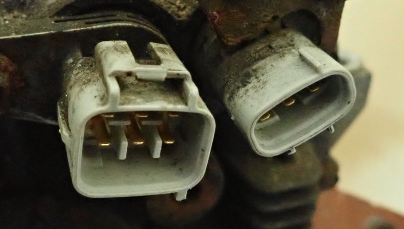

Jack, Are you planning on doing any speed vs rpm measurements as information appears to be a bit thin on the ground for these motors?
I paid £100 and collected it at the weekend.
It was sold to me as a "LEXUS RX 400H 2004-2008 209048010 "
It has 2FM on the casting and what looks like a barcode and serial number sticker.
Has anyone identified replacement connectors for the resolver and temp sensor?
Trying to decide if something like an inverter from a 2015 Yaris would be a suitable donor to power it as they are common and inexpensive.
I also guess they are more compact and a bit smaller than the Mk2 Prius inverters?
