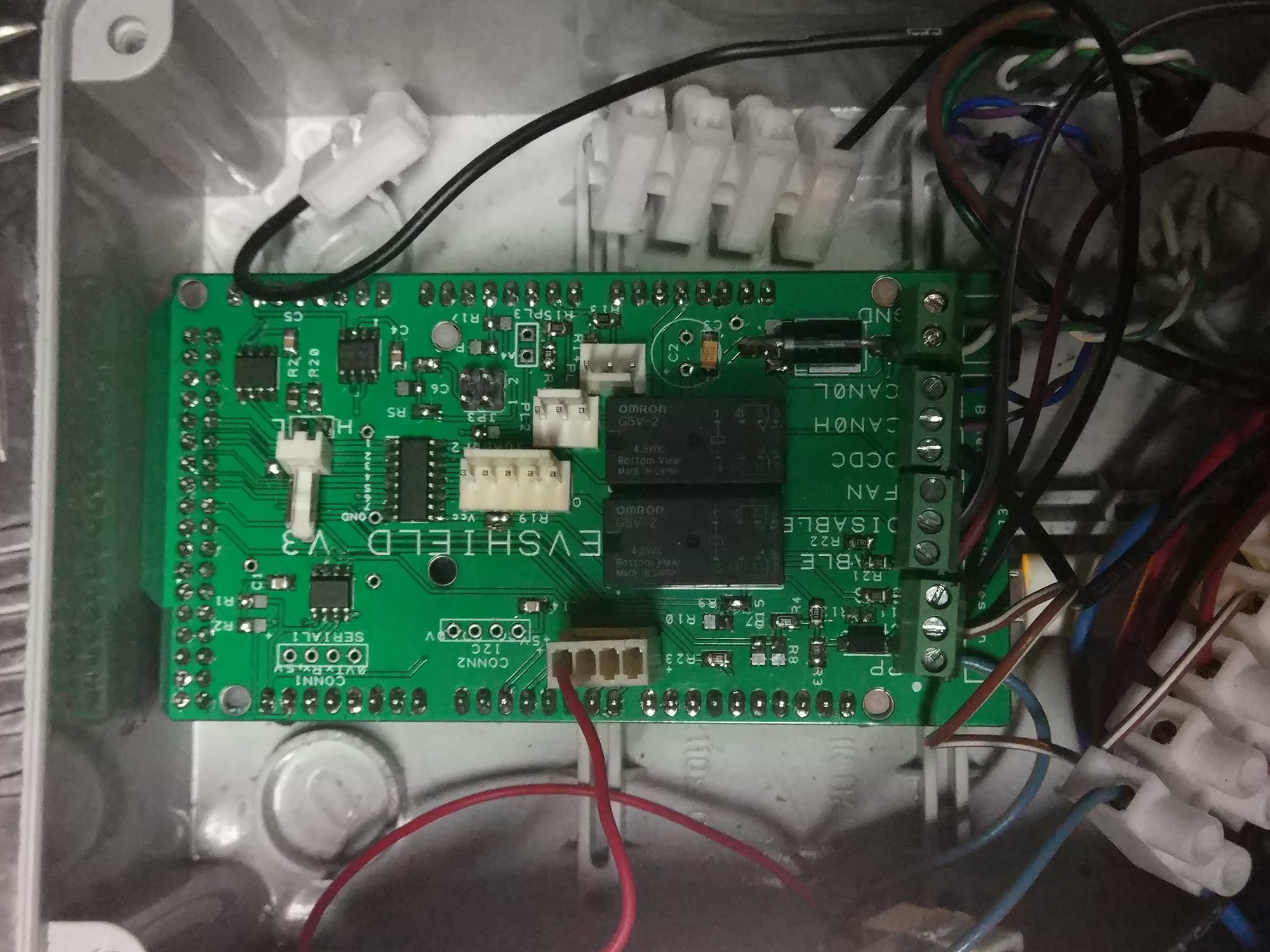

I have a small problem. I installed my charger and connected it to a 2nd phase next to my Eltek charger.
I sense PP signal with my DUE and it starts to transmitt CAN.
Outlander Charger pulls the EVSE in and i guess both chargers work together at 11A. They should work at 18A though.
Next i disconnected the CAN lines for Eltek charger and i saw a steady 3A from Outlander charger only! I tried to change the code but i cant get it to give more amps.
What do you think is wrong? My code is here: https://leafdriveblog.wordpress.com/202 ... ger-tests/

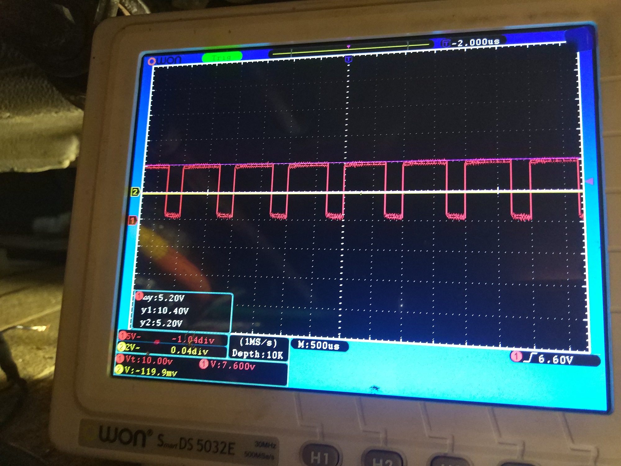

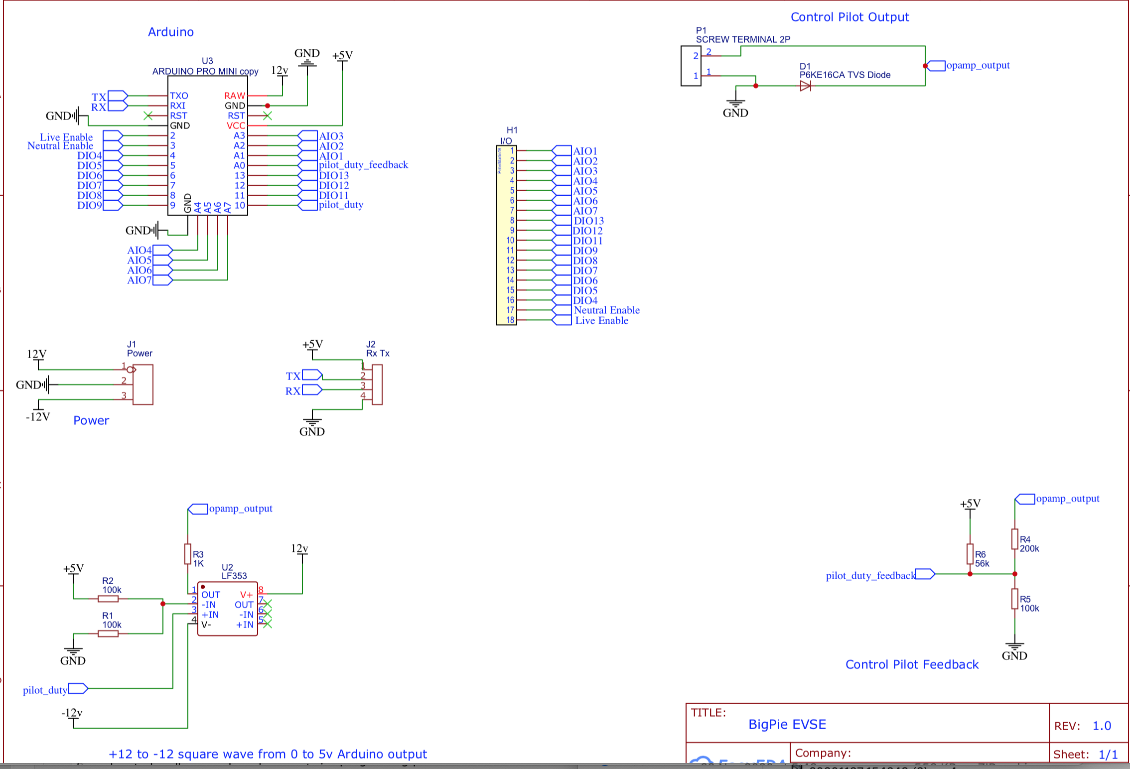

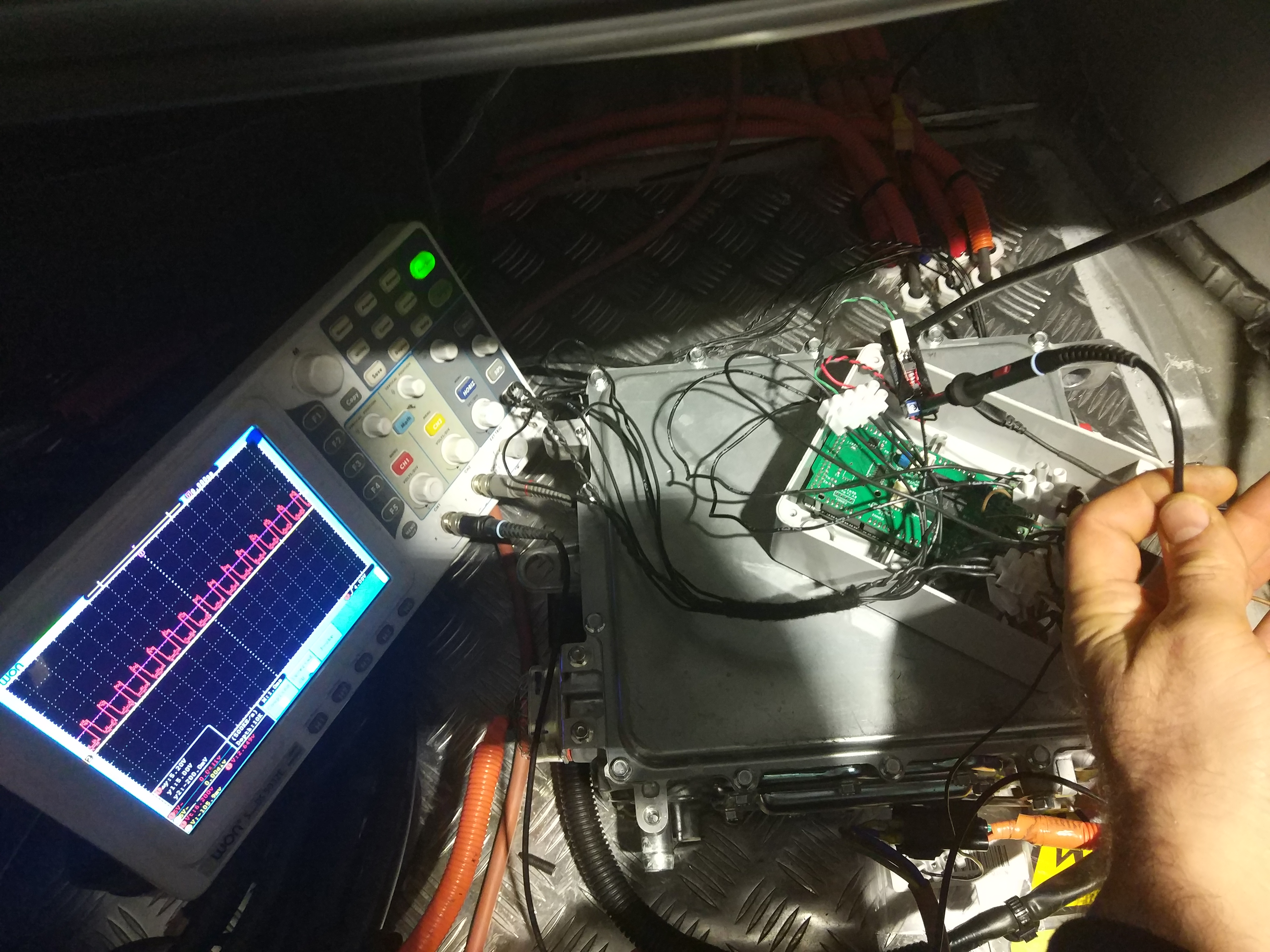

Damn... it wont work no matter how i set my CAN MSG. And to think i tried it dry a week ago and it gave me 8A!
I am begginning to think its my EVSE CP signal. Yet it is no different than a week ago...
I will try to expand it a bit.
EDIT: It was CP signal. When i tested it with my scope it seemed awfull small duty. I verified this when i opened my EVSE. Inside a resistor broke off. It was the same resistor that fixes your EVSE current limit. Of course without this resistor it was set to "ventilate" at 6Aac.
Now that i set this straight i get good 16A from both chargers. I will observe a bit just to be absolutely sure

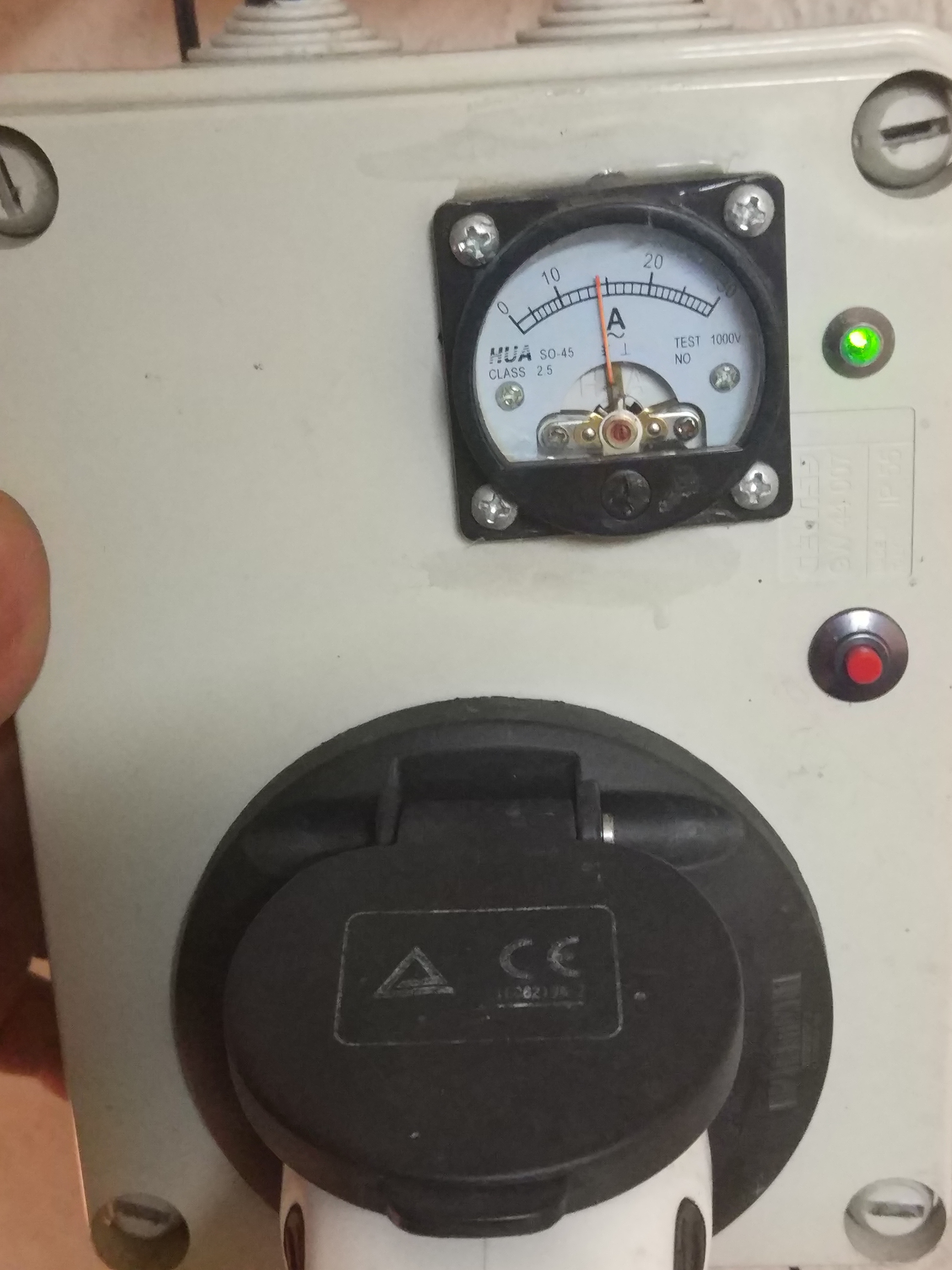

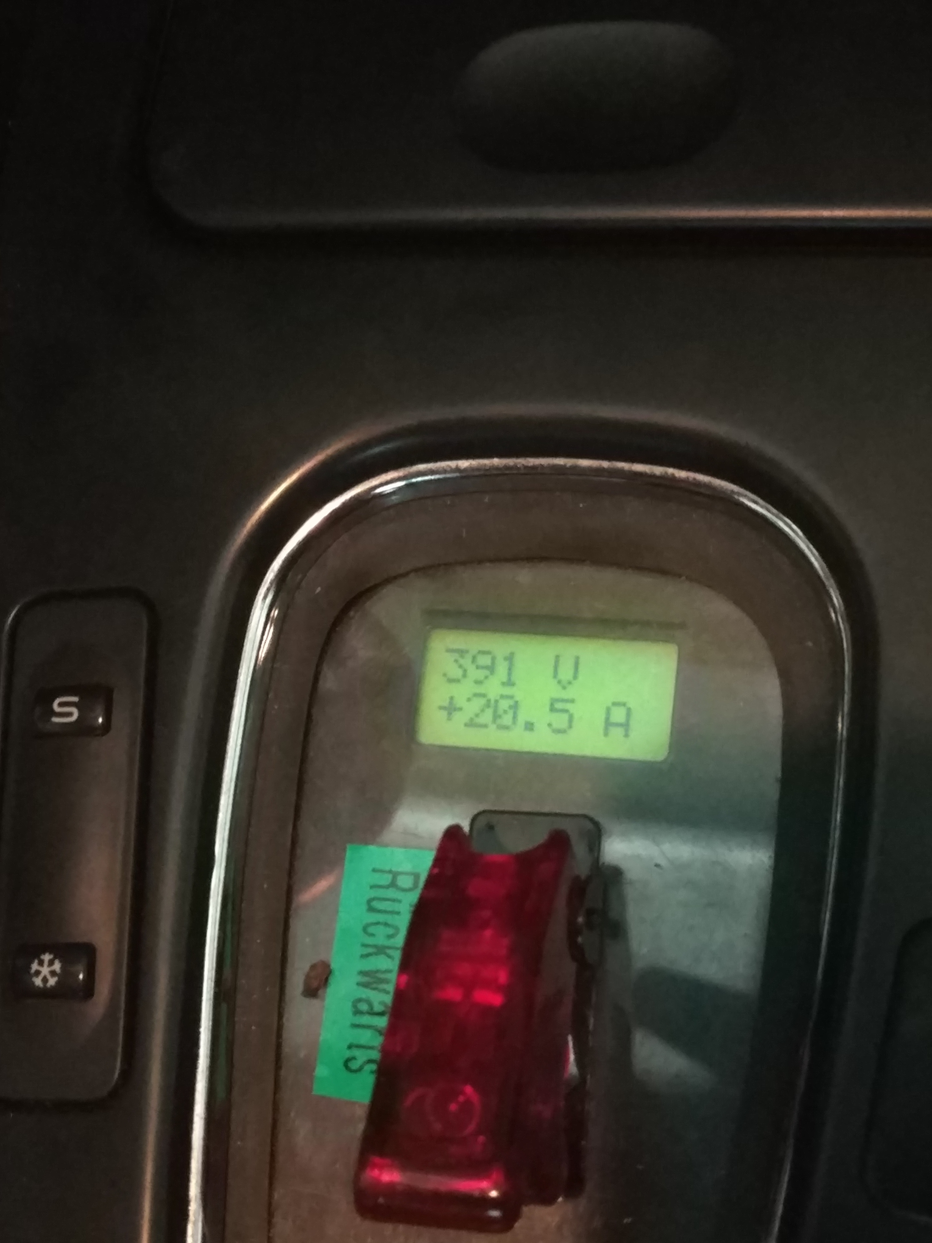

It works good, i get 16A at 388Vdc, so this means 6.2kW of power. Really good! I will try now to use a third Outlander charger here with in the same line with the same commands. See if the two interfeere with one another anyhow. I will not build it in yet because a friend lent it to me for experimenting. That will come later when i am more confident... This should now create 6.2kW + 3.2kW = 9.4kW power on the battery. Plenty enough for me.
There is a slight problem though that i recognise immediately. This charger has a function to pull down EVSE CP signal and this is how it starts EVSE. My Eltek does not do that. Therefore i will be limited to using Outlander charger as my primary single phase charger.
I will connect a single phase cable to my EVSE so when i connect to this i will be loading only one phase in a house which will leave other phase for my wifes Ampera to use. Steady charging through the night or faster charging if we need to go somewhere soon.

Re: Mitsubishi outlander charger and DC:DC

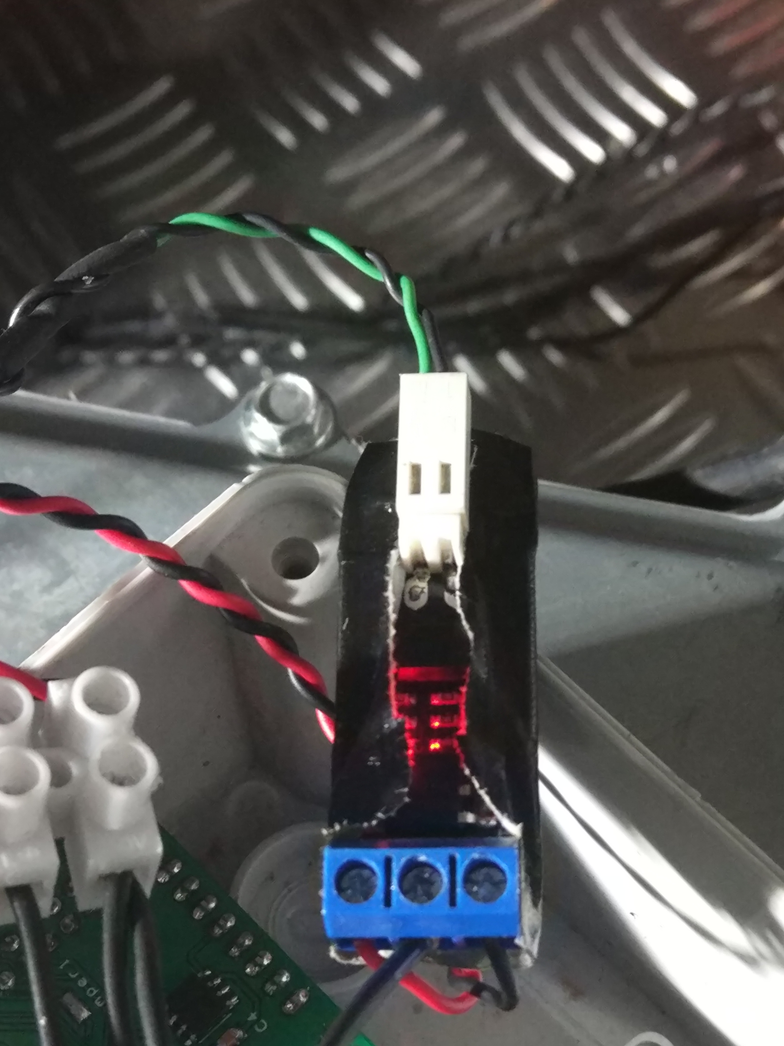

Huh! I managed to connect the third charger and connect it to CAN bus and the rest of spagetti. When i connected it to my EVSE i got 15A!
But after some time my EVSE dropped the contactor. I cant connect anything to it anymore.
I am now thinking poor Simple EVSE couldnt supply enough CP signal to TWO chargers and its DCDC released its magic smoke. I will try what happens on my desk...
EDIT: Nope, EVSE is fine. It looks like the first charger shut itself down and wouldnt pull the EVSE in. The second one could do the job, but not in paralell with the first one. Maybe some CAN msg collision?
I also pulled the rest of wires out and repositioned the EVSE plug. Yes the first charger started to react and would feed 8A.
I will experiment some more what happens. It seems like two chargers online start to pull CP but something happens and they release it.

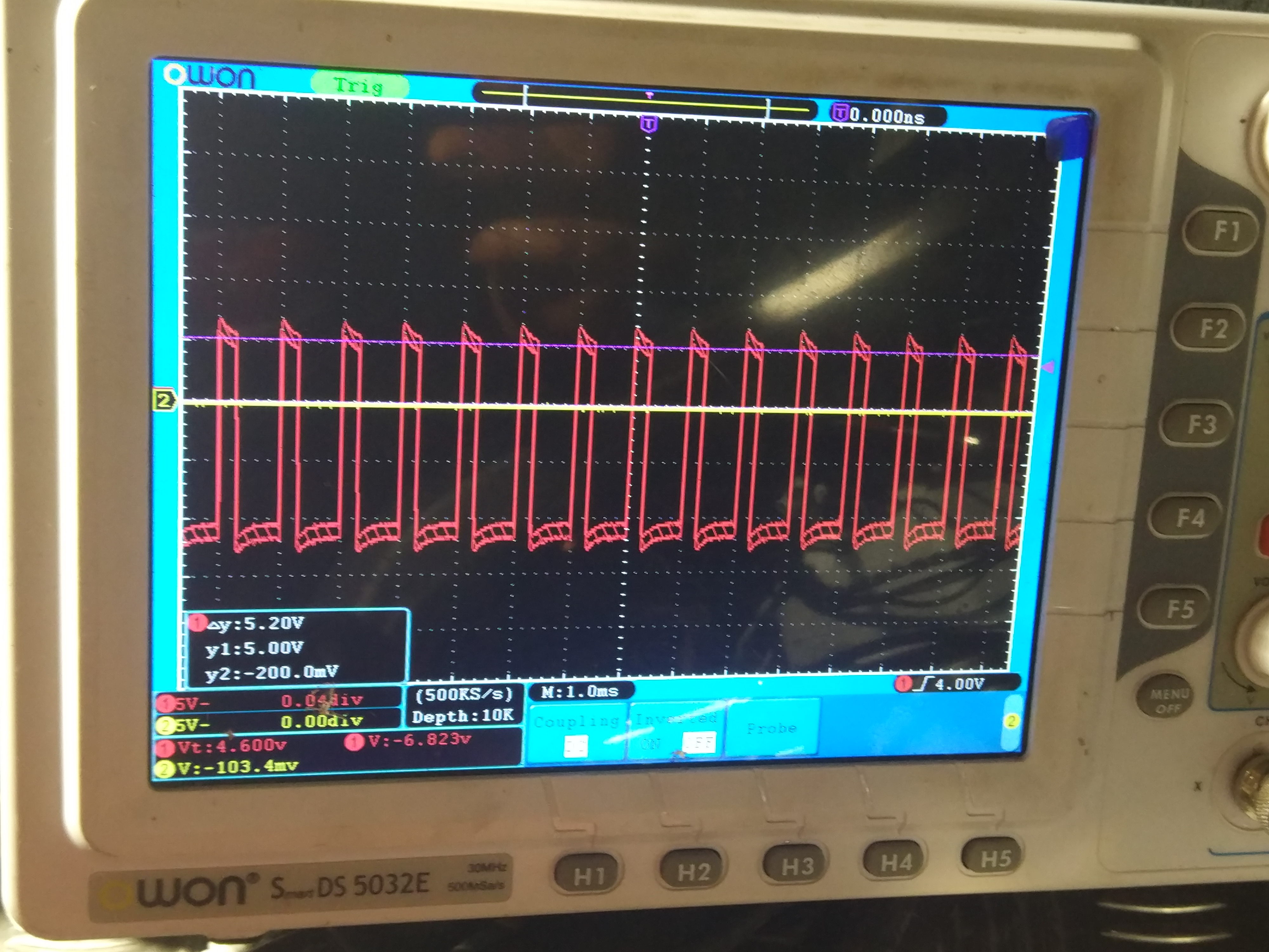

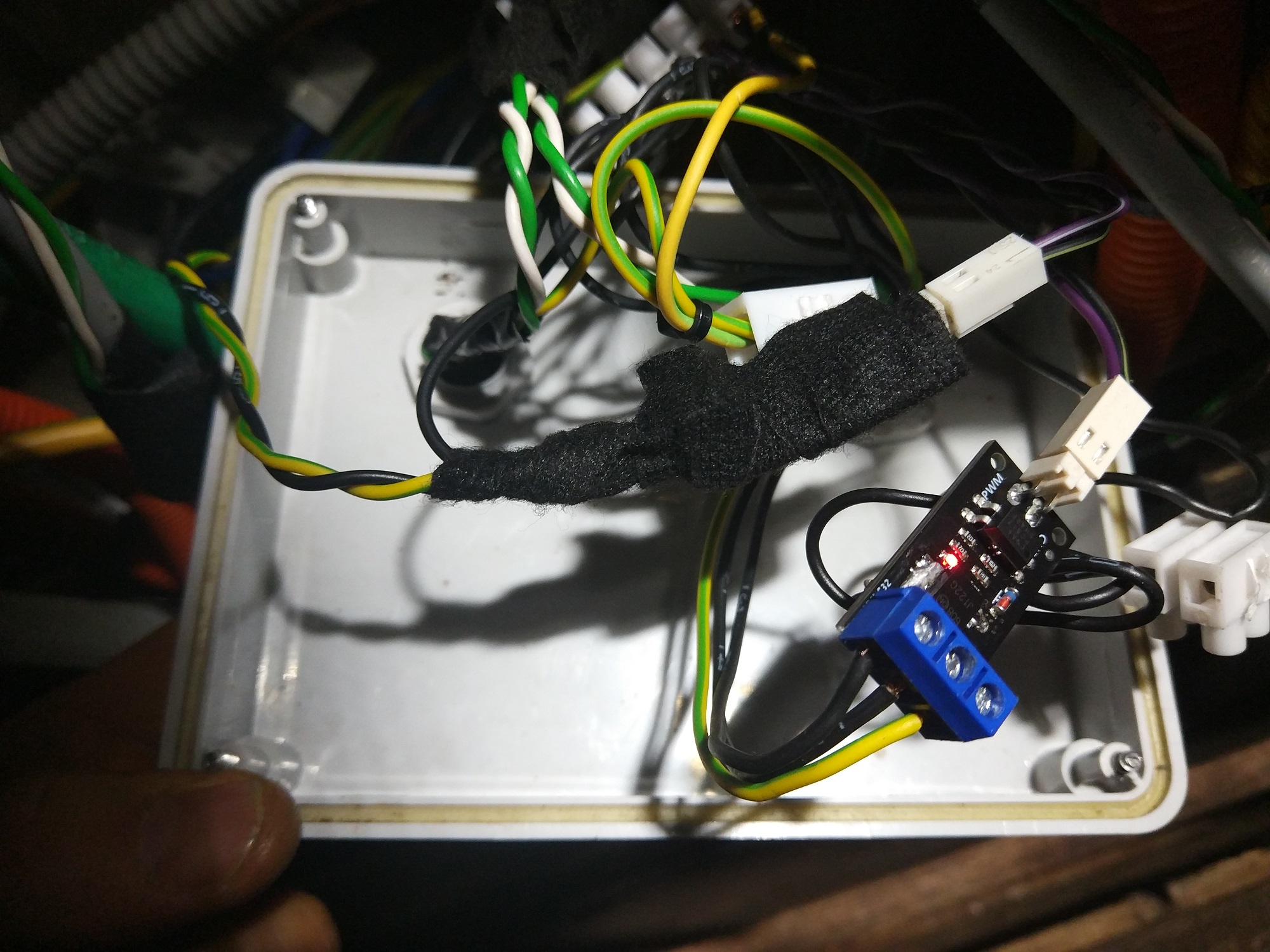

I may make a copy of CP signal with some transistor pair and feed both chargers the amplified version. Of course CP resistors will be pulled in through my circuit.
EDIT2: Yes that is exactly the case. Once the first charger pulls EVSE in voltage on the line falls to some 6V and after the second one pulls it further voltage falls down to 2,5V and at that point both chargers release EVSE because they think it is an error.
Next i took my pulse generator and first made 12V peak to peak function. I got both of the chargers ON! Good. Then i adapted the weave form so it was 5V to 0V PWM as it would be with signal from transistor. If i kept signal at 5V second charger would work good. But if i would lower this to 4V charger would release CP.
I will really have to make a transistor circuit to repeat CP signal from inside my junction box.
A
A
- Posts: 3795
- Has thanked: 166 times
- Been thanked: 411 times

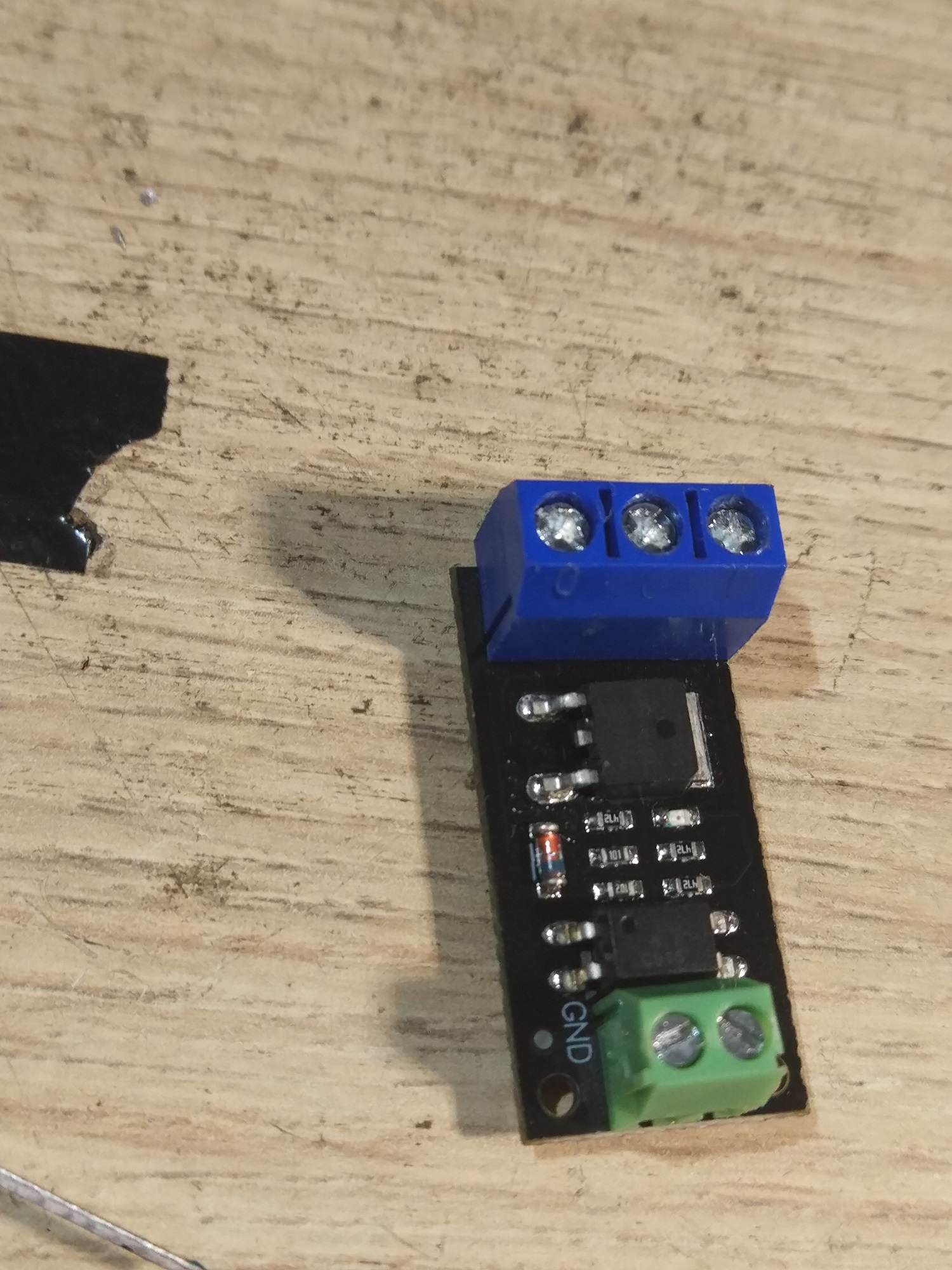

I used simple opto isolated mosfet module with 1K pullup to 12V and it worked immediately. I could vary the power through EVSE button setting and both chargers responded to varrying CP signal.
What is more i also connected Eltek charger on the first phase and together i got 21A which is a little less that usual due to the high SOC value at 390Vdc.
Next i will work on getting the voltage reports on x389 msg and using that to stop the chargers, Eltek will take care of itself up to 390Vdc. Idea is to stop the two Outlander chargers at 390Vdc and then taper off with Eltek. Maybe later i can even use the voltage info with my fast charging CHADEMO setup.

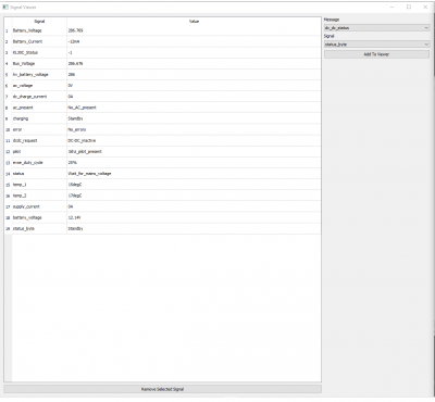

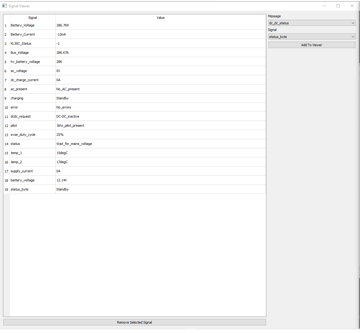

I have put together a DBC file for anyone wanting to read the CAN bus output of the charger/DC-DC converter in SavvyCan. Not perfect but think I've got all the useful stuff in there.
- charger_savvy.zip
- (3.99 KiB) Downloaded 1116 times

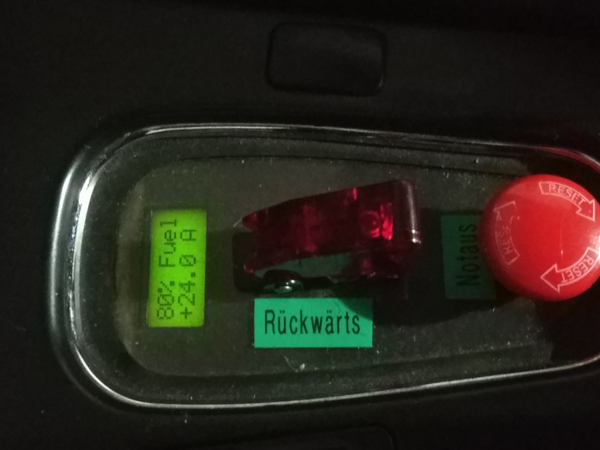

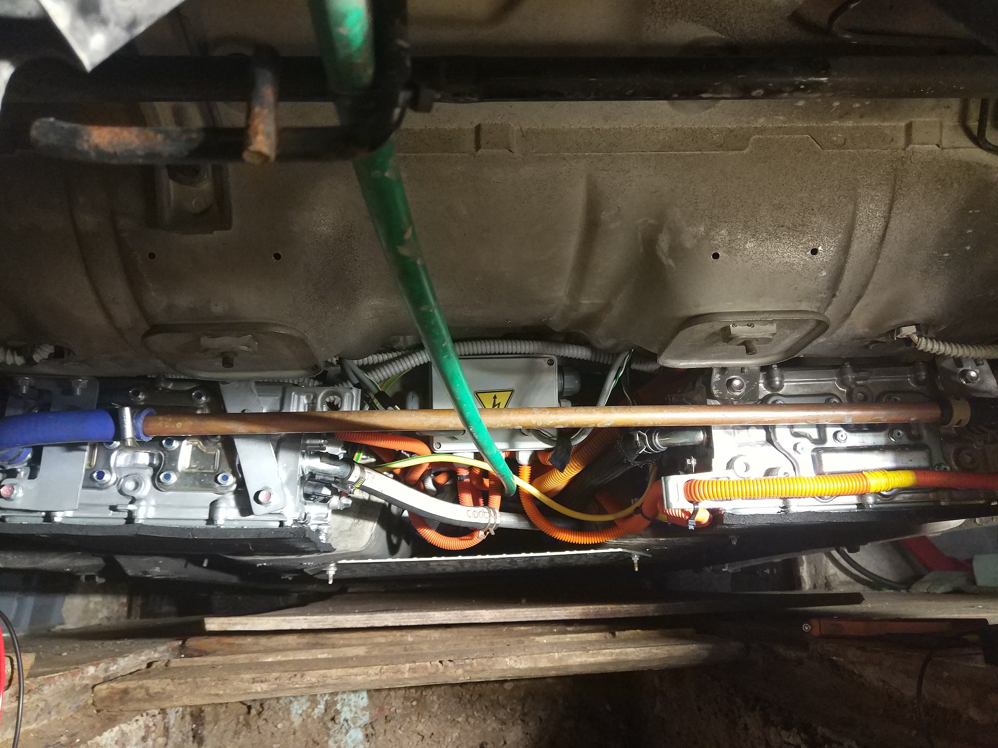

Well i have built all 3 chargers into my Pug, filled the system with water and deair it. I must say DCDC can draw about 5A from HV so i think it is capable of about 1800W. I tried to put 2 of them in parallel and connect my 12V PTC heater of 50A. There was a short drop in voltage but it returned to 13,8V immediately. I consider DCDC a very good unit.
Chargers on the other hand wont work well together. Just after i connect power they would ramp up to 21A joint current but immediately they would fall down to 10A and then try to ramp up again. It is like something wouldnt let them keep the power.
I will investigate further. I think it may be the CAN lines. I made a single line and strung connectors out from it. As i remember my own advice i may have used too long lines out of the string, which may cause all sorts of artefacts on the lines. One should never use more than couple cm of lines out from the string. I will try to shorten those lines....
EDIT: It seems i jumped the gun too soon... Current twitching from full power down to 10A was due to almost full battery. My logic board was accepting charger 0x389 ID voltage signal and reducing power down to 3A as battery reached 390Vdc. After a short but wild drive
i reduced the battery sufficiently so that all chargers were working at full power at 24A! 390Vdc x 24A = 9.3kW which is enough for comfortable every day use.
I highly recommend those charger/DCDC combo; they are quite inexpensive and multiple chargers can be controlled easily.

Now my second problem is i get 4V peak CP signal on connection. My DIY EVSE is not picky, but i guess OEM EVSE needs 6V and is waiting for connection at 4V.
I Will try to get CP signal into my DUE board and then replicate it for two chargers using 12V and couple of mosfets.
Anyone has any idea how would i replicate CP signal with Arduino? Do i just interrupt sense the PWM and use some digital pins to output the same signal to both chargers? Would that leave enough of computing power for CAN bus and other stuff on DUE?
- Posts: 1884
- Has thanked: 91 times
- Been thanked: 517 times
Ive done just that over last couple of days arber, https://github.com/jamiejones85/BigPieEVSE used pwm and an opamp to get +12v -12v signal

I figured charger works good with simple 12V square PWM signal. So i just need to send CP signal into DUE and sense the square weave to output two identical square weaves on two PWM pins. How hard can that be?
EDIT: Or i can just sense PP pin, pull CP in and just bang away with PWM analog write. Not possible to listen to EVSE changing its pace, but it will work
EDIT2: Yes, on CP pull in I simply start analogwrite() on PWM pin 2 and with 3V signal i can get the charger with mosfet module to charge at whatever i select for it as duty. Next should be to install two mosfet modules on both chargers and charge using that.
Last i will prepare CP duty reading on my DUE. This should make a fairly simple amps reduction in case EVSE changes its state.

Well, there was a fair bit of modification required. I spent a lot of time trying to get chargers to accept fake CP signal.
First of all i used some mosfet power boards. But mosfet really wouldnt do. I tried all sorts of pullups and signals etc... But then i accidentaly burned that mosfet element. What to do...? I havent had any mosfets to replace it. I took one MJD122G NPN darlington transistor that i had here and replaced the burned mosfet. To my surprise NPN module worked the first time with pullup 220R and both chargers started on my fake CP signal while DUE board was pulling the real CP signal down with 880R combined resistance. I took pin D2 which is PWM output and used analogwrite() function to create 1kHz PWM with duty as should be on CP. Of course i got inverted signal because of NPN and pullup. But all i had to do is invert my duty from 30% to 70% and i get good 30% function. I put both transistor modules down in the box with the chargers. PWM signal is fed on a single line and then transistors split the signal to each charger.
Then i closed up everything and went to test charge on one OEM EVSE to be sure.

I dont know how should i put this...
Someone gave me a DIY cable with presoldered car plug so i only added my own EVSE plug to it. But damn thing had the cable colours reversed! So instead of L1 wire i fitted N wire (by correct gray colour) into my EVSE plug and vice versa. Now i had connected live 400Vac to at least two of the chargers. As you can imagine results were... well nothing spectacular strangely?? I immediately realized something is not good and removed the plug.
But it seems my Eltek charger has died quietly!
Surprisingly both Outlander charger still work!!! I can get 17A from them...
Not that i promote that kind of abuse, but they seem to be well protected.
