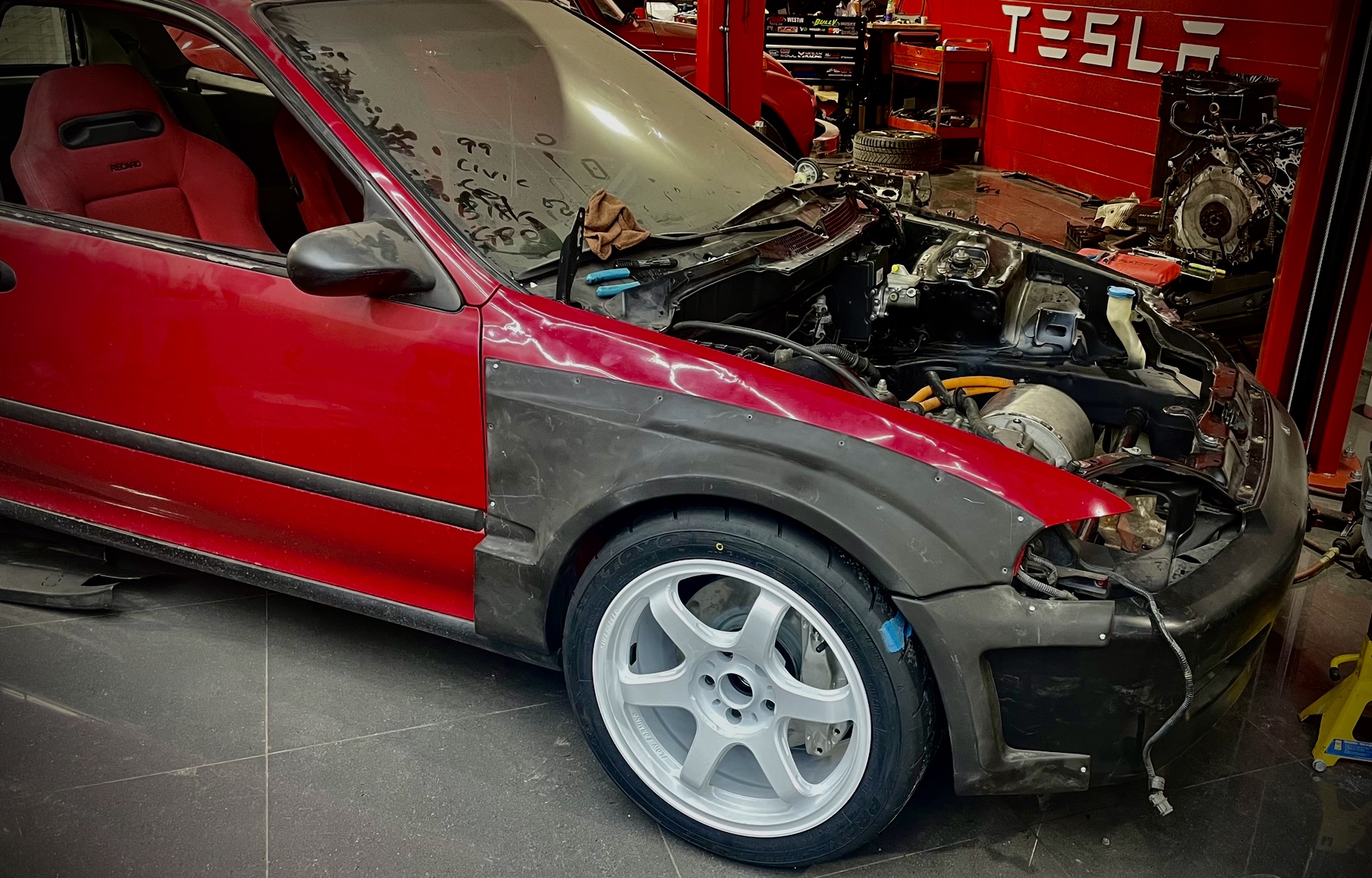

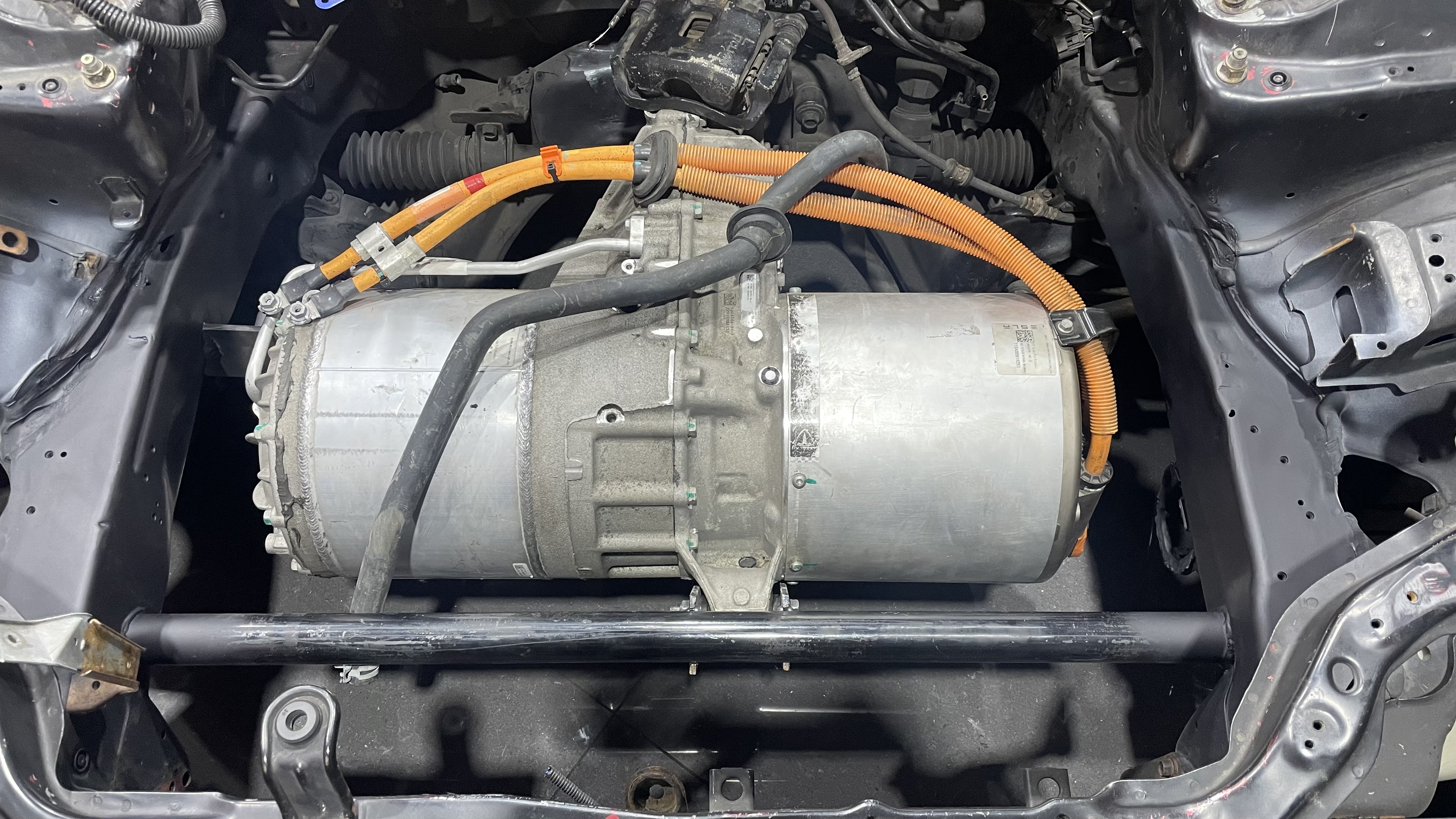

Progress update. Decided on two LDU one in front and one in the rear. Yes for now I’ll have them both turned down as pack power will be an issue
Can the new board control both motors as in rear master and front slave even though they are both LDU?

I already have two reverse rotation pumps in the drive unitsEV_Builder wrote: ↑Mon Feb 07, 2022 6:36 am Not sure if you forgot/forget but the motors have an internal oil pump which is directional...
Hope you didn't. How did you solve?
