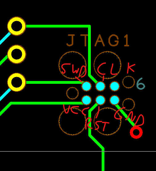

Just one little glitch, the Tag Connect is mirrored (I'd have to plug it in 180° rotated) so using the pin header for now.

I did have to manually make that footprint so I'm not exactly surprised.
Are the mounting holes reversed in relation to the pads? If so, that's a pretty easy fix, I can just reroute the traces.

Yes, the alignment holes are swapped. If the "one" hole swaps place with the "2 holes" it would be perfect. The holes are a good fit, otherwise.

I'm just now having some time to take a look at this.
I've looked at the design, the datasheets, and the fabricated boards, and the pinout looks completely correct to me.
https://www.tag-connect.com/wp-content/ ... -CTX_1.pdf contains the pinout of the 6-pin TAG connector.
1 VCC
2 SWDIO / TMS
3 nRESET
4 SWCLK / TCK
5 GND (also connected to GNDDetect)
6 SWO / TDO
Now if you take a look at the TC2030-IDC datasheet https://www.tag-connect.com/wp-content/ ... -Rev-B.pdf it shows the pin numberings. Bottom left is pin 1 (VCC) and top right is pin 6 (SWO, unused IIRC).
Comparing this to the boards as built, you can see connections that look to me to be correct.
Well damn. Looked at the PCB files and it looks like I put GND at pin 6 instead of pin 5. I will fix that and send updated Gerbers for the next runs.
SWO is ignored, correct?
-Isaac

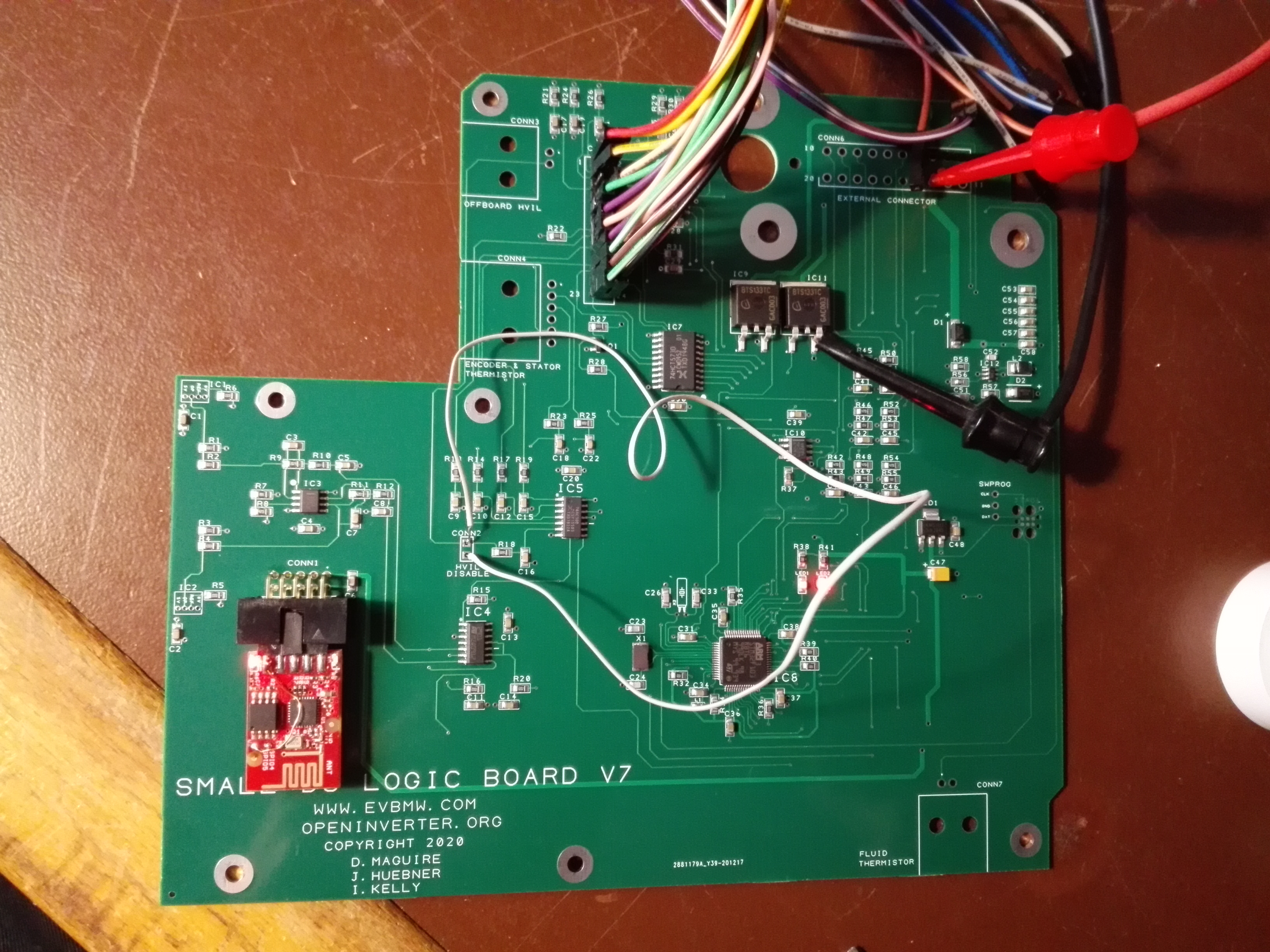

This is how it's layed out on V3 mainboard:

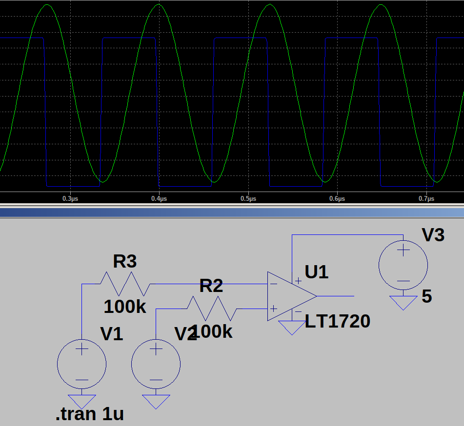

Would you be up for an LDU update? I figured out a replacement circuit for the discrete current sensor oscillator, see attachment.
The comparator of choice would be TLV3201AIDBVR in a tiny SOT-23-5 package with low propagation delay. V1 and V2 represent the two ends of the 8 MHz crystal of the STM32.

Absolutely! That looks great, it was the only real concern with doing the LDU. LCSC has 16,000 in stock, nice.
I'll probably have a first draft by Saturday or so (it's exam week for me); will begin with that exciter circuit and send to you for review as I'm not exactly experienced with HF design.

I've finished the regulator replacement and TAG6, about 2/3 done with updating footprints (haven't got the capacitors sorted). So now I'm looking at the current sensor clock system.
johu wrote: Tue Feb 23, 2021 5:44 pm V1 and V2 represent the two ends of the 8 MHz crystal of the STM32.
If you look at the PCB files, the crystal is a few inches away from the clockgen circuitry.
So there are going to be some long lines somewhere with high frequency signals on them. My gut says that isn't great.
Should I extend the crystal traces or the op-amp traces? It's got to be one or the other.
Or just add another crystal? (though it might need some sort of kickstart... not really sure how those work)
-Isaac

Oh, forgot to follow up on this. I think to not disturb the crystal it is probably best to keep the traces to the crystal short and have a longer one running from comparator to line driver. I'm thinking 8 MHz is not that high of a frequency. After all it is being transmitted via a rather lengthy cable to the current sensors.

johu wrote: Fri Mar 05, 2021 10:02 am Oh, forgot to follow up on this. I think to not disturb the crystal it is probably best to keep the traces to the crystal short and have a longer one running from comparator to line driver. I'm thinking 8 MHz is not that high of a frequency. After all it is being transmitted via a rather lengthy cable to the current sensors.
Sounds good. I'll have to make some space next to the crystal but it's a SOT23, pretty easy to fit there.
But what is the line driver? The v4a has the LTC1799 right next to the output; the clock goes straight to TP25 and the ICLK_OUT lines on the sensor harness.
Should another chip be added?

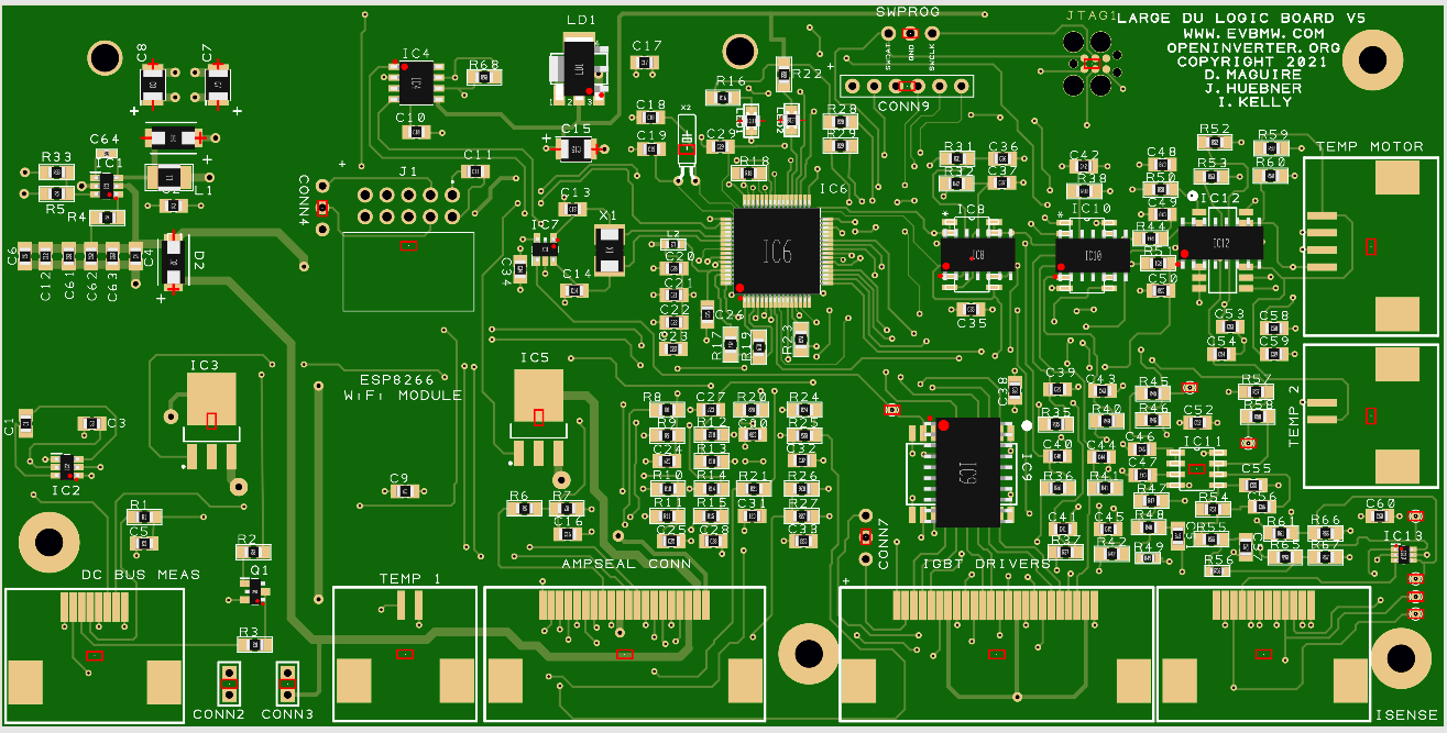

Bonus pic of the board as JLC imagines it.
