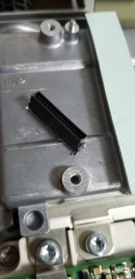

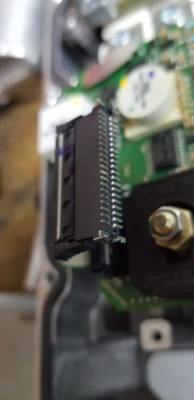

And this should be the correct header: https://www.digikey.de/product-detail/d ... ND/8537679
I think it can only be reflowed as the first pin row is obscured by the second.
The straight version could be hand-soldered, just have to check of the ribbon is long enough

Great work Johu
Yes that is the correct header mine arrived today and fits beautifully.

Re: i3 controller hacking from diyelectriccar.com
Are you sure... see my picture in the other tread https://openinverter.org/forum/downloa ... mode=view , the gate driver connector on the left (white tape and yellow paint) is almost touching the cover, for that reason I use the yellow paint to be sure the wire will not rub against the inverter cover, I was not able to put the brain on top of the gate driver (not enough space)Thanksyes, there seems to be plenty of clearance.
Sorry if some sentences make non sense... I'm French!
- Posts: 6969
- Has thanked: 455 times
- Been thanked: 1771 times
I see what you mean, the enclosure slopes downwards towards the edge.
I have a handicap here, I don't have the enclosure

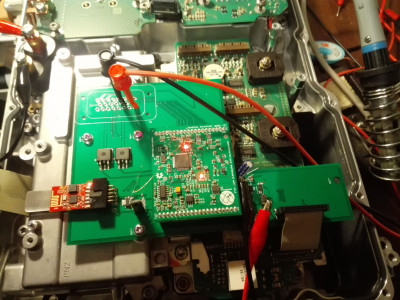

Mail from JLCPCB today
The board "in general" is working but has a few design flaws.
- The 32V boost converter overheats and cuts back seconds after the PWM becomes active. It will need more cooling and lower switching frequency. 1 Mhz is too much. That also means larger inductor.
- The communication between ESP and STM is disturbed and I cannot refresh the parameters once the PWM is running. Will need better routing and perhaps some low pass filtering.
- SPI is not working because there is a voltage divider before the digital isolator. WTF? Anyway, seems my test board with LD1117 had like 0.07V higher 3V3 level and just made it, the mini mainboard with just 3.27V doesn't make it. Will need to add a buffer. On the pic you see one from my 74 collection.

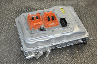

I could potentially test in Finland. I have access to a complete unit. It's not mine but I'll check if it's OK to open it.
I think I'll buy it anyway after this project is complete
golfdubcrazy
- Posts: 86
- Been thanked: 11 times
i have the complete inverter, can give it a test fit if heikki cant im in the UK if that's any easier for you.
