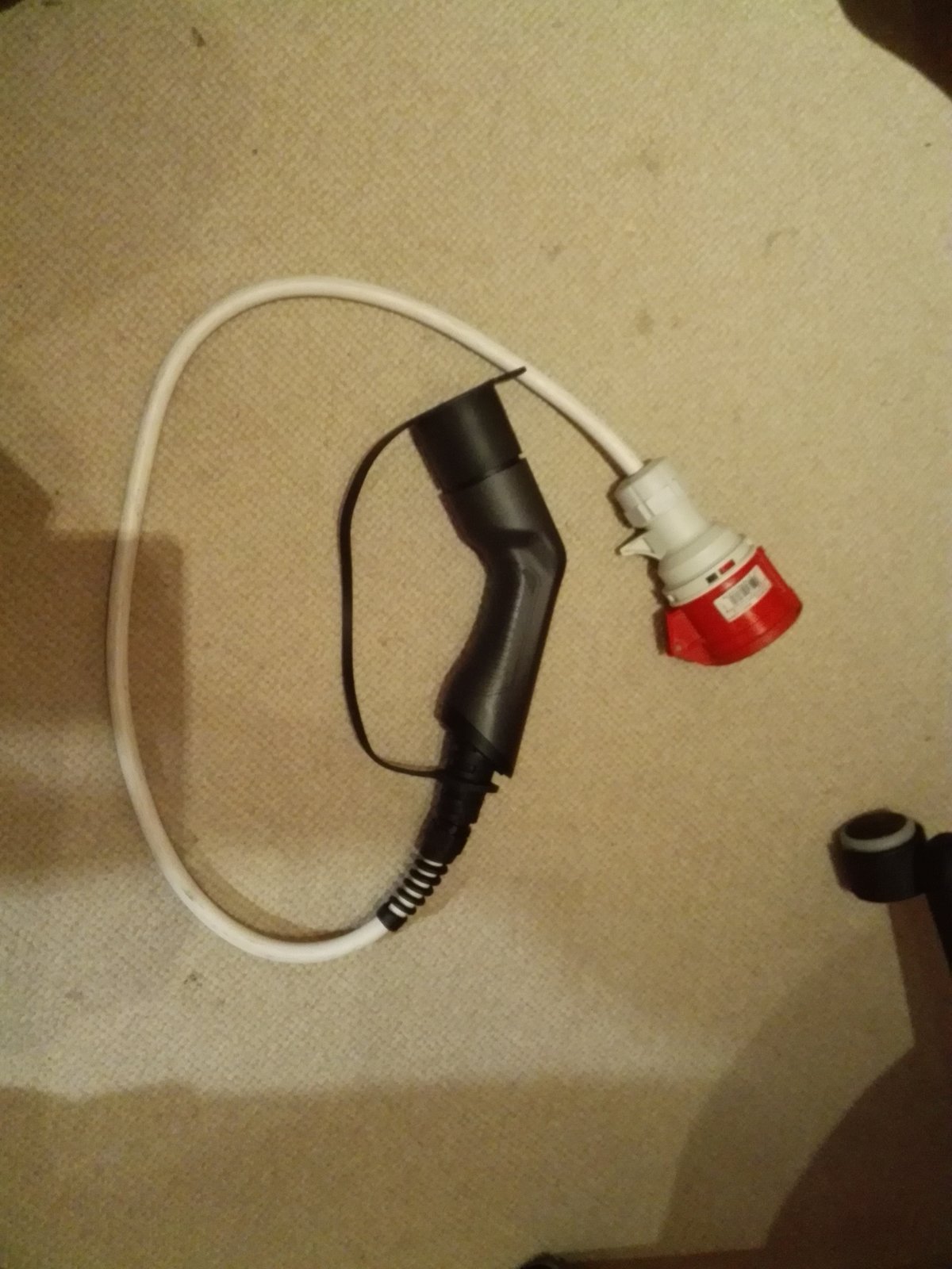

Johannes, would you share a bit more how can you charge from type2 public charger since you don't have a nissan charger on board? I know you have your own handmade charger but you are not using that with type2 only with regular 3 phase? Are you using inverter as charger? If so can this be done with Prius gen3 inverter and synchronous motor? Thank you
- Posts: 6640
- Has thanked: 347 times
- Been thanked: 1501 times
Yes, I use this adapter cable and rich mans charger
Both chargers have CHAdeMO output and thereby interface to the car.
You can build a charger from Prius inverter
Gen2: viewtopic.php?f=14&t=1070
Gen3: viewtopic.php?f=14&t=825
I wouldn't bother using the motor as an inductor with Prius convrters as they have a purpose built inductor anyway.
Whether you put it in the car or outside is a matter of taste. None of these provide galvanic isolation so at least a GFCI is a must.
I also have a Type-2 to Schuko adapter for poor mans charger.Both chargers have CHAdeMO output and thereby interface to the car.
