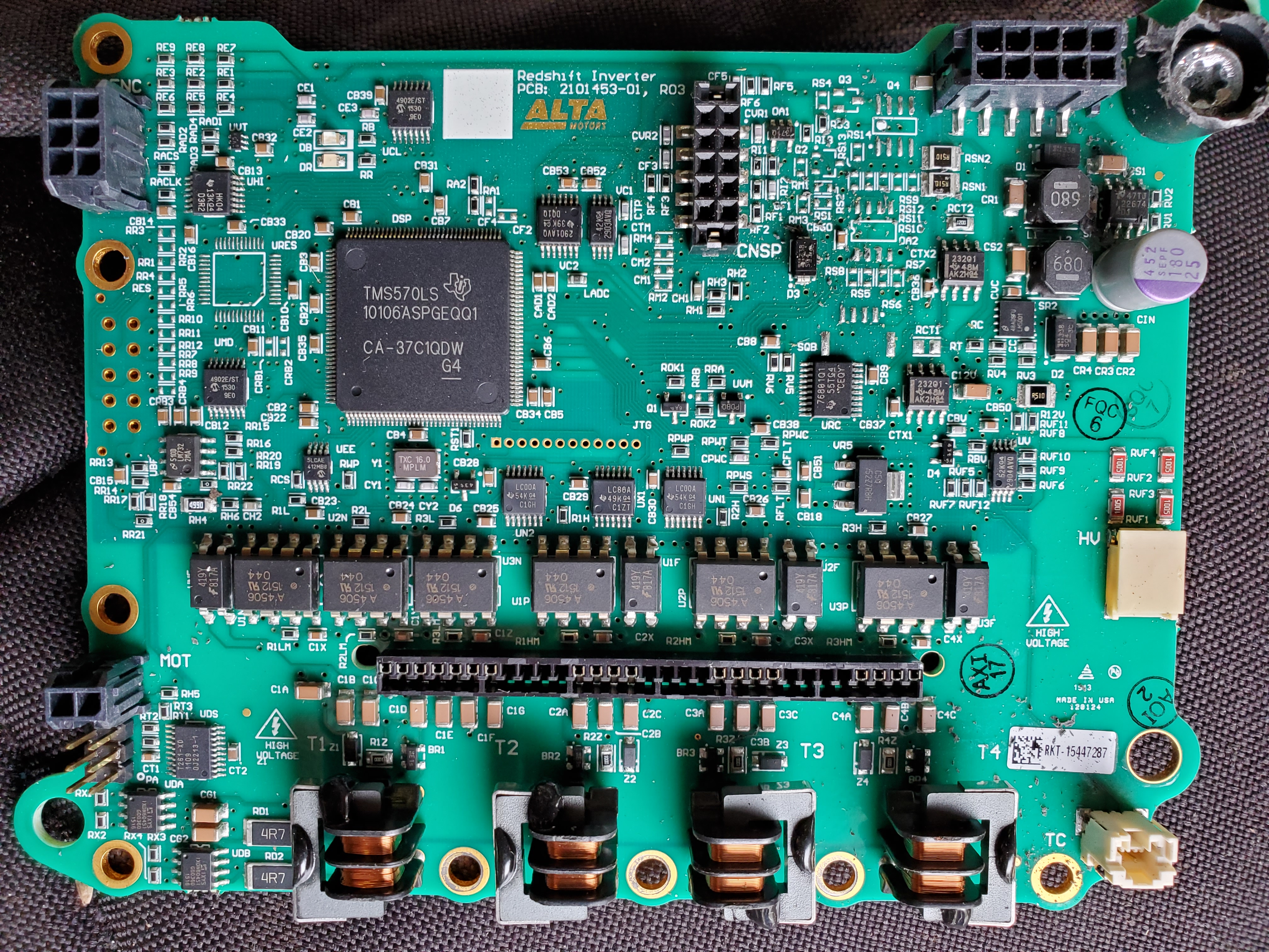

Inverter details so far: (motor and igbt brick are water cooled)
Mitsubishi 300A 600V igbts with 6 integral gate drivers?
http://www.mitsubishielectric.com/semic ... /g1_series
Inverter Microcontroller TMS570
https://www.ti.com/document-viewer/TMS5 ... PNS1412487
Melexis hall current sensor
https://www.melexis.com/en/product/MLX9 ... ent-Sensor
Throttle, not yet identified
Battery is 84S Panasonic 18650 cylindrical li ion cells. It supplies a large capacitor on top of the inverter
The system uses a canbus with nodes for inverter, accessory control module, battery, charge port module and display module. I'm told the production bikes have a second canbus from throttle to inverter but I'm not sure if the early bikes like this prototype has that.

Worst case, using the stock motor and inverter powerside, and then an openinverter controlboard, bms( maybe?) and perhaps replacement dash (if this is driven from the stock electronics) wouldn't be the end of the world.It should certainly at least run with the openinverter control board...
Re: Alta electric dirtbike OEM project
1. Current sensor
2. "Main" 12 volt, CAN1, CAN2, Throttle?
3.tiny wires and connector to battery POS and NEG
4.Temps sensor near IGBT housing
5. Temp sensor in motor
6.Encoder. I'm told it is "SPI" as the traces are marked RACLK and RACS
7.This connector sits on top of all the pins coming out of the IGBT brick. The gate drivers live inside the brick
8. JTAG holes
Some of the devices
A. microcontroller , 144 pins
B. CAN2
c. CAN1
D. Opto isolator https://docs.broadcom.com/doc/AV02-1360EN
E. I'm told these are for "desat" protection
F. I'm told these are the power supply transformers for the gate drivers
My understanding is that the Openinverter board V3 will take care of everything above the level of the optoisolators (D). I'm hoping there is a way to disable the Alta microcontroller and connect V3 board onto this board. Is there a way to connect V3 board to this oem board above the optoisolators?

Looking good!
I'd be tempted to try finding/tracing the PWM signal - the IGBT brick will take 6 lots of PWM at something like +15/-5V (depends on the IGBTs) but somewhere this will be driven by a low voltage (+3.3/0V? maybe +5V), which the openinverter board can drive. I'd start looking at D - I can't quite read the numbers on the ICs, but there are 6 of them, always a good sign! You may have to hold the main ucontroller in reset, hopefully you can find a datasheet.
Another option might be to remove the stock controller board entirely and drive the IGBT brick with the openinverter board and gate drivers?

What I'm calling the igbt brick
The linear connector towards the bottom of the inverter board sits on top of these pins.
Under the bricks cover is another board holding the gate drivers

Ahhh, even better then. The openinverter board should probably be able to drive that fairly direclty (although looks like the top board has all the power supplies etc)
Looking at the big picture for a moment, everything above the level of the row of opto-isolators is low voltage inputs and outputs that could be handled by the Johannes brain and V3 board. We would have PWM input flowing down into the igbts and feedback and error info flowing back up to the brain. Everything below the isolators is high voltage and needs to be retained or replicated as none of this stuff would be provided by the openinverter v3 kit.

From left to right they are 1Low, 2L, 3L, 1High, 2H and 3H
(these are Avago "IPM gate drive interface optocouplers"): https://docs.broadcom.com/doc/AV02-1360EN
Tracing the input circuits i find that all six are fed signals through the three small square devices located just above them. These devices are "input positive NAND gates": https://www.ti.com/lit/ds/symlink/sn74l ... poasamples
I think these are some sort of buffers that the PWM signals flow through as another layer of safety?
Working backwards from these buffers or gates I found the six specific pins on the TMS570 mcu from which the PWM signals originate

Excellent
You're doing well, it's a lot to learn all at once!
Yes, I suspect those nand gates are a form of hardware protection - it'd be quite easy to wire them up to some hw overcurrent/desat/etc output to disable PWM before the mcu even has a chance to think about it!
I would be tempted to try driving the pwm between the mcu and nand gates, this may not work as the mcu or other circuitry may inhibit. But if it does work you'll likely retain the hardware protection. Otherwise, drive after the nand gates, and tie the fault line to the 'desat' input on the mainboard (next best option)
Remember that both these options may be likely to upset the mcu - this may just set some fault flags you can ignore, or it may disable PWM overriding your inputs. Even best case, you may find that the mcu sends messages that other systems (dash, bms etc) rely on so these may not work. If the mcu stops PWM working, you could try holding in in reset (find the reset pin, tie it to ground usually).

I'm working under the premise that the OEM mcu is hopelessly locked up. My jtag hacker friend explained that we dont have the proprietary bootloader to do anything with the mcu. I'm not too upset about losing the other systems like the display/dash and the accessory control module.
If I can get the motor spinning (looks promising!) with openinverter, then the next task would be to try and get the BMS and charger to cooperate. I'll have to learn about can sniffing and deciphering for that crucial job. Luckily, I have a second working bike, a working battery and a CAN adapter.
You wrote "Otherwise, drive after the nand gates, and tie the fault line to the 'desat' input on the mainboard (next best option)" This is the strategy that I can mostly comprehend right now. This would entail plugging wires into the openinverter board header and soldering the ends onto the pads of the optocouplers on the Alta board? (The gate driver boards supplied with the V3 kit would then not be needed)
If I have this right, I suppose its time to place an order...

Sounds good to me! Hopefully BMS will be fairly simple (can always bypass it just to get HV...), charger might be more tricky, but yes, if you have a second working bike to sniff CAN from you're in a pretty good position
Yup, you've got all the gate drivers etc you need right there in the stock inverter, one would assume they're designed to drive the powerstage properly, so makes sense to use them
I reckon just a rev3 mainboard and you'll be pretty set
