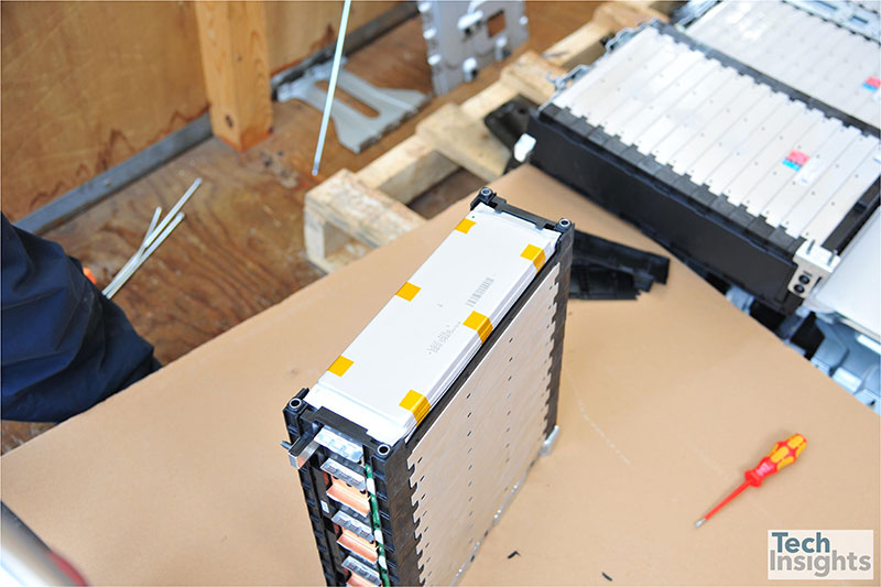

Here is what I found out about the various Leaf packs:
- 24 kWh: 48 modules 2P2S 7.2V
- 30 kWh: 24 modules 2P4S 14.4V
- 40 kWh: 24 modules 2P4S 14.4V (Up to here 192 cells total)
- 62 kWh: 24 modules 3P4S 14.4V (288 cells total)
Apparently the 30 and 40 kWh packs are more or less a drop-in replacement as I installed the packs in two equal sized rows. In summer conditions a 75% charged 24 kWh pack gives me about 80km of highway range. A 40 kWh pack would give me 130 km.
The 62 kWh pack would take up more space, I would probably only fit 16 modules under the car and would have to find space for the extra 8 ones.

I would hazard a guess that Kona and Bolt have practicaly the same 60Ah LG cell as Jaguar IPACE.clanger9 wrote: ↑Mon Dec 07, 2020 4:51 pm I started to compile a list of OEM battery modules on the wiki: https://openinverter.org/wiki/Batteries#OEM_modules
Hopefully useful. If you find any more details, please add them...![]()
In Kona it is NCM622 chemistry configured as 96S3P. https://www.speakev.com/threads/kona-ba ... ec.110601/ In Chevy Bolt there are 96S3P also NMC 622. https://www.techinsights.com/blog/revie ... powertrain
I dont know if this article is assumption or fact https://electricrevs.com/2018/03/09/jag ... in-common/
