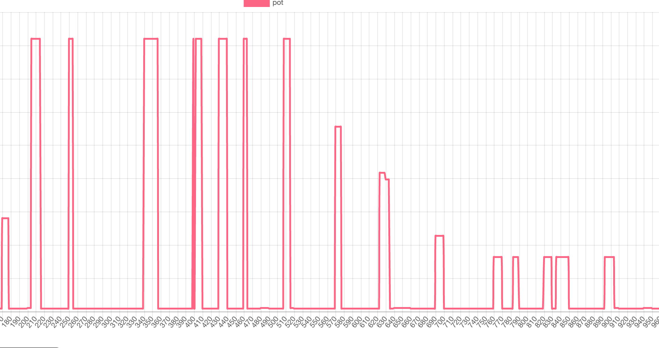

Pot Plot from VCU:
Savvycan says:
Average inter-frame interval: 46.758ms
Minimum inter-frame interval: 9.966ms
Maximum inter-frame interval: 4.29496e+06ms
Any ideas/suggestions?
Pot plot from Inverter
Still think I'm having can bus issues, it's set to 10ms in the VCU.Savvycan says:

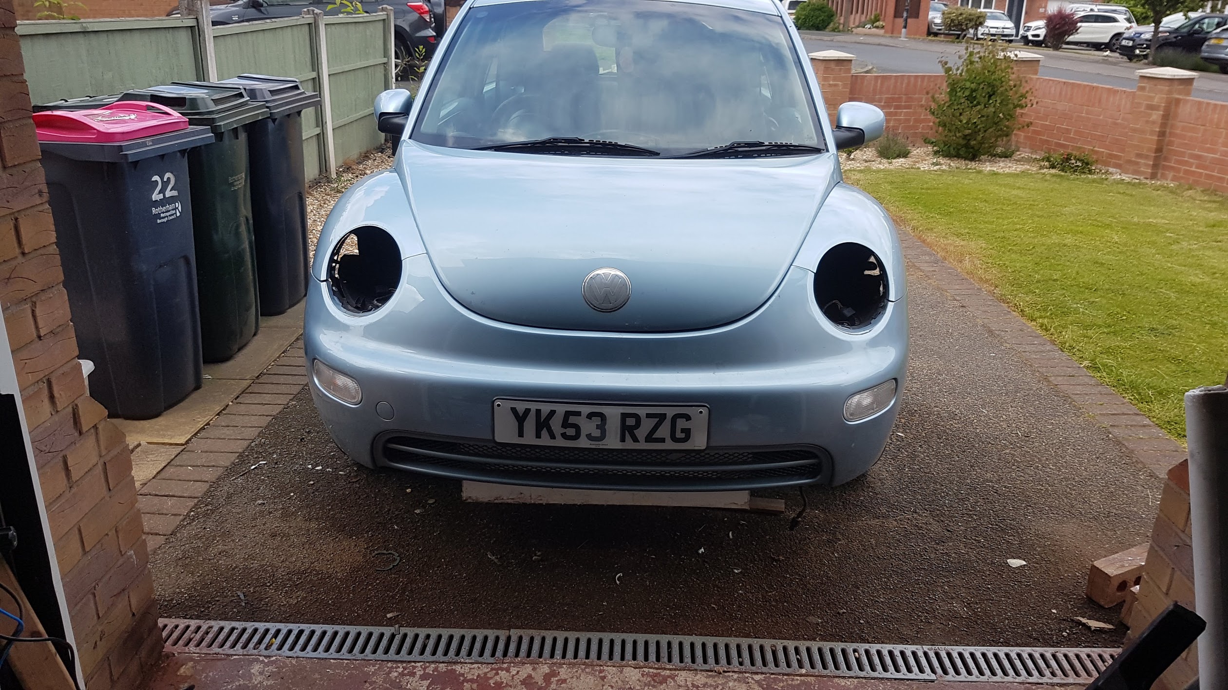

And we're rolling.

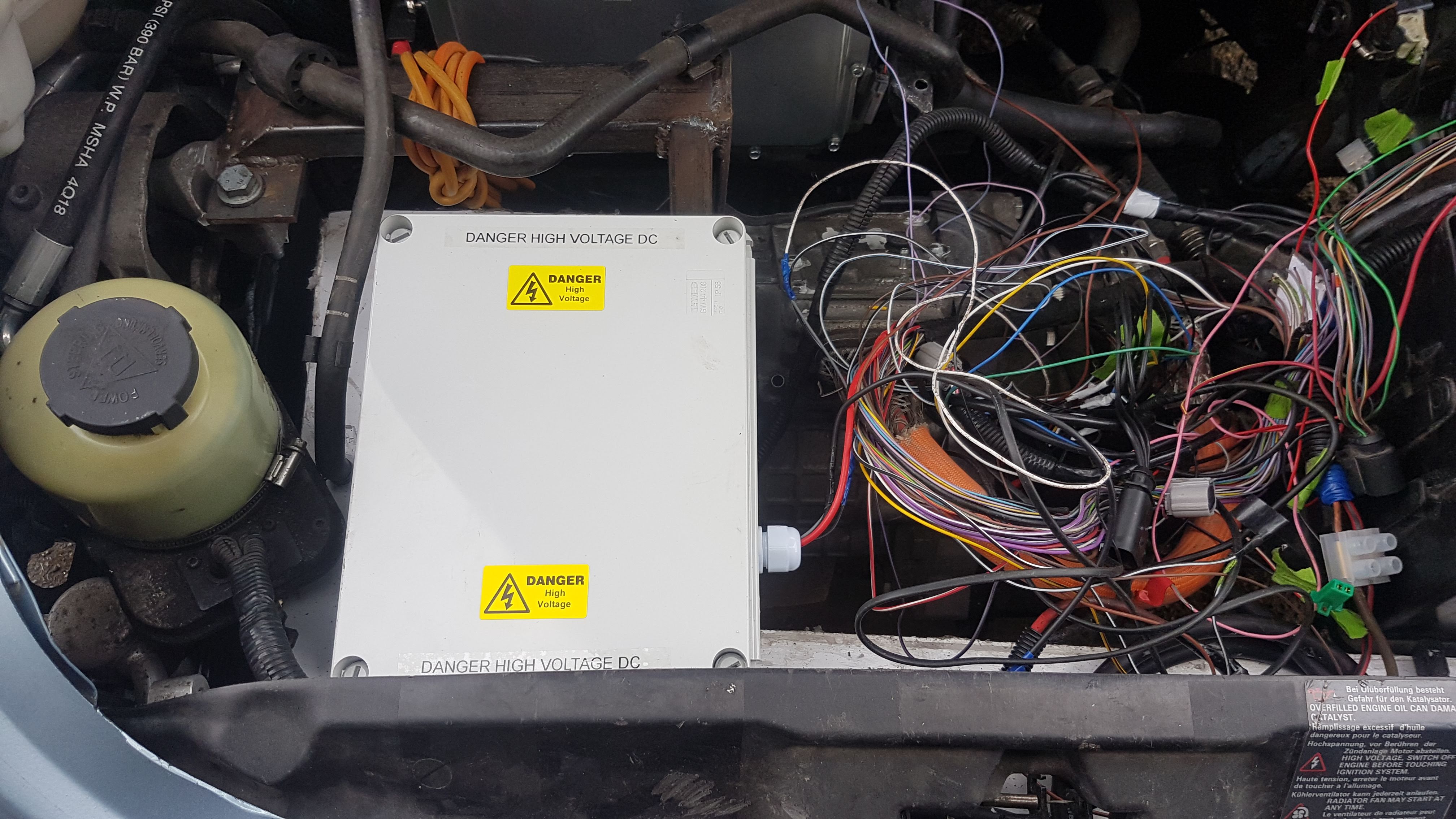

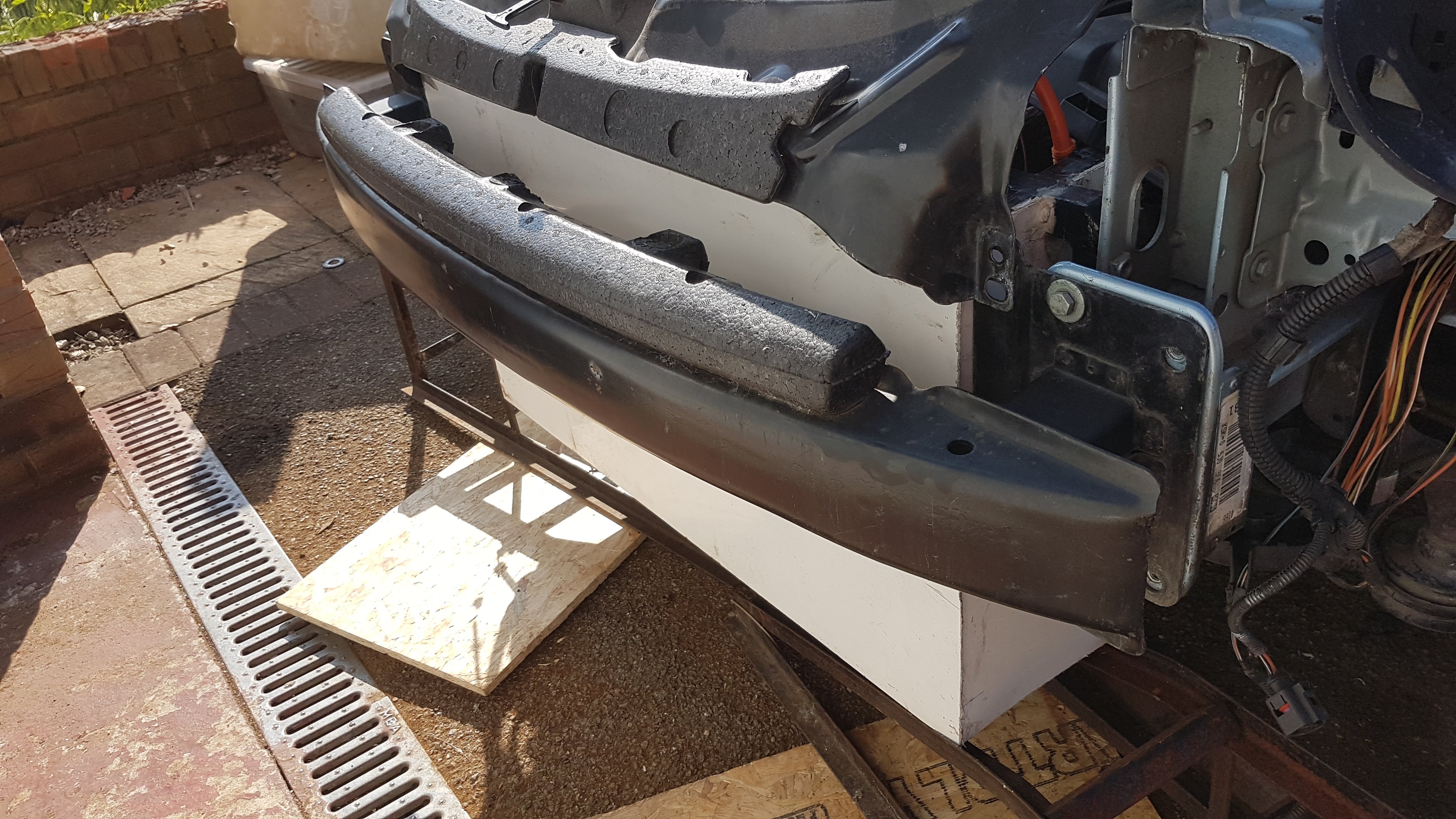

After a couple of goes at a battery box, first time with a steal frame and fibre glass, I've now got the box built, with PVC sheets sealing it.
The front end is reassembled with the box in place. I've decided to have the contactors and fuse outside of the battery box.
Few more little jobs to do, cooling loop and a couple more brackets to make up, tidy some of the wiring etc.
I hope to add a second GTE pack at some point, so will likely look at getting the battery modules repositioned in the future, but just want to get something usable as soon as possible now.

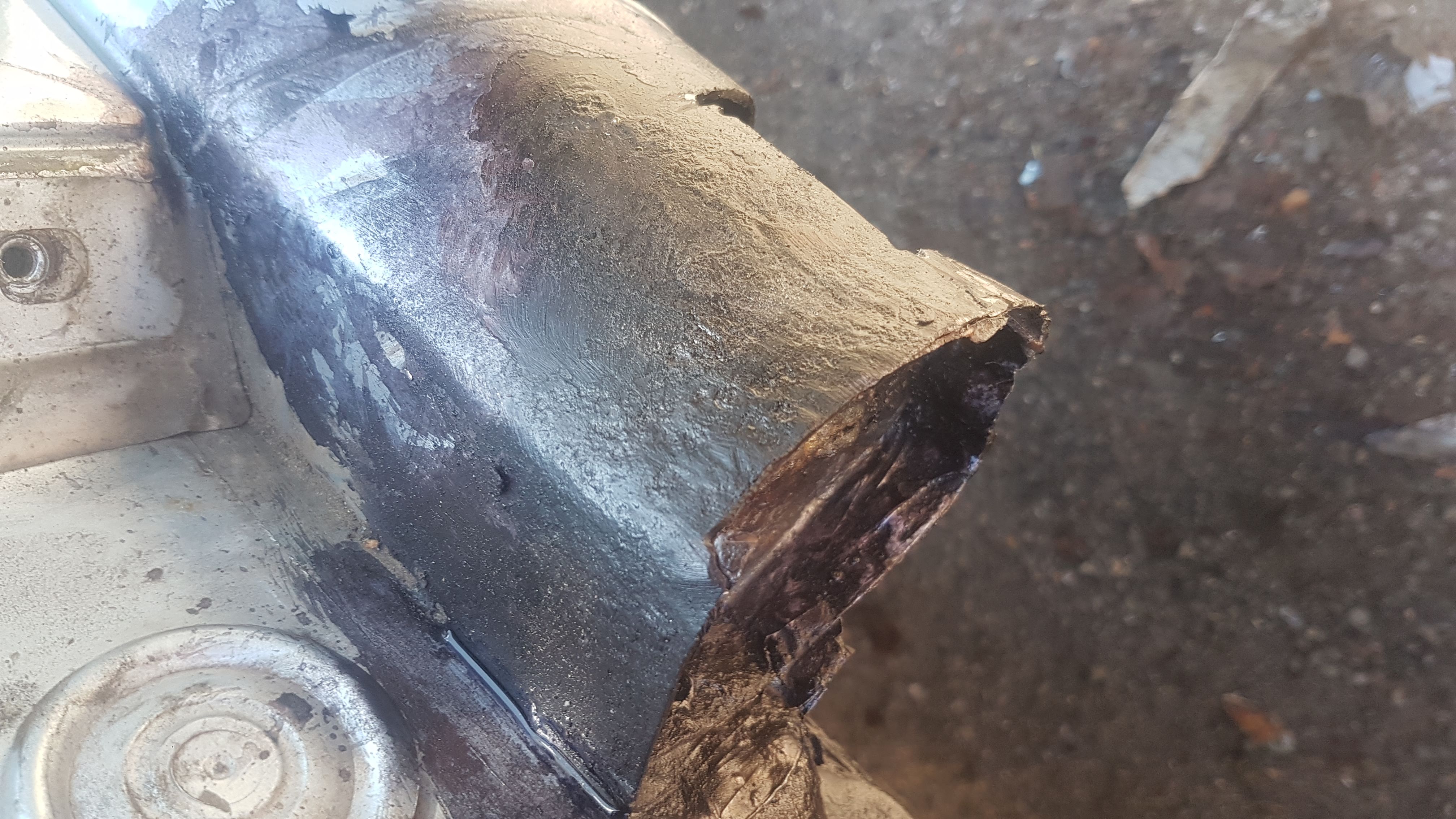

I checked the MOT history and just before I bought the car it failed:
"Rear Brakes imbalanced across an axle Axle 2 (1.2.1 (b) (i))"
"Offside Rear Service brake excessively binding (1.2.1 (f))"
So I'm awaiting new pads and discs to be delivered, hopefully that and cleaning up some corrosion on the calipers will sort that. While there, I noticed some corrosion around that also needs addressing and a patch welding in on the sill.
