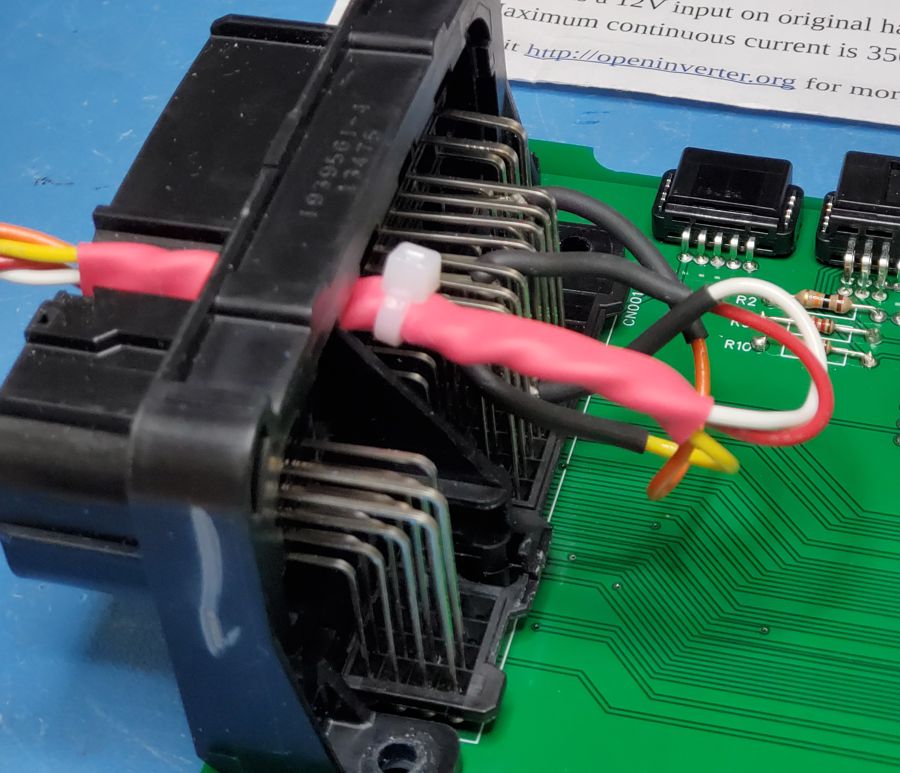

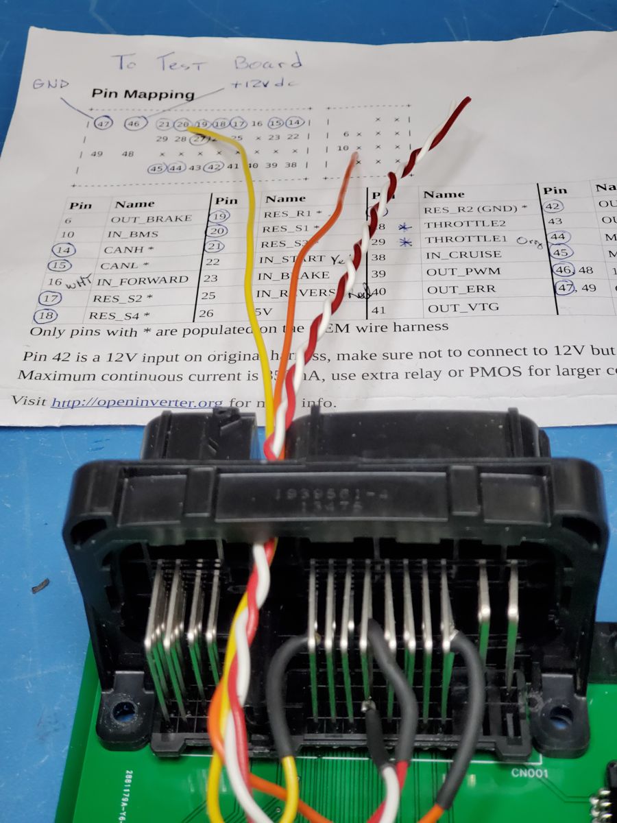

Johannus, I am still working on my MGB Conversion, and to add connections that are not in the Leafs wire harness connector to the Invertor, I have done the following:
Here I have wired to the back side of the connector red to pin 25 in_reverse, white to pin 16 in_forward, Yellow to pin 22 in_start and orange to pin 29 throttle1.
I took this tack because disassembling the plug and finding the right pins and not destroying the plug seemed daunting to me. This seemed easier to me. I drilled a 1/4" hole to the side and between the top and bottom sections of the plug receptacle.
I had thought about trying to solder to a via but I am not that skilled nor did I trust I could do it a) into the correct via and b) I was worried about destroying the trace.
What occurred to me later was I wish there was a connector on the adapter board to make the pins available to attach the wires to. I realize a revision to the adapter board would be required. It's just an idea for the future (if it's a good one as I am not an EE).
