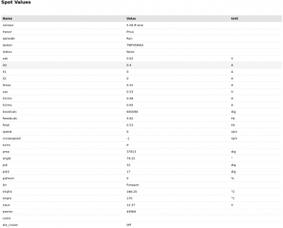

I have a prius gen 2 board wired up and ready for a test on real hardware (inverter).
Before doing that I want to verify that everything is working correctly.
I have it on the bench, powered with a 12V PSU. See parameters attached. I can start the inverter in manual mode, however get opmode returns 1 and in the Spot Values I can see opmode is run and not manual run.
I probed all pins of the 12pin connector, and none have a PWM signal.
Is there anything I am missing?

20pin connector only has +12 and GND connected, I can see that my opmode switches to RUN when touching +12 to the start pin.
I'm getting the following error msg:
[97950]: DERATE - TMPHSMAX
thmphsmax is already maxed out to 150°C , but tmphs is at 166.28°C

Post by kon »
Got around the tmphsmax by hard coding it to a random value within limits and recompiling the FW.
I still can't start the inverter in manual mode.
error memory shows
STOP - DESAT
I can get opmode to 1.0 by holding start pin high, but still no PWM out. Starting inverter in manual mode won't change opmode (stays 0)

Have you connected ALL inverter pins on the 12 pin connector? That will give you a valid temperature and remove the DESAT error

This test was board only (no inverter connected). I wanted to verify the output on the bench first, before connecting it to the inverter.
I was hoping that there is a way of testing outputs without inverter, but I guess it's easier to test with the board connected to the inverter ...
Been thanked: 1914 times
Re: Prius Gen2 bench test
oh ok. Well then connect a the desat input (MFIV) to 6V or more.
