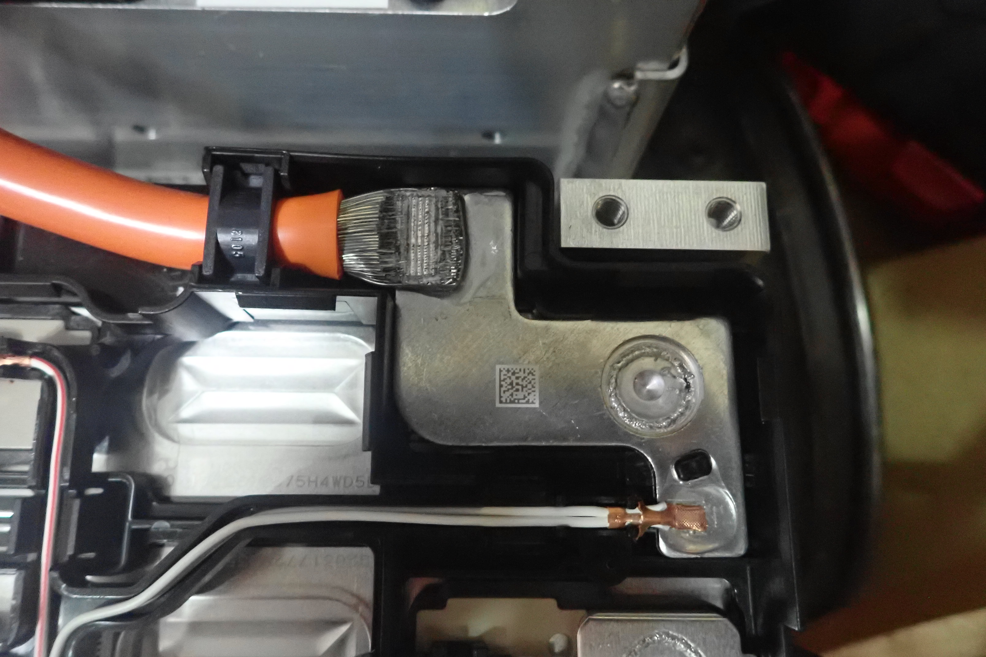

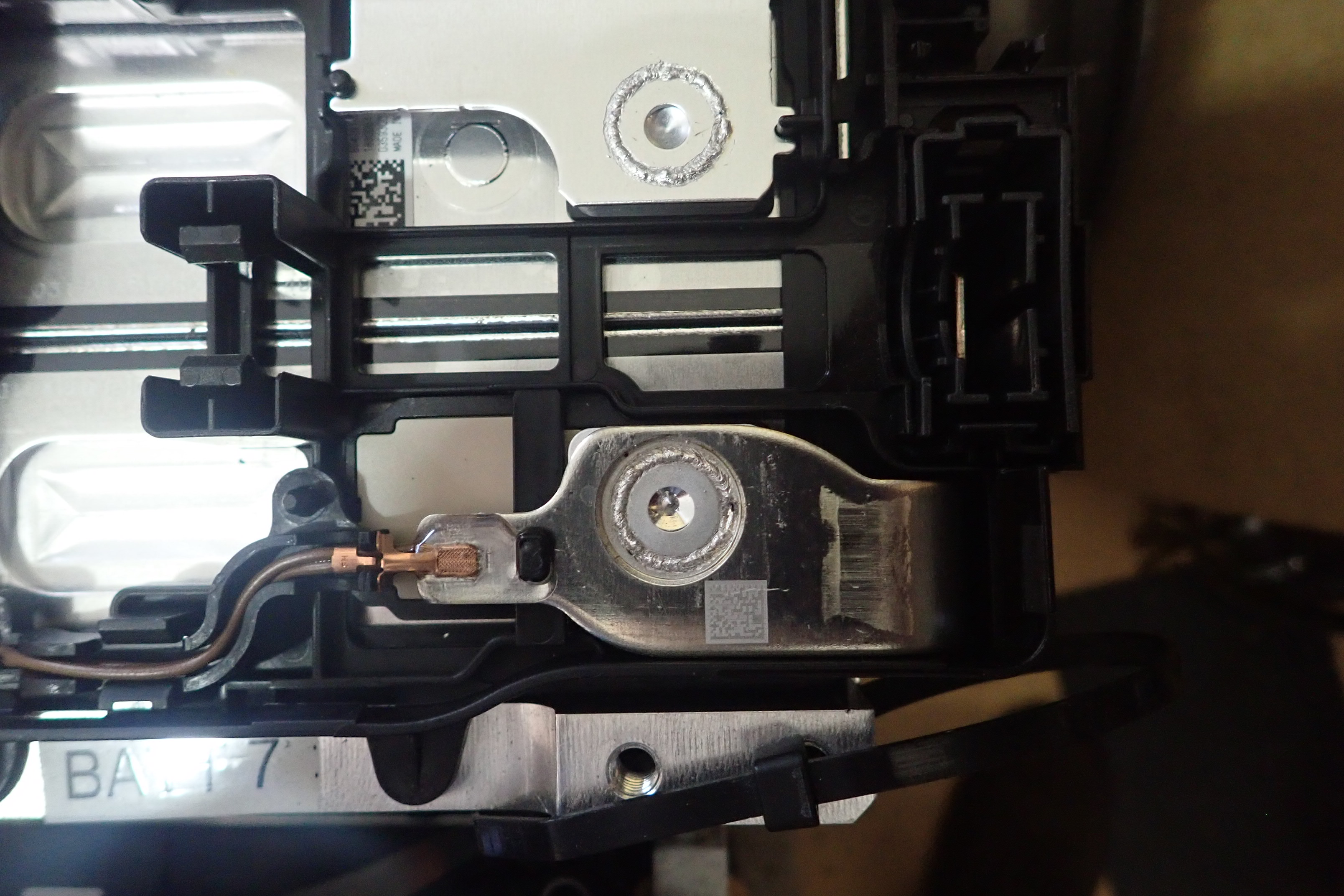

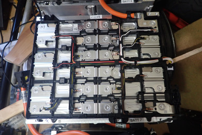

At some point I'm going to have to alter the aluminium cables on the BMW i3 battery modules to allow them to be connected together in the new pack orientation and to the inverter etc. Not only are the cables aluminium but the bus-bars coming off the battery terminals are aluminium and are laser welded to the battery terminal.
The main difficulty I see the dissimilar metal reaction between Copper and Aluminium when joined which with the slightest moisture will be an intermetallic nightmare. Also the practical process of joining two aluminium cables with good electrical integrity is a bit of a mystery to me.
I've no experience working with aluminium cables let alone large high power power ones like this so an after any experience or workarounds for this problem.
Some photos of the battery terminals and bus bars.
Anyone joined Aluminium cables to Copper cables?

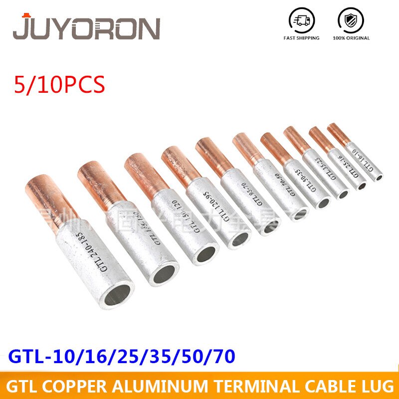

Hi. I am using i3 batteries for my conversion aswell. I am using the juyron al-cu connectors. Beware that their 50-50 mm2 connector is 50mm2 on the Al side but tighter on the Cu side. I had to drill the copper side out slightly to fit a 50mm2 copper cable. This is because the current carrying capacity is better on the Cu side and the expected application is to use a thinner Cu cable for the given Al size cable. I wanted to use 50mm2 copper anyway for my longer cable runs.Mouse wrote: ↑Sun Oct 25, 2020 9:59 pmAgreed, this is my main concern.
Water ingress is one of my major concerns for the whole project.
I've seen some sort of aluminium specific rust inhibitor goop especially for electrical connections on the internet. But I lost the link and will have to re-find it.
Aliexpress to the rescue.
It would appear they do a whole range of different Aluminium:Copper connectors available. The two sides are proportioned for the same current capacity in the different metals.
https://www.aliexpress.com/item/4000879274215.html
GTL-16-GTL-25-GTL-35-GTL-10-Compression-Copper-Aluminum-CU-AL-Tube-Bimetallic-Crimp.jpg_Q90.jpg
I tried to get hold of the elpress connectors but they and their distributors wouldn't sell to private customers, only to registered companies. So, as you say, AliExpress to the rescue
