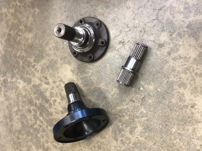

Yep the mini installation is mine, the motor is effectively upside down, it spins quite happily like this, no nasty noises from the reduction gear / diff.
Not sure how it will affect cooling etc in the longer term, but it seems happy.
Finished making the shafts last night so the real drive tests will start soon!

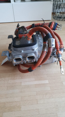

Unfortunately I'm not near the inverter by myself, so i thought some here will know:
What is supposed to be on these holes?
Thanks, Philip
Thanks, Philip

I think it's the charger&dcdc
Or it least it looks like the dcdc/charger would fit based on the charger I have

Yes 1 is for charger / dc-dc.
I can't remember what the other is for on Outlander, I use it for my heater.

The other is for the heater.
The 40 amp fuse is heater I believe.

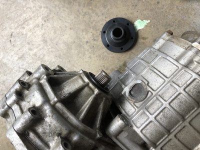

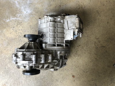

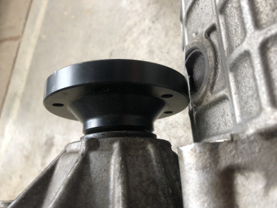

with some minor shaving of the plugged coolant port on the motor, type 2 (100mm) cv flanges fit nicely
Type 1 (90mm) (vw beetle) fit great as-is.
108mm or 930 flanges should fit, but with a lot more shaving of the motor case.

Just wondering is there some standard for distance between flanges/stubs? If replacing VW transmission model XYZ with mitsubishi rear diff with these stubs, will original drive shafts fit lengthwise?
