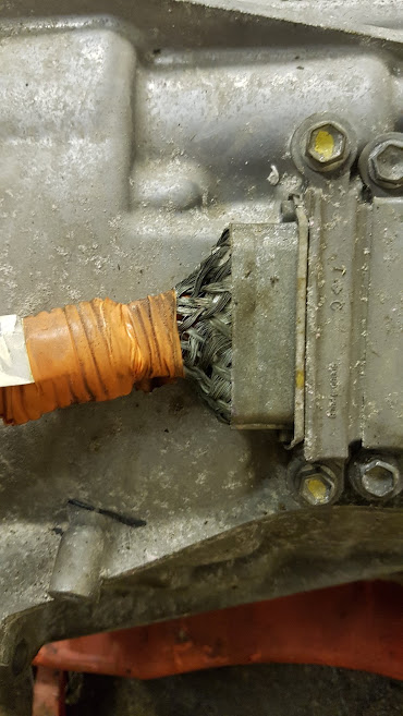

Hi, I've got my GS450h motor/transmission out of the car now and have been checking it over.

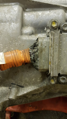

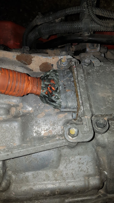

The braiding around the HV cables as it goes into the connector on the box looks a bit strange to me being exposed to the elements and ratty. Is this how they are suppposed to be/look? -

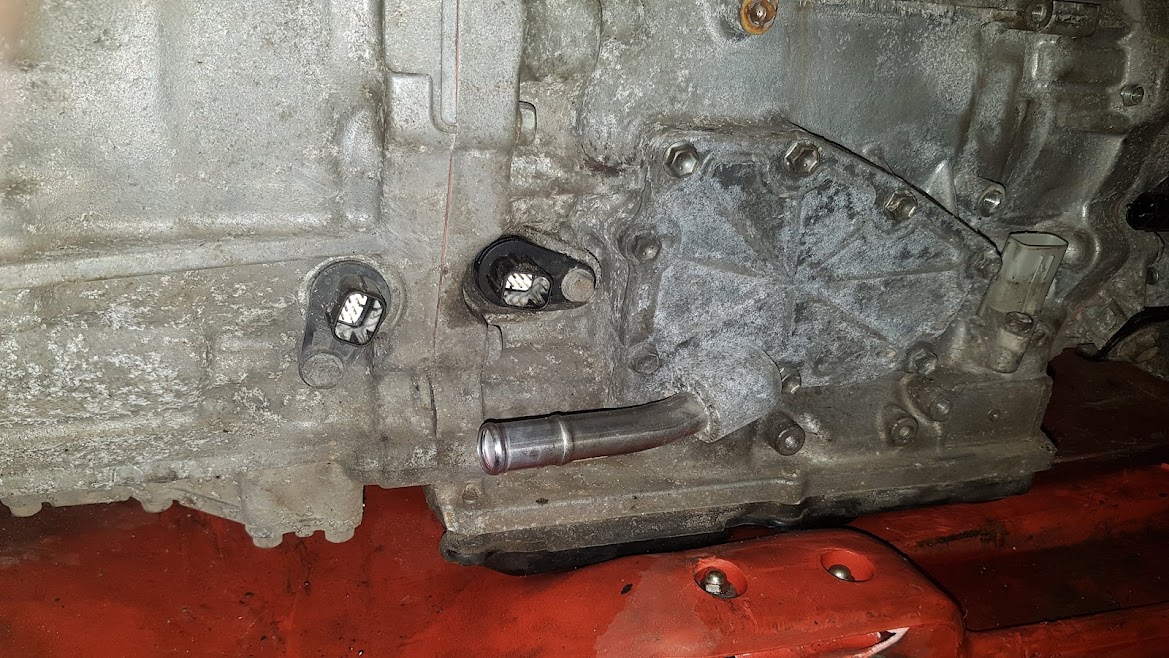

Also, can somebody tell me the purpose of these two connectors? - They seem to be a gland seal with connectors on the inside of the box, one of them got a little damaged when removing the box/harness, so I want to understand what they are and if they're important.

It's regular shielding. All good.
MG1 & MG2 Resolver Connectors on your photo.
https://openinverter.org/wiki/Lexus_GS450h_Inverter

Ah ok they're important then, I might need to buy some new harness connectors for then then, but I'll leave the HV harness alone
Thanks for the advice
