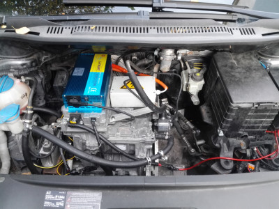

Got the heater bolted to the transmission today, now I'm just lacking an expansion bottle.
Wired up a bespoke output of the VCU that powers up the Chinese inverters control electronics and thereby enables the heater (or whatever is plugged into the outlet).
I programmed the VCU with a simple On/Off parameter that enables and disables the inverter and also added some extra logic:
- Only start inverter when handbrake is OFF (see below), DC switch is on, outside temperature is below a given threshold and battery SoC is above another threshold
- Also start inverter when DC switch is on and "Force On" is selected
I'm switching it off when the hand brake comes on because likely you will turn off the car when putting on the handbrake and thereby I avoid interrupting current with the main relays.
I also need to find out whether the inverter overheats during standstill, I'm only running the fan at 5V.
Somebody asked why I need AC to run the heater. There are 2 reasons: the integrated thermo switch is not DC rated and the integrated pump is run by an AC motor

Used the heater when driving 10 km near freezing temps. Turns out the Chinese inverter overheats. Smells like chokes.

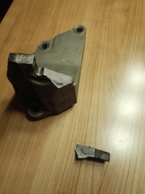

Testing day today
I tested the modified FW controller all day with not too promising results which means a lot of vibration. So eventually I decided to rather spend time tuning the current FW controller. I did all this is second gear in order to build up revs but not too much speed. Of course that also means more wheel torque.
Now while I was at it I chased another bug that I think is connected to the DC current regen controller. When it hits the limit it gives a really hard bang. That's already disturbing in 3rd gear, guess how much more disturbing it is in 2nd.
So I stopped, adjusted some parameters and took off to try again. But wait, whats that growling noise when accelerating? I pulled over into a side road and as I turned the steering wheel to go back home a nasty sound of something locking up (or so) emerged from the passenger side (right side that is in Germany). Ok, driveshaft snapped or something I though. Since it was quite dark I decided to walk home like 1 km and then return with my other car, tools and a headlight.
Alright, back at the spot I open the hood and find the motor hanging down deeply only supported by the two remaining transmission mounting and maybe the aero plastic. The Nissan motor mount had sheered off. Sheeet. Think!
Now the next part is a bit superstitious. Just last week I did a clean out where I go through all my stuff and throw out everything I consider useless. I also found my second Leaf motor mount, twisted it in my hand and was about to take it out for the salvager. But then I though, na, lets keep it, who knows... Maybe we can uncontinuously look into the future or it was just a rotten bit of luck.
I thought of all that while looking at my snapped motor mount. Next I took my cheesy jack and lifted the motor back up. Then I unmounted the motor mount, took it back home, swapped the Nissan bracket, drove back down, put it back in. I think I earned some street cred with that.

download/file.php?id=469&mode=view
It looks like your mount has too much leverage on that piece. Add some support from the mount to the top of the inverter to avoid bending it.

Yes, that could be true. Already thought about throwing out the VW motor mount and replace it by a rubber mount and a Z-profile. Anyway, support could just be a relatively small alu profile from the inverter to the mount, right?

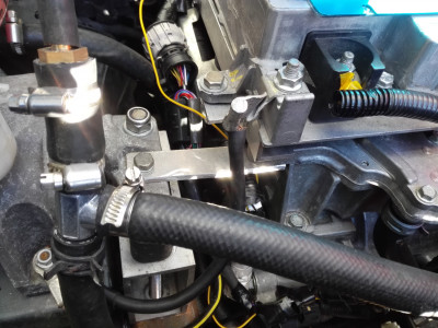

Based on the photo I would cut and drill a stiff piece of steel or aluminium (let's say at least 2mm or 3mm thick, respectively, but even a thinner piece would definitely be significantly better than nothing) that connects the two bolts on top of the mount to the three PDM mounting holes on the inverter. They look to be about level from each other.
- Posts: 6769
- Has thanked: 383 times
- Been thanked: 1589 times
How about that? Not going through all 3 holes but then the holes are connected on top by the DC-DC carrier.celeron55 wrote: ↑Fri Oct 22, 2021 5:51 pm Based on the photo I would cut and drill a stiff piece of steel or aluminium (let's say at least 2mm or 3mm thick, respectively, but even a thinner piece would definitely be significantly better than nothing) that connects the two bolts on top of the mount to the three PDM mounting holes on the inverter. They look to be about level from each other.

90degree L Chanel would stiffen that up.
Still quite a bit of leverage looks like, but better than nothing
- Posts: 6769
True, the L would clear inverter well. I have some 3mm and 5mm L profiles here.

I have a weird setup. The transmission is in a classic rubber bushing so it can only move that far. The motor mount rests on rubber but can swing freely. And then there's the torque arm that should take most load on accelerating and regen.
- celeron55
- Posts: 804
- Has thanked: 38 times
- Been thanked: 136 times
I wouldn't settle with that. I think it should provide support also in the front-back axis of the vehicle. Nevertheless it is an improvement, maybe it's enough.
