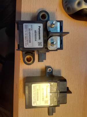

Ok, the Chinese inverter finally gave up. Probably the inductor shorted out because all the enamel is gone and then the transistor blew. As a "nice" little side effect that took out my little DC-DC converter that delivers logic supply and that then took out my entire ULN2003 array, shorting all channels to GND. Guess what happened to the positive contactor upon next power-on? Yes it switched on without precharging and is now welded.
Also my vacuum pump never turned on, that has one inversion stage after the ULN. So had to drive home 40 km with brute force braking :roll:
As another little bonus I now know what an AC rated fuse looks like when it interrupts DC: it melts the fuse holder and spreads little glass and metal balls all over the place.
Does anyone have those Panasonic Nissan Leaf contactors collecting dust?

Boxster EV wrote: Fri Nov 12, 2021 8:49 am Any good?
Thanks but wrong form factor, they seem to mount standing up

I have these two spare. Pulled from a BMW s-box. They’re yours if you want them.
Posts: 6969
Has thanked: 455 times
Been thanked: 1771 times
chrskly wrote: Sat Nov 13, 2021 10:45 am I have these two spare. Pulled from a BMW s-box. They’re yours if you want them.
That comes closer, worth a try

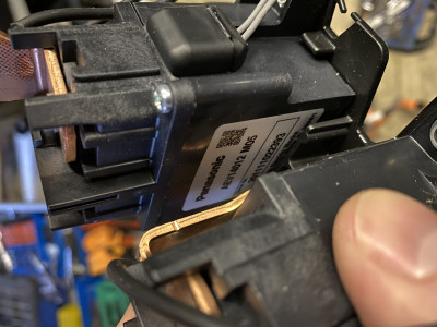

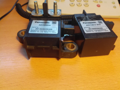

I just received the AEV14012 contactors from chrskly today (thanks very much :) ). It largely seems to be the same design. The mounting holes are smaller but at the same location. The connector for the coil is identical. The resistance is a bit less, 25 vs. 31 ohms.
Unfortunately it doesn't click right into Nissans assembly because the back side is all flat. Also the front bracket of the "Nissan" variant is designed to hold a 90° busbar, but that could also be fitted to the 14012 just with less plastic support.
Now that I found I can just hit these things with a hammer I might resort to that for now.

Apparently, yes. Infinite resistance when coil not powered, no resistance when powered. Remains the question whether the contact area is diminished by the welding causing excess heat losses.

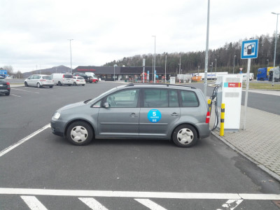

Some combined GT86 and Touran action this week. I drove to Zapatero in Ulm (400km away) on Sunday night. Again, the trip didn't go quite as planned. Driving was all smooth but as always, charging was not:
1st stop: couldn't even grab the CHAdeMO connector, it was locked in the EVSE. Some high power charge was seemingly available but it turned out it couldn't serve CHAdeMO and CCS at the same time. Thought only triple chargers had that limitation. So I drove on to the
2nd stop: all good, charged to 90% as I did a phone call while charging
3rd stop: used the time for some lunch, perfect!
4th stop: charging didn't start. Called support, but all they ever do is reboot the charger. Which didn't cure anything. So support rebooted it again which resulted in the screen turning black permanently. Bugger it, still had 25% left, so drove to the next town and charged one hour on an AC EVSE with Prius charger. Popped the overload protection a few times while searching for peak power but was always able to restart

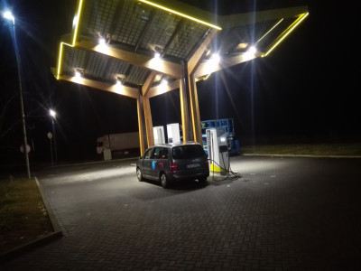

6th stop: Another Fastned, worked flawlessly
I no longer try to deplete the battery as much as possible, because a) you get stranded very quickly b) prolonged charging at 50 kW heats it up so much that you get reduced speed at the next stop anyway.
