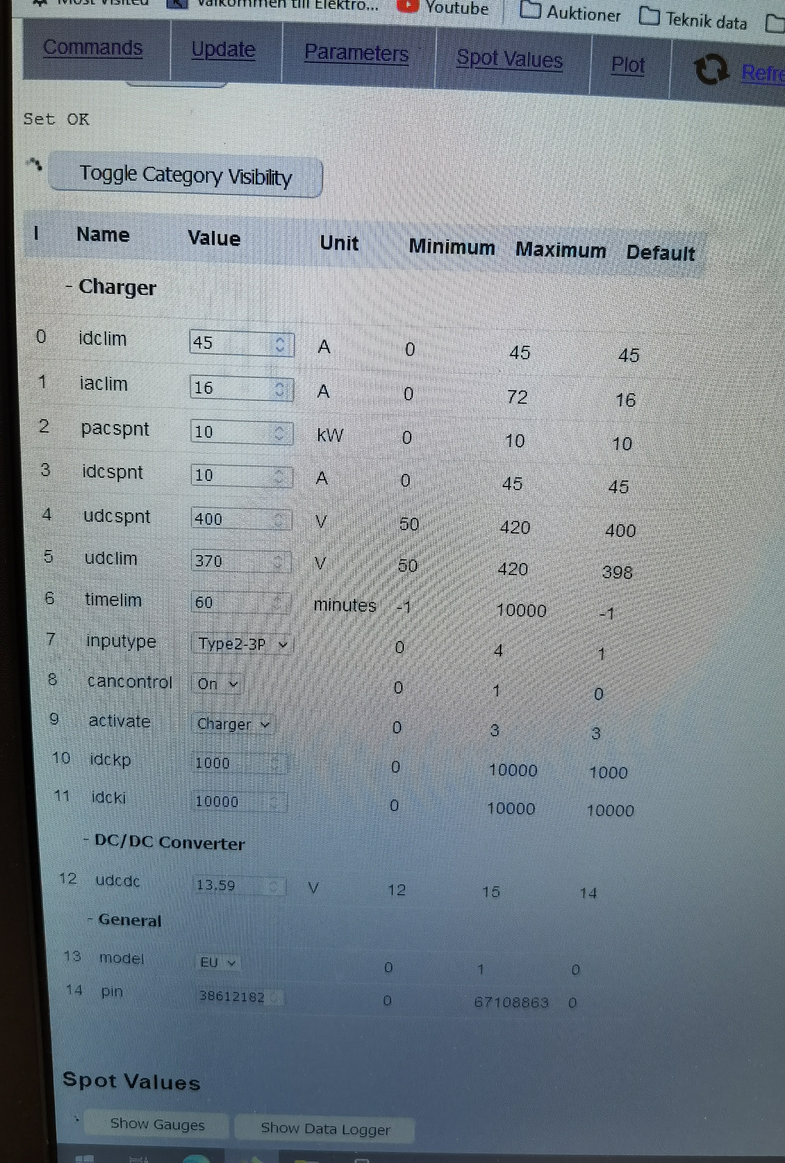

Is the 12V battery connected?fredd90 wrote: ↑Thu Jul 08, 2021 4:20 pm Got in to problems, I think
Everything wired up according to the pinout supplied at first post.
Can't get any pcs values from Web interface, connecting and logging in went great
I have selected eu version,
Is there any more changes to get things working?
Got 5v at pin one and pcs is mounted in penthouse,
Also got 13v at pin6(pcs-enable) with or without communication cable connected.
Attached a picture of my pcs:

Yes 12v battery is connected to m8 studs, it is 13v at battery poles for the moment. Should i try without the battery connected?muehlpower wrote: ↑Thu Jul 08, 2021 5:22 pmIs the 12V battery connected?fredd90 wrote: ↑Thu Jul 08, 2021 4:20 pm Got in to problems, I think
My pcs controller came presoldered so this is my first test,
3v3 led is on and the other one is flashing.
I have also solder for external can but that's not yet connected.
Edit number 2: After some experimenting i got the dcdc charging to work, works perfekt.
Now got ahead trying with controlling via canbus, Read the manual to gen 2 controller, but it seems that can message is shifted a bit.
0x102 b0: 0x0 b1: 0x78 b2: 0x1 b3: 0xA (idcspnt 10A) b4: b5: 0x1(enable) b6: 0x46(soc 70) b7: 0x0
Bit 1 and 2 results in udclim @ 376vdc
When enable Di1/Input 1 and can enable i got my smart charge adapter to apply 400vac 3phase.
Proximity: on enable: on canenable: on
The only thing i get really confused about is the parameter: uac, it is around 6600V
Think i have read everything on wiki but i don´t get it to work, anyone else that got it to work, besides Damien? =)
Another thing i read i the manual, can it be so simple that my unit not are registered correctly and my 5 minutes of charge is finish? i did buy a "full" kit

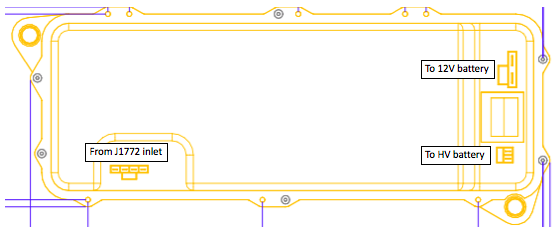

Can someone please clarify the polarity on the J1772, HVDC and 12V connections on the PCS?
I'm using a US Model 3 PCS.
In exchange here's the info on the PCS controller connectors and terminals. Connectors already come with seals.
Thanks in advance.

I also have this question. Can anyone provide the HV pinout for the PCS?
Hello here is some info
3Phase Connector LVDC Connector HVDC Connector (Plus connector via 63A 600vdc fast fuse)

Much appreciated.
