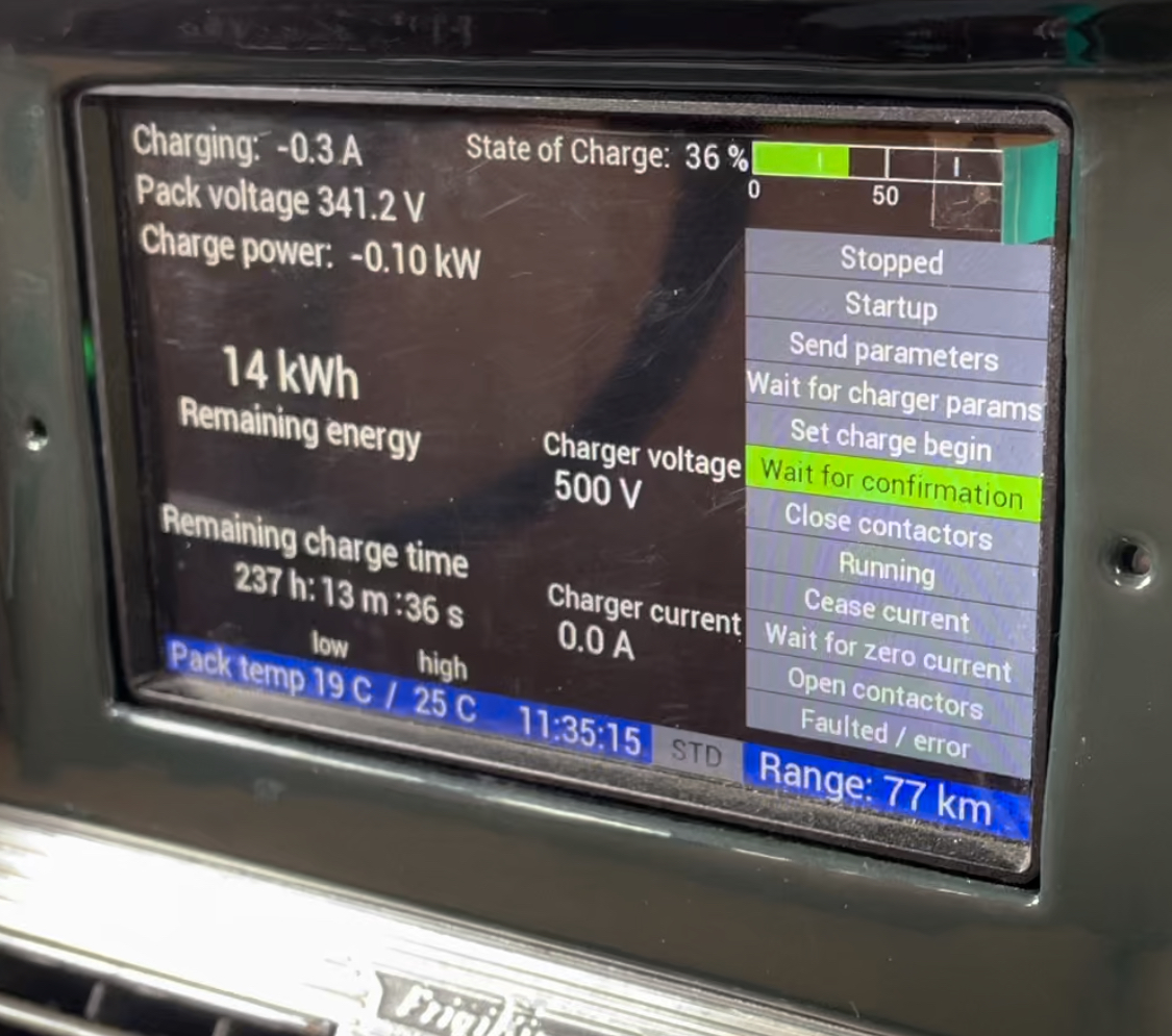

Correct, the isolation test is indeed during the “Wait for confirmation” state.
You need to send “car in charge enable” aka “ready to receive charge”. So at that point the car contactors are closed. Only further down the process the CHAdeMO contactors close. If you open the car contactors amd thus send “car not ready to receive charge” the process will abort. See process flow here https://www.evcreate.nl/chademo-fast-ch ... mo-process
Car contactors open and CHAdeMO contactors closed does not happen.You need to send “car in charge enable” aka “ready to receive charge”. So at that point the car contactors are closed. Only further down the process the CHAdeMO contactors close. If you open the car contactors amd thus send “car not ready to receive charge” the process will abort. See process flow here https://www.evcreate.nl/chademo-fast-ch ... mo-process

This question may be dumb, but, well, I'm dumb.
Do I need to do anything to the ISA shunt to set it up for use? Right now I just wired it up and that's it.
I went and attempted to charge for the first time today, and it appears that the process failed right when the board started to need info from the shunt. Frankly, it was too cold to do other trouble shooting even though I had a CAN sniffer with me.

Ok I'm starting to wrap my head around this. A couple questions:
Johannes, if I just input "i" to the custom command input on the web interface, would that be the same as inputting it via serial? The wiki is unclear to me.
EDIT: I just tried this and got an "unknown command sequence" error. The wiki says that the custom command input can be used for terminal commands that haven't been brought out to the interface, whats the correct command/procedure to do that?
If not, can anyone tell me what I need to connect to the programming port so I can access via serial? I'm not seeing a part # on the BOM or a clear pinout on the schematic.
As a side note, I really appreciate the help on this, I've committed to taking the car on a week-long event starting February 6th, so I need to make this work.

Isaac, hopefully final dumb question:
Should I have seen a response over CAN after sending the initialization messages? Because I did not.
EDIT: I think I fixed my issue. It'd help if I had wired the shunt correctly. Now off to test.
- Posts: 1052
- Location: Raleigh, NC, USA
- Has thanked: 223 times
- Been thanked: 257 times
Annnnddddd not yet fixed. Failed slightly later, by seconds. Previously, would fail immediately after both sides closed contactors and began charging, now it hangs there for a second or two before dropping.
Question for Damien (or others if they know): How many amps can the board provide the contactors? I have a feeling mine are drawing too much.
I'm also not certain all is well with the shunt, but I'm a bit burnt out of wrestling with it.
- Posts: 656
Could you send a screenshot of the current and voltage messages sent by the shunt? I can plug them in and verify that format is good.
Your shunt may be in the 'wrong' direction too, I really don't know if there is any customary way to orient it (and if the current is negative when it should be positive, then the code will probably be unhappy).
