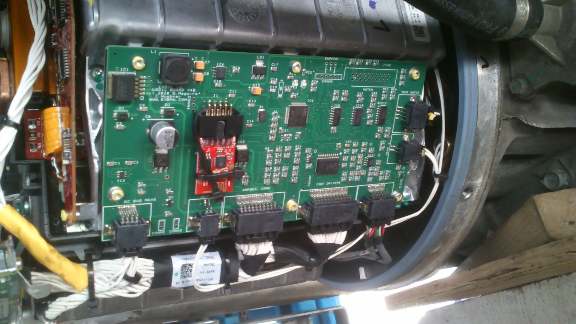

Tesla LDU WLAN module failed
Post by RiPower »

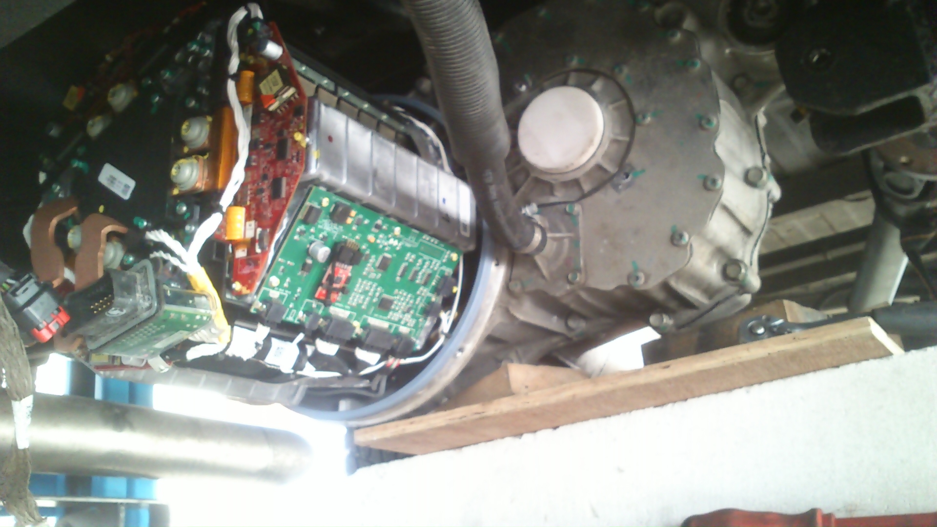

For your information, 2 weeks ago I had the problem that I no longer received a WiFi signal from the inverter. I then removed the engine and removed the cover. The WiFi module had slipped out and was lying loose in the housing. So that this doesn't happen again, I've now secured it with a cable tie. See photos:

Re: Tesla LDU WLAN module failed
Post by jon volk »
I used a dab of hot glue for mine. Also added some glue to the electrolytic capacitor as I had a cracked solder joint at one point.
RiPower
Posts: 25
Joined: Wed Jan 05, 2022 6:48 pm
Post by RiPower »
I also thought of hot glue, but I was worried that it would get a little warmer under the hood.
