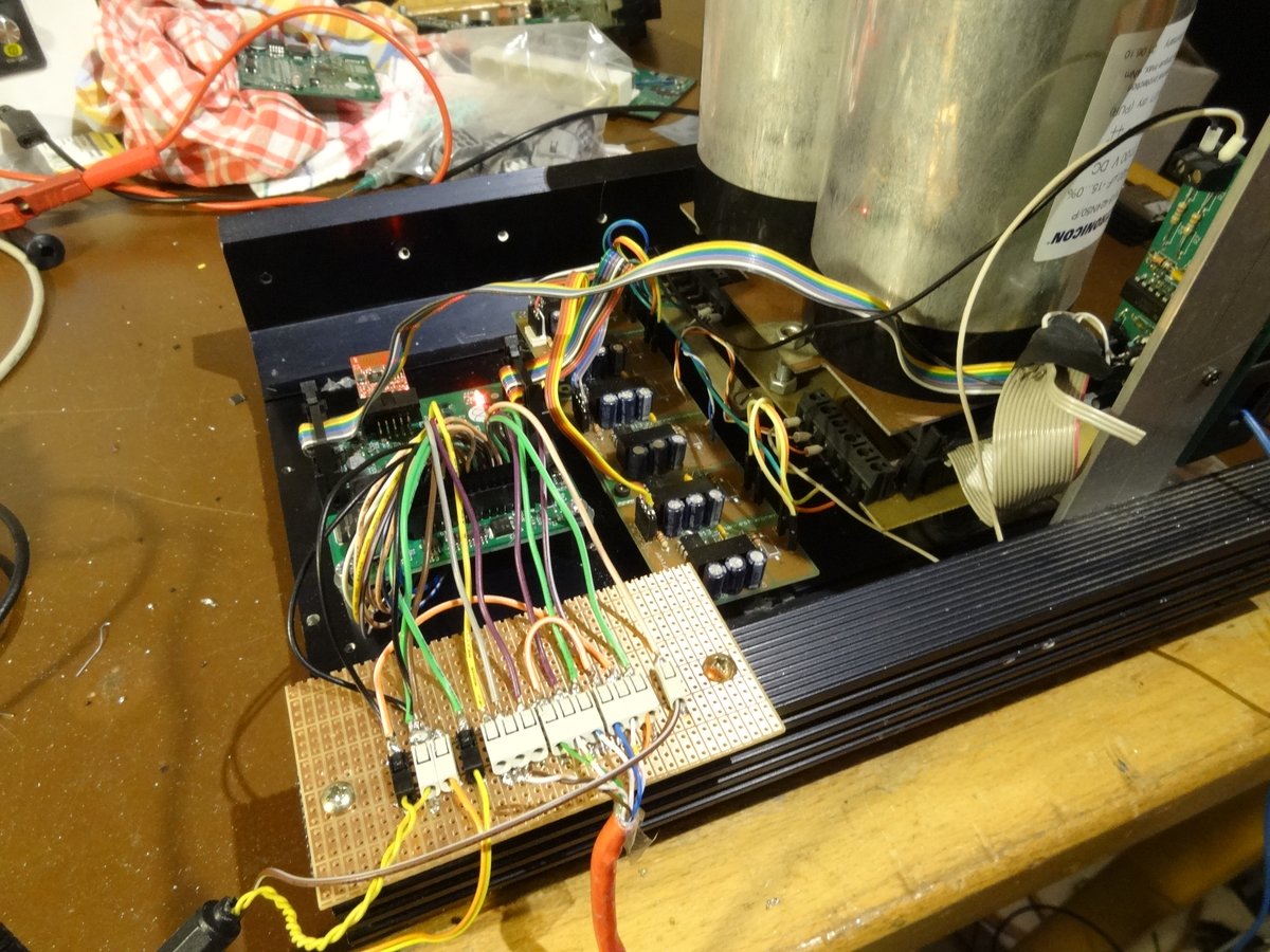

First task done ;) Crimped the resolver wire. Used geduxaz pinout.
Orange pair (pin 1 and 2): excitation R1/R2
Green pair (pin 3 and 4): sine S2/S1
Blue pair (pin 5 and 6): cosine S3/S4
Spliced off the brown pair to reach the temperature sensor. It seems both MG1 and MG2 temp sensors end up on the same connector, does anyone know which one is which?
Also tested it with my old test inverter and it runs nicely.

@Johu. I checked your images. I see resolver Sin/Cos grounds (pin 5/6 in Prius pinout) are used as signals and
Sin/Cos ( pin 2/3) you use as grounds (green blue wires are connected together in your board). why?

geduxaz wrote: Sat Feb 05, 2022 12:23 pm @Johu. I checked your images. I see resolver Sin/Cos grounds (pin 5/6 in Prius pinout) are used as signals and
you mean I swapped polarity? if so, it wasn't intentional but it doesn't really matter. The supposed grounds are tied to 1.6V and the signals are used unipolar.
