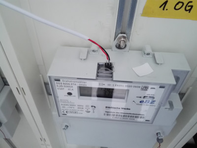

To start out we first need to know the energy flow from/to the grid. I had tried openenergymeter in the past but it was very inaccurate, I found it hard to use and also it required a Raspberry PI to run 24/7 which defeats the purpose: conserving energy.

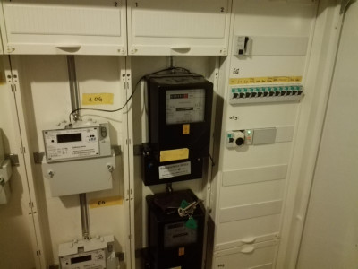

So I researched my existing utility energy meter a bit to find out it actually outputs a serial data stream via infrared (apparently the format is called SML).

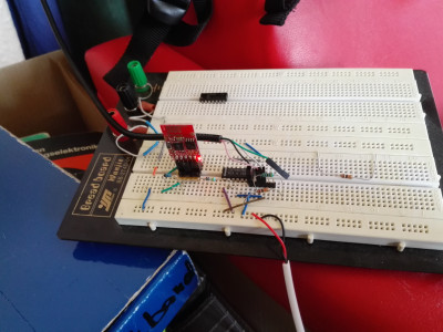

I started out with the physical layer. I mounted one of these reflective encoder heads (left over from Polo project) which essentially consists of an IR diode and a photo transistor. The diode is NOT needed! Nothing needs to be requested, the meter just dumps out the info every second.
Ok, the photo transistor needs 15k pull up (47k makes it too slow, 10k gives too little amplitude). Since the waveform looks rather distorted we feed it through a logic gate, I just use two inverters 74ACT04.
Then it goes to the ESP via a 470 Ohm resistor to RX. RX is connected to 3V3 via a diode to level shift the 5V to a 3V3 signal.

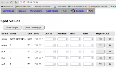

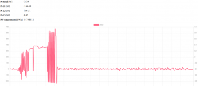

Next we need to write some Arduino C++. Little surprise I took the inverter sketch and modified it. Serial interface runs at 9600 7E1 (first time I see parity used).
Soon had some output

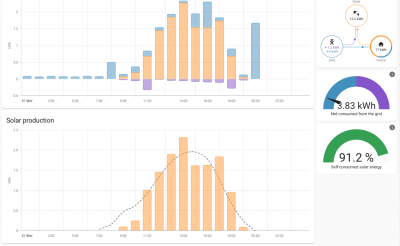

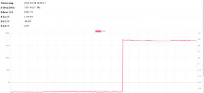

Now went off on a tangent and decided to record that data to a mysql database. That allows more systematic analysis.
So now have a 1-second updating web page

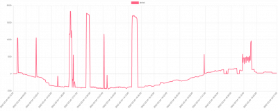

And a daily overview
Everything below 0 means we're exporting to the grid. Some number crunching later I found I "lost" 2 kWh today.
Decided to not run 10m of wire through the public stair case, below our apartment door and onto my desk. So put everything into a DIN rail enclosure next to a DIN rail 5V supply. Pretty huh?

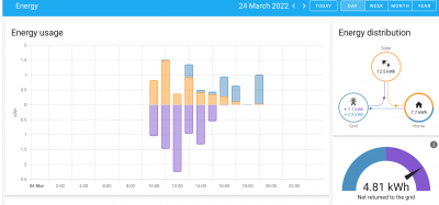

I feel your pain, I'm not paid for export. My new solar exported almost 8kwh today. Does your smart meter have the P1 port?
https://github.com/zuidwijk/dsmr/

It's part of home assistant. I'm working on an ESP32 to take the export current and make my EVSE max amps follow it. I might have to look into your cheap Chinese inverter solution and a chademo plug to take some power from the car and reduce the blue parts of the graph.
I've got a CT clamp around the house load and the PV generation and taking one from the other to get import/export values, not the most accurate but it'll do for now.

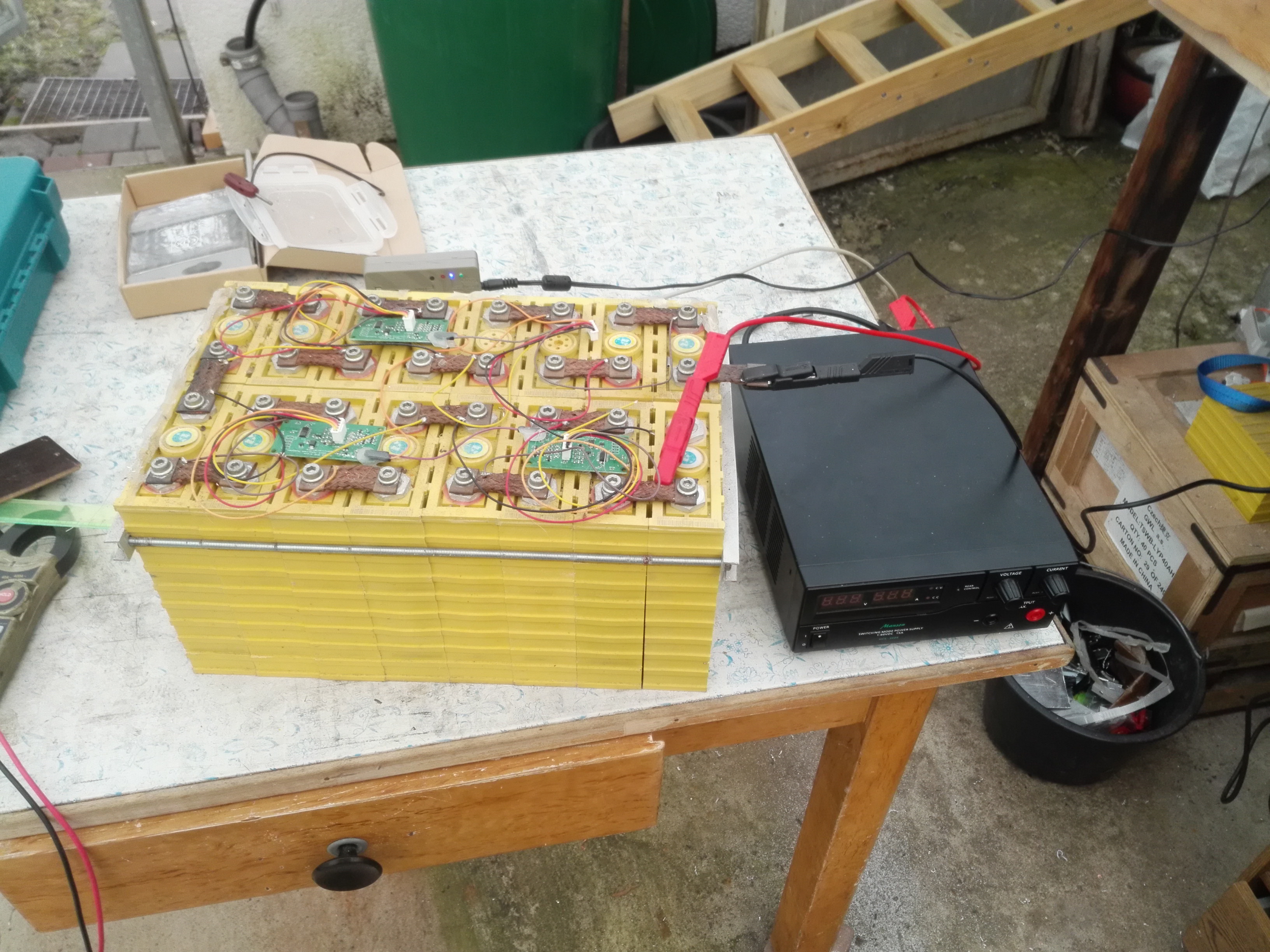

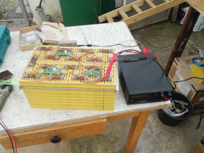

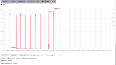

Successfully putting excess solar power into some old LFP batteries. I'm using a BeagleBone (for now) and a Manson switch mode supply with USB (for now) and am running the following script.
It fluctuates a bit (+- 10W) but reacts pretty quickly. Currently wife is cooking and the hot plates switch on and off in some 30s interval. In between it ramps up the battery and then ramps it down again within a second.

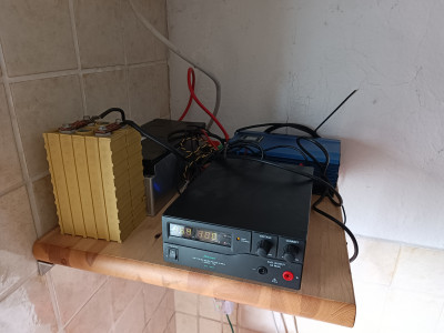

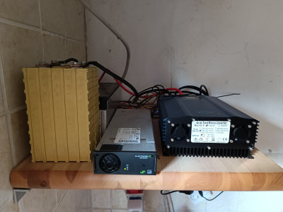

Relocated the whole system to the basement where it's cooler, more fireproof and most of all not as disturbing as when sitting in my desk. Both charger and inverter can be pretty noisy when operating at power.
Next step is replacing the lab power supply by an Eltek flatpack. I hope it goes as low as 44V.
Posts: 6765
Has thanked: 383 times
Been thanked: 1584 times
Re: Zero Grid Export and Reading energy meter with ESP

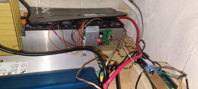

And today I did the Eltek replacement. Lab supply works perfectly well but I thought it is a bit over-qualified.
The Eltek uses CAN, the BeagleBone has native CAN so one less device connected over the notoriously unreliable USB.
There is one challenge though: below 48V the Eltek no longer accept the current limiting command. But has a 43.5V - 57.5V working range. So now I just do a PI loop that changes output voltage to arrive at the required output power. The measurements are updated fairly often, like 5 times per second so it seems to work reasonably well. Also the 10 mV resolution is very helpful. Mind you, the controller gains must be super low because a couple of mV make a whole lot of difference in battery current.
The driver will show up on github in a minute

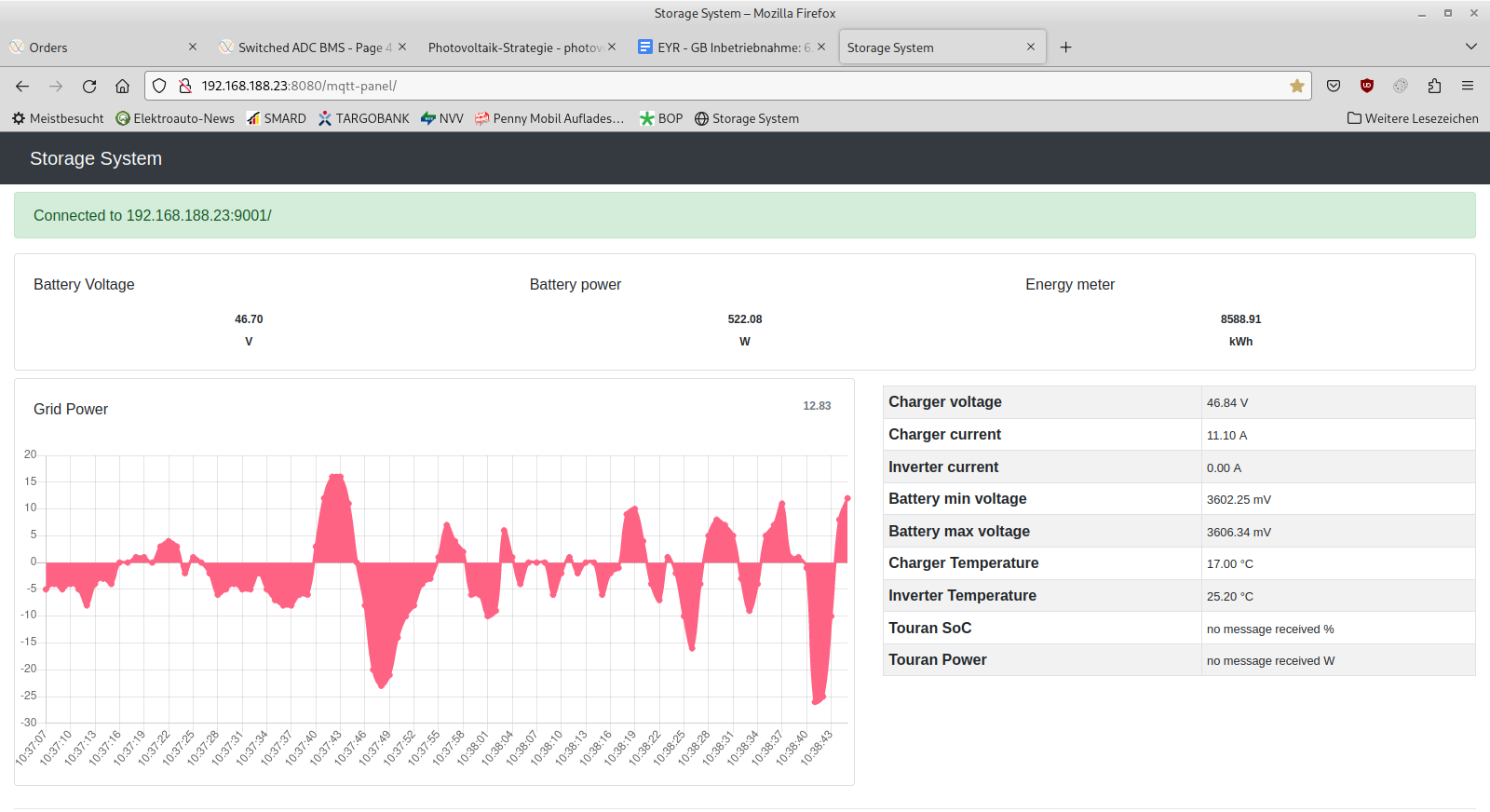

Added the Switched ADC BMS yesterday. It works a treat and now I can keep an eye on the cell voltages. That said, without any balancing after 1 year of operation the delta is 5mV.
I found when two python scripts receive CAN messages you have to configure filters. Otherwise they might "steal" each others messages.

I found the Flatpack consumes a hefty 200 mA from the battery once its AC is disconnected. It also keeps sending CAN messages with no AC, so apparently the battery voltage backfeeds into the control circuit. I fitted a diode to its output.
Was also having CAN bus trouble (bus off condition), maybe related to switching it off. Connecting the can bus gnd fixed the issues.
EDIT: no the CAN bus trouble wasn't fixed by adding the GND wire. As always, when something has worked for months and suddently stops working you should wonder about the latest changes.
The latest change is the addition of a relay to power down the charger when it isn't needed. It has a little boost converter to be able to close the 12V relay from a 5V supply. Now I hooked the relay up to a separate power supply et voila, everything is working. So either the extra current draw (200 mA) from the beaglebones 5V rail or the interference caused by the boost converter is disturbing communication. Will add some more capacity and see if that helps
