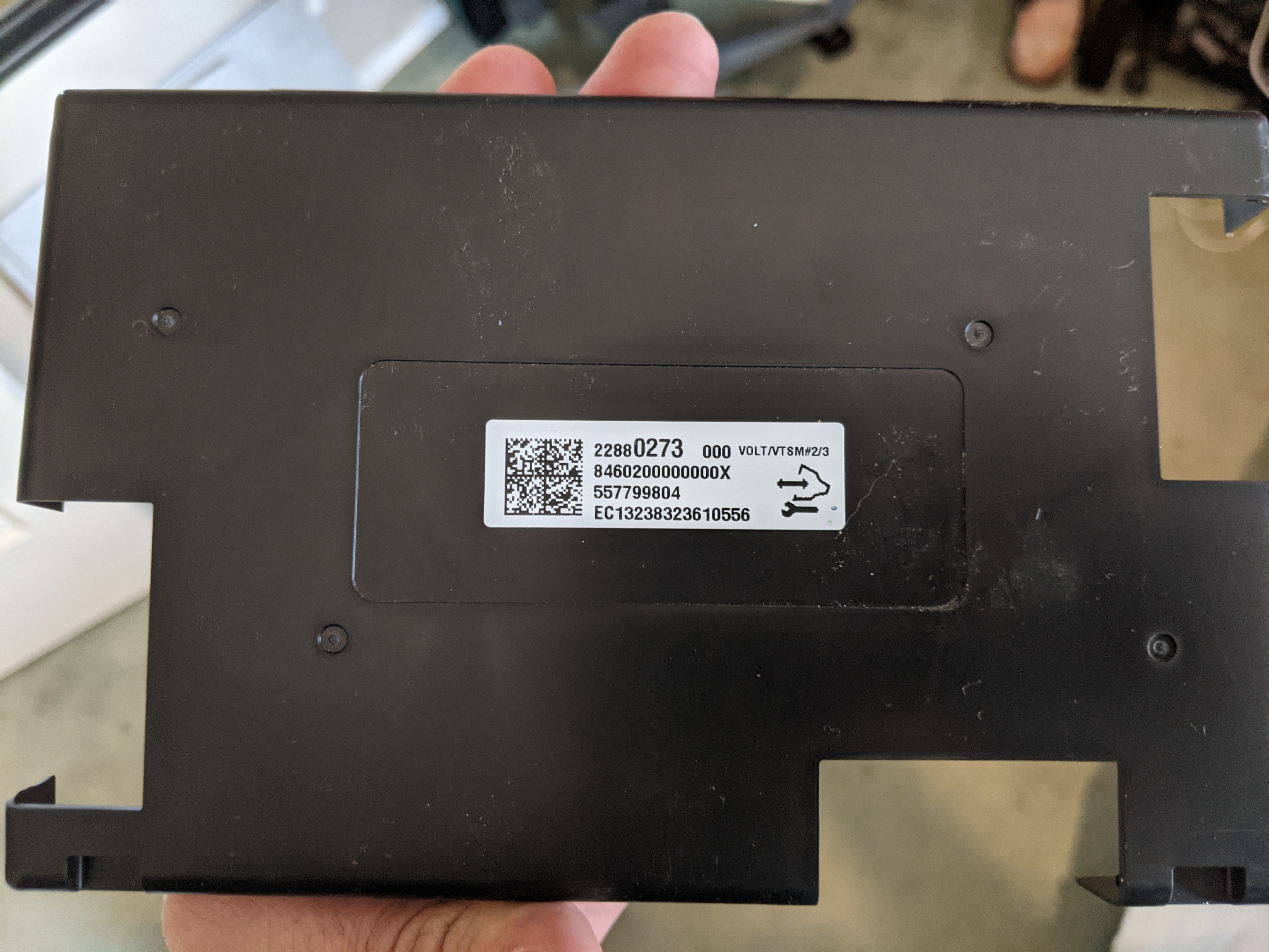

Hi All,
I believe I got the SimpBMS software running on a Teensy 3.2, so I plugged it into my gen 1 Chevy Volt battery to read the cell voltages and I got the following (shown below). Now, the pack voltage from SimpBMS is 279.5 V, but I measured the voltage with a multimeter myself to be at around 339 V. There does seem to be an error readout from SimpBMS that says "!!! Series Cells Fault !!!", but how can I diagnose this? What do I need to do to fix this?
Thanks!

As you can see from the read out it shows only 80 cells instead of 96, so issues with the cabus slaves. To get series cells fault to be removed you need to input the right series cell settings.

The displayed read out shows all the found Slaves, it would seem to me one of the slaves is not reading properly.
How have you wired it up? Did you retain the OEM loom?

Dang... I was worried about that. I noticed that one of the slaves has a dirt ring on it as if some water was on there at some point... I'm worried that I may have gotten damaged while it was sitting at the junk yard. Is there a way where I can individually check each BMS? Something like compare the battery section voltage with the voltage reported from the individual BMS slave?
Yup, OEM loom connected as specified in the SimpBMS manual.

I would say unplug each slave on the LV side one by one to identify the reported modules.
You need to find the one reporting module 6 as 5 7 8 are missing.

Did this and had some strange results. Still not quite sure which one would be defective...
Per the attached image, when I disconnected pack 1, I got the following

Pack 3 as it only shows 8 cells but the module is monitoring more.

Nice! Now the question is how to fix it? I suppose I could try finding a bms slave somewhere? I found one on ebay, but its part number is 22911432 and mine is 22880273. I highly doubt it's a good idea to mix and match like that...
I suspect opening up that BMS to see if anything is obviously broken is also a lost cause.

Thanks Tom. I did this, and although there wasn't a connection that had no change, pack 2 did drop out module 6, which is the one we were looking for. I pulled out that bms, opened it up, and, well, I think the attachment speaks for itself. Note that this is the one that I mentioned that had the water stain on it.
Anyone out there have a replacement?

I had to replace 2 slave modules with similar corrosion. One of these days I plan on potting a set.

Seen that a lot in BMS context. I left one test system in the shed and there was a bit of water ingress. Looked similar. Water + high voltage + PCB.

For those keeping tabs, I managed to find the BMS modules listed on Ebay. I got them in, installed them, and things look good! Reads all 96 cells, and output the same voltage that I read with a multimeter. The only thing is that the print out skips module 8, which I am guessing is why it says "series faul"? Any advice?
