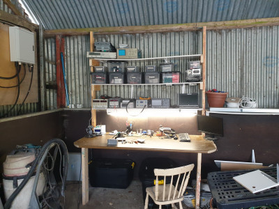

I'm slowly getting the new workshop up and running so will be able to troubleshoot these various bugs out of the system as well as continue development on new features. I appreciate folks bearing with me in what was a real nightmare of a time moving house and home particularly over the last few weeks. My feet are just beginning to touch the ground the past few days.

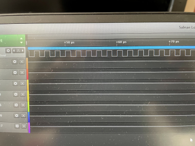

I can't get the sync serial working in my kit. No pulses on CLK, REQ and HTM.
I used a logic analyser to check the input on pin1 for IC18 (CLK) and it's receiving input: Is there a trick in getting the can transceivers to work?
Could the can transceivers in the kit be faulty?

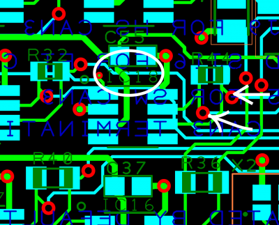

Thanks. I checked and the wiring seems fine.EV_Builder wrote: ↑Sun May 01, 2022 5:49 amCheck wireing first. Who is supplying the clock?Zechy wrote: ↑Sun May 01, 2022 3:24 am I can't get the sync serial working in my kit. No pulses on CLK, REQ and HTM.
Is the inverter switched on?
I then measured at the white arrows and didn't get any CLK+ and CLK- signal: Then I used external can transceiver modules between the input pin 1 and the 56pin connector: The syncserial then gets to the inverter and I get data back on the MTH cables.

Pohh good job. Then it's time to check orientation?

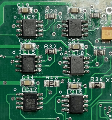

- Posts: 228
- Location: West Midlands, UK
- Been thanked: 13 times
Re: ZombieVerter VCU Support
Think the transceivers are bad, as im having the same issues.
Fed CAN to 2 of them and received nothing the other side
Fed the same CAN to 2 known working ones (from another project) and received the other side as expected.

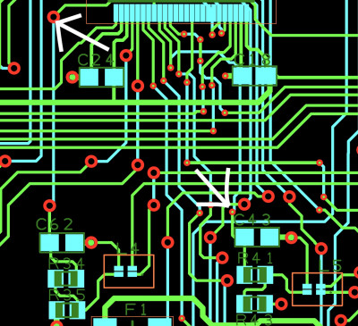

My tmpm stays on 6400 no matter what I try.
I plugged a 10k Ohm pot in on MG2temp+ and - I can then measure a voltage of 0.2-3.8 on pin A6
When I plug the 10k Ohm pot into MG1temp+ and - I can only see 0.02-0.06 volt on pin A5
