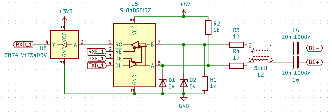

Sorry not very clear, obviously need to move to a 5V transceiver too!

Sorry, typo SN74LV1T34DBVPete9008 wrote: ↑Sat May 14, 2022 6:09 pm Probably something like a SN74LVT1T34 for the Rx line (or similar, not my first choice but they were all that was in stock when I checked a few weeks ago). For the Tx and enable you'll probably find that the Pico 3V3 high level is fine, let me find the datasheet.

Just had a quick look and can't find stock of anything suitable now.
It's a fairly nasty solution at these frequencies but a resistive divider should work for Rx, just keep the resistor values low so that RC (where C is the circuit parasitics) is much lower than the signal pulse width and ideally lower than the max rise time, if specified, for the receiving chip (can't find it for the RP2040 but given the input has metastability latches and schmitt inputs it should be fine).
Say 20pf (probably lower in reality) and RC < 50ns gives a max R of 2k5 so say a 1k and a 2k. Should be possible to bodge them onto an existing board to try it without a respin too if you can find a 5V transceiver.

Unfortunately I think this might be too much bodge. I'd need to swap in resistive dividers on the two data pins, and a 5v supply, not totally impossible for testing, but probably worth just ordering a new board.
Edit: only one data line, and the driver VCC line, and the pull up resistor, not totally inconceivable.

It's not too bad to do, I wouldn't do it on a production board but for testing it's ok. I've recently done the same mod on a 5V CAN transceiver to allow it to work with a 3v3 Arduino board (just tried to take a picture but can't get the camera to focus clearly enough to show it). I normally cut a track, scrape back the solder resist and lay the series resistor across the gap and then find somewhere from the 3v3 side of the track to the ground plane for the parallel resistor. If done neatly it's hard to tell it is there.
For the 5V I'd expect to lift the IC pin and run a mod wire unless there is a convenient place to cut a track (later has the advantage that it keeps the decoupling cap on the IC).
The main problem with the resistive divider is the power consumption, to get the high frequency performance it needs to have low R values which means mA currents going through it which ruins your standby power consumption - but it's good enough for validating a design. There is a really nasty hack which just uses the series resistance to limit current and then relies on the receiving IC protection diode to clamp the voltage - in theory it works but I've never used it.
There are a number of other level translator circuits using FETs or diodes but they often don't perform well at higher frequencies. The best way is to use a translator which gives low power and clean/fast rising and falling edges. You can either use a dedicated one, like the one mentioned, or a logic gate from a family that has 5v tolerance, seem to remember using LVC and VHC families in the past.

Looks good.
I forgot you have three channels to do, could also use something like a vhc125, cheaper and available but older generation family so slightly higher supply current (afraid I'm not up to date with newer equivalent logic families). Might not work quite as well with the existing board layout/routing though?

Thanks, I think I'll use the three small shifters though, definitely fits better with the "modular" layout.Pete9008 wrote: ↑Sun May 15, 2022 9:27 am Looks good.

I've ordered a new board with the 5V drivers. Fingers crossed!
Latest schematic here: https://raw.githubusercontent.com/catph ... ti-bms.pdf
It occurs to me that there is another improvement that could be made. I'm not inclined to do so on my board at this late stage but for a redesign, I would consider tying RE and DE together, and putting a pull-up on RO. This does 2 things:
1) Frees up a GPIO per transceiver!
2) Disables RX when transmitting, no PIO JMP needed!
Edit: Remembered why I didn't do this originally, the board has a low power sleep mode that shuts down both the TX and RX.

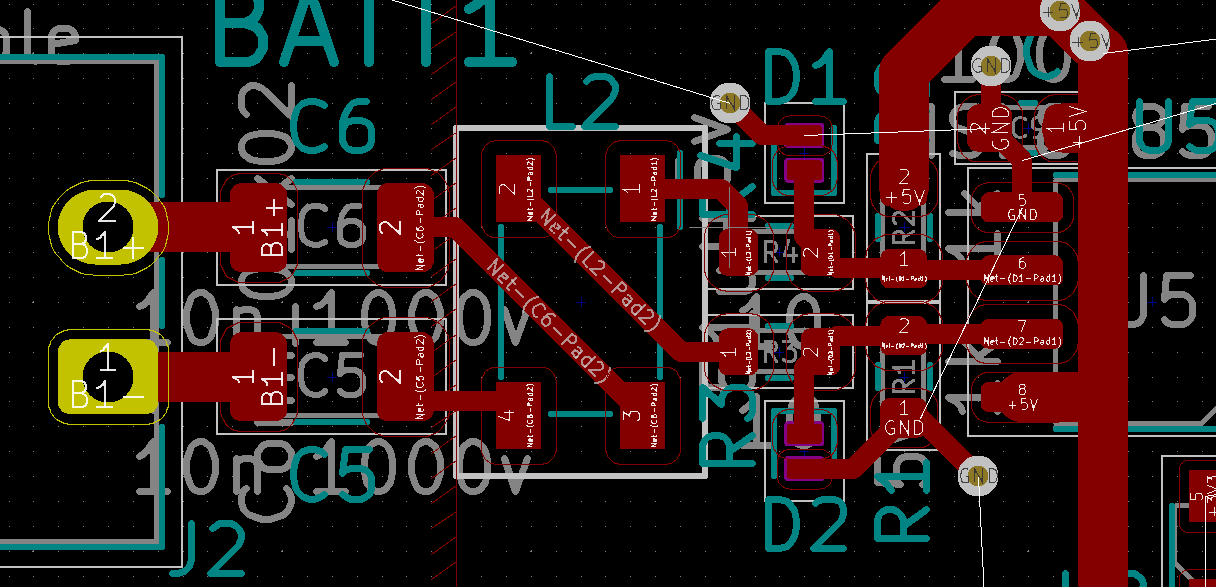

That had me worried for a minute, from the render it looked like the chokes were in the wrong way round
Just checked the PCB and it's fine though
Where did you find stock of the ICs?

Yes, for some reason I mounted the chokes sideways. I think at some point I must have been extremely tight on space, and it stuck.
It's all JLCPCB. They have stock, but prices are through the roof. £160 GBP for 5 boards. I really hope they work!
