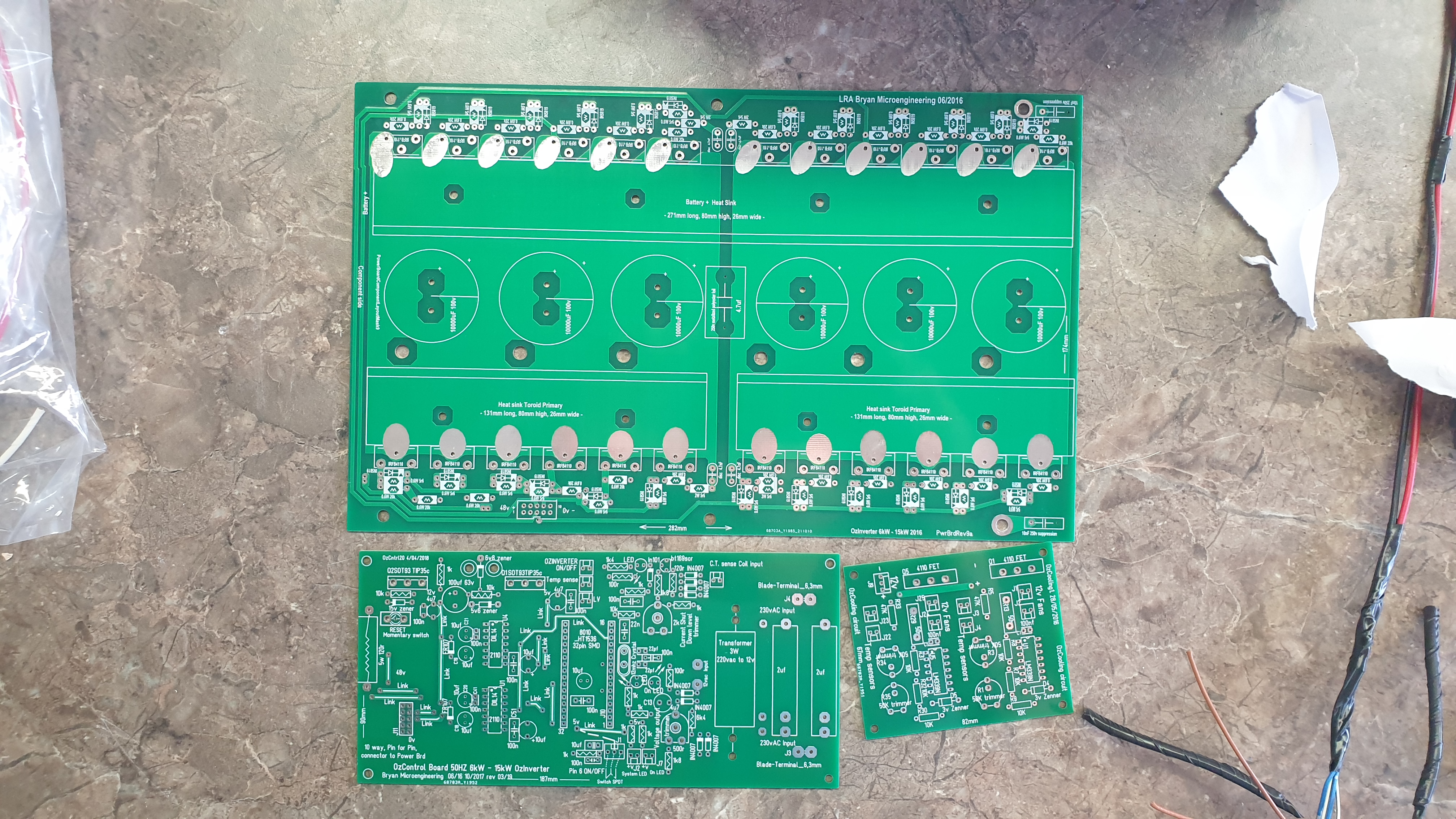

As some of you may know I hate re inventing the wheel so went about a search to find a high power dc to ac inverter that could be built, upgraded and maintained at home. Perhaps knowing its usefullness was at an end my pos Victron 3kw decided to pop a row of mosfets over the weekend. Surprise surprise. Anyway, my search has led me to the Ozinverter detailed here :
http://www.bryanhorology.com/ozinverter.php
Purchased the book and a few days later the boards which have arrived today. Naturally I'll be doing things a little bit differently but will document the build and process here and of course with uber boring videos.
OzInverter Build

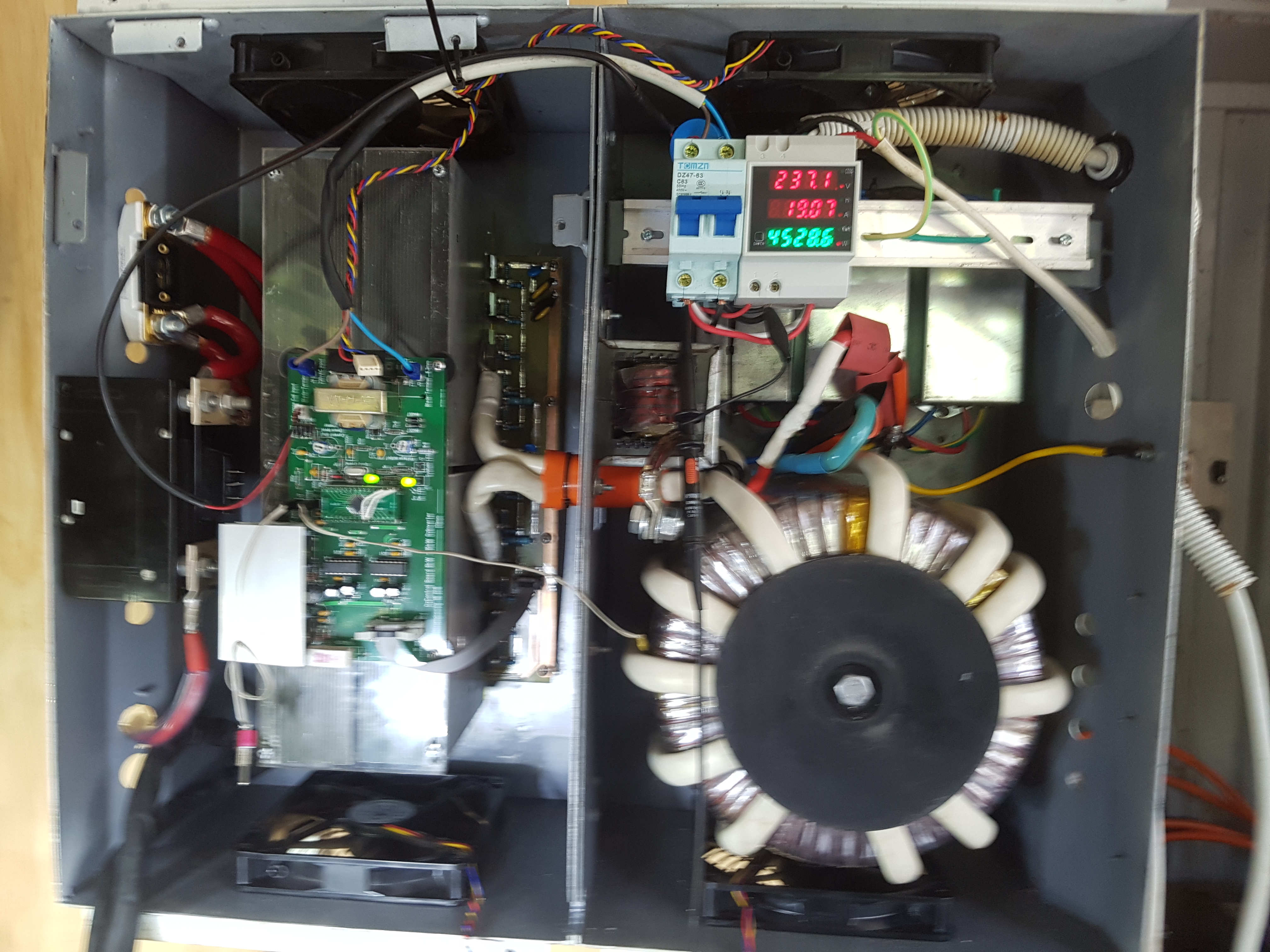

I have built my own inverter almost the same but with improvements such as Totem Pole Fet drivers. It has been running my house for the last 6 years. It is capable of 8KW continuous and can start a 5KW induction motor.
Re Prius inverters, they may be great at 300 VDC but the IGBTs are not so efficient at 48VDC.

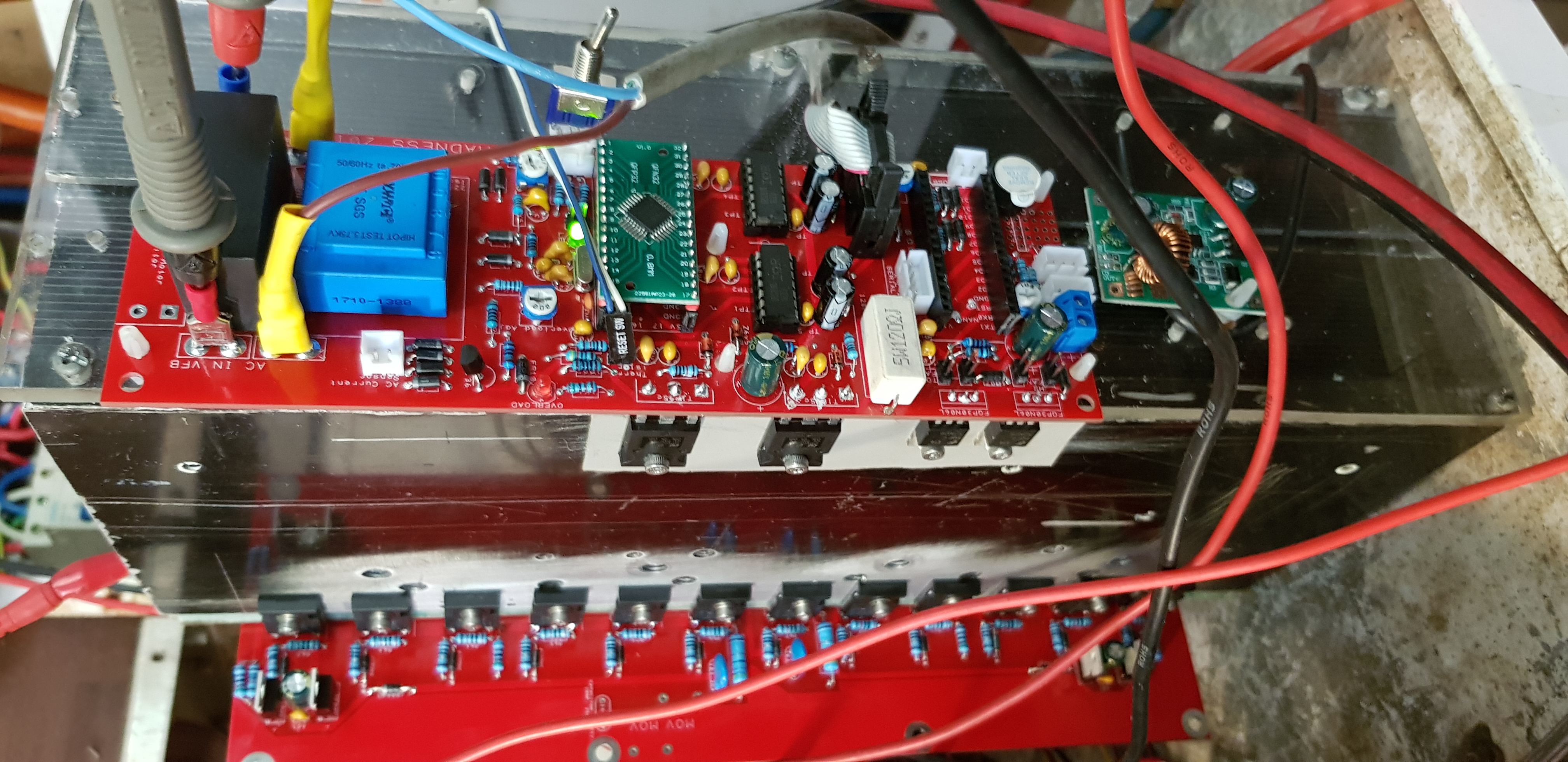

I built my own inverter but something quite different. I have watched the OzInverter evolve since an Aussie engineer diagnosed the heavy standby current in an old Chinese inverter - name I have forgotten; then the modifications of the infamous Power Jack inverter which then led to the "Oz Inverter" design. I am now probably 2 years out of date, but there were 2 main versions of inverting, one using the chinese EGS8010 (I think) module and the other used an Arduino Nano module, which would be my preference. I think this was refered to the Nano OzInverter.
Many MOSFETs were killed in the evolution of the Oz inverter
Various builds had differing results in regards to MOSFETs blowing up.
I agree with Gary re: totem Pole drivers.
I prefer to go one further and use isolated gate drivers.
One of the better results I can remember is by a guy in Queensland that used a "Big Ass" E transformer he acquired from a junkyard.
If you want efficiency, go with a Toroid, but if you want a more forgiving transformer with a better sine wave output, go with a "Big Ass" E core transformer. An E-core transformer is much easier to wind as well.
