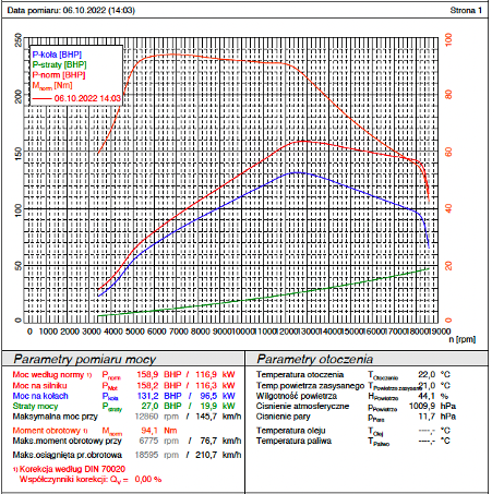

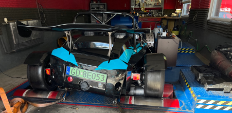

Super interesting thread plenty of interesting observations. I was starting a similar discussion some time ago, so good to see some new facts coming in.
I finally took my car to the dyno, so hopefully the finding I share will contribute to further understanding of the SDU parameters setup.
I personally think this engine has superb potential, it is light, still well prices and I’m getting 180-190kW which suit my applications.
My setup:
- SDU, Quaife diff, running on reverse gear, v6 Board
- 17 modules from Ioniq 5 2022, 102s2p. According to hyndai numbers from Ioniq5, cell voltage of 3,48V is on 14% SoC and 4,15V on 97% SoC
- I charge the pack up to 430V (catalogue limit of SDU inverter, so I read) which gives me about 4,21V per cell
- NB, I once charged to 440V and inverter still worked fine
- After 2 years of testing, I settled on these parameters for road and track:
Boost: 2200, Fweak: 230, fslipmax: 2.7, fslipconstmax: 5.9, idcmax: 500
What I want to achieve:
- Understand the parameters and understand why I don’t get to 220kW for the racetrack
- Improve power beyond field weakening point
- Flatten out the power curve and limit it to have the same amount of power to the wheels down to 30-40% of SoC. It is not very rewarding when you see the power dropping 0.1s every second or two compared to the previous lap:
- Better the 0-100km/h from the current 3.9s
The dyno
It is not a wheelhub dyno so the first disappoint was that despite my super soft slicks it could cope with the strong electric motor toque up to the power level of 170bhp. The torque readout itself was weird, ~100Nm. We had no idea why, I was first electric car ever on this dyno.
I limited the power by reducing the fweak, hard. On test runs it had to be only 500 at the start, then we improved a few things (0 camber and tighter belts).
That will be the baseline for the other graphs:

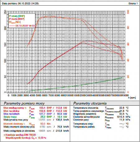

Run_14: Boost: 2500, Fweak: 350, fslipmax: 2.7, fslipconstmax: 5.9, idcmax: 700, thrtramp 10 Graph from the BMS for this run: 325 * 390 V = 170bhp
That would mean the losses (inverter, motor, powertrain) are on the 6.5% level, which in ICE numbers, it is crazy low!
Run_16: Boost: 2500, Fweak: 350, fslipmax: 3, fslipconstmax: 5.9, idcmax: 700, thrtramp 10 Run_17: Boost: 2500, Fweak: 350, fslipmax: 2.7, fslipconstmax: 5.9, idcmax: 250, thrtramp 10 Run_18: Boost: 2500, Fweak: 350, fslipmax: 2.7, fslipconstmax: 5.9, idcmax: 250, thrtramp 30 Run_20: Boost: 2500, Fweak: 350, fslipmax: 2.7, fslipconstmax: 4, idcmax: 250, thrtramp 10 Run_21: Boost: 2500, Fweak: 350, fslipmax: 2.7, fslipconstmax: 8, idcmax: 250, thrtramp 10

Re: Tuning the small drive unit with charts
Thank you for posting all this. I will go through it in more detail, but I have one immediate question. What is your value of udcnom? That will have quite a few implications for the interpretation of the data.StefSonic7EV wrote: ↑Thu Oct 06, 2022 8:53 pm Super interesting thread plenty of interesting observations. I was starting a similar discussion some time ago, so good to see some new facts coming in.
My immediate thought here is that you're not pulling nearly as much current as you might. I tuned for a peak current of 500A, but you are only pulling 325A. I guess that was for the benefit of the dyno, so as for the question of whether you can get 220kW, you probably can, but you didn't test that.

udcnom is 360 for me, I did not care about this parameter too much. Engine operates on a voltage from 430 to 370 V.
One of the biggest findings from the dyno for me is that powertrain losses are low 6.5% when calculating the engine power from the electrical power.
So on the full charge (I'm assuming the inverter's efficiency is much higher at peak voltage) I was getting 180kW of electric power drawn out of the battery.
Which parameters might limit me in getting to to 220kW?
I will be testing it on the road tomorrow and will post the results immediately.
catphish wrote: ↑Thu Oct 06, 2022 9:13 pm Thank you for posting all this. I will go through it in more detail, but I have one immediate question. What is your value of udcnom? That will have quite a few implications for the interpretation of the data.
