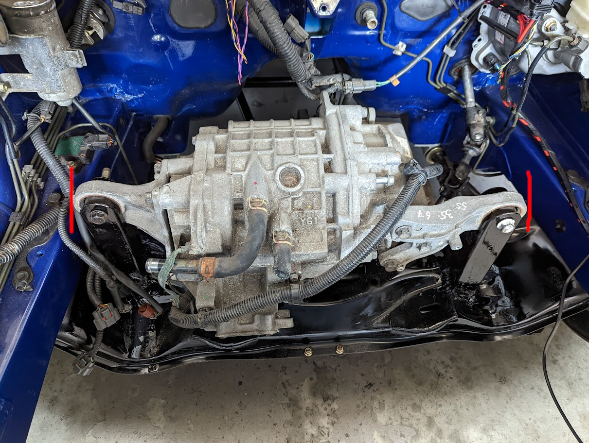

Ok so a bit more experimenting today with coding and CANBUS. Defined all relevant values on the code to int16_t, just in case teensy 32bit ints were messing things up.
Confirmed that I am getting a negative value when I multiple torquerequest by -1.
Rotation direction doesn't change if I multiple by -1 or not. Attached some canbus logs from both settings.
From what I can tell the canbus logs look like I would expect them too for commanding negative torque.

Those CAN values appear right.
It would also be worth checking what the motor is reporting for torque and RPM 0x289:
void canRX_289(const CAN_message_t &msg)
  motorTorque = ((((msg.buf[0] * 256) + msg.buf[1]) - 10000) / 10); // Motor Torque -200 / + 200nm
  motorRPM = (msg.buf[2] * 256 + msg.buf[3] - 20000);               // Rear RPM -10000,10000,RPM negative is reverse
Can't really think of anything else that would only make it run forwards, but worth check phase order and resolvers.

Interestingly the inverter is reporting negative torque when it should be. Which would suggest there is an error in the physical setup.
I've play around with the resolver order before, but anything apart from this current order doesn't spin at all.
Edit: Gone through my setup again and also the FOC tuning video. I think I have the answer, it is probably just the polarity wrong on resolver connectors, since I don't have the OEM connector. Will report back.

LRBen wrote: Thu Sep 15, 2022 12:00 pm Edit: Gone through my setup again and also the FOC tuning video. I think I have the answer, it is probably just the polarity wrong on resolver connectors, since I don't have the OEM connector. Will report back.
Was resolver polarity in the end! Spinning the correct way now.

tom91 wrote: Thu Sep 15, 2022 1:58 pm Can you now also spin in reverse with a negative torque command?
Curiously no. Spins the same way regardless of positive or negative torque commands. I have the gearbox so doesn't affect me. But obviously still not ideal.

Looks like I'm not quite there on the setup of this motor. Spins up nice and smooth with wheels off the ground. But when I try to move the vehicle under it's own power it judders. Edit: it actually does have some power. Can take off in 2nd and 3th no problem, actually seems smoother in higher gears.
I changed my throttle position multiplier to * 19, in order to get close to the torque request limit of 2000 before the +10000 offset calculation but it has had no effect.
Could this be resolver issues again? It is a mismatch motor/inverter. I would assume my inability to switch direction of the motor with negative torque commands is also probably related.

On further testing and consideration. I think this might just be a case of the motor stalling at low torque request? If I put my foot down quicker it smooths out. So I'm thinking it might be a case of having to improve my code for torque request to smooth it all out.
This is the judder in reverse gear so there is some additional gearbox noise.

That does not sound great!
Should be no need for smoothing, I only smooth for a calmer drive and to limit wheel spin.
No direction control does point to an underlying problem though and I'm sure this is related.
For this specific behaviour I would check:
Is there anything else on the CAN bus that can transmit messages, such as the outlander charger?
Could be the inverter receiving a 0 or no torque request every second or so, ie CAN packet loss. Check your CAN wiring and resistance

So a bit more messing around. I think I can rule out canbus issues, savvycan doesn't suggest any dropped messages, I also ran the VCU canbus straight to the inverter with nothing else and had the same behavior.
RSDN pulled low or floating had no effect.
So I tried swapping the resolver wires back to how they were before when it span backwards. Now it's very smooth but lacking power and also spinning the other way.
Feels like this is a basic setup issue. The down side to no bench testing before throwing it in the vehicle.

Looks like it was basic setup. Since I chopped up the resolver wiring to use it with the Prius inverter I had nothing to go on for resolver polarity etc. Add on to that the resistance readings for to two pairs of the resolver signals are within spec of each other there were allot of combinations to get through.
The polarity of R1 and R2 also had an effect so I had to go through those combinations as well. Pretty close now though. I can command negative torque and it works. I have power and smooth delivery. It does want to spin backwards by default, but multiplying the torque command by -1 fixes that.

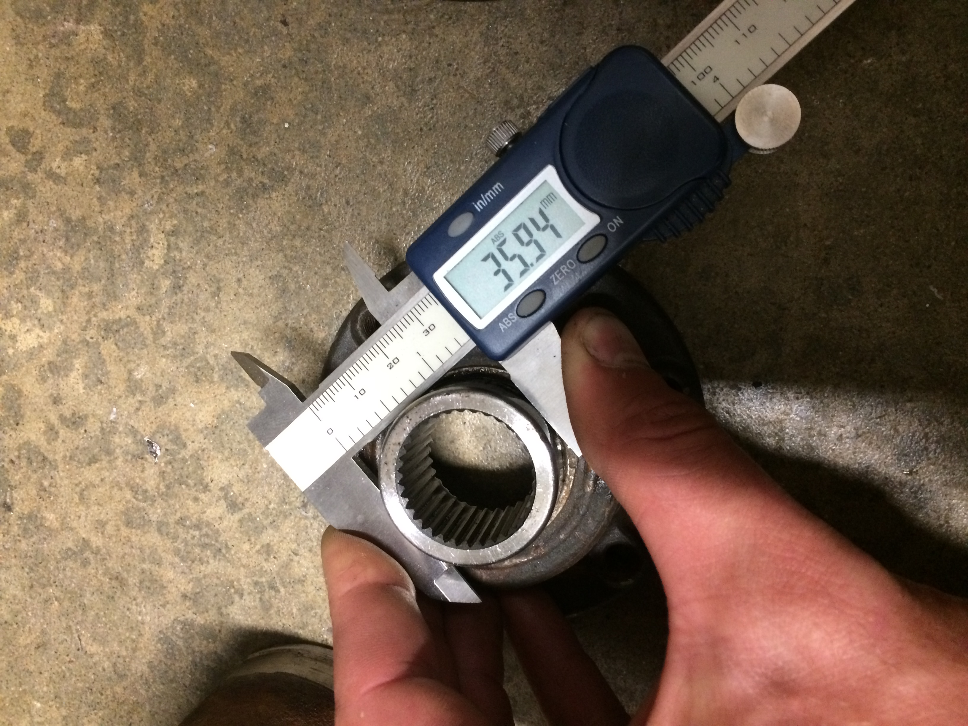

I am very interested in coming up with a drive shaft/flange solution as getting the shafts is getting difficult.
Posts: 1011
Has thanked: 180 times
Been thanked: 374 times
tom91 wrote: Sun Sep 18, 2022 4:41 pm I am very interested in coming up with a drive shaft/flange solution as getting the shafts is getting difficult.
The company im working with whom are cold rolling the stubs i have designed for the leaf gearbox, do all the oem prototypes. theyll have no problem making a stub for these.
is there any particular CV you have in mind? i was just thinking of making a stub shaft with the 33 vw spline so all the VW flanges fit. apposed to doing a full custom cv, say one that works with a mini shaft, would be very expensive.
