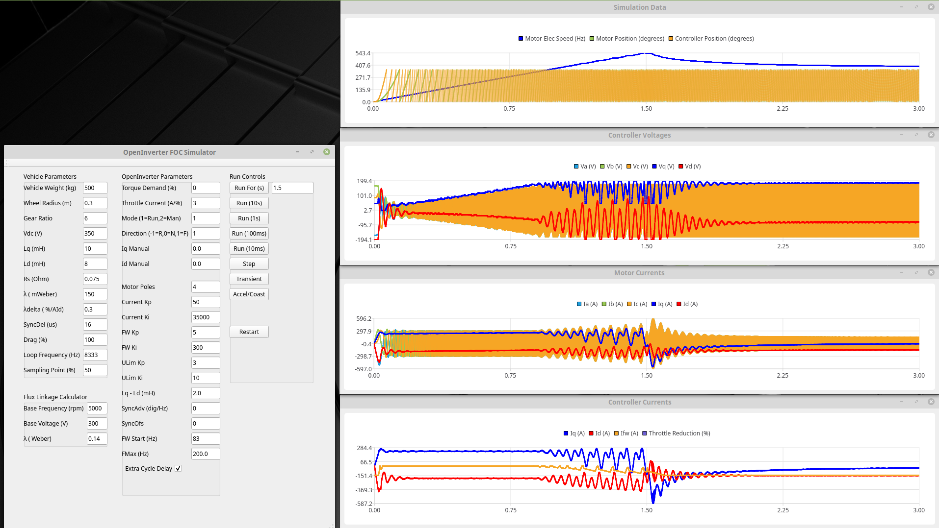

johu wrote: Wed Oct 05, 2022 5:52 am Went for another test drive on the different terrain around my dads place. More straight and level roads.
I changed the maximum d-controller amplitude to max-3000 (was max-1000) to leave more room for the q-controller and set fwmargin=4500.
Before I had driven with fwmargin=2500 and experienced a short burst of acceleration when coming OFF throttle
Shocking result: unwanted acceleration. At about 7000 rpm I came off throttle and the car accelerated happily to 8500 rpm or 100 kph in 2nd gear. Would be nice if it did so on demand. Had to force it back down to 3500 rpm, then came a bang and regulation recovered. No over current. Unfortunately no logging as it was just a quick test and one I certainly don't want to repeat as it is harsh on the battery.
Pete, can you simulate above settings? I know I could but you are more savvy with the simulator. The settings are as posted here viewtopic.php?p=45280#p45280 but fwmargin=4500 and maxVd=max-3000 in PwmInit()
Here are the plots, two for each. One run just accelerating and one accelerating to around 7krpm and then coasting.
fwmargin=2500, d-controller max-1000:
fwmargin=4500, d-controller max-3000:
The differences are fairly subtle and there is no significant difference between the behaviour of the two coming off the throttle. None of them look stable though and they are both going open loop at times when moving to coast. My gut feel is that you were lucky with the 2500 version (it was still going unstable/open loop but not in a way that produced the nasty effects) and it only took a small change to push it outside that sweet spot. Without more detail (a high speed log for example ;) ) I'm not sure it's worth spending much more time looking at this. Once it goes unstable it becomes highly unpredictable and I don't believe my model is good enough to be representative at that point.
The goal has got to be to get the control loops stable and staying within the closed loop region. I think part of the problem is that when you come off the throttle the Mtpa pulls a lot of -Id out. Up to that point that -Id has been helping with the FW but with it gone the FW controller has to suddenly add a lot more -Id to replace it to stop the motor voltages shooting up (you can see this in the plots where Vd and Id shoot up to full scale positive before being slowly pulled back down). This required a very fast FW loop response which then compromises the normal FW control and causes all the noise problems that can be seen in the plots. By changing to the FW and Mtpa scheme I suggested above you avoid this discontinuity completely and can instead tune the FW controller to be a lot slower which avoids all the noise and avoids a lot of the stability issues.
Edit - you can also see the difference between the controller view and motor view of the currents in the plots. Sync compensation should help with this and allow better separation of the q and d components.
Edit2 - That's interesting, based on the simulation FW isn't needed at 7k, will have a look at the settings as see what that means!
Edit3 - Ignore the above for now, flux linkage of 90 seems a bit low for the leaf motor, 150 would seem more reasonable. Need to redo the simulations to see what effect that has.

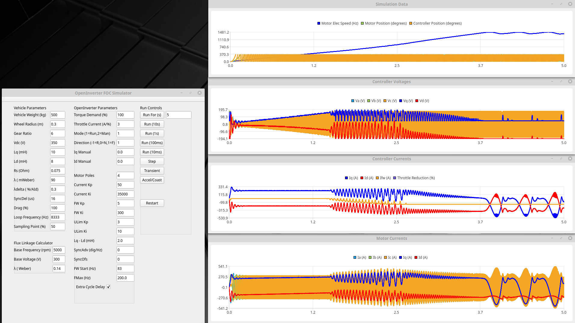

Two new plots, both accelerating to around 7k and then coasting but with the value of 150 for flux linkage so that FW is now active at that point.
fwmargin=2500, vd = max-1000:
fwmargin=4500, vd = max-3000:
Except that I got two of the plots swapped on screen :oops: they look very similar. The fwmargin=2500 is slightly more stable (bigger overshoots on the currents on the fwmargin=4500 plot) but there is not that much in it. All the comments in the above post still apply.

Added the previously omitted equation terms to the simulator and the results are significantly different to before but there is also some very odd behaviour and it is very, very sensitive to motor parameters (with Lq/Ld inductances of more than a couple of mH the results just make no sense at all!).
Can't see any point spending more time on it until better data is available to calibrate it against (either accurate motor data or high quality logged data) so it's on hold till one of these is available.

Looking a bit more at this and I'm wondering whether the simulation is right and the inductance values I'm using are wrong. I've never been able to find any really good Ld and Lq data for motors so it has been a bit of a guess but I'm wondering if the 2-10mH typical values I've been using are waaay too big.
The only data I can find is here https://macsphere.mcmaster.ca/bitstream ... _Ph.D..pdf, Fig4.9 on page 98 (p122 of pdf). It gives values for the leaf motor of Lq ranging from 550uH at 0A reducing to 330uH at 300A and values for Ld ranging from 150uH to 100uH for the same currents. Now these are 10-100 times lower than the values that I have been using in the simulations (and also much, much lower than the values typically used for the Mtpa calcs in the inverter software) and would make a massive difference to the results - the latest simulator results with the extra equation terms might actually start to make sense at that point!
So the question, does anyone have data for the Lq and Ld inductance for other motors?
Note - once we have a good set of logged data these values can also be worked out from that.
Edit - just tried the lower values on the new model and the results look very good :)
Hoping that someone can provide some evidence that the motor inductances are typically in the low hundreds of uH rather than mH.
Edit2 - Even the extra torque generated by Mtpa looks sensible now (which has always previously bothered me as being way too high)!
