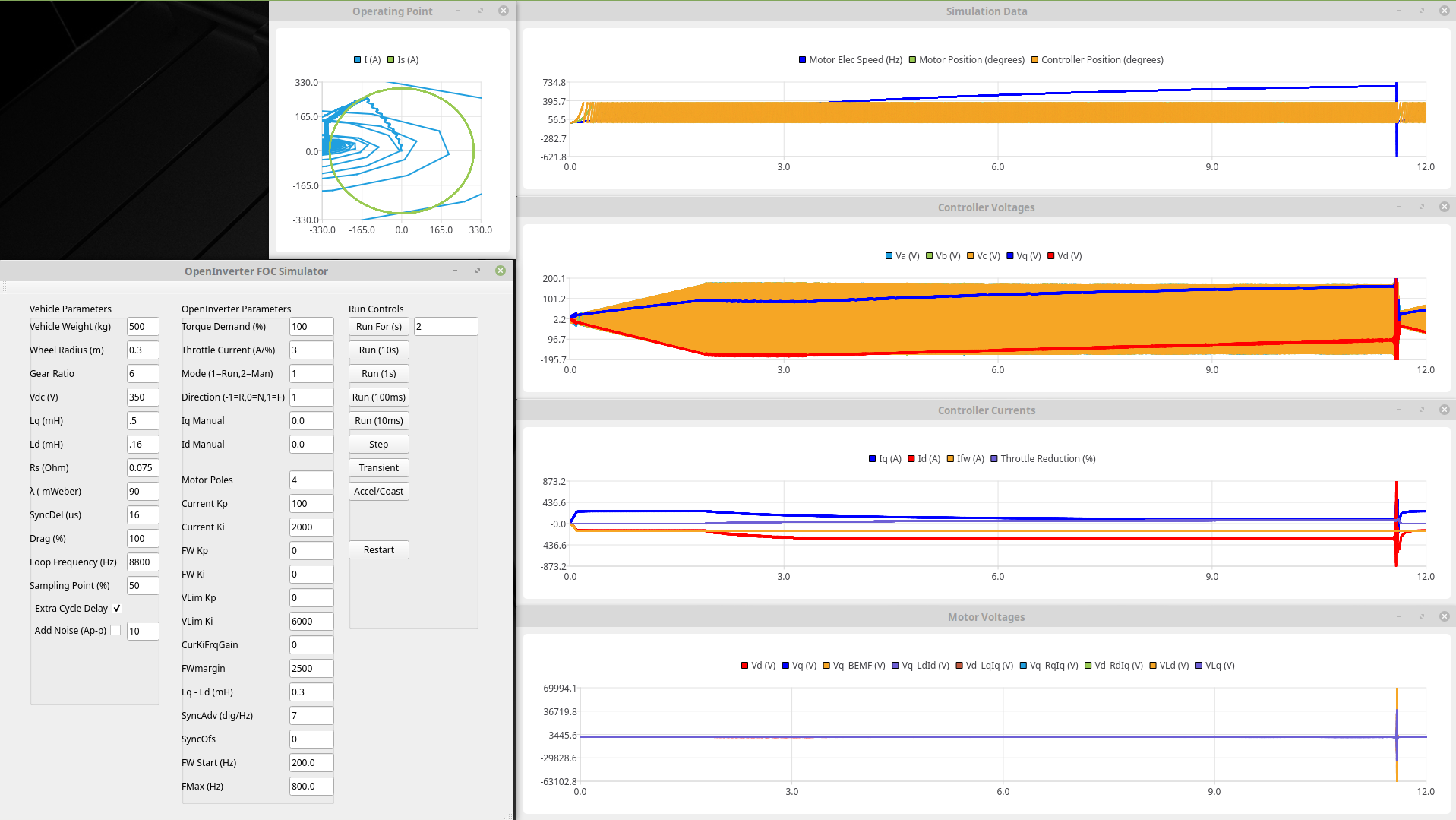

Tried the improved scheme. First plot with the limiter just aiming the trajectory at Icrit:
And next one that tried to adjust the trajectory to limit the amount of Iq reduced if there is plenty of margin on ud:
The second one, which should be slightly better, is slightly worse. What is happening is that the mod causes a bit of instability in the limiter control loop (seen in the disturbances on the Id and Iq traces) and this instability does more harm than the improved trajectory does good. Now this is for Icrit of 550A, it's quite possible that for motors with lower Icrit (but still outside the current limit circle) it may offer more benefits but I don't think it is worth it so am going to bin it for now.You do not have the required permissions to view the files attached to this post.

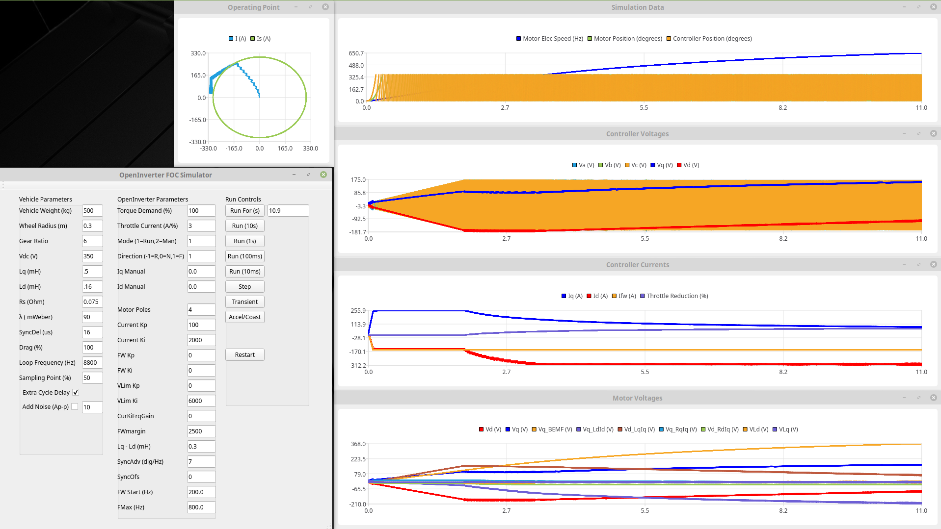

More plots!
I've now added the polar operating point plot for Iq Id. It's not as nice as I'd like as the QT chart doesn't seem to be able to put the axis in the center but it will do. It shows the Is (max current circle) and the trace shows how Id and Iq moved during the run (the start of the trace is at the origin).
I've had to run the plots 10ms at a time for the first sec while ramping the throttle to get a nice trace (the throttle ramps should do this with the real firmware).
First a low L motor: You can see the current following the Mtpa curve up to the Is limit and then moving towards Icrit as the voltage limiting kicks in. Once Id hits the neg limit it then starts ramping the Iq down towards zero. I'm not too sure why it isnt following the circumference of the circle as it moves towards Icrit but I think it's because I dont recalculate the max Iq following the change to Id (Iq = root(is*is - iq*iq) ).
Next what happens if you push the speed so high that there isn't enough Id to keep the voltages under control: You can see that the currents start circling round Icrit when the controllers go open loop. This is at around 11krpm (not a good idea to get to this point in real life!).
Next a high L motor: This time Icrit is 75A so once the limiter comes in it starts moving the operating point almost directly down. On different motors this could move to the left or right too dependant on how Mtpa's Id and Icrit match.
If the icrit parameter is badly guessed then this is what you get (motor model icrit at -50A, controller parameter at -75A): You can see the controller aiming for what it thinks is Icrit but actually ending up circling the real Icrit.
All interesting stuff - just hope it's somewhere close to reality!

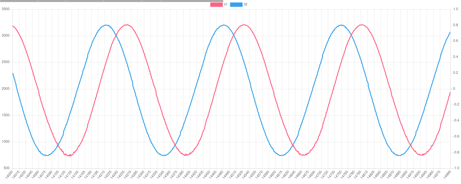

Yes we do have ADC2
Those are injected samples in the 10ms task stimulated with a 10 Hz sine wave with 90° phase shift

Now I'm thinking how to best make use of it.
a) "injected simultaneous mode"
Have ADC1 first convert sin-signal and ADC2 cos-signal (at the very same time) and next in sequence il1 and il2
That way there is virtually no offset between currents and angle sampling. Downside: no averaging or median takes place. That said no averaging is done on the resolver anyway and it isn't too noisy. Other downside: currents are not sampled at mid-PWM
b) leave resolver sampling as it is and trigger injected conversion of il1 and il2 on ADC2 at mid-PWM
c) Have ADC2 free running with DMA like right now, just not disturbed by sampling the other 6 signals. Not that trivial as ADC2 doesn't have its own DMA channel but uses the upper 16 bit of ADC_DR(ADC1)

More news from ADC2
Noise level: Again the least noisiest way seems to be discarding the first sample. Averaging of two samples didn't reduce noise. I think the spikes are from the wifi module of my rather old test board. Newer ones have better filtering.
And a nice sine wave (20 Hz) In comparison noise level of 3-median ADC sampling: I'd say it's about half the noise
More news from ADC2

The typical noise level on that last plot looks pretty good, what are the big negative spikes though?
Interesting that averaging doesn't reduce it, that suggests that its not true random noise. Also interested to know what causes the first sample noise, I've used the adcs in these chips in that mode before, in fairly high precision measurements, without seeing the effect.
Which sampling scheme are you going with?

Definitely wifi module.
Here is a chart with it removed and not even discarding the first sample:
