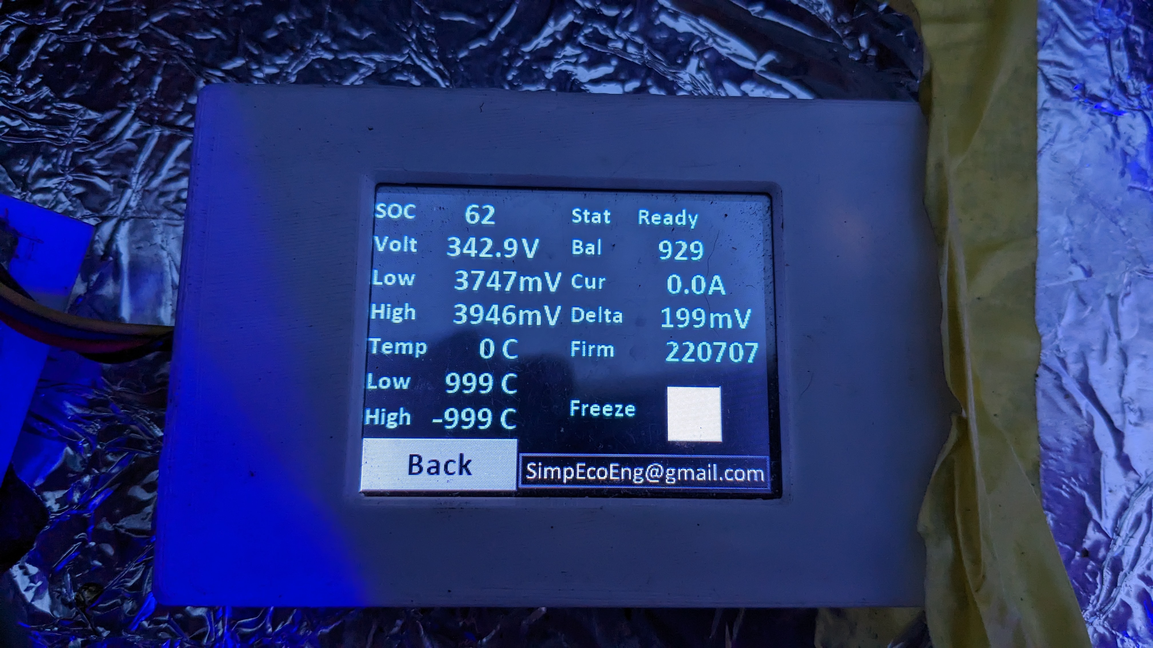

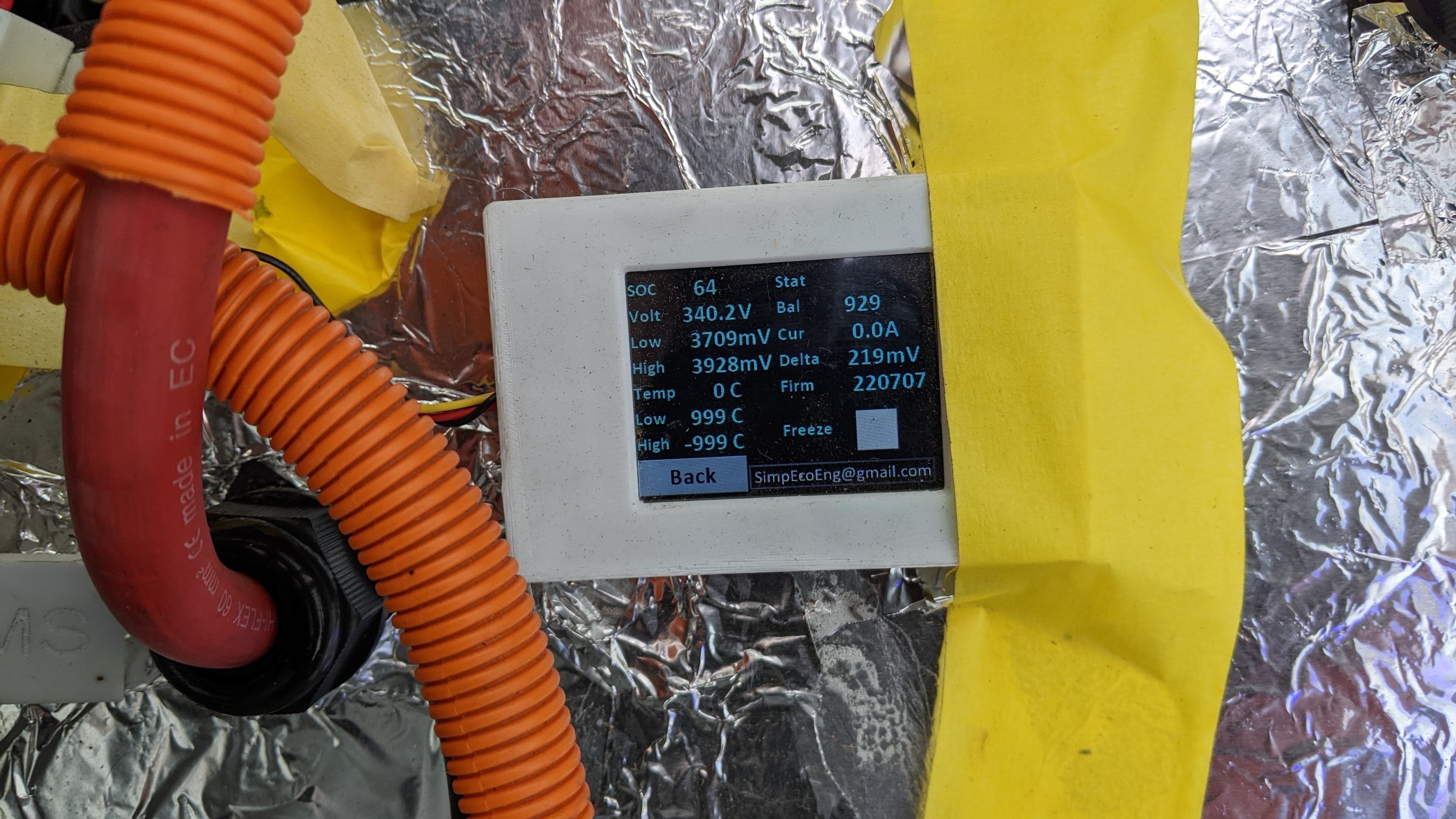

Has anyone else found their Tesla slave boards not balancing with SIMP? I've had my setup in for a couple months now and sorted out all the issues I had with voltage readings, which was caused by poor soldering of cell taps onto the boards.
I have played around with the balance settings quite a bit, it will say that it is balancing when a cell hits a set voltage as it should do. However I can leave it overnight multiple times and there will be 0 difference in the delta. Although it does seem to be changing slowly over very long periods. It looks like I have lowered my delta by around 20mV in 3 months. Although it has not been on 24/7 for all that time and they are 53aH cells. Could it just be a case that these boards are not really designed to balance that fast?
This is from the 28th September
This is from this morning at a very similar high cell voltage.

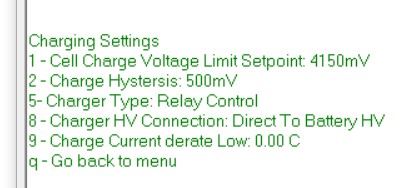

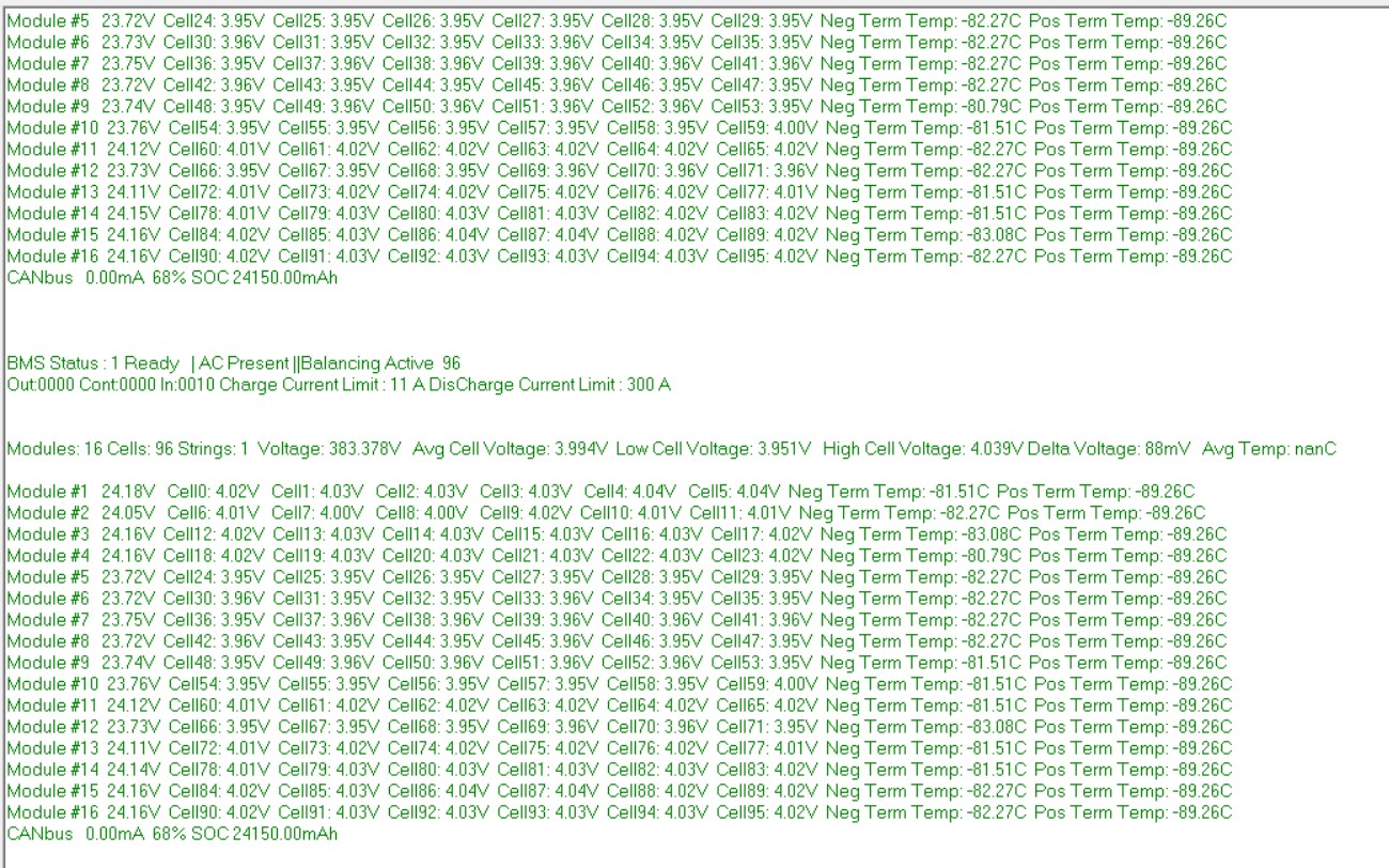

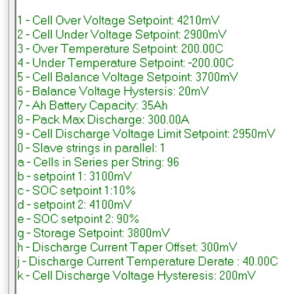

I realize the above is a very old post, but after spending hours on this I haven't been able to find an answer.
A/C is present | cell voltage limit not reached, but BMS stays in Ready or Drive state. Why?
ran output debug and charge enable is cycling.
I am not using a current sensor or temp sensors.
I need to get the charge enable output working and this seems to be the missing piece.

This came up in another thread a few weeks ago. The hysteresis value is too high and also the battery is almost fully charged. I am not totally sure on this but If you reduce the charge hysteresis to 100mV it might work.
