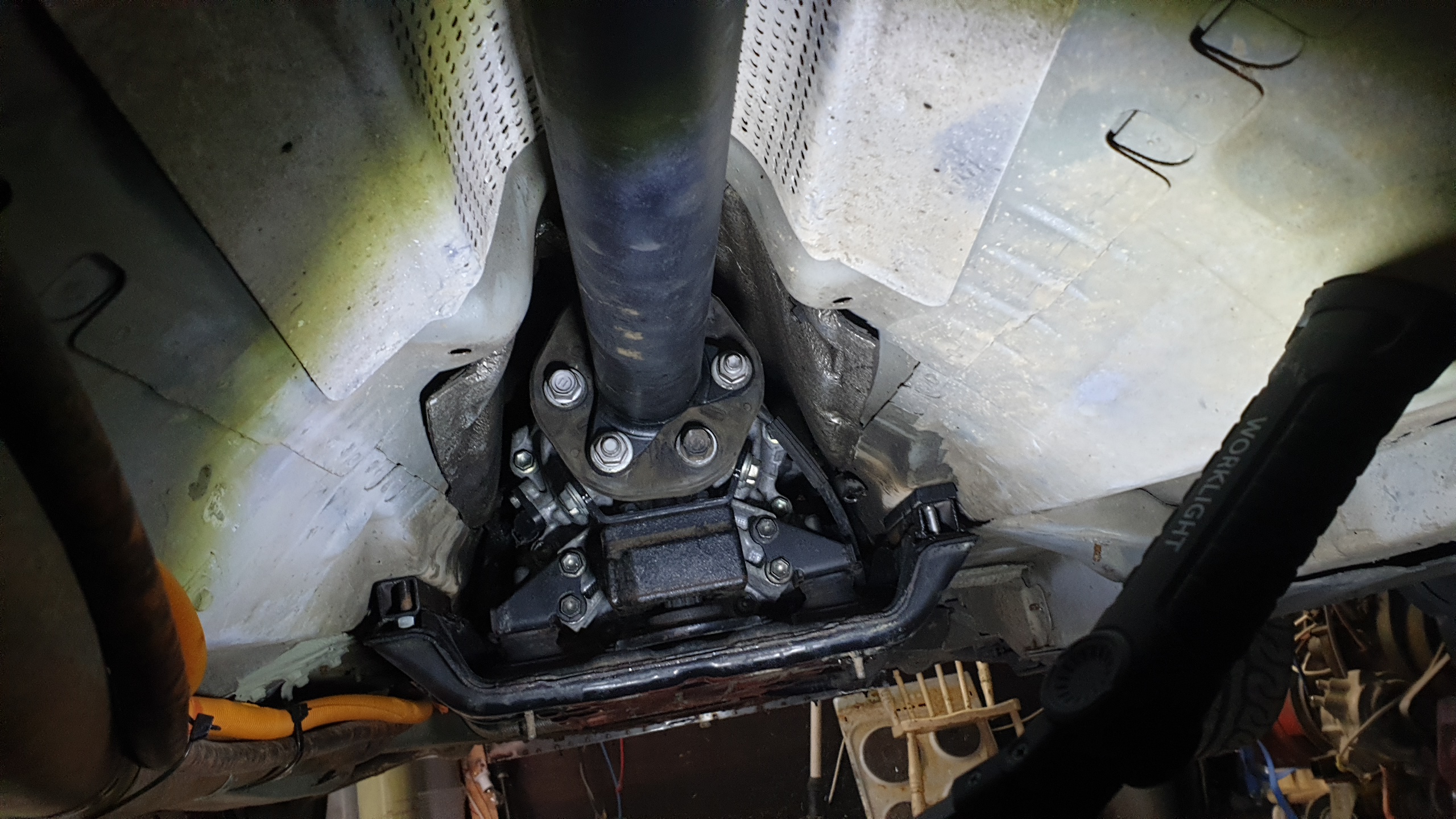

Inverter fitted. Collected the modified driveshaft and its a perfect fit. Spent yesterday on wiring integration with the VCU so with luck first wheel spins next week. Am in the process of sourcing a VW onboard charger so will need to hack that and with a bit of luck will make a new vcu module to run it.

Looking good. Curious on the charger change - current charging needs an upgrade?

Well part of why I build cars is as test beds for things I'm developing or hacking. Noticed there are very few options for low power on board AC charging so decided to give the VW a go as they are plentiful and cheap. May as well use the E39 for testing and development.
