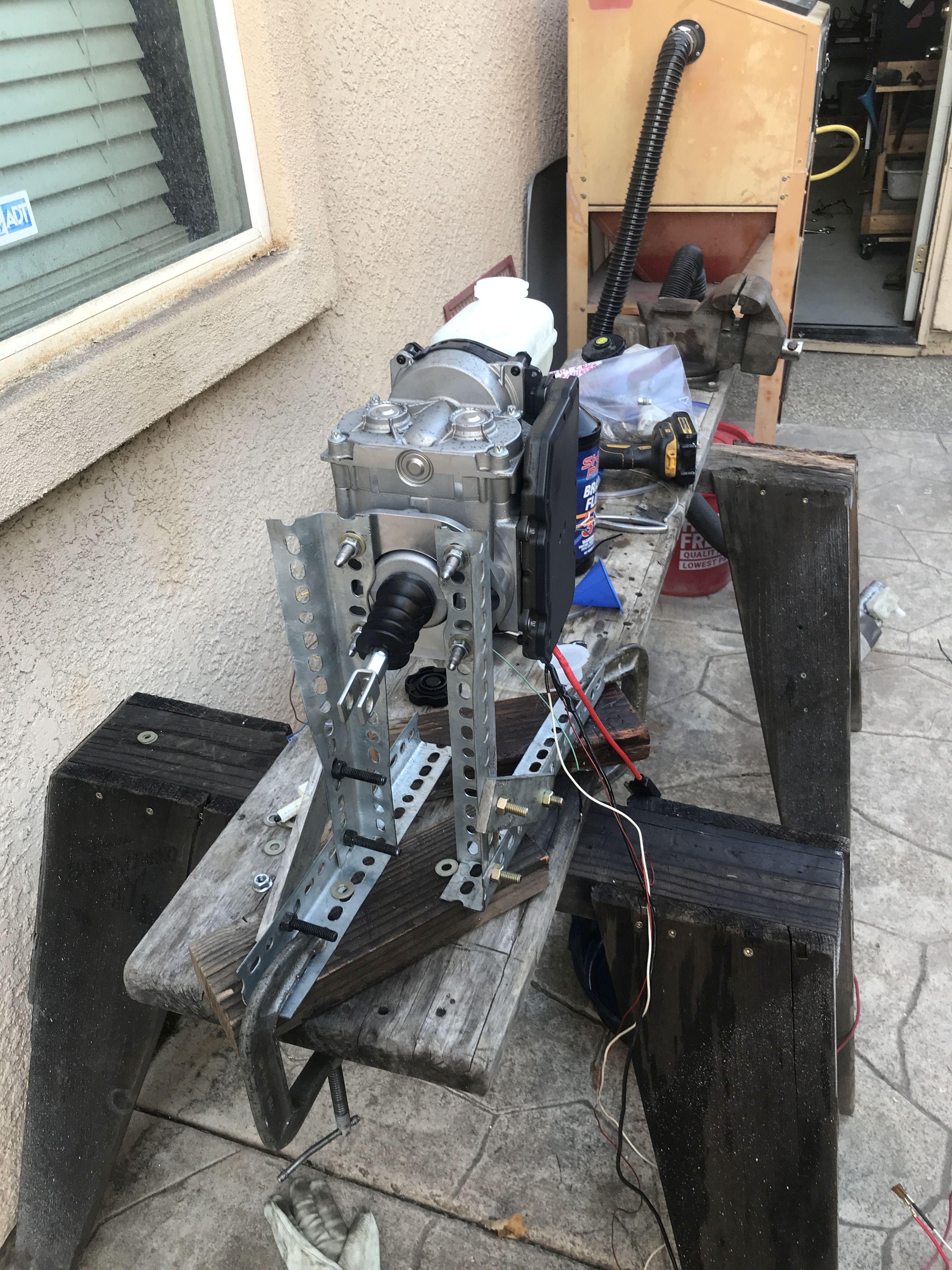

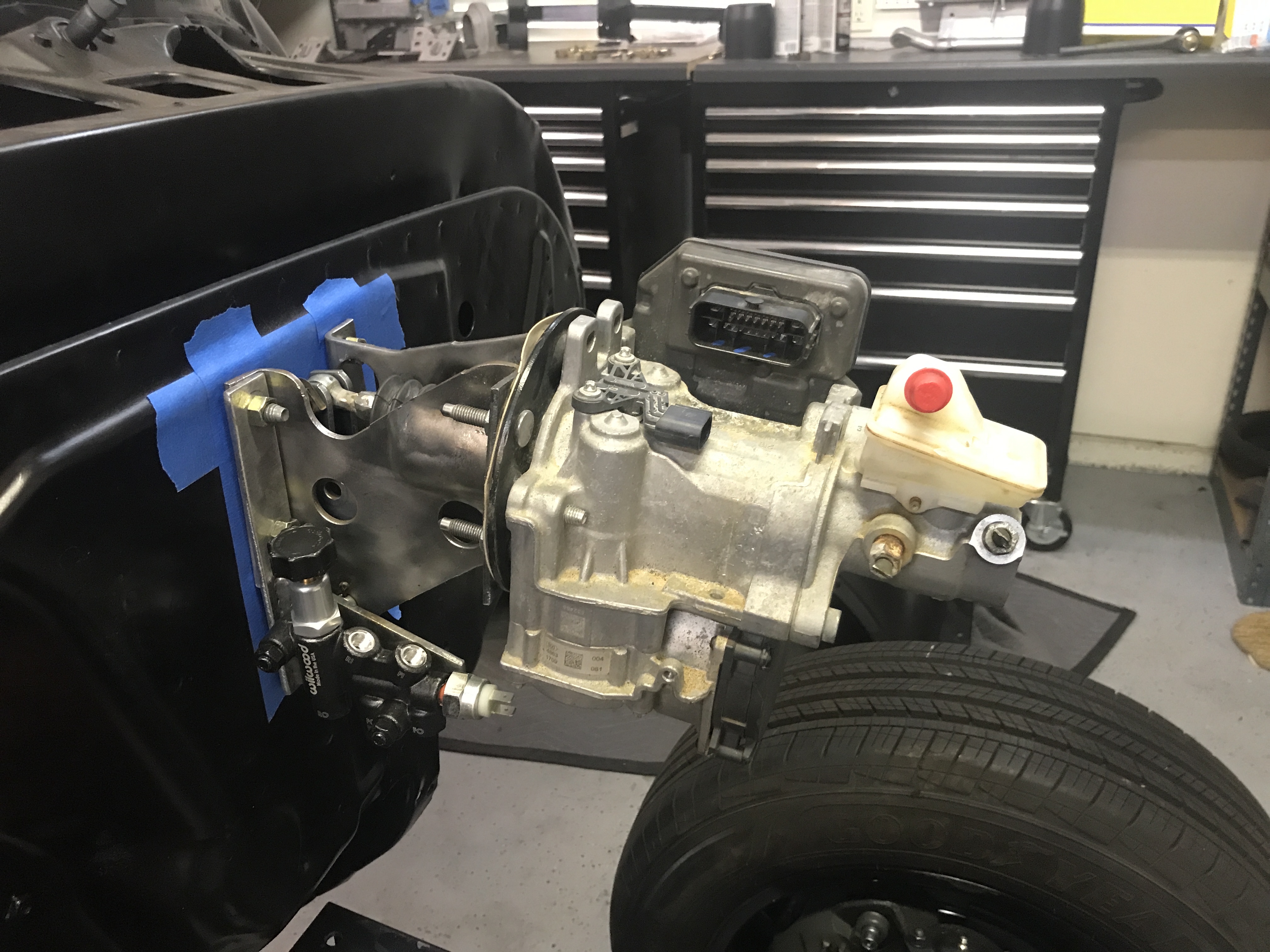

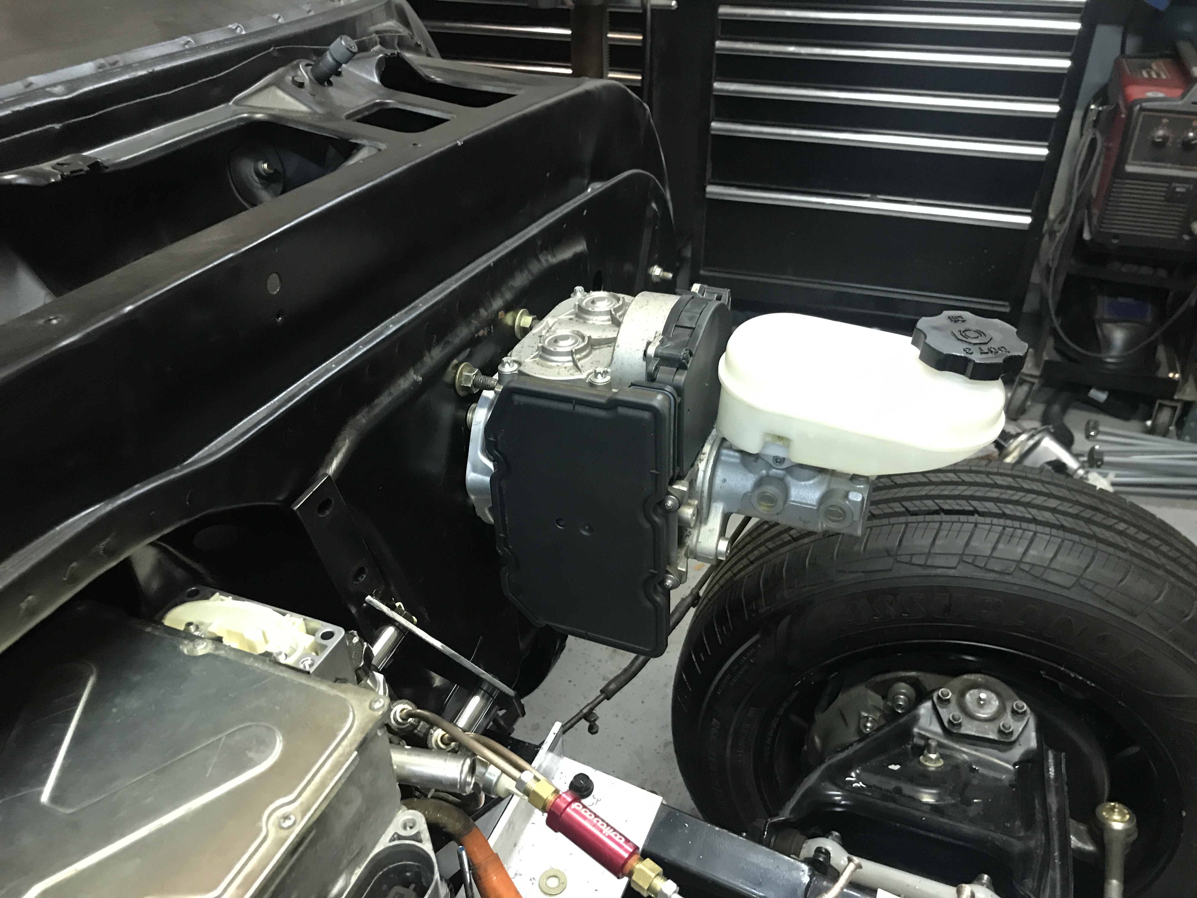

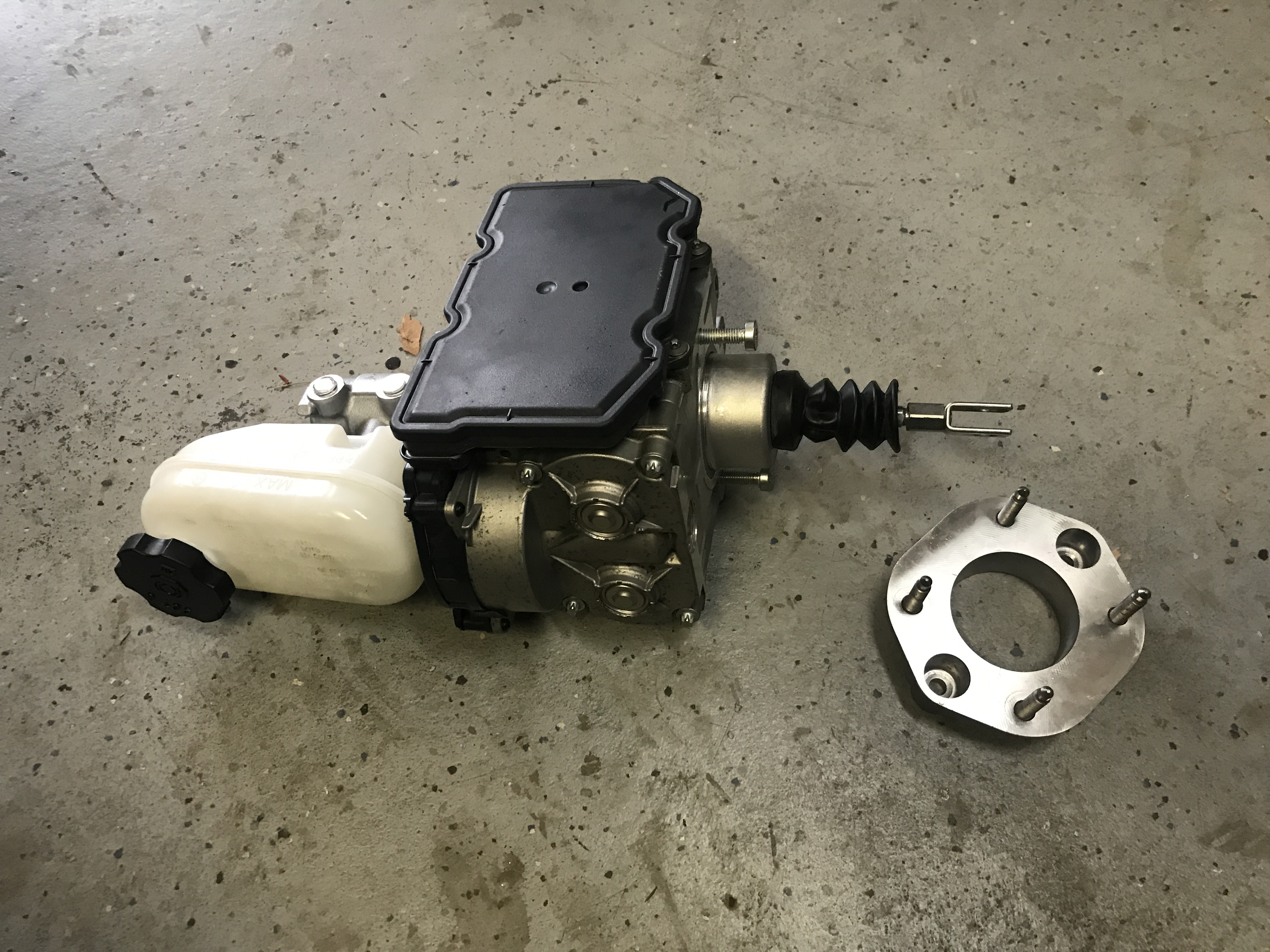

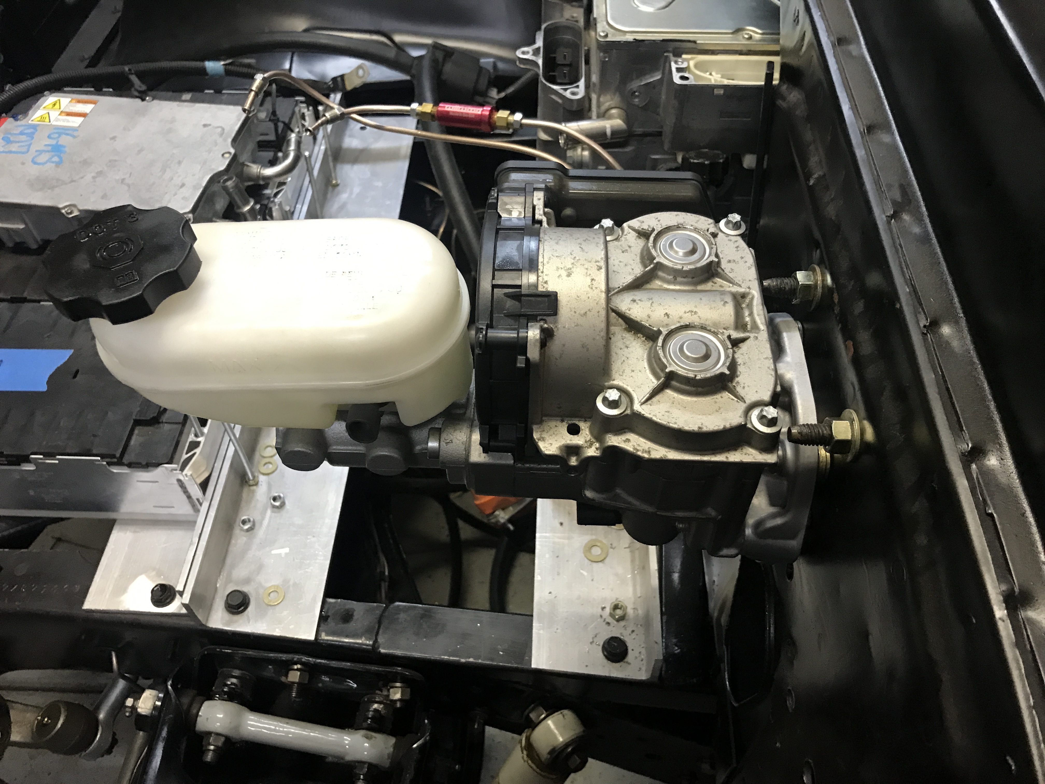

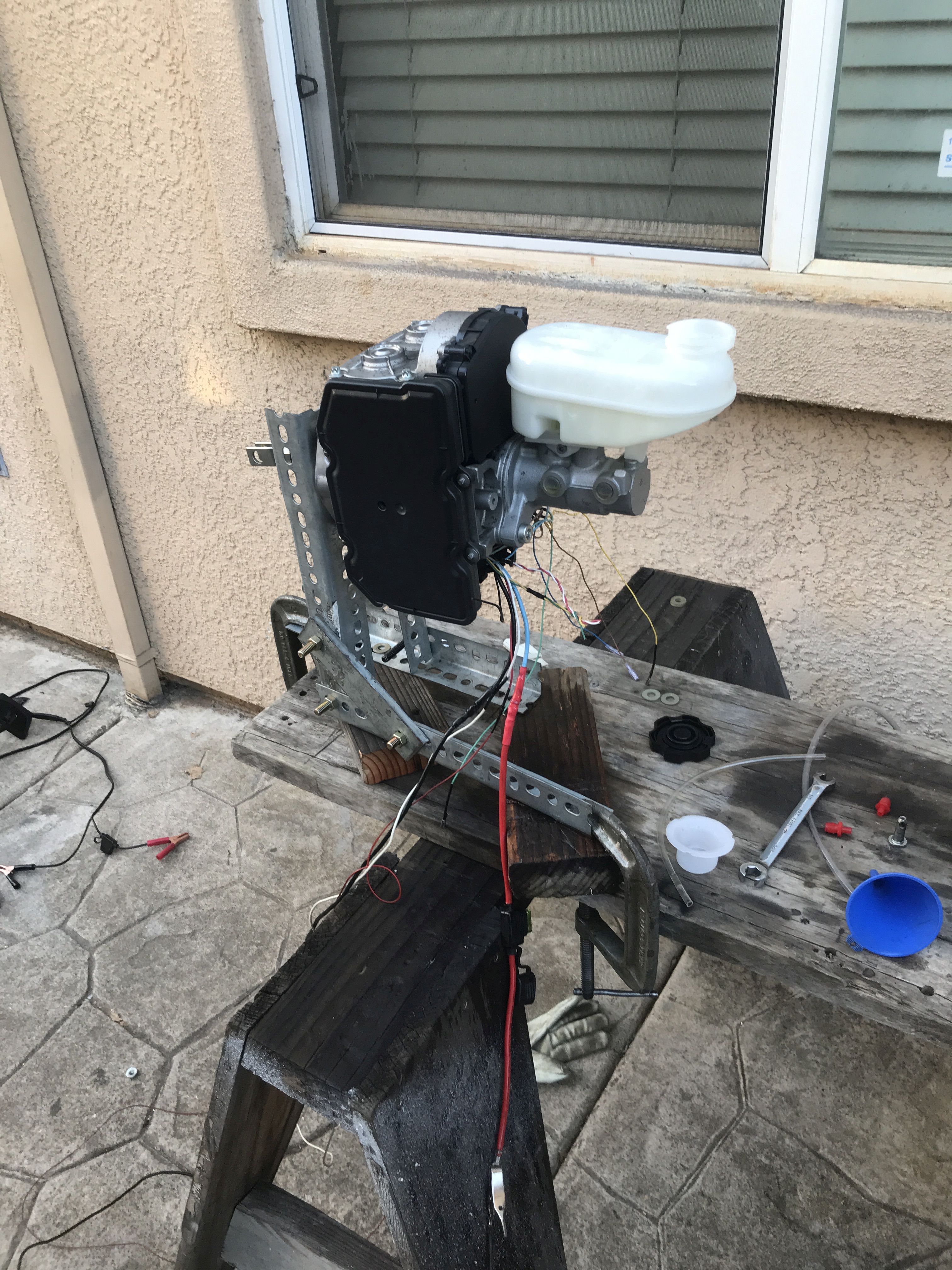

so first thing I done did was bench test this Tesla Model S BOSCH iBooster gittie up since the seller offered it at nearly 50% discount since he never tested it and could assure me it was in working order, s fingers crossed I wired it up using my Honda CRV iBooster wiring harness of the same generation
and she roared to life

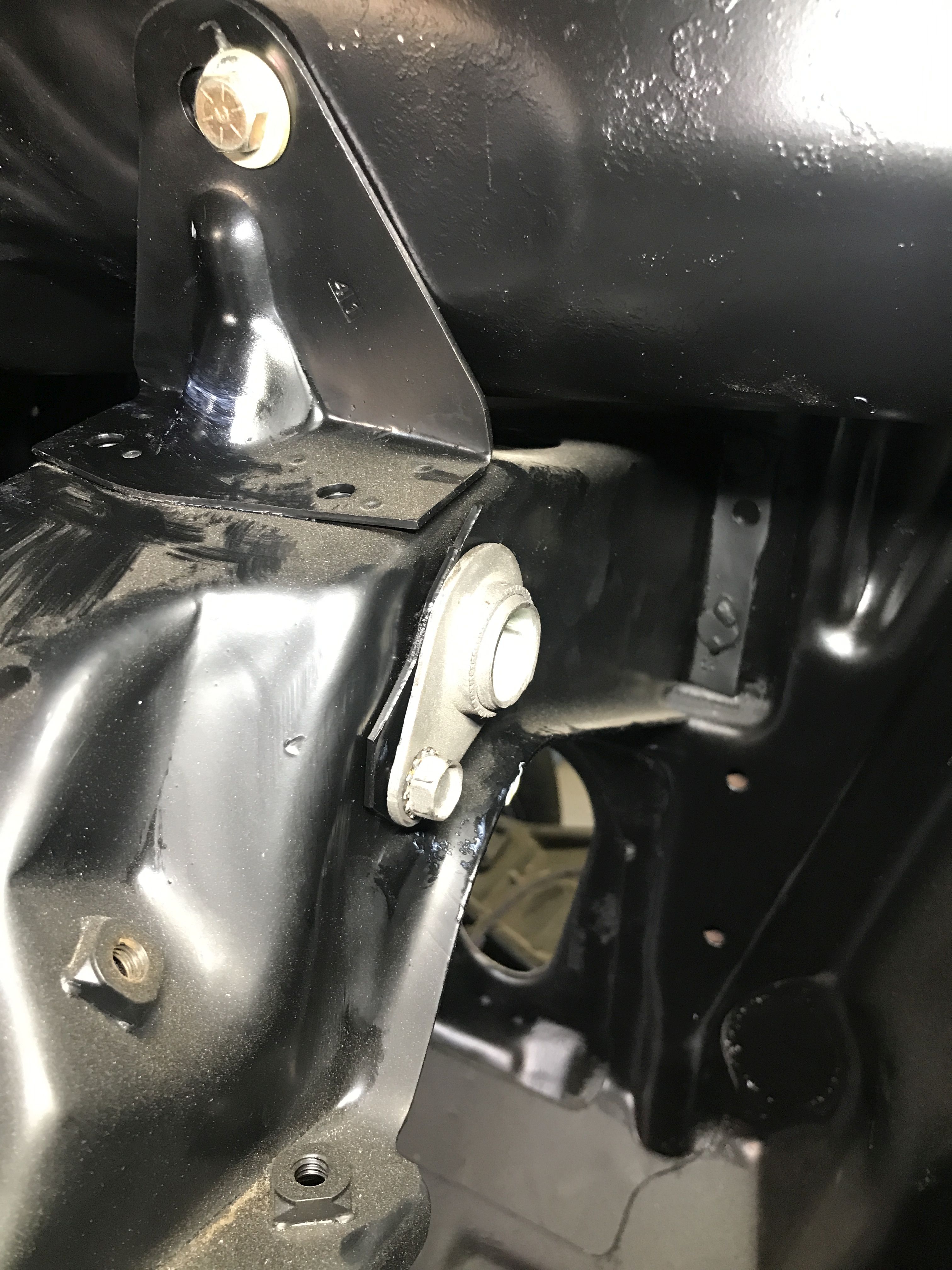

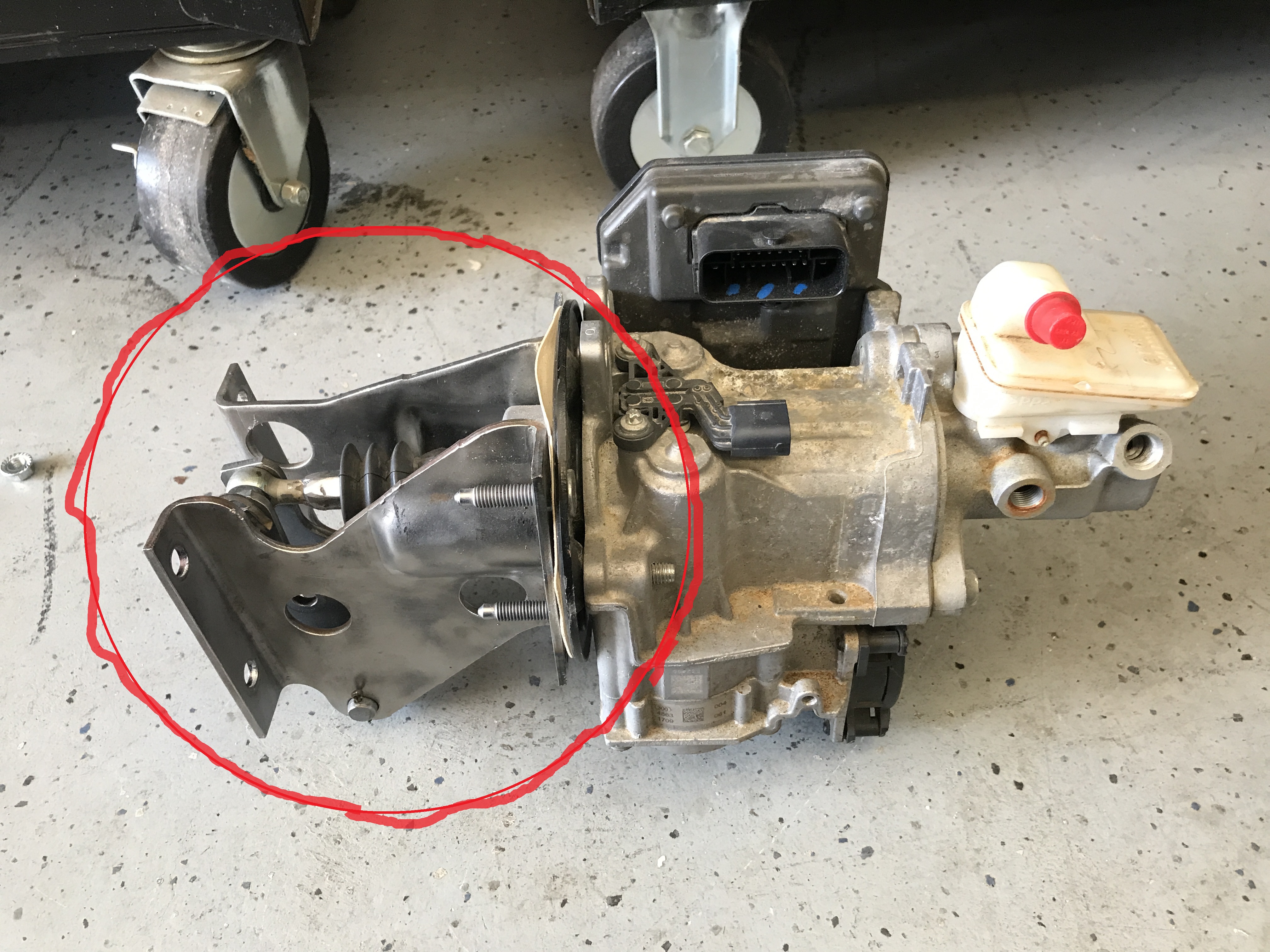

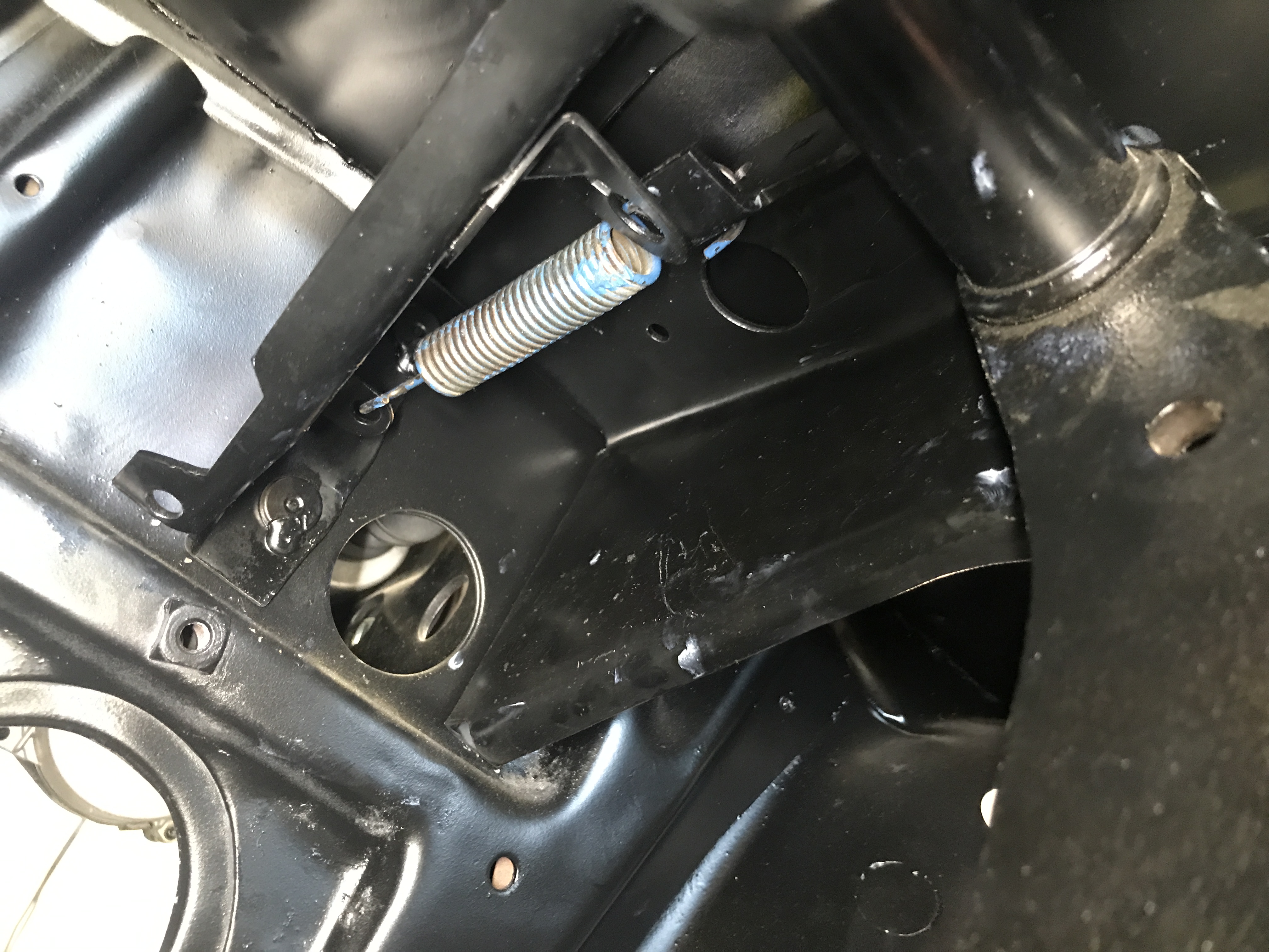

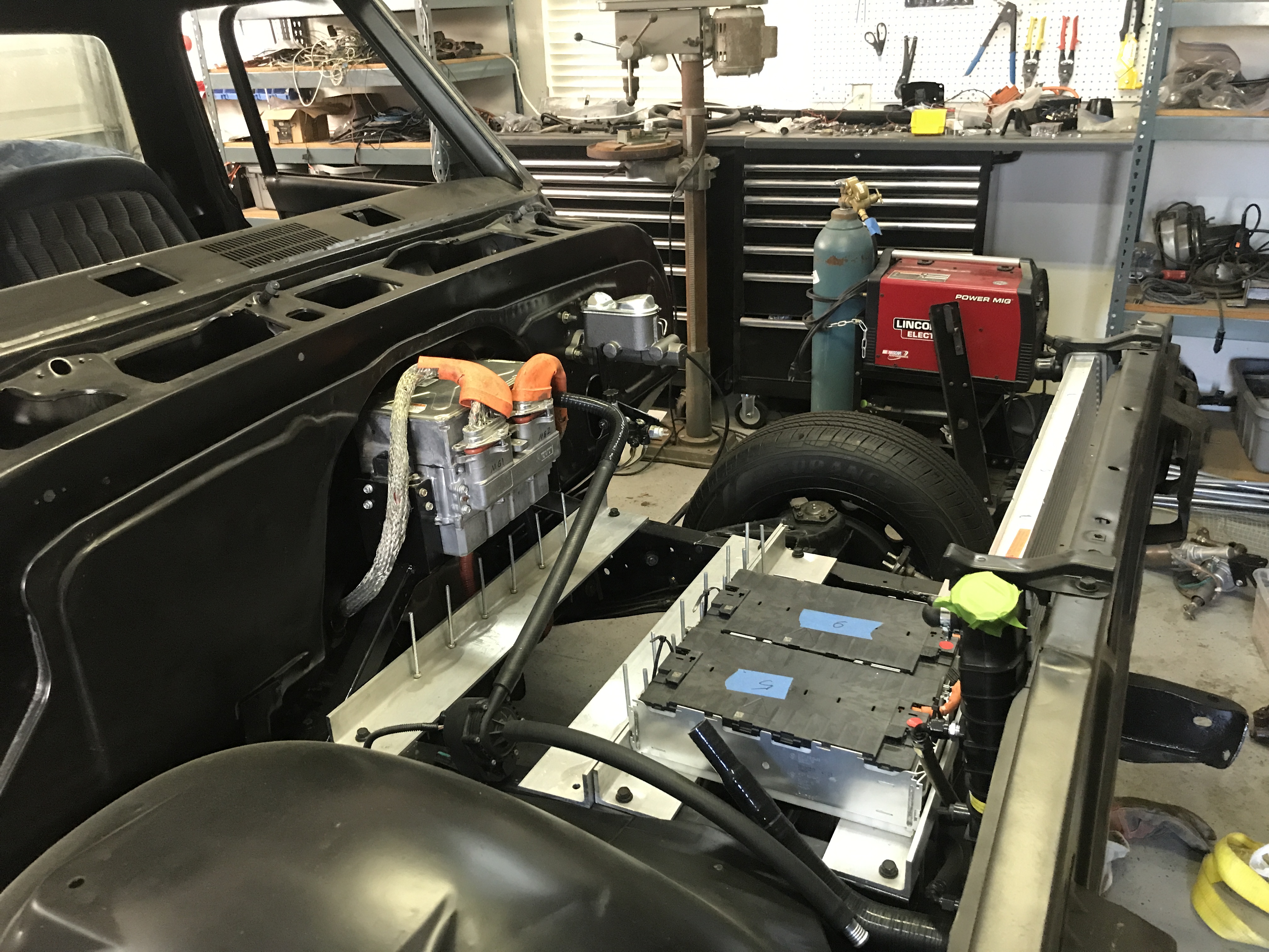

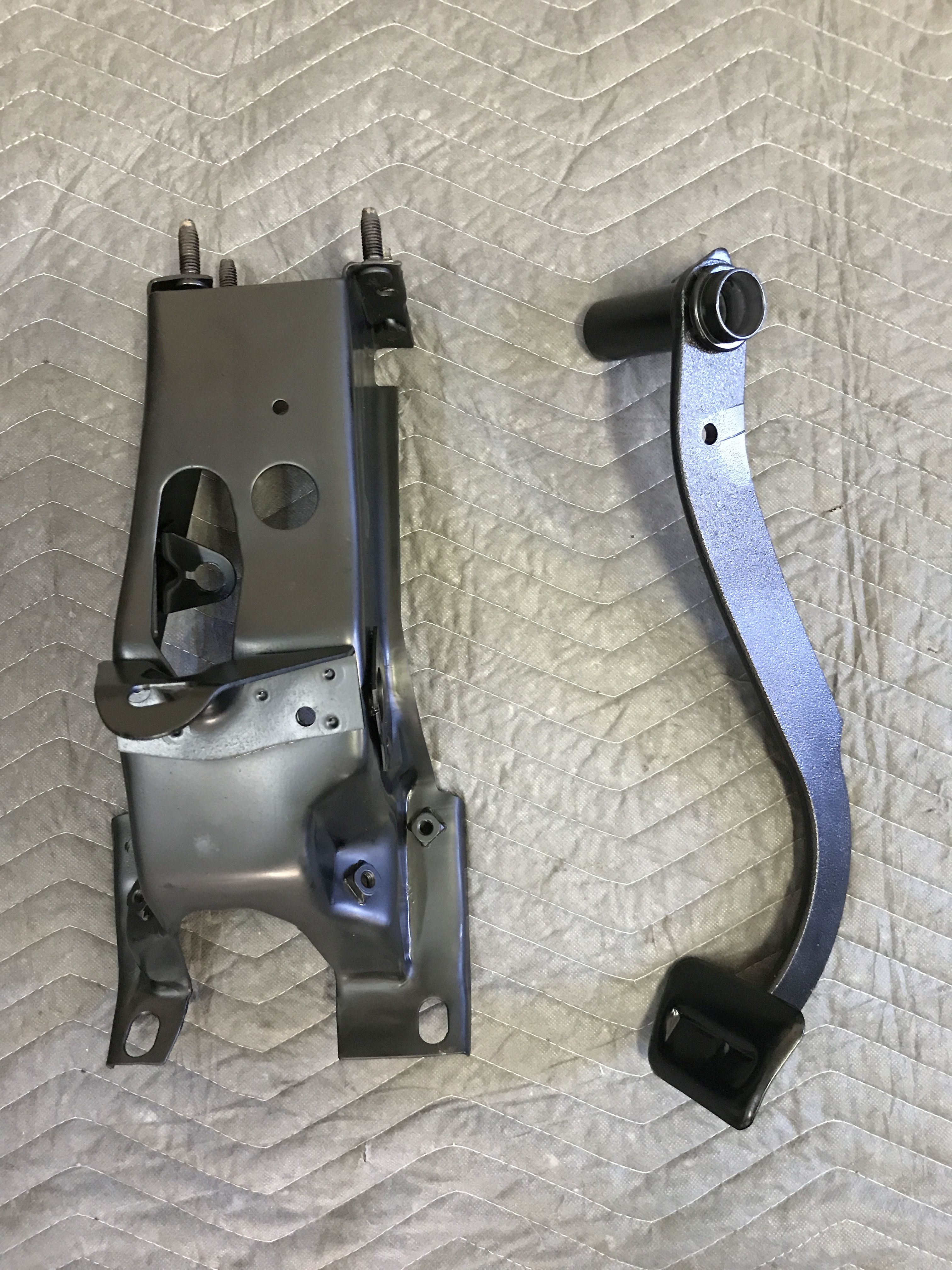

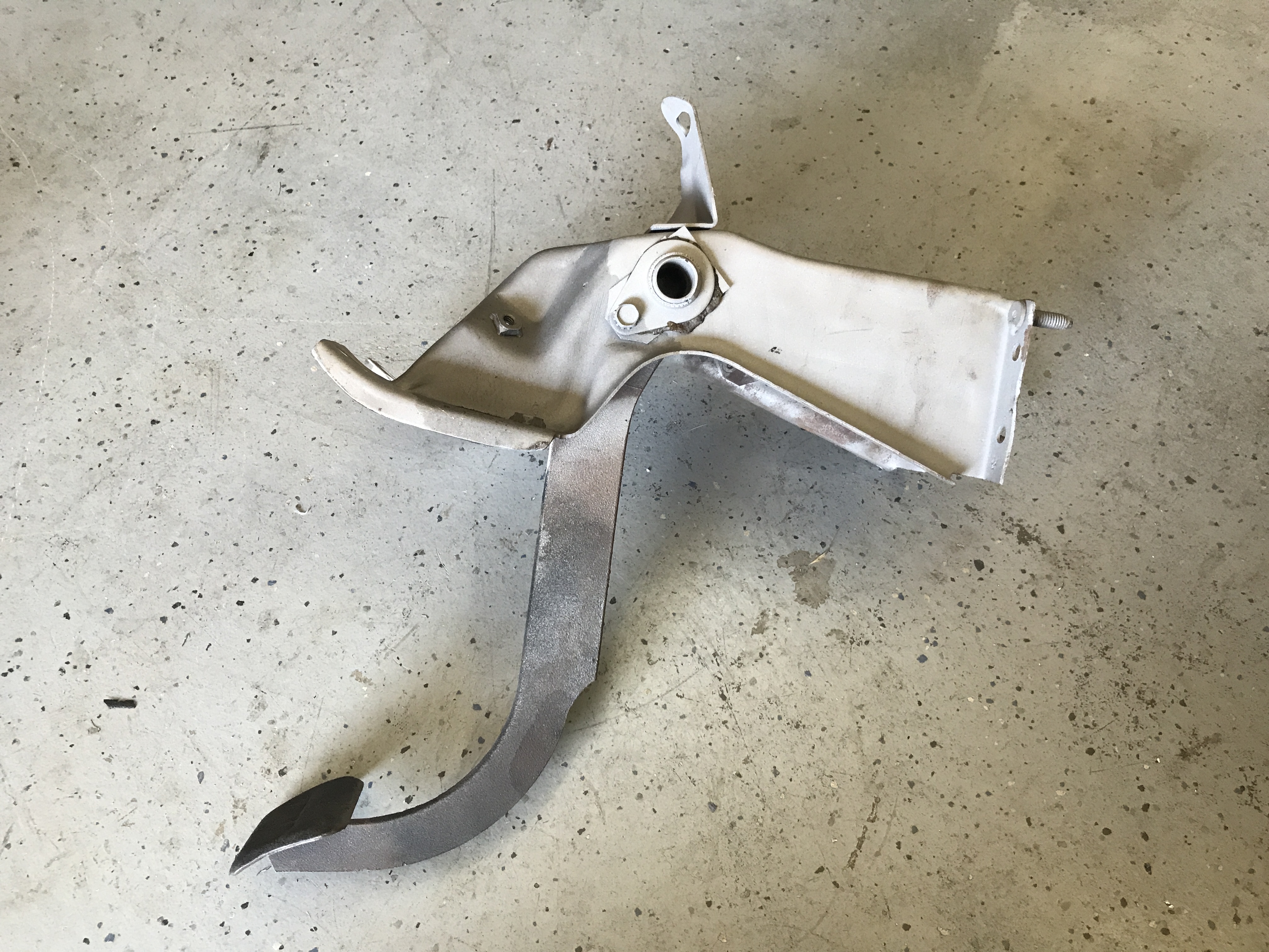

so something that has been bothering me during this entire brake setup ordeal is this silly Chevrolet original brake bracket that offsets the booster and master cylinder like 10" further away from the firewall and uses a leaver effect to multiply the pressure applied by the pedal, in other words the push rod from the brake pedal does not go straight directly into the booster but it sorta forms a Z if you can picture it
the rod from the actual brake pedal pushes on the bottom of this bracket which then transfers that force to the rod above it and that's the rod that applies pressure on the actual brake booster, my buddy Patrick who is way smarter than me, figured out how much it multiplies the force by measuring stuff and pressing buttons on a calculator and such

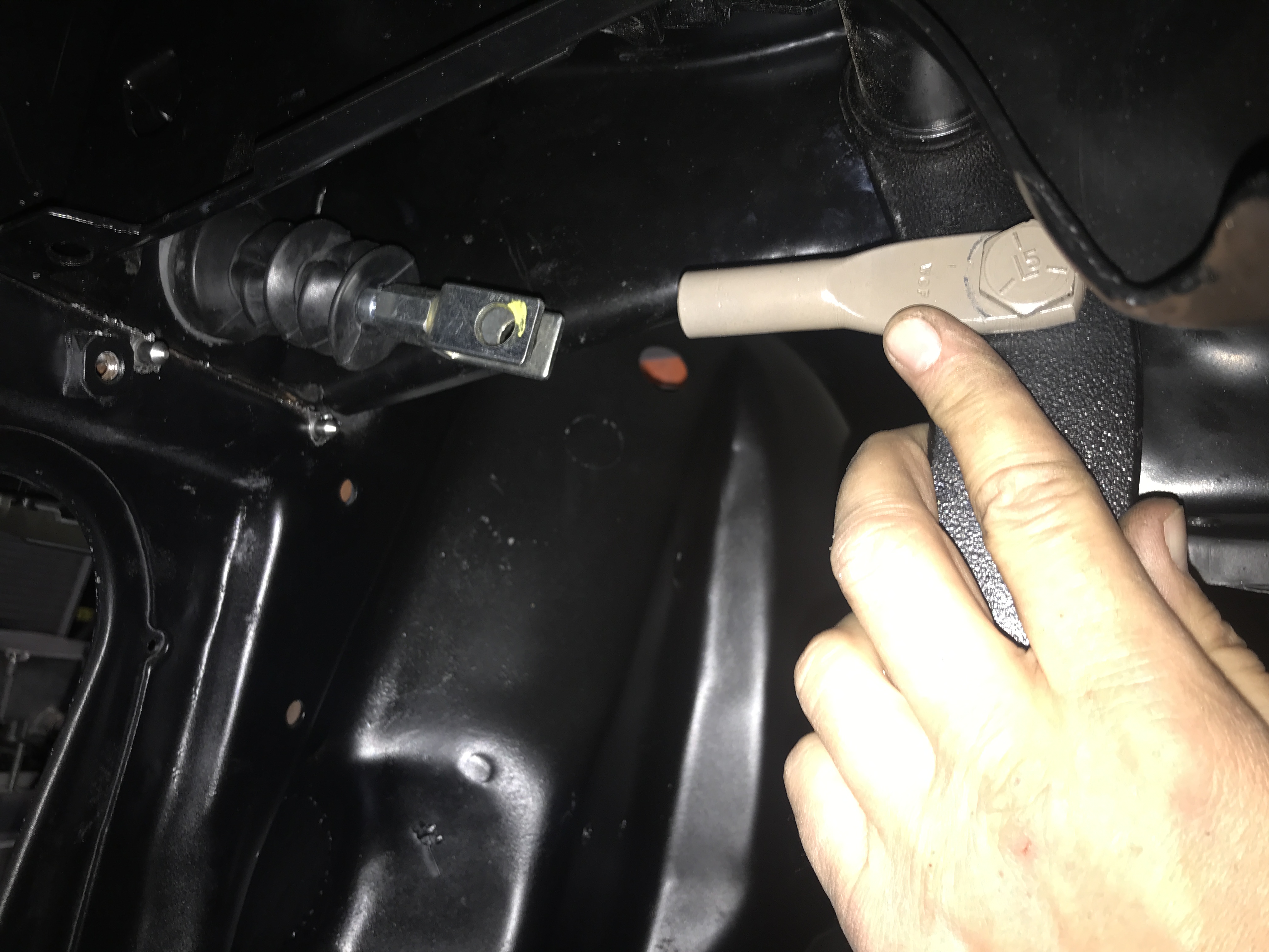

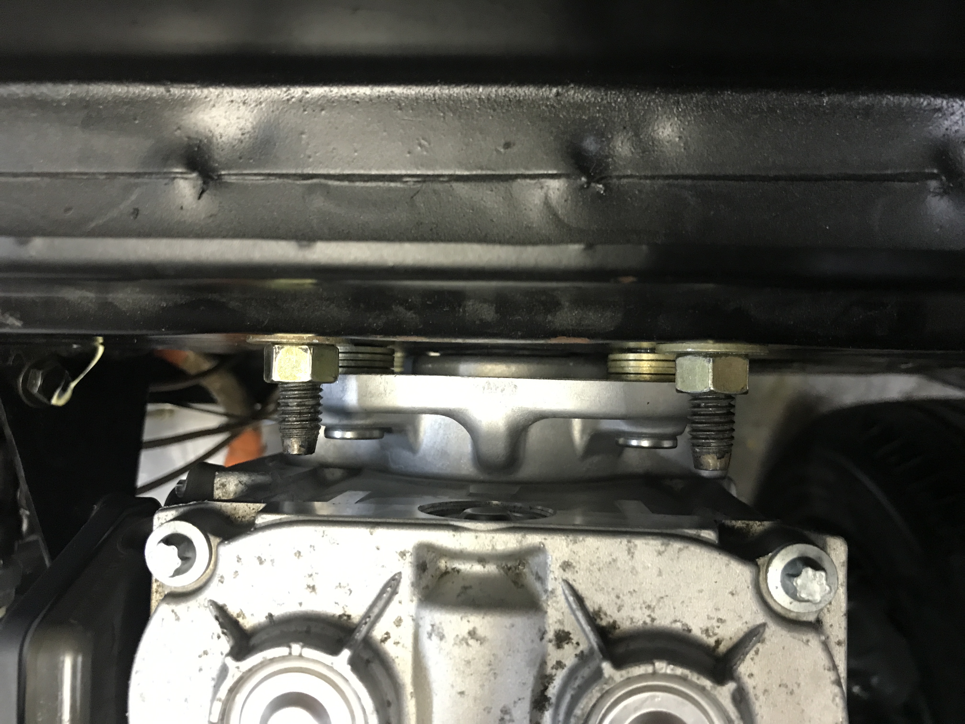

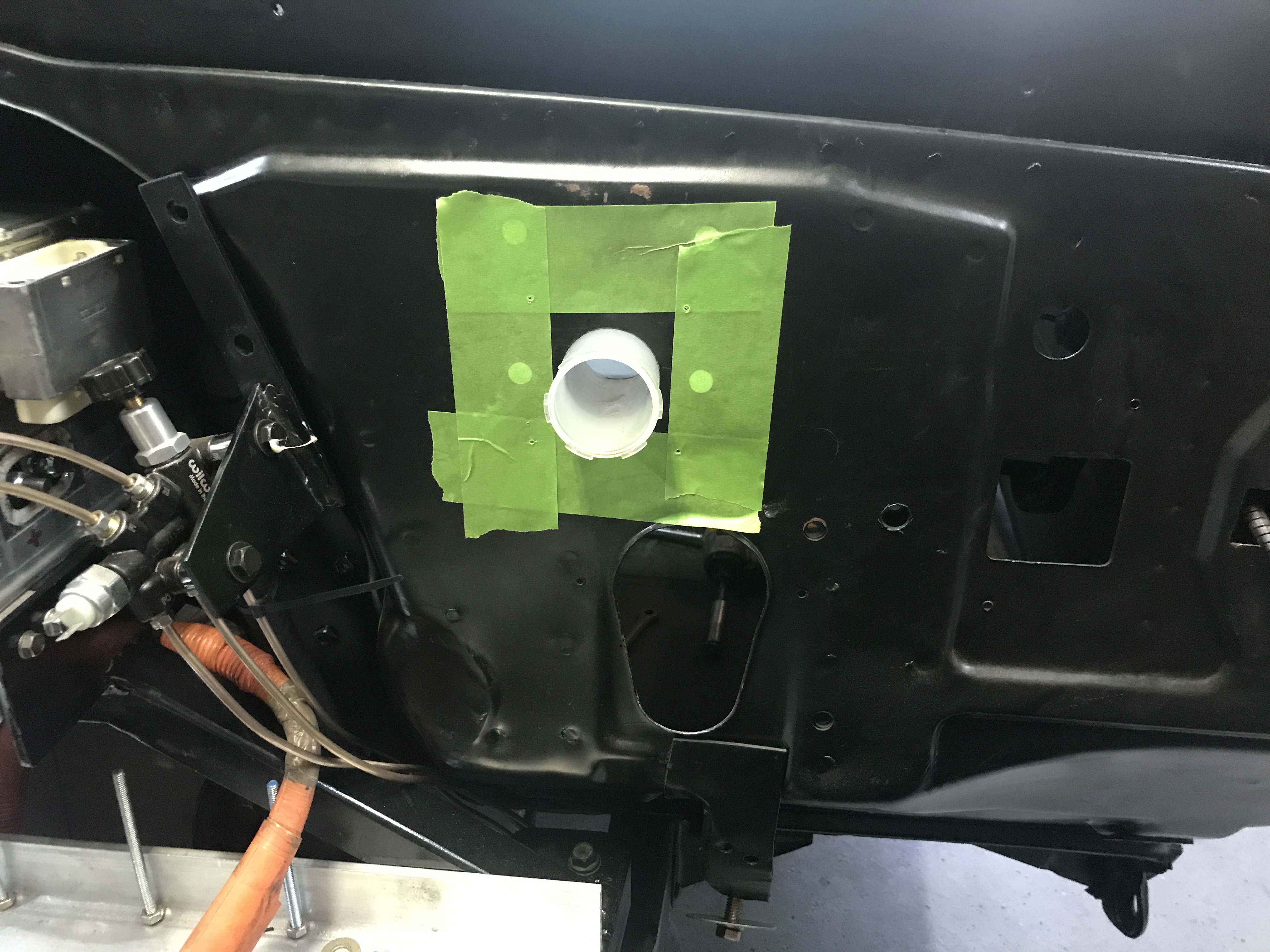

so we don't want that offset bracket we want to mount this iBooster flat against the firewall like Elon intended like so
but since she don't wanna sit flush just the way it comes out of the box, we had to moch it up with some spacers
just to see how and if we can mate the Tesla booster push rod the the GM pedal pushrod like so

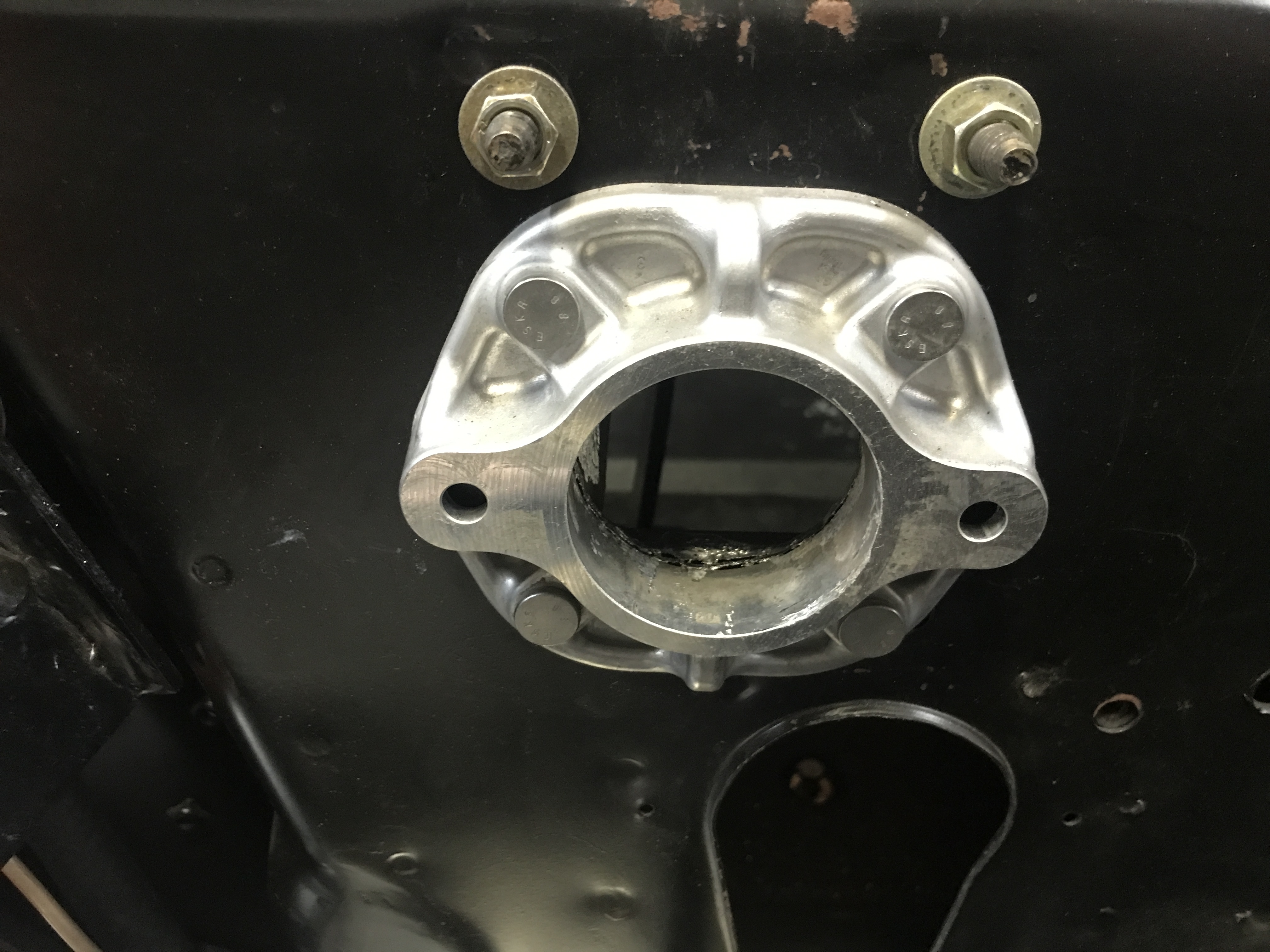

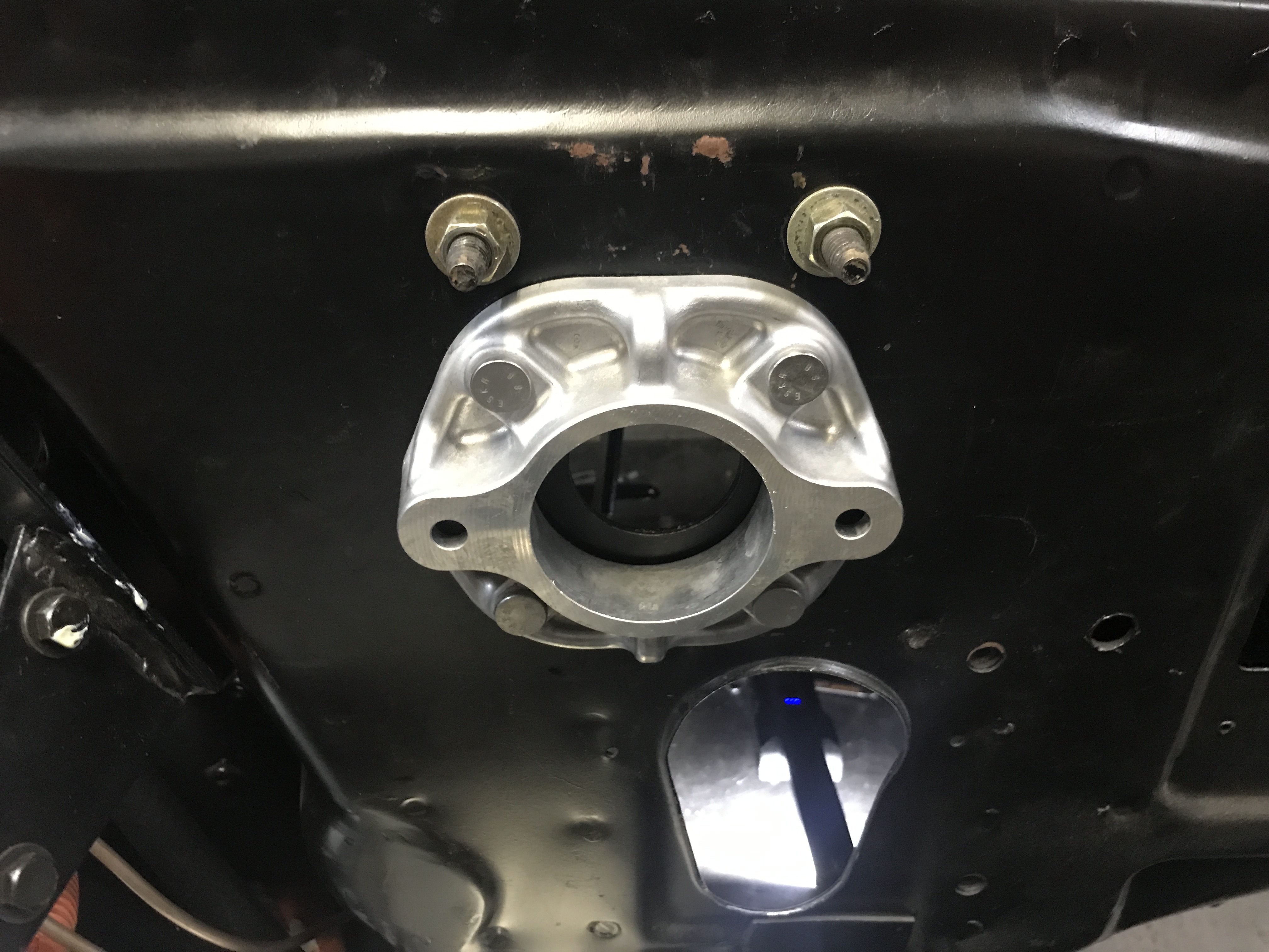

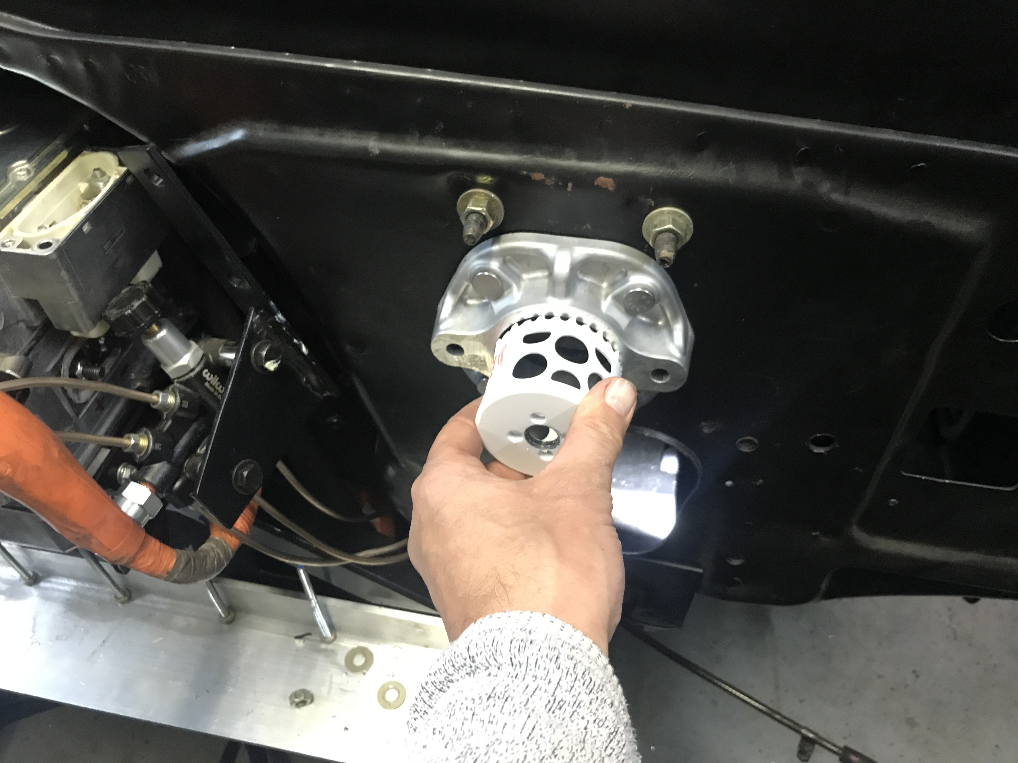

did I mention the Tesla Model S BOSCH iBooster comes with this secy aluminiuniunium round super duper bracket adapter thingie
using the Mighty Vac brake pump jug as a pilot hole centererer tool

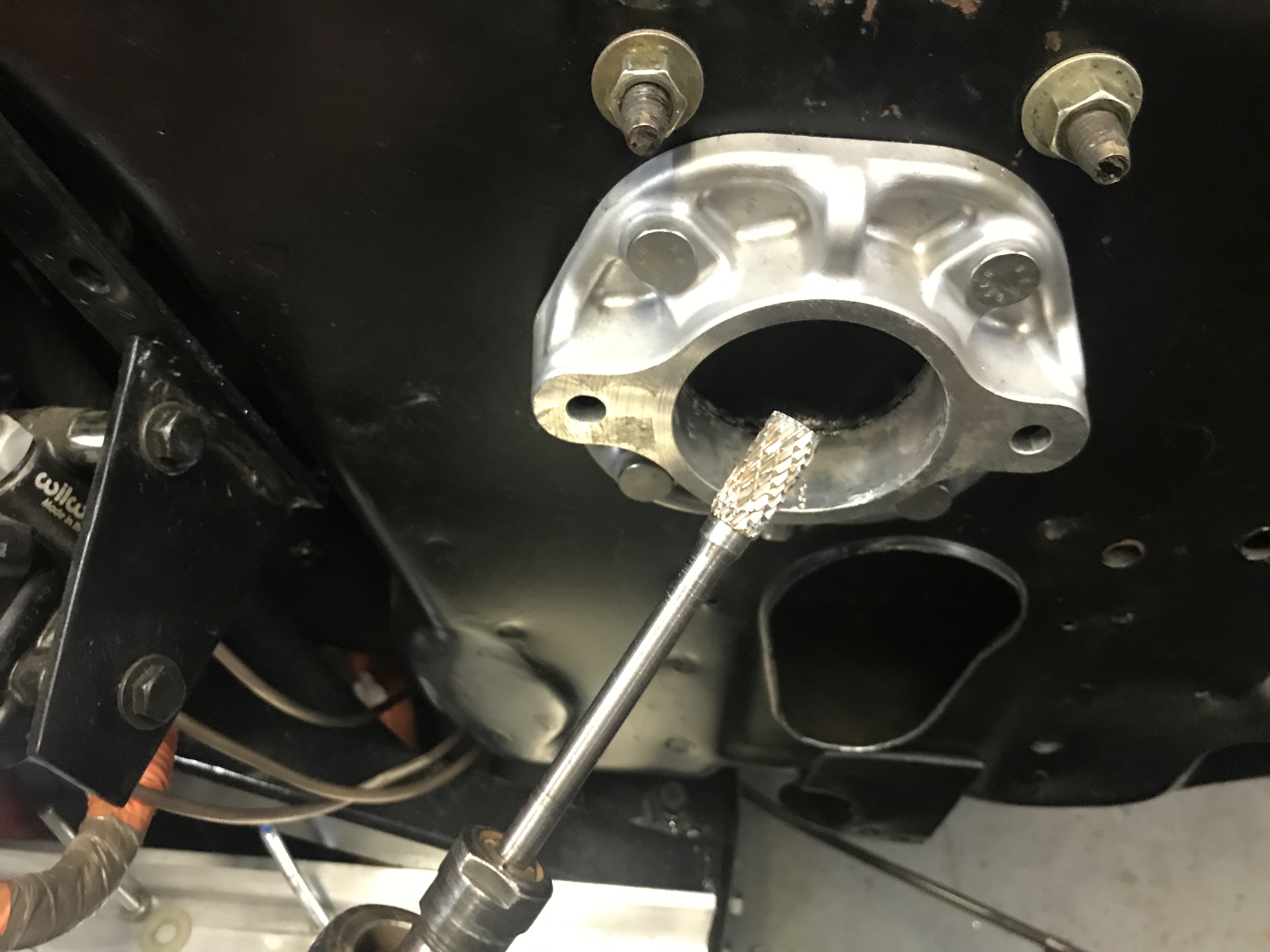

I absolutely have no luck with these Milwaukee hole saws, them and I don't get along, here I demonstrate how a 2 1/2" hole saw does not fit into a 2 1/2" hole

this gave me the opportunity to hone my skills with my fairly newly acquired toy: The Grindinator

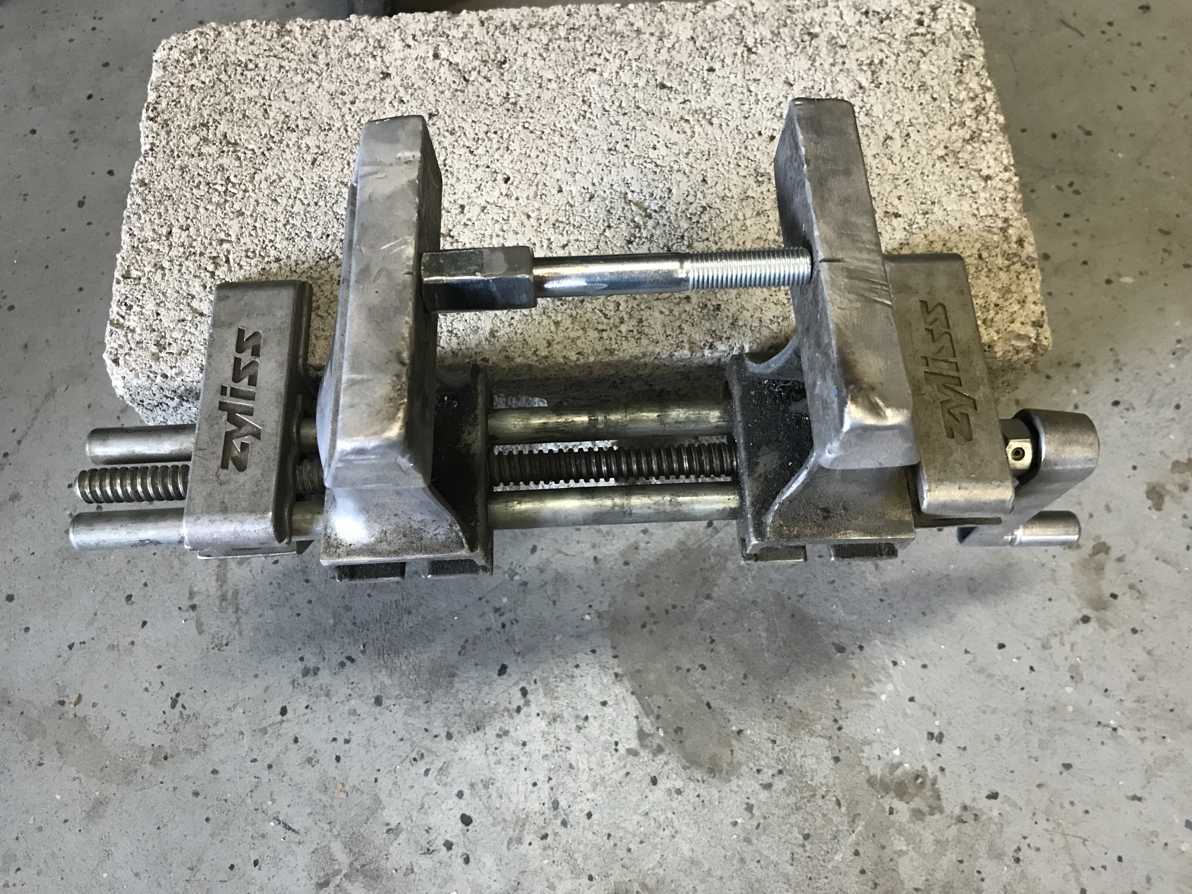

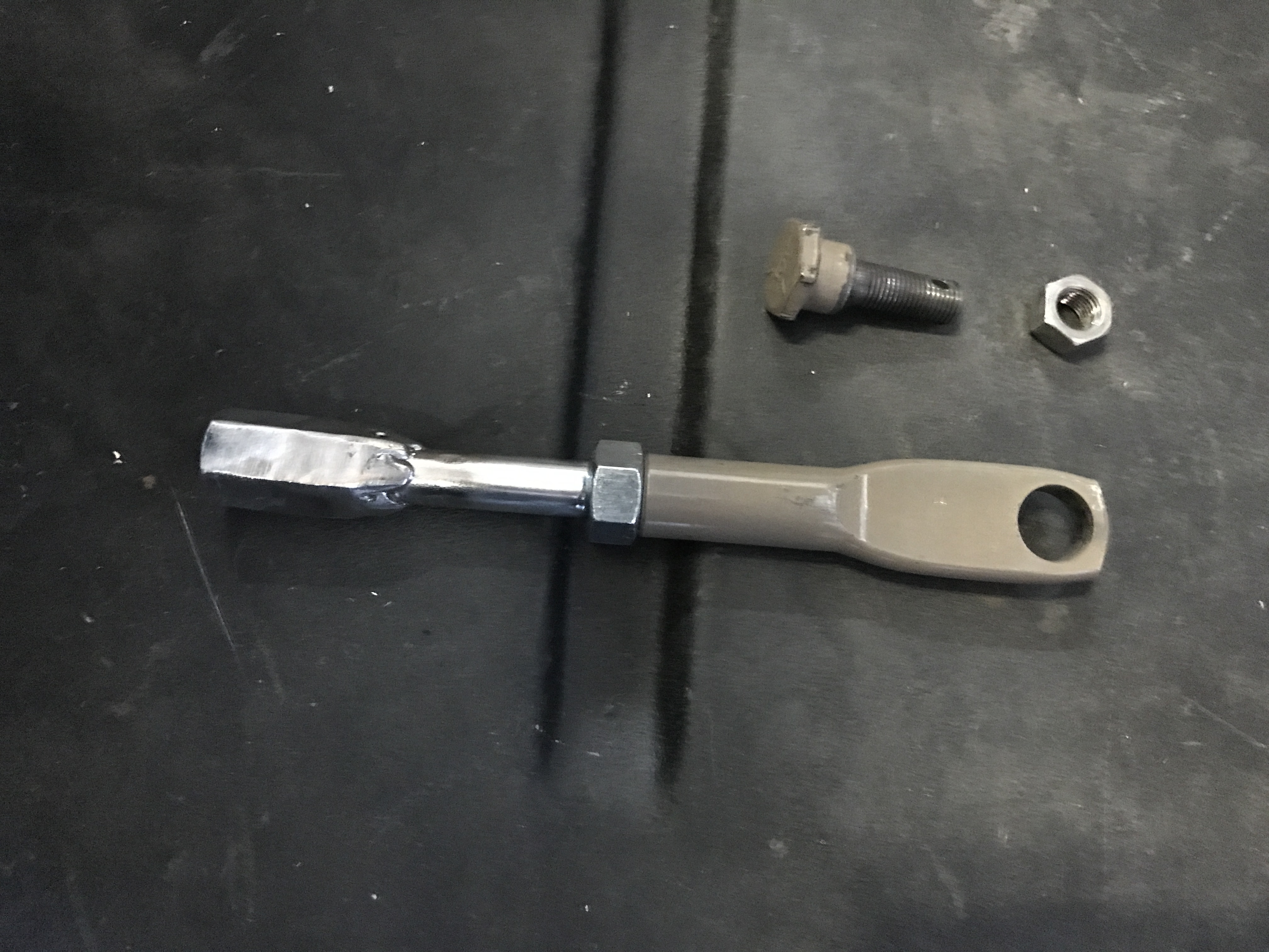

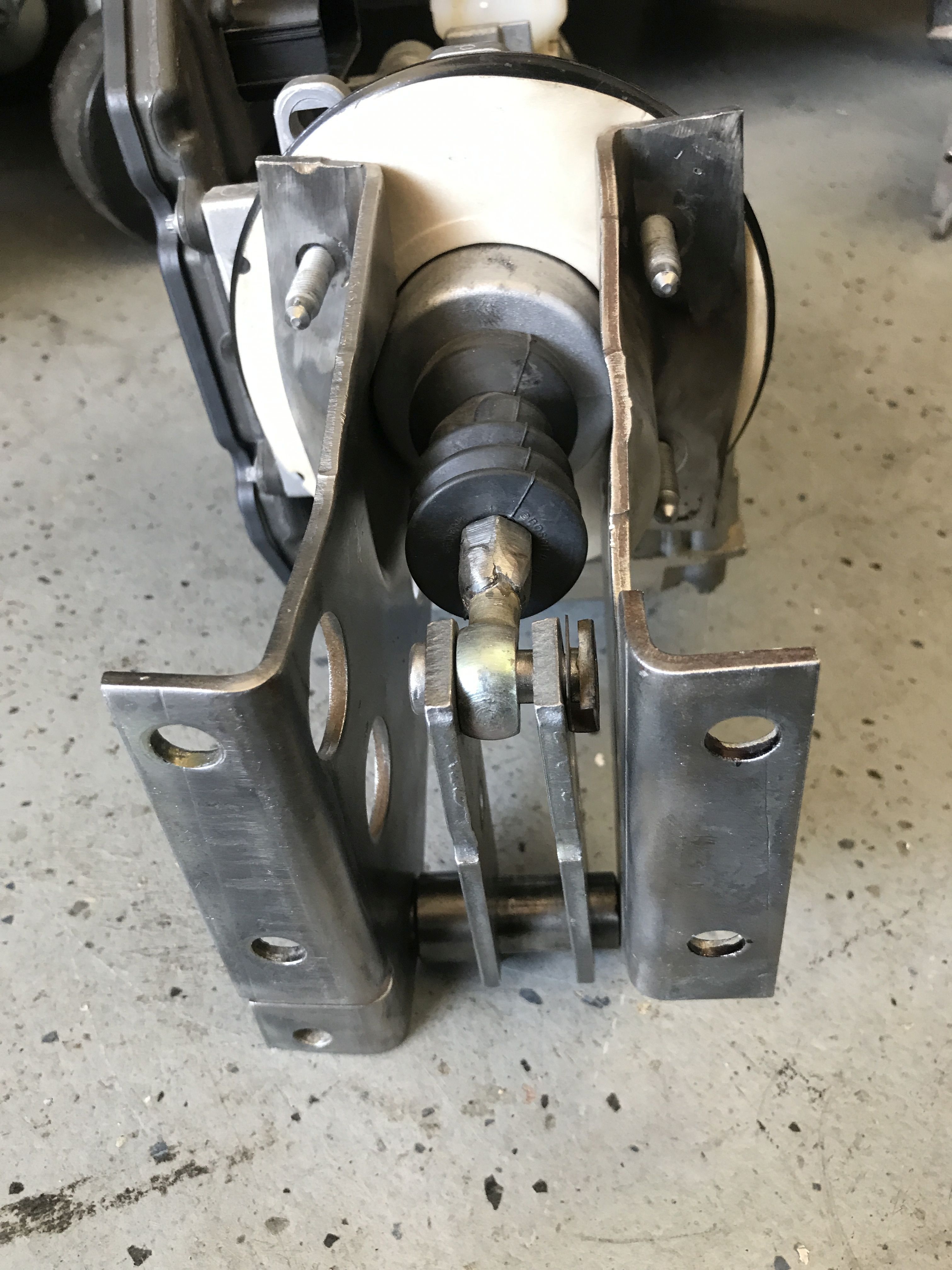

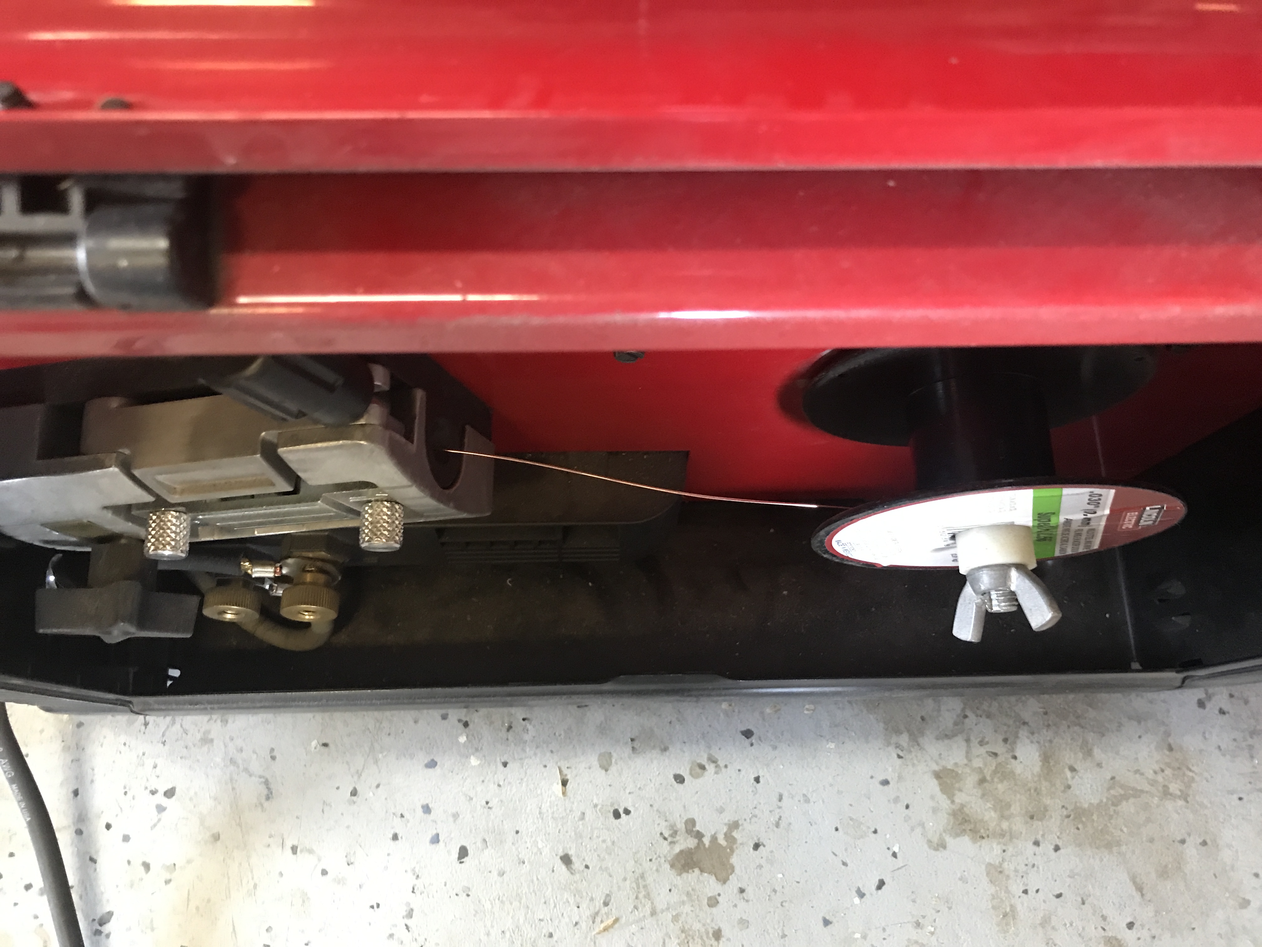

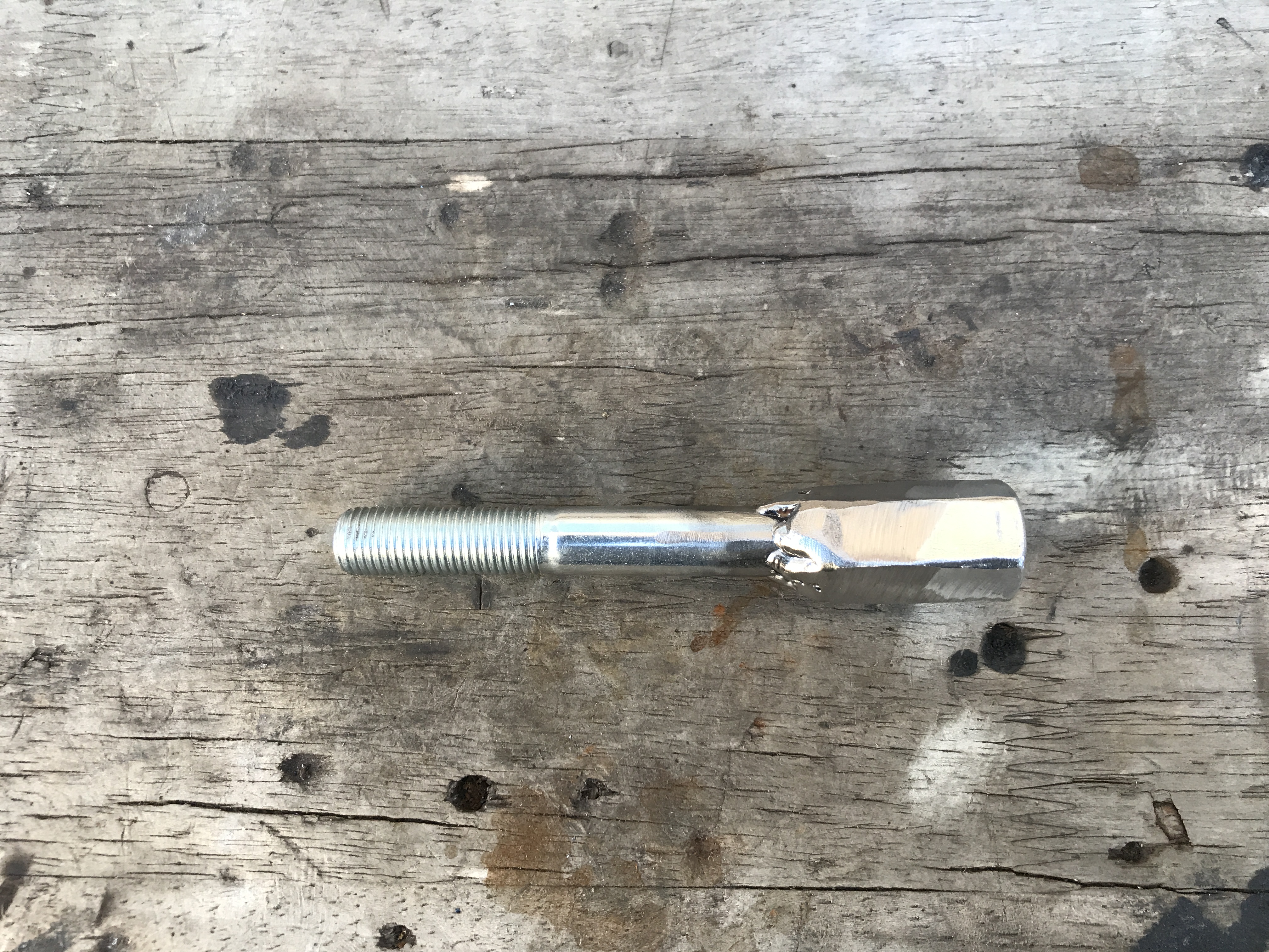

then it was time to make a new brake pedal push rod
The AnyWhere ViceRator 3000 TM (patent pending)
but only after completely running out of welding wire first !!! wouldn't have it any other way, holler are me if you can relate

Planning to reinforce the firewall there? May already be stiff enough of course.

very interesting point I do see it flex when the pedal is depressed, however there is a backing OEM Chevy bracket already on the cabin side but I think it may need some reinforcing
view from the pedal side, head at floor level looking up under the dash on the driver's side, the hole is where the rod from the pedal runs to the Tesla Model S iBooster

Least invasive might be spot welding/riveting a couple strips of angle on the 'engine' side, just to spread the load a little. But you're no worse than stock currently, so...

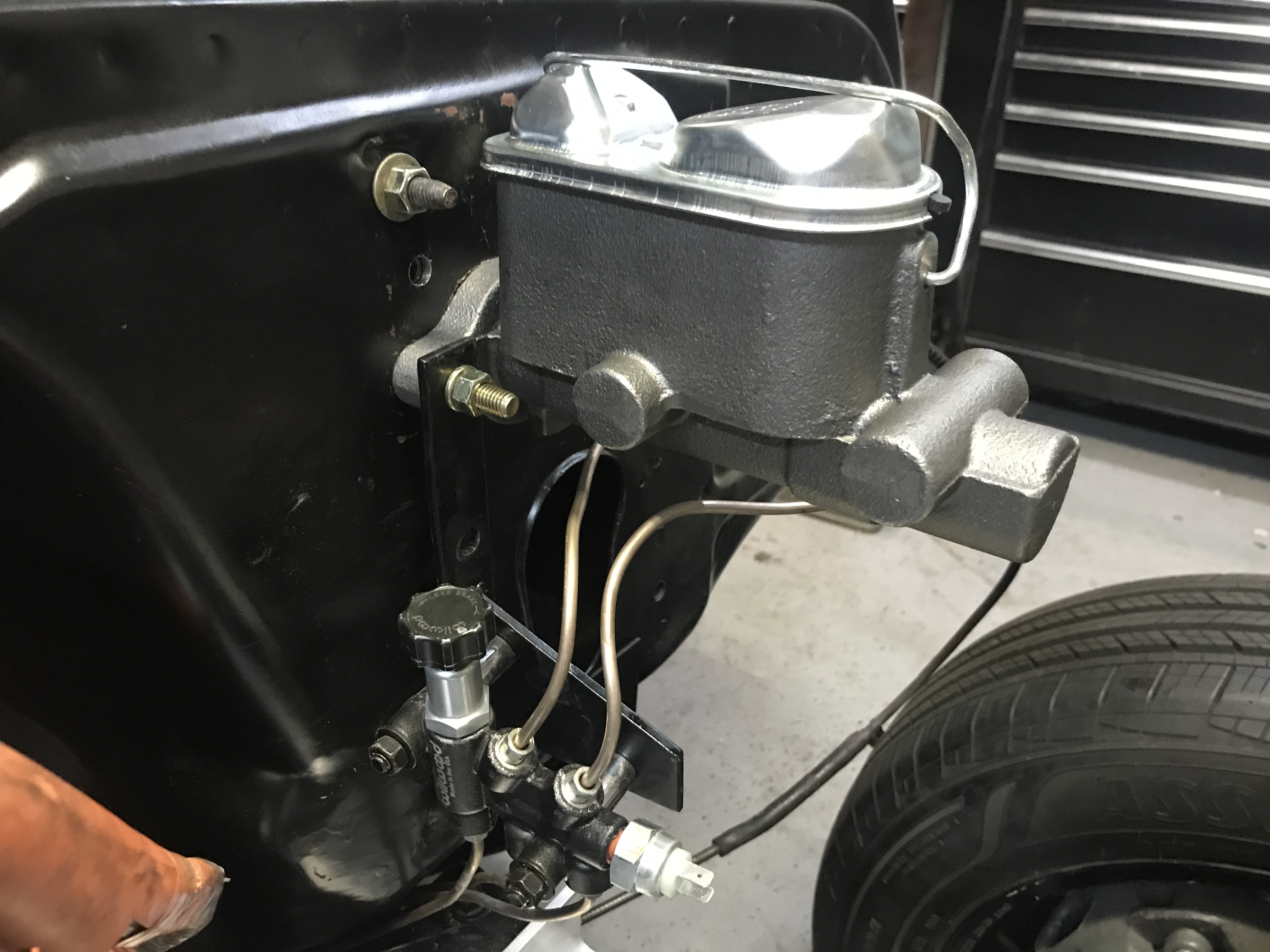

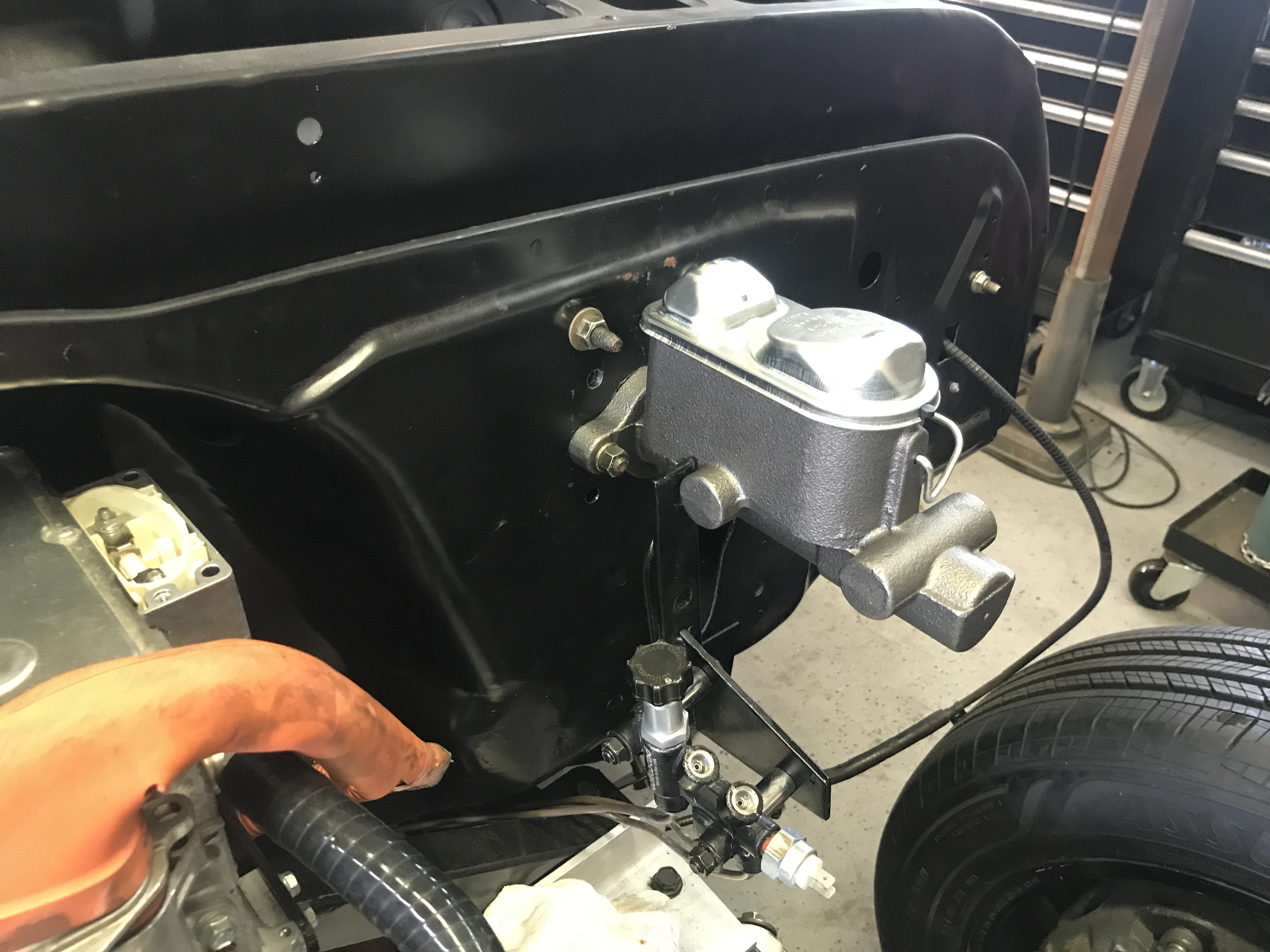

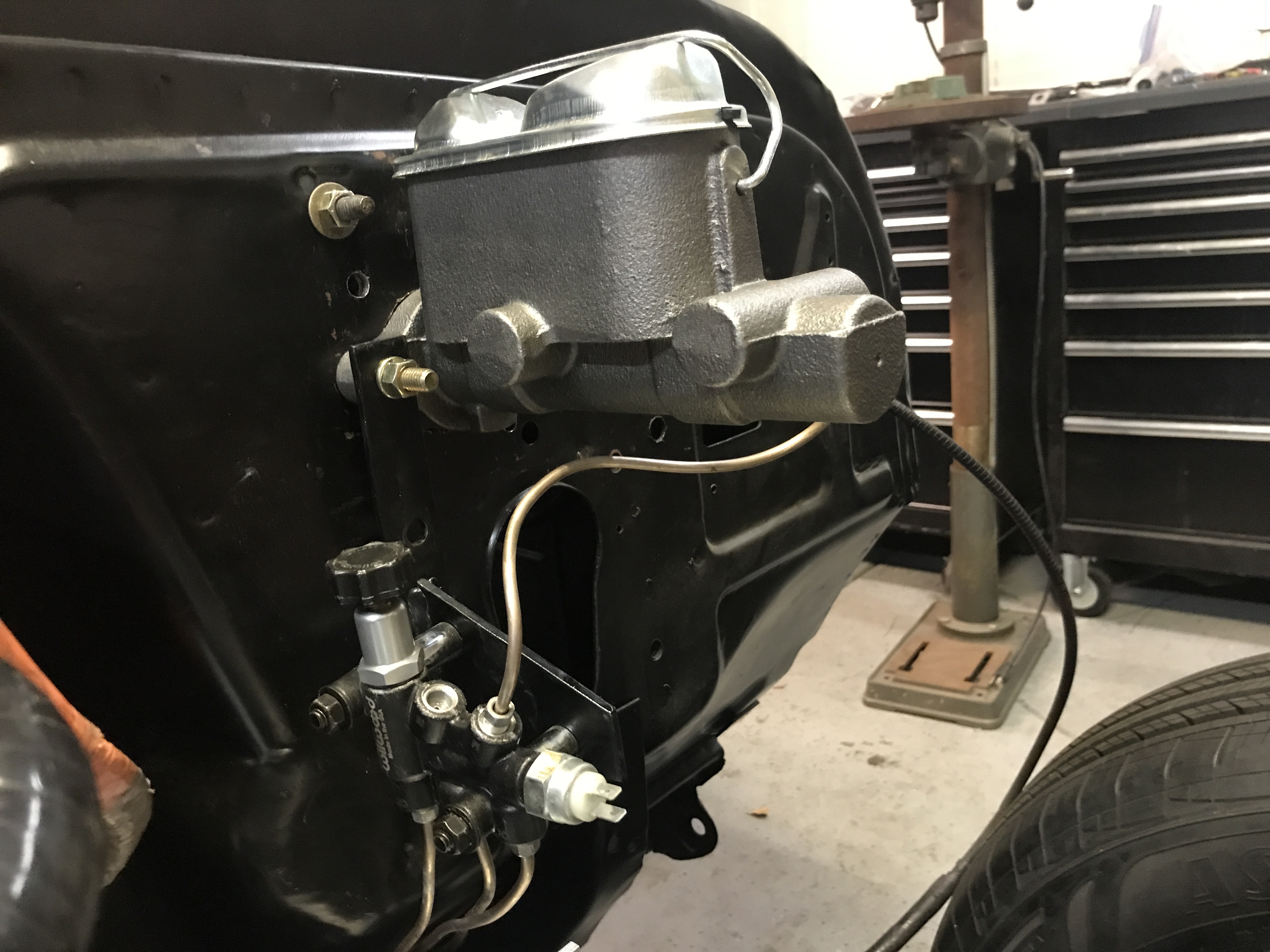

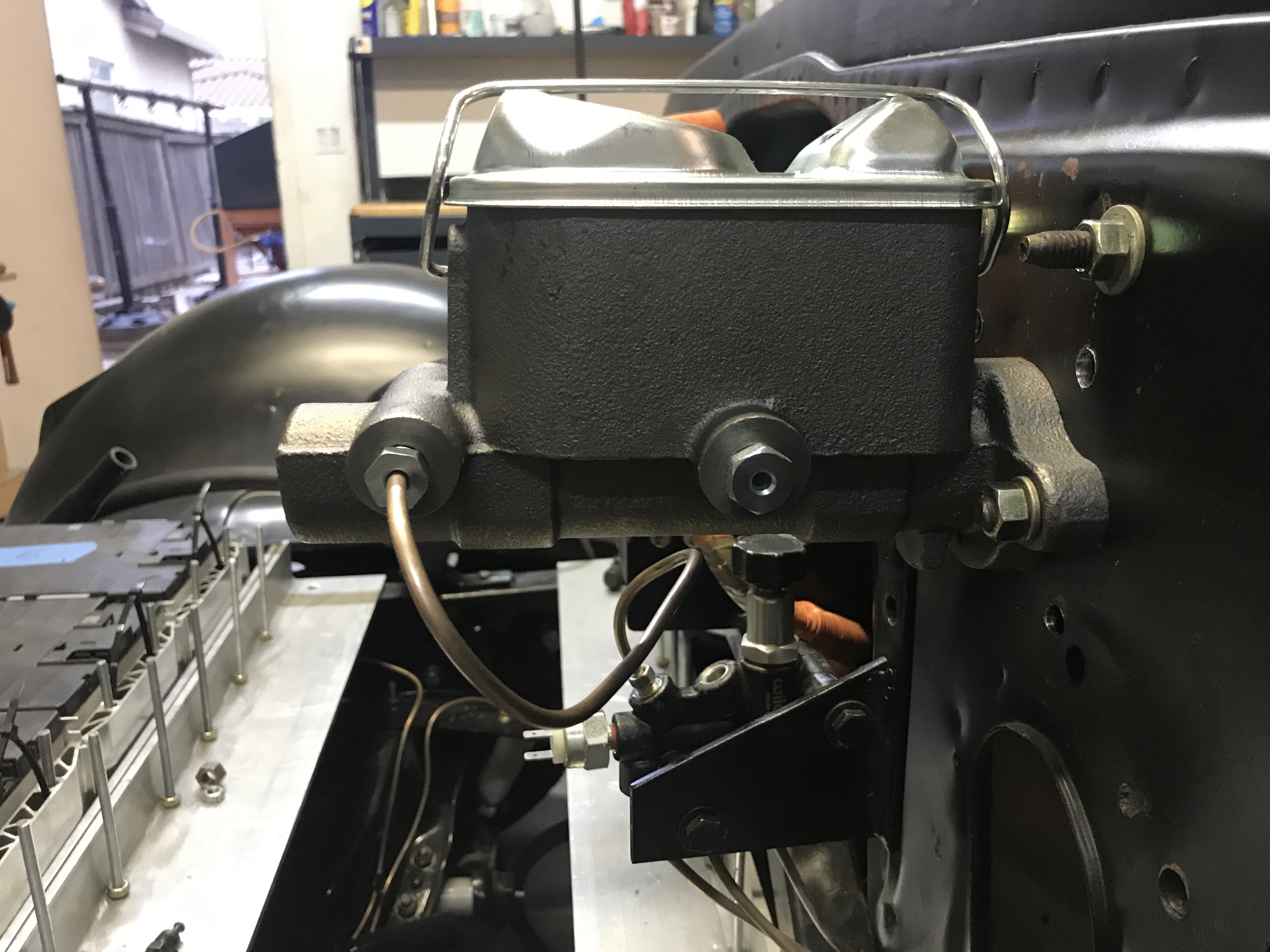

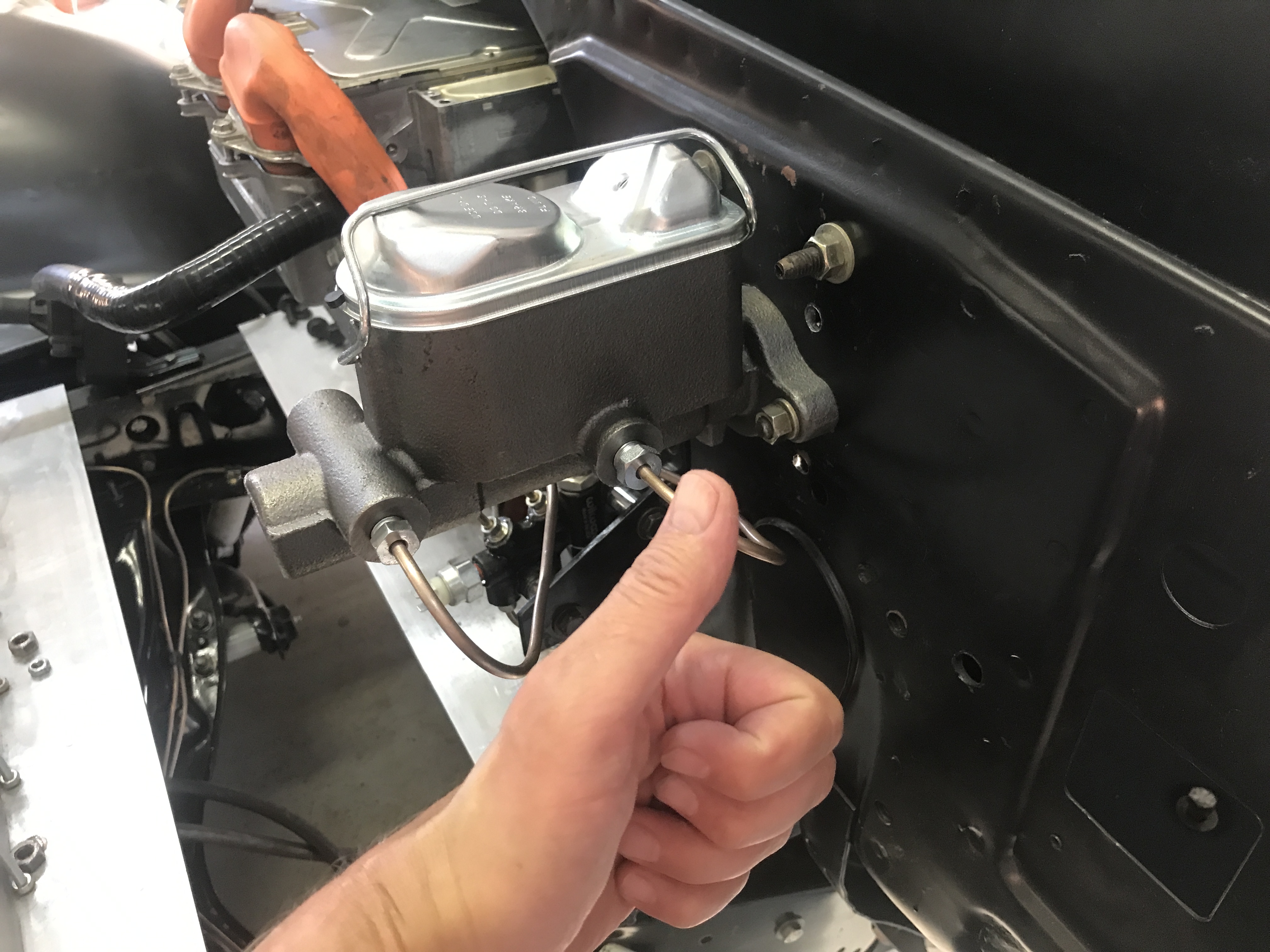

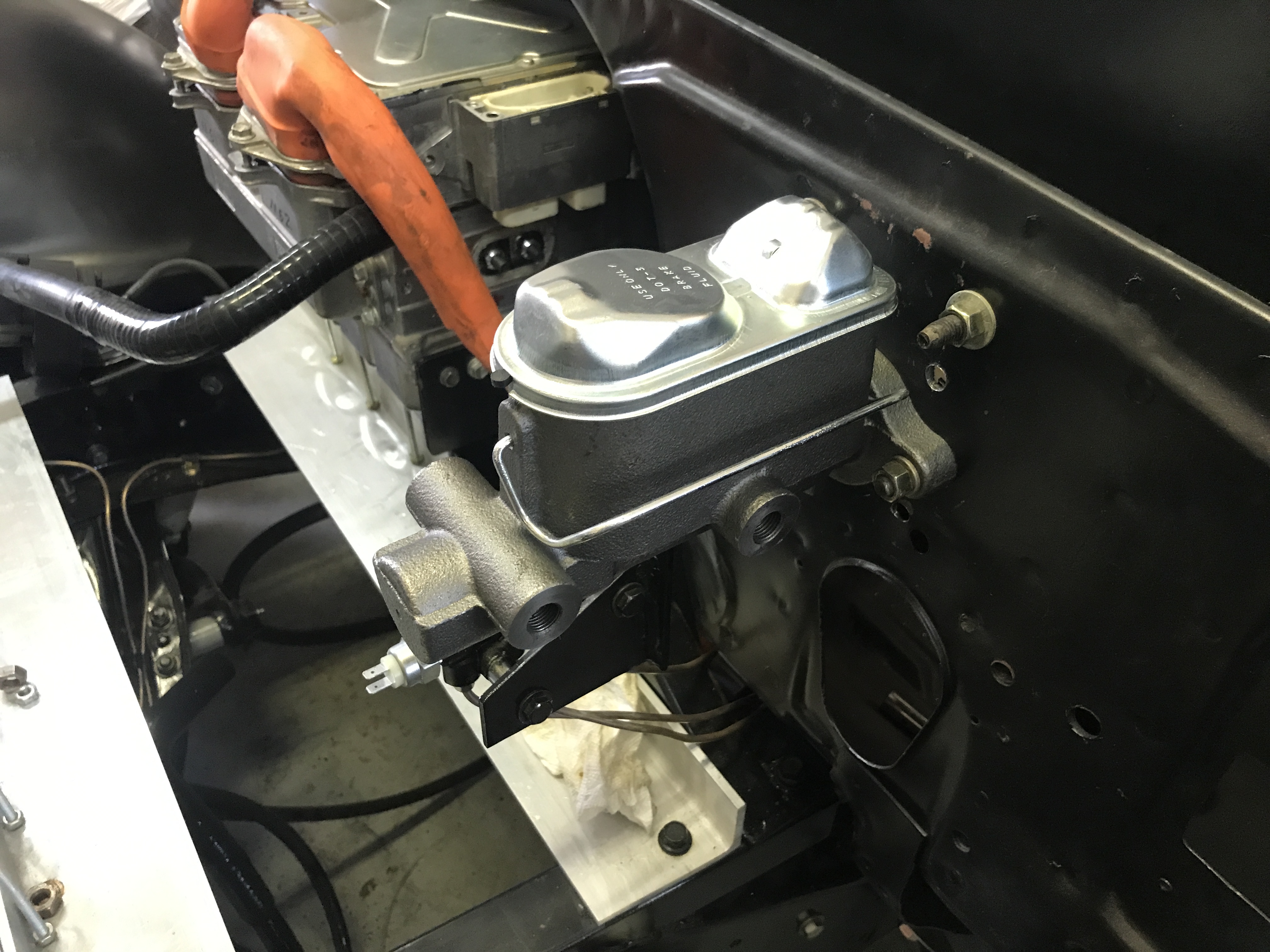

so since I first converted from factory GM stock drum in the front / drum in the rear brakes to factory GM stock disc in the front / drum in the rear brakes I decided to simply finish that conversion in stock fashion, so I yanked the Tesla master cylinder / iBooster in favor of the OEM GM disc/drum master cylinder, but wait it gets worse, I had to go with the manual one since we no longer have vacuum, but that's ok that was an actual factory option in 1971
so why did I do this, well we need a baseline a foundation, I need to install and plumb the brakes in this stock OEM fashion and see if I can bleed them and get a nice firm brake pedal feel, then and only then will I consider going back to the iBooster, and I think if I do I will look into adopting it to the OEM GM master cylinder as I think it needs a bigger bore and more flow piston/cylinder
so last night's efforts in taking the necessary two steps backwards:
Gregski
Posts: 3163
Has thanked: 633 times
Been thanked: 1609 times
Post by Gregski »
"If at first you don't succeed, try again, if you still fail, try again, if it still doesn't work, quit, give up, go do something else"
~ The Good Enuff Garage
Gregski
Posts: 3163
Post by Gregski »

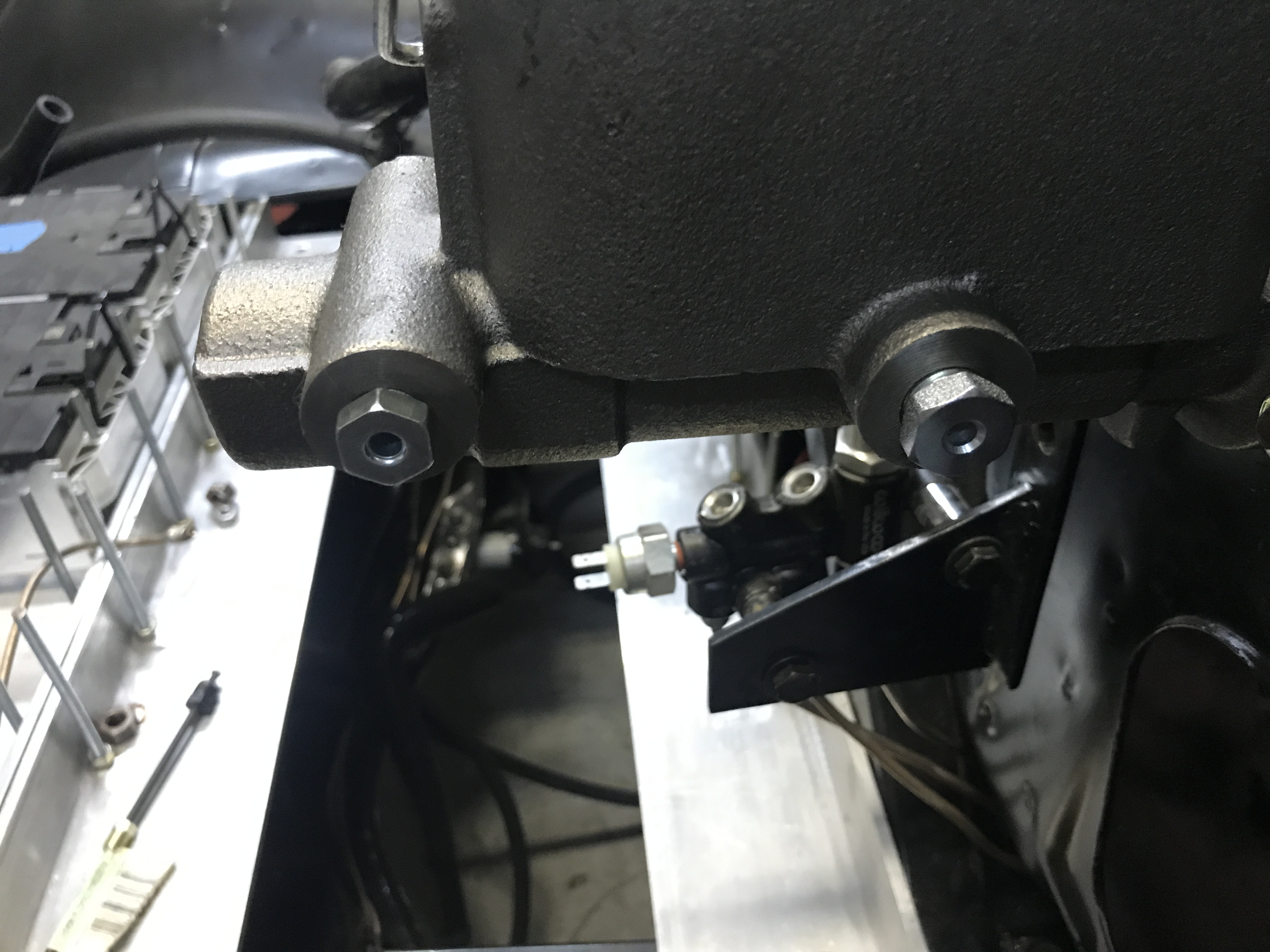

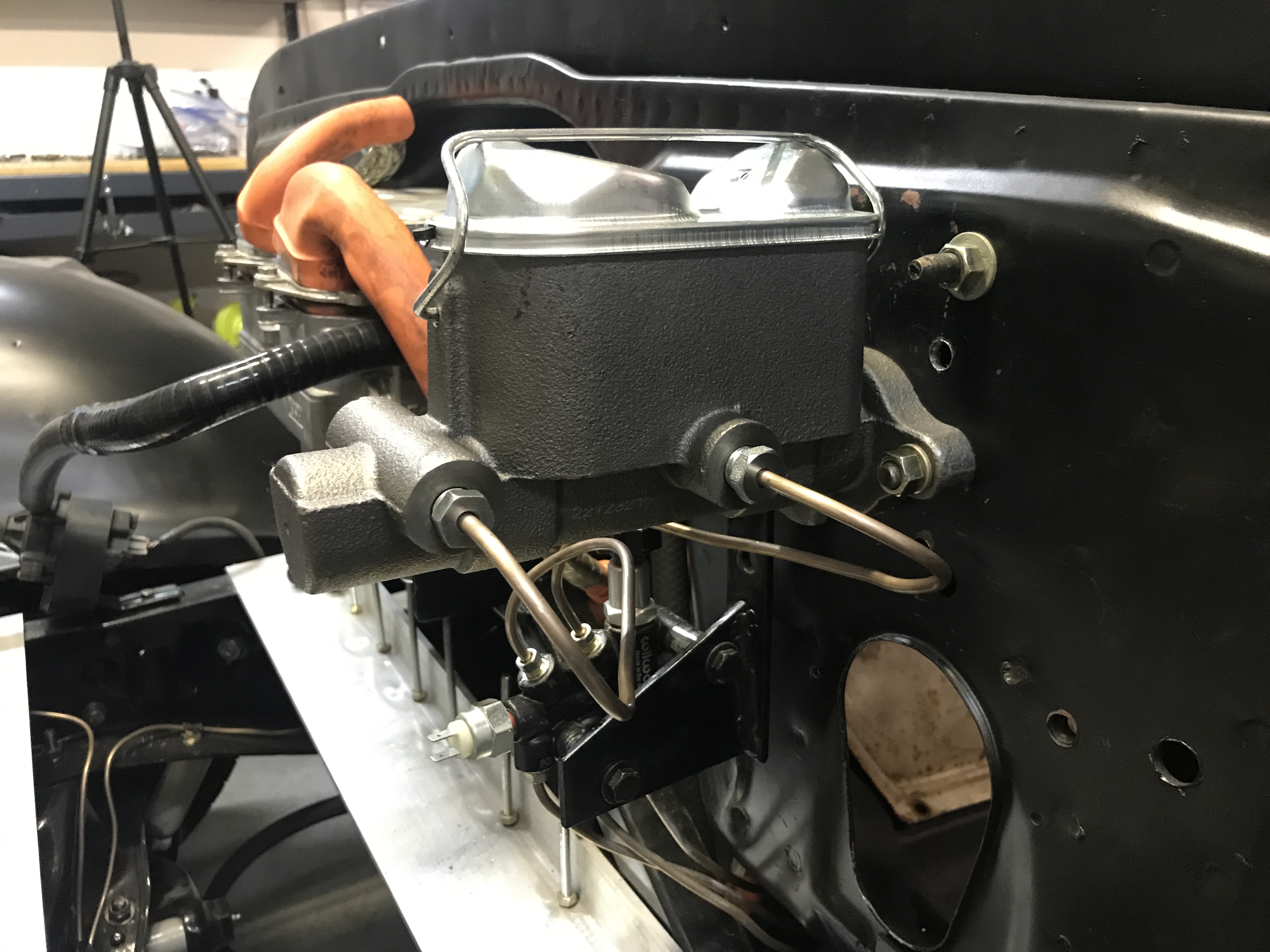

parts are trickling in
New brake line [ahem] ... installed !
Gregski
Posts: 3163
Post by Gregski »
I swear I can now make brake lines in my sleep, sometimes I even put both fittings on them!
Gregski
Posts: 3163

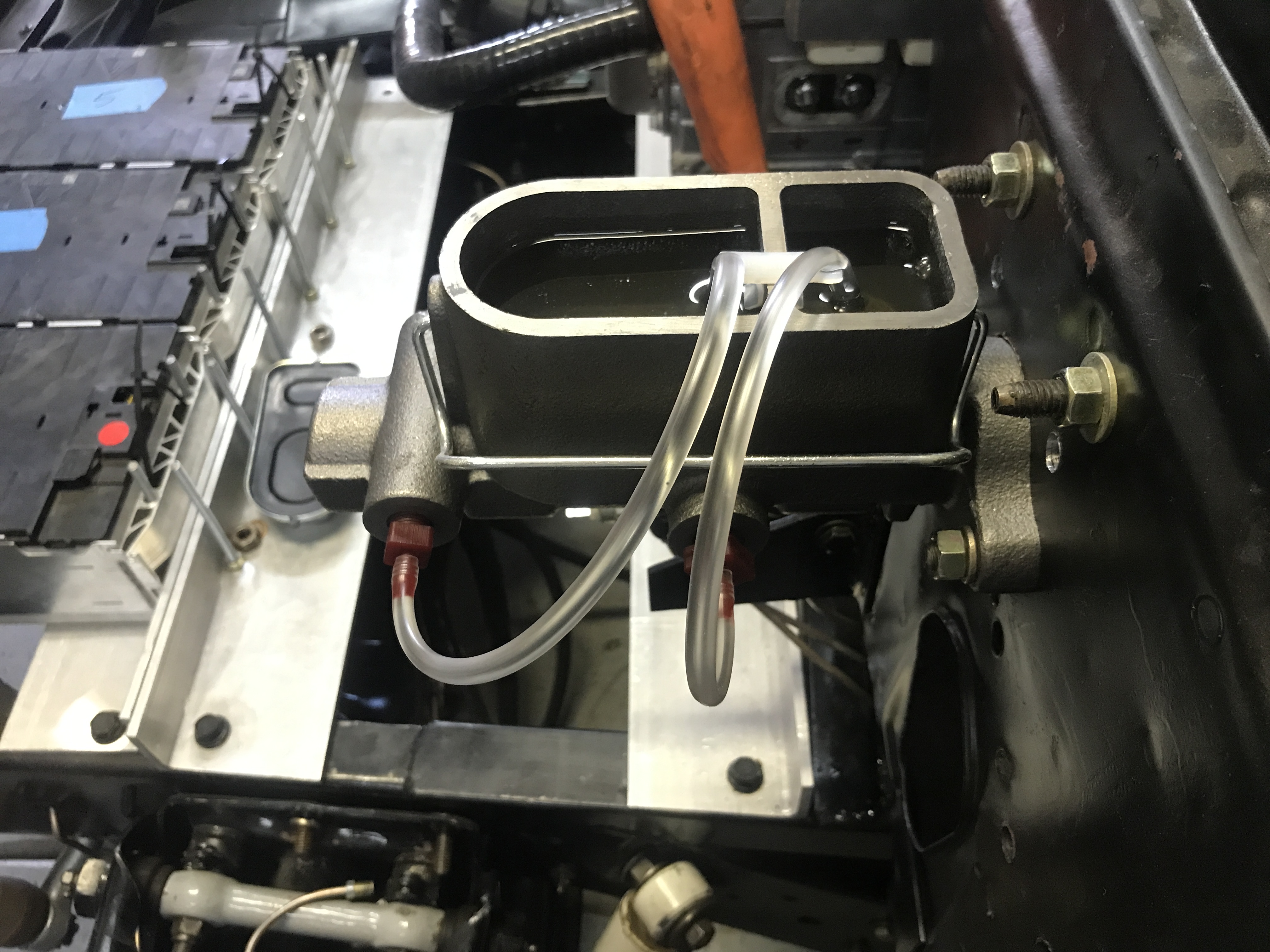

Post by Gregski »
happy to report brakes are done and all working, son helped me bleed 'em! thank you Michael you won't hear me talk about them ever again, sheesh enuff of that, we have an electric truck to build!
