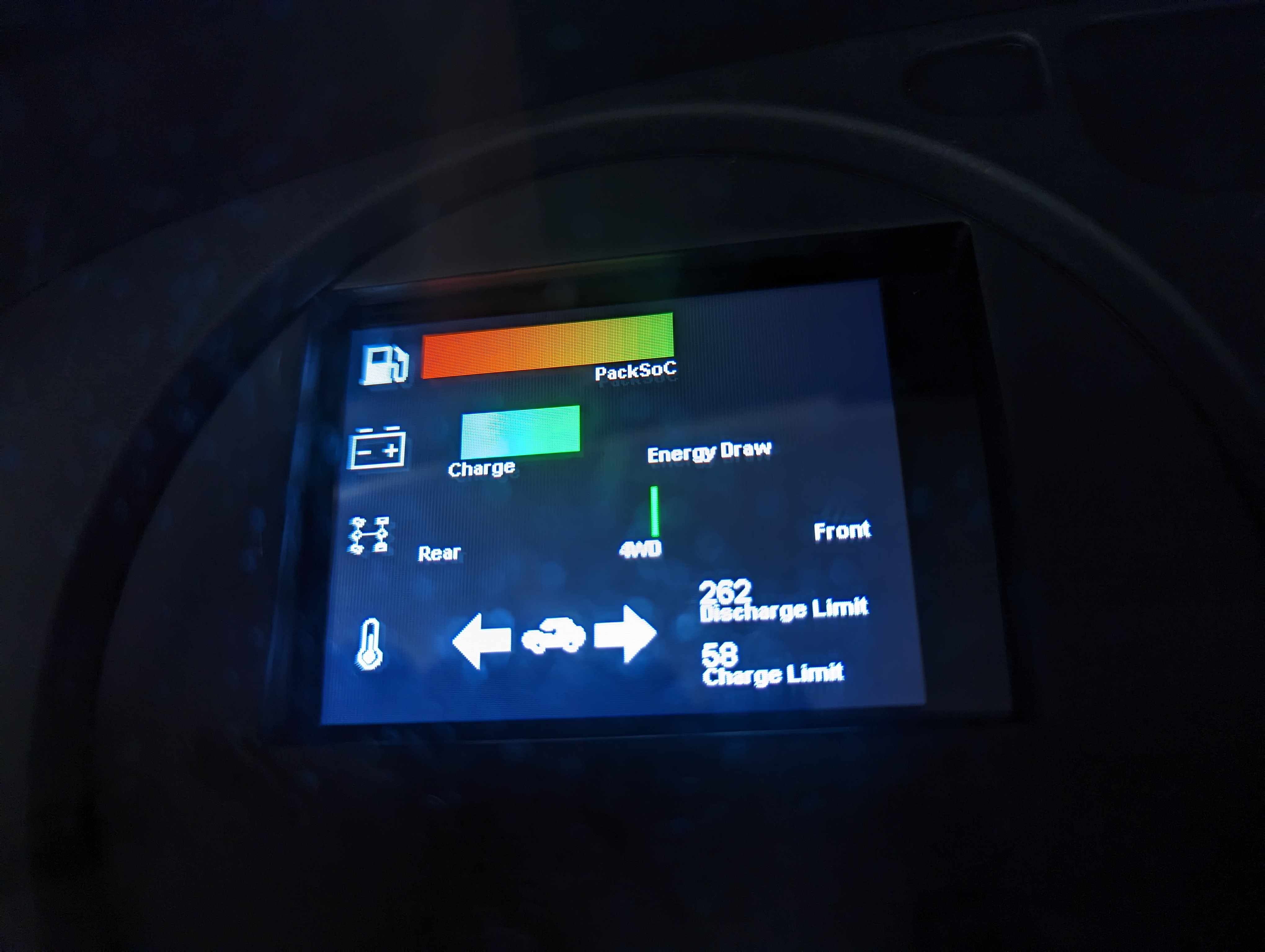

I'm almost done wiring the car, almost everything works by now.
As we figured out that the Zombieverter could only drive the rpm OR the speedometer i decided for the speedometer and put an digital gauge in place of the rpm gauge.
It's a canchecked MFD28 display that comes with software and can literally show anything on the Canbus.

Looks awesome!
What's the Zombieverter's limitation in your case there?

Don't forget to make it dimmable with an input or so.
Displays can be very bright at night.

marcexec wrote: Mon Dec 26, 2022 1:36 pm What's the Zombieverter's limitation in your case there?
It has 3 PWM outputs but they all run at the same frequency. Speedometer and rev counter need a (different!) variable frequency so you must pick which one you want to run.

johu wrote: Tue Dec 27, 2022 11:51 am It has 3 PWM outputs but they all run at the same frequency. Speedometer and rev counter need a (different!) variable frequency so you must pick which one you want to run.
Which frequencies, how high do we talk about?
Posts: 6742
Has thanked: 380 times
Been thanked: 1564 times
Re: Subaru e-mpreza (Impreza) 96 - AWD with 2 Outlander rear motors
The speedo is 166 Hz at 250 km/h
We never tested the rev counter

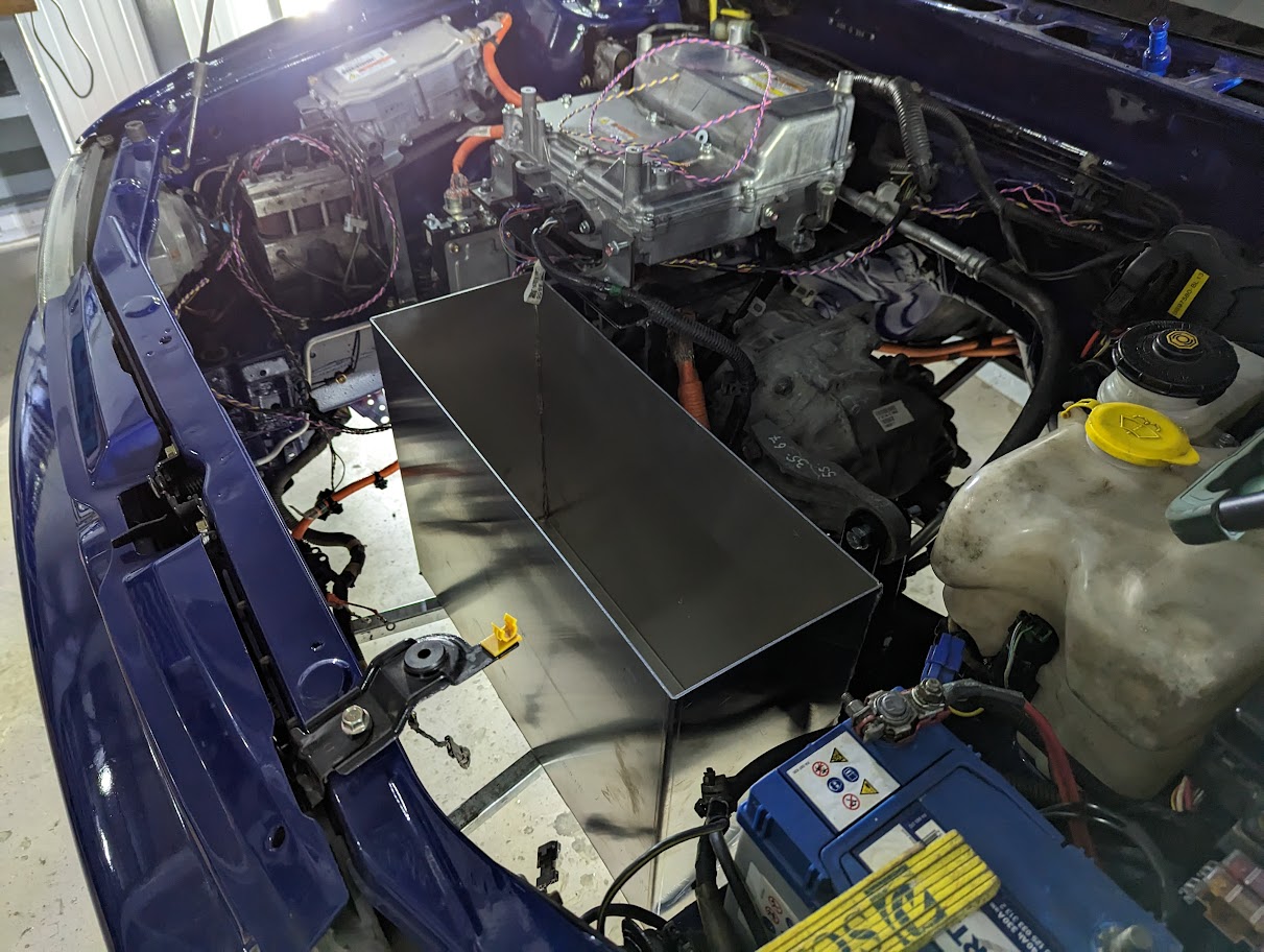

Finally, after a battery disaster, i am moving forward with this conversion. I sold the Kona-Battery as the TÜV-Guidelines for building EVs in Germany have been changed while i built this Impreza, saying that an energy storage unit can't be any closer than 400mm to the front end of the bumper and 300mm to the rear end of the bumper. I bought the Leaf-Battery with 40 KwH from Marty from this forum. That Pack is so much easier to install!!!
Yesterday we welded the battery boxes and put half the Pack und the back. The planned watercooling won't work now, but i'm planning on aircooling them.

Plenty of space at the front! Very impressive and factory-looking build

Thanks a lot for sharing all this info - super helpful as I'm about to pull the engine out of my Legacy GT (3rd Gen) to build battery boxes up front. Did you do any 3D modelling to plan the space at all? Just curious.
