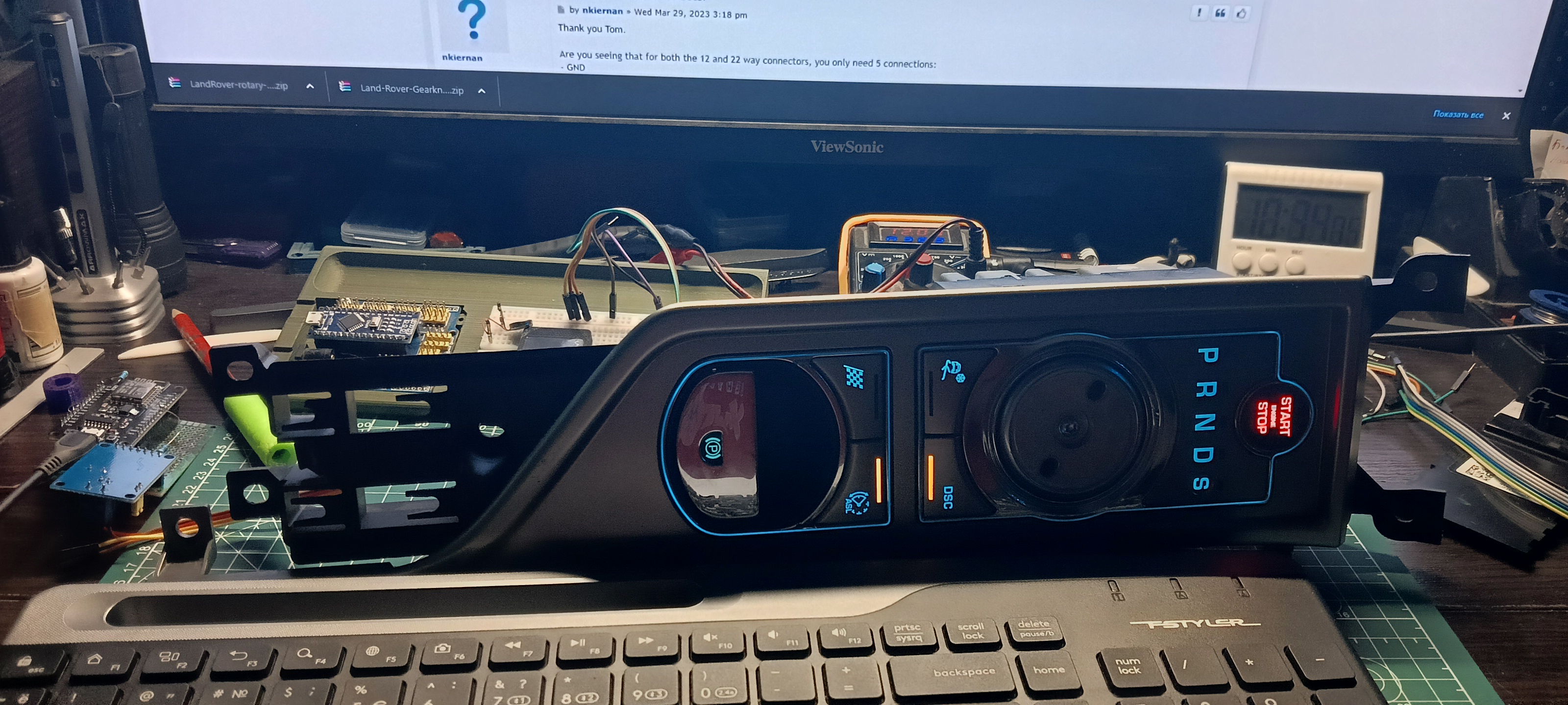

Re: can id´s 4 Gear Selector
Hello friends. How long have I been looking for this topic in all the forums !!!! I'm trying to get it to work with a stepper motor for shifting gears in another car. I needed to find all the CAN bus codes and then I stumbled upon this forum. Happiness!!!
I found only 2 leds like in my picture

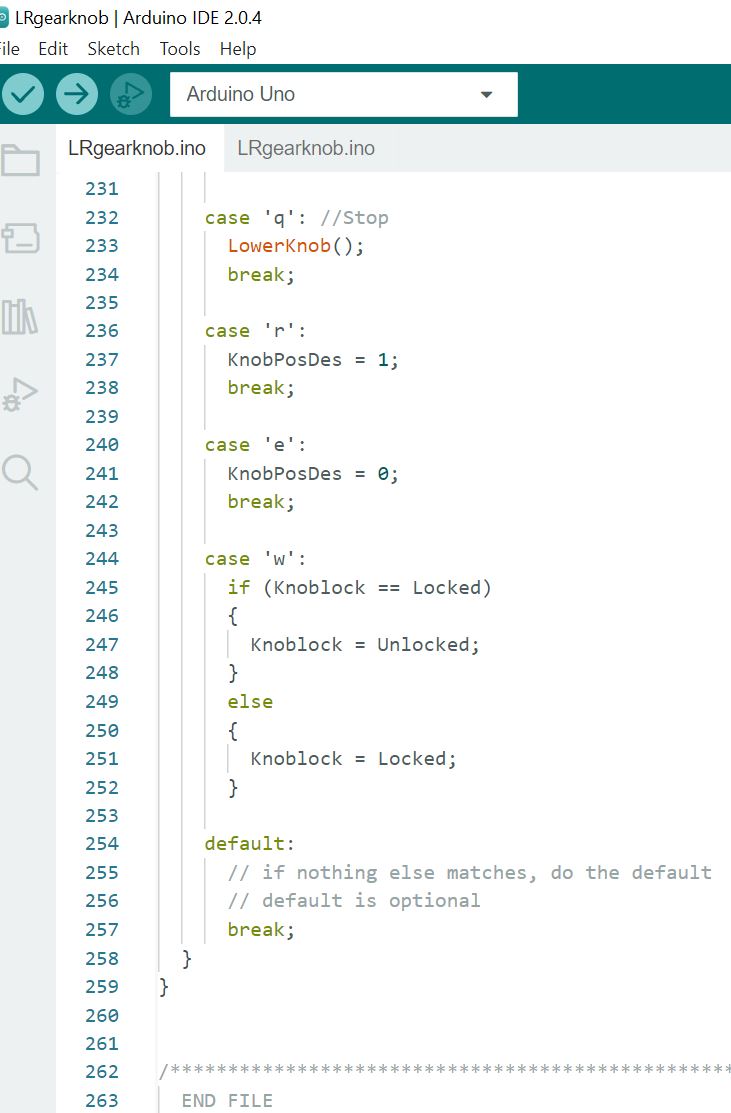

I found mcp_can.h library on git. Applied nkiernan's advice uploaded to arduino. What should happen? Maybe I don't have a CAN bus connection? The port monitor should display information with the line 0x312 from selector?
- Posts: 2962
- Has thanked: 330 times
- Been thanked: 847 times
It does not print anything, as the Leds will feedback on the knob.
Send it the letter 'd' is you want to toggle canbus debugging.
I don't understand. Maybe my GSM doesn't work with this code? Because on the video of the seller from Aliexpress there is no mine. Does anyone have a video review of working GSM with arduino? How to make the knob move? I haven't been able to move it for 2 weeks now((((
I Send it the letter 'd', but nothing. Then 's', then 'w' and nothing(((
Couple of suggestions. You have the CAN lines connected between the arduino CAN shield and the Jag unit and did you check the resistance between the lines ( approx 60R). Think I added a 120R resistor between the lines because my CAN shield didn't have the termination resistor.VanGogh wrote: ↑Tue Apr 04, 2023 8:08 pm I don't understand. Maybe my GSM doesn't work with this code? Because on the video of the seller from Aliexpress there is no mine. Does anyone have a video review of working GSM with arduino? How to make the knob move? I haven't been able to move it for 2 weeks now((((
You're applying 12V+ and GND to relevant pins and are you applying the 12V+ ignition signal also? When you open serial monitor in arduino and connected to the UNO, this is what would print when first powered up or reset (baud rate is set to 115200 yes?):
