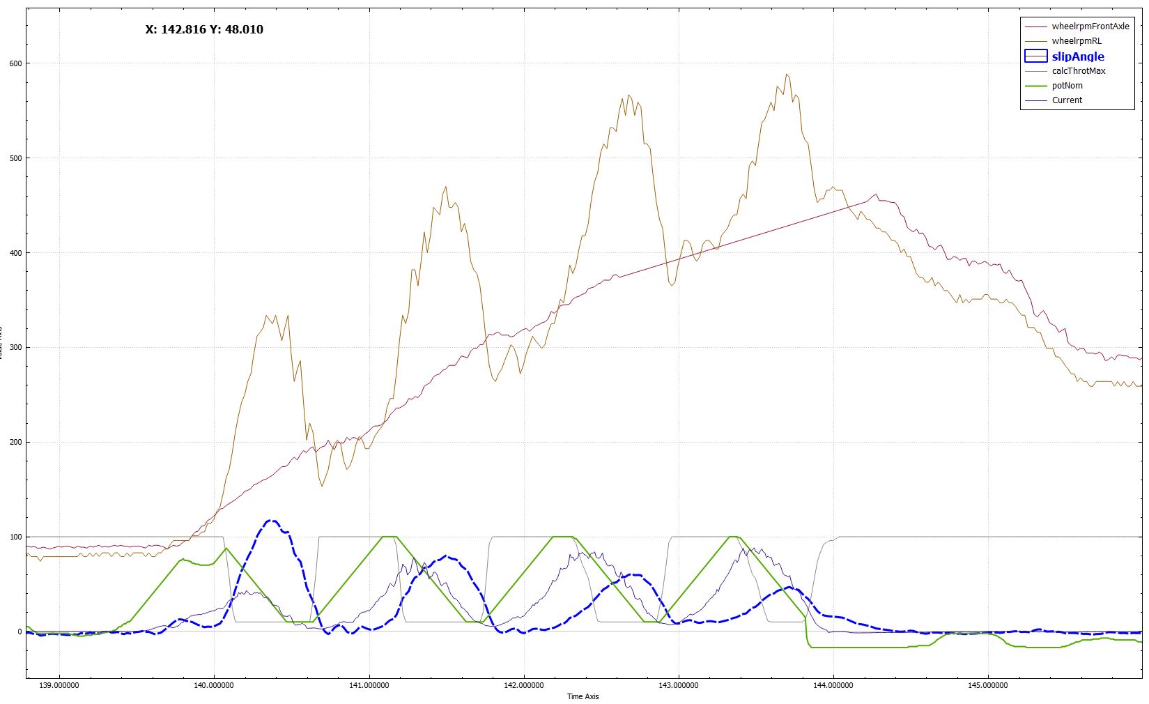

Ran a few tests today with 2%/10ms throtramp. It's "working" but unable to keep up and ends up oscillating. Seems throtramp also applies for coming off throttle, I had assumed it was only for application, but clearly see its falling at 2%/10ms also. I'm going to have to raise that value a lot to be able to catch the slip which will make the throttle pretty jerky...

2%/10ms is IMO a very slow throttle ramp. I run mine at 50%/10ms so you can definitely go a decent way up. The throttle is only as jerky as your foot :)
Personally I prefer the "instant" throttle response.

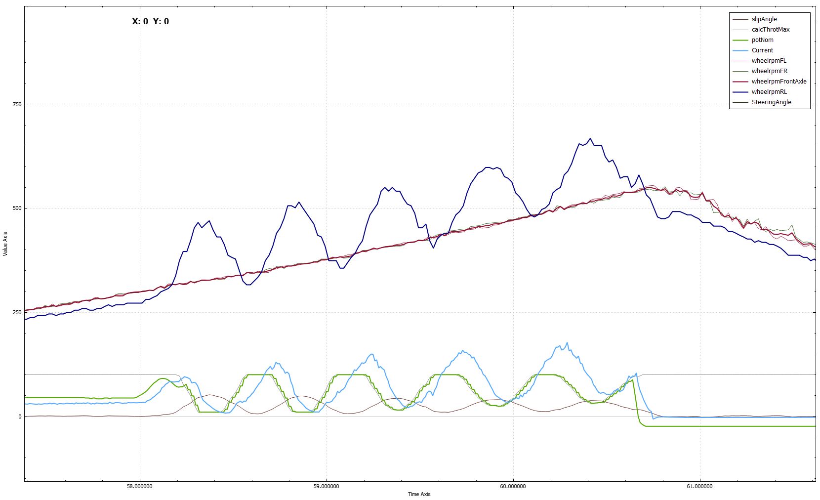

40%/10ms - fair bit better but still not fast enough. Throttle/potnom is cut within about 40-50ms of the slip starting, but motor current takes a further 50ms to decay - can reduce the ramp up to 100%/10ms but then I'm dealing with some internal openinverter ramping I guess...

cloudy wrote: Sat Mar 04, 2023 2:44 pm 40%/10ms - fair bit better but still not fast enough. Throttle/potnom is cut within about 40-50ms of the slip starting, but motor current takes a further 50ms to decay - can reduce the ramp up to 100%/10ms but then I'm dealing with some internal openinverter ramping I guess...
Yes, sorry, there's a hardcoded internal ramp (filter) that happens after throtramp and creates quite a lag in throttle response. This was a problem for me so I added a patch to make it adjustable:
https://github.com/jsphuebner/stm32-sine/pull/21
I reduced this filter from 4 to 3 to half the response time. You need to be a little careful with this value if you are using regen. If not, you can get much more aggressive with it.

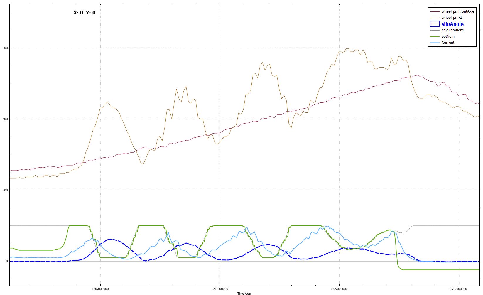

Another slight improvement. 50%/10ms and throtfilter 3. I reckon I can shave off even more time by either dropping the target slip (so it drops throtmax quicker) and increasing the proportional response (or moving to a basic PID controller that can see the trend of increasing slip earlier) and reducing the slip angle averaging a little.
Assuming a 20% slip target, it would appear I have around 100ms from the start of slip being apparent in the sensors and slip exceeding 20%. This is a very light car with very low rotating mass in the driven axle, so maybe a harder challenge than most.

cloudy wrote: Sat Mar 04, 2023 11:31 am Ran a few tests today with 2%/10ms throtramp. It's "working" but unable to keep up and ends up oscillating.
If I might make a suggestion: assuming you're doing a simple proportional feedback ie:
throtmax = 100 - slip;
Try an integral-only approach, like this:
if(slip > 20) throtmax--;
else throtmax++;
The benefit of this is that while it will respond slower, it will reach an equilibrium. The reason for the oscillation is likely because throtmax is reduced too much, slopping the slip entirely, but as soon as the slip is gone, throamax is returned to 100%, and the slip returns. By using an integral, the reduction in throtmax will be maintained at the correct value to keep the slip at 20%. This is how I do current control anyway.
