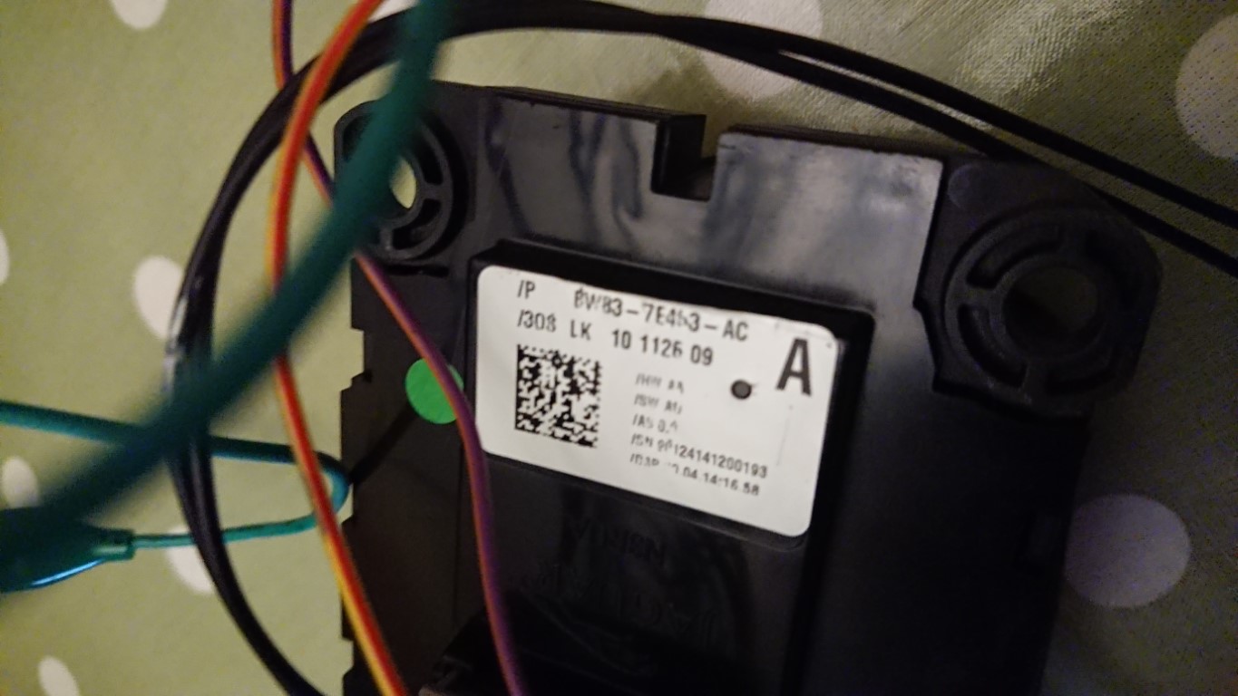

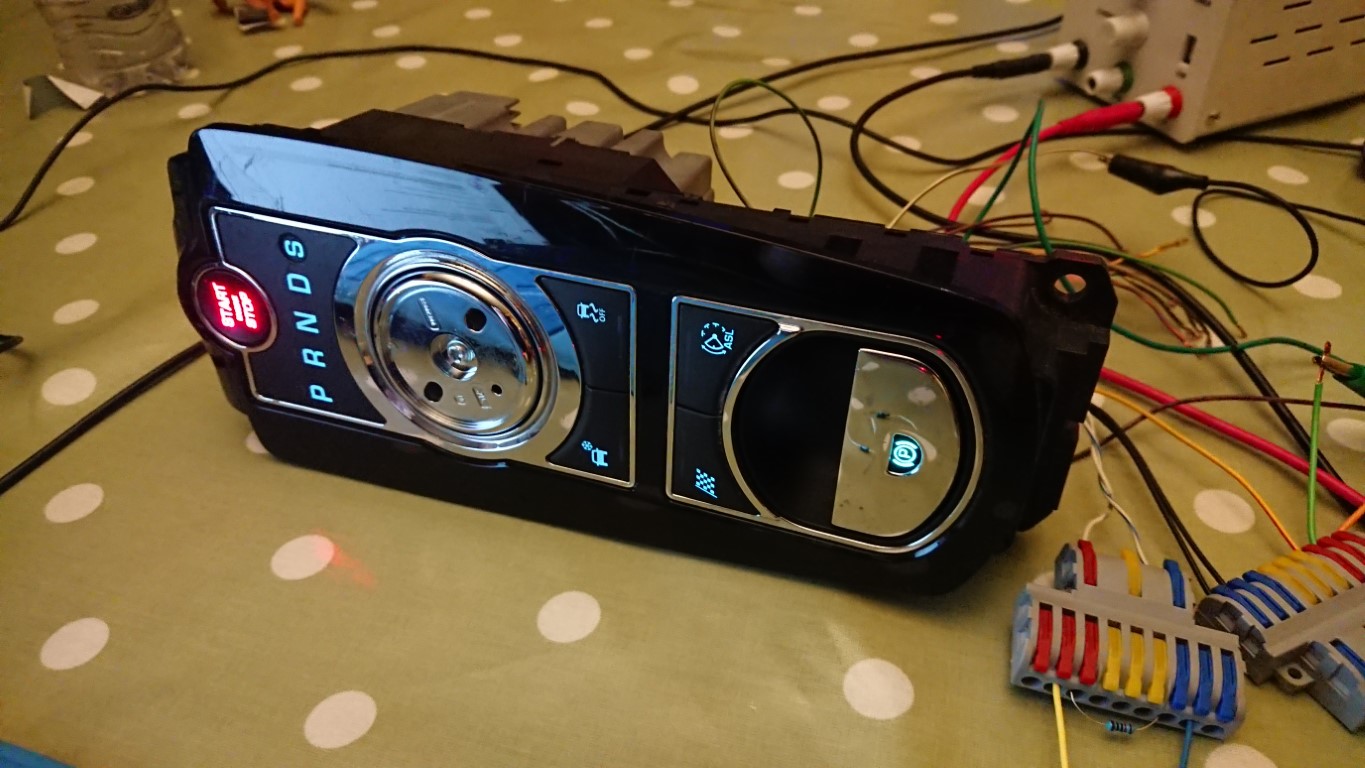

Maybe I bought a broken GSM? But if I apply 9V to the motor or solenoid pins, the knob rises and the solenoid releases its movement.

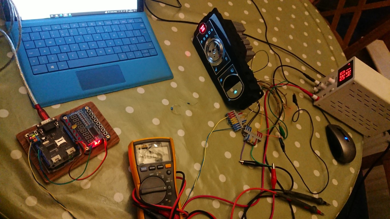

You show pictures and the module tester. Do you have a module tester?
It is not clear how have it wired, as in all the wires.

Re: can id´s 4 Gear Selector
My setup is wired as flowing:
With the Arduino sending the canbus, the knob will raise when ignition is supplied with 12V and will lower when it is removed.
You can even have the canbus not working apply power to all the 12V inputs then turn on the canbus or connect it and the knob raises.
The knob does not get raised based on canbus content it just needs to be correct and 12V "ign" needs to be provided.

I don't understand why it doesn't detect the Park position... There is 12V on pin 14. But the monitor still displays

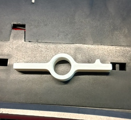

I bought this GSM on ebay and Lifting Gear Lever was broken. I printed it on my 3D printer and installed it in place.
Checked motor and solenoid. Everything works and moves. Maybe some microcircuit burned out and therefore there is no signal to the motor to raise the knob?
