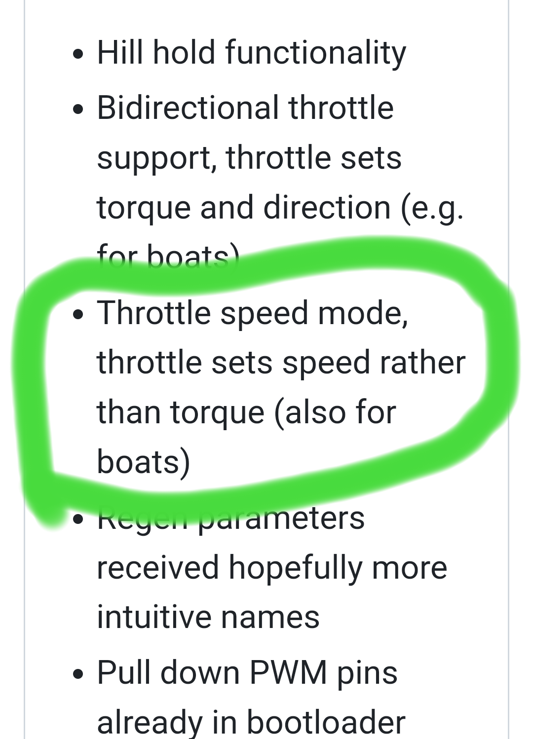

Post by Romale »
Throttle speed mode, throttle sets speed rather than torque (also for boats)
this part of the description interests me))
bidir mode works fine.
but he controls the moment. it is not very convenient for rotating the propeller under water.
the described ability to control the number of revolutions of the motor instead of the torque would be ideal.
but how to turn it on?
evil neodymium :twisted:
Been thanked: 1914 times
Re: question about bidir pedal control
cruise control = speed control ;)
For a propeller it does work with speedflt=0 and speedkp=0.1, tested before on a boat.
