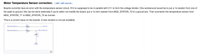

Has anyone hooked up the two phev rear motor temp sensors to a V1C board and got sensible values ?
The motor has 2 temp outputs and 2 associated grounds. As there is no 5v or 12v to the motor, i am thinking these are thermistor types.
Is there a profile in 5.24r suitable for connecting these to as i'm not sure what type they are.
Phev rear motor temp sensors

i added one for the front motor, I'd try that first, maybe they're the same.
I also documented a fix to a bug on the board.BMW E91 2006

thanks Jamie - i did see that but wasn't sure if it was applicable, but no harm in trying.
So to be clear for each temp output pair from the motor, i ground the ground side, and connect the temp output to one of the temp inputs on the Ampseal, and take a 1k resistor from that junction to ground also ?
What profile do you select in the inverter interface for this setup ?

No, you pick one to use, not both, connect one side to motor temp T1 and other to T2, then use a 1k resistor to from gnd to T2. I think it's labelled as Outlander Front in the web interface.
T1 is just a 5v supply, T2 is the input.

I tried following your instructions and it works.
