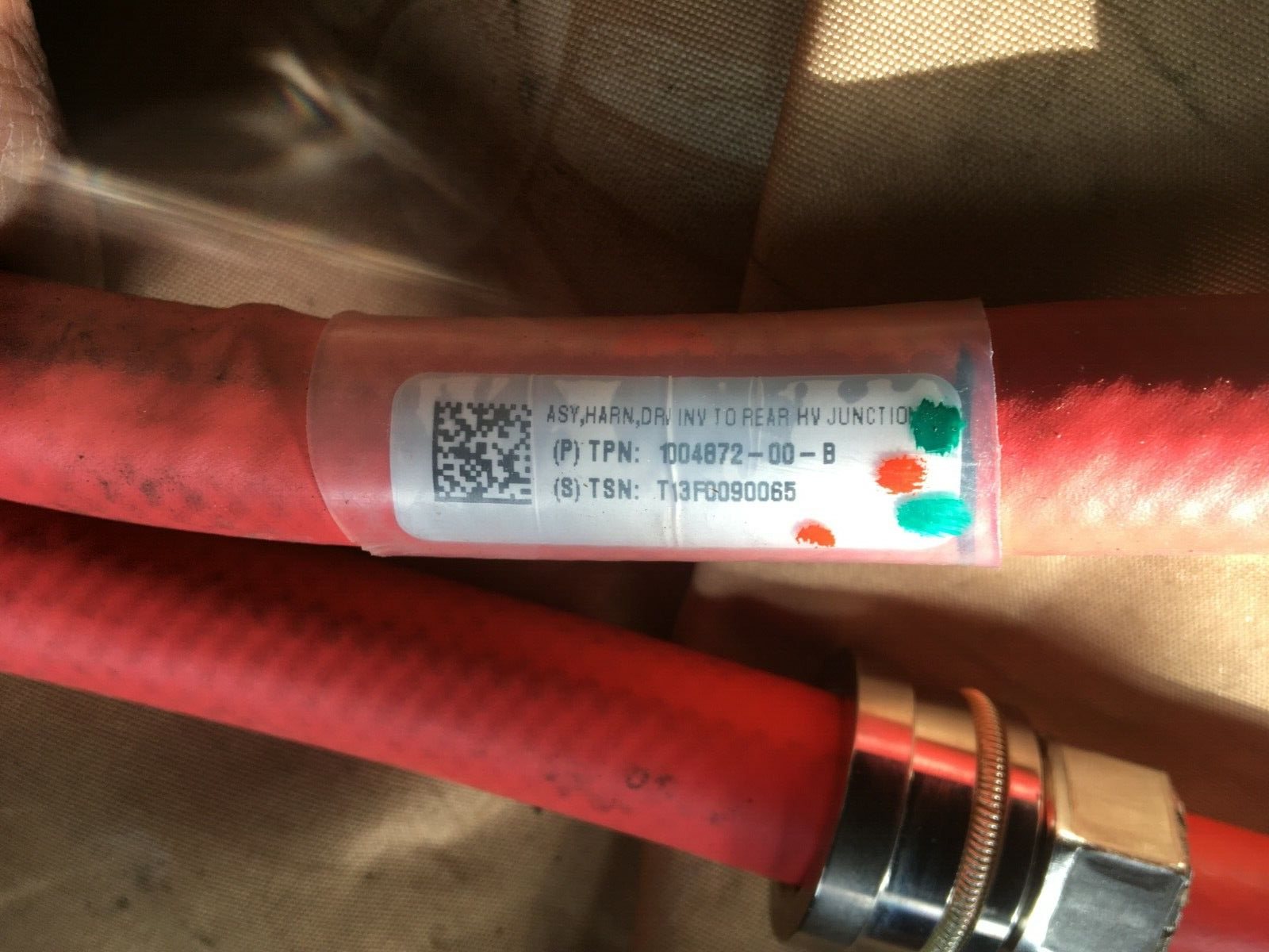

I've got a set of early LDU cables (1004872-00-B) on the way (via eBay), but until they arrive . . .

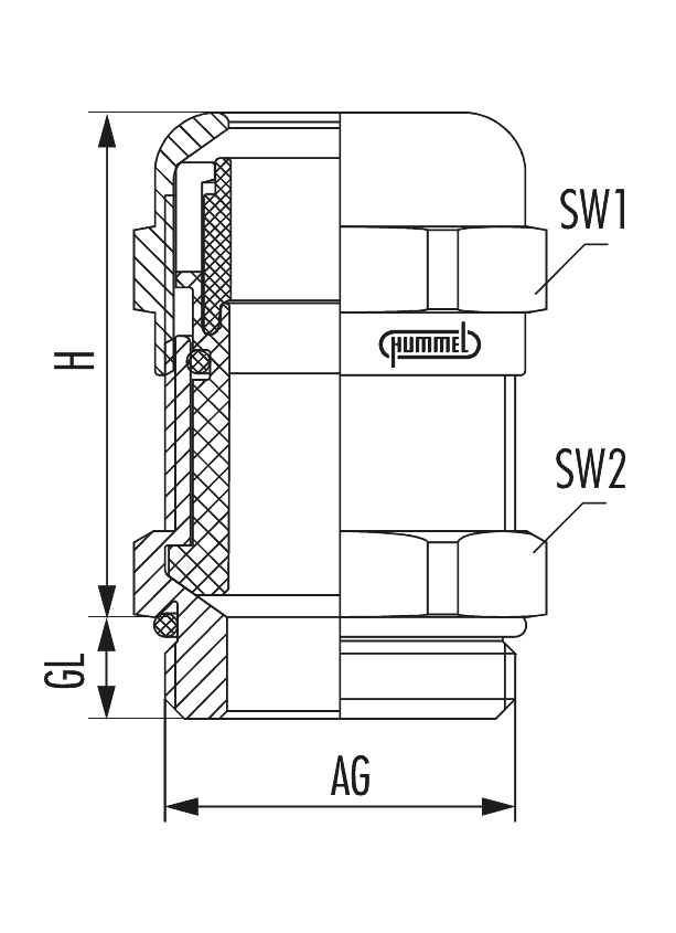

Do you have an accurate OD of these cables? I'm trying to order EMC shielded cable glands, and I need to verify that the HV cables for the LDU are <18mm OD, or larger than that. 18mm is the typical breakover point, where I order one part No., or another.
[later: I've added a "LDU HV Connectors" section to the LDU Wiki with some dimensions. Summary:
the outer insulation OD is ~17.3mm]

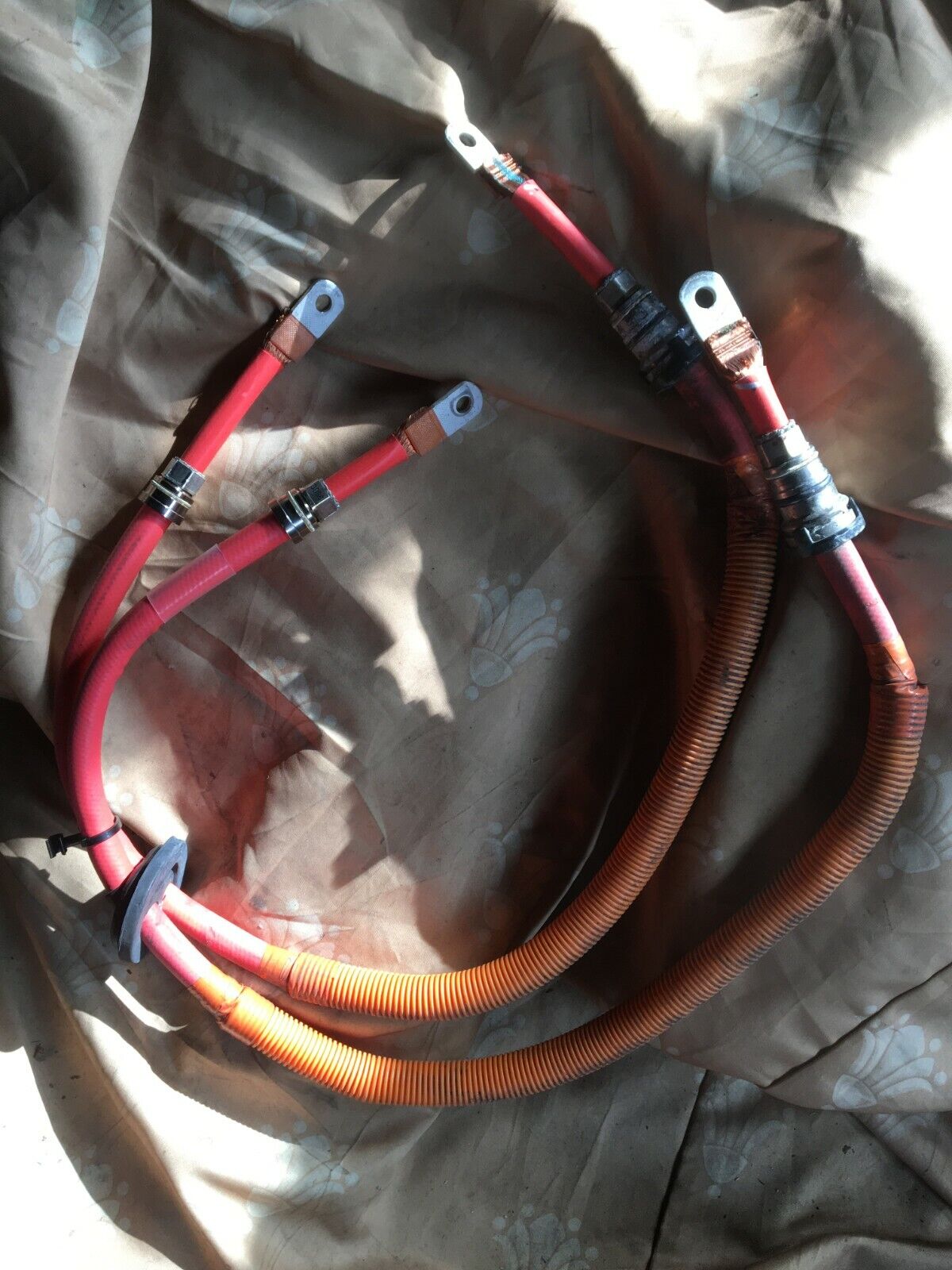

Typical early Model S LDU cables:
(The early Model S LDU HV cables have no bracket on the ends that insert into the GEN1 Rear HVJB, and that is the major distinguishing feature. As the Rear HVJB changed in late 2013 -- requiring a redesign of the HV cable assy -- there are a lot more later Model S HV cables available than early ones. I could have used either in my case -- I'm cutting off the ends that mate to the OEM HVJB -- but the best price available I found was for an early set.)

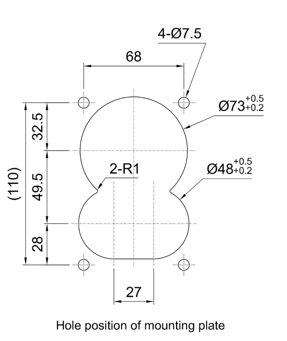

Typical EMC cable gland (for shielded cables, such as the LDU HV cables). Hummel 1.631.2500.50 HSK-M-EMC-D shown (currently USD$17 @ TME):
Here's a fun and short installation video by Hummel for this product. Hint: it's not the product shown below in the preview, which shows their "budget" product that requires straightening the shield wires and folding them back over an insert. The HSK-M-EMC-D line is a bit more expensive but much easier to install -- no fussing with the shield braid -- but is also longer/less compact.
By way of explanation, my particular project -- adding CCS DCFC to a 2014 Toyota RAV4 EV -- involves adding a pair of contactors in a new HVJB between the HV battery pack and what amounts to an early Tesla LDU. I'm cutting the OEM HV cables, adding EMC glands to maintain the cable shielding, and mounting contactors inside a die-cast aluminum IP67 box. Because the system I'm working with uses the early Telsa slip-in cable glands, and I have to continue to use them but lengthen the distance of the OEM cable run, it's just easiest for me to obtain an extra early Tesla HV cable set (with Tesla's proprietary glands) and use the new set on the LDU, in order to get everything long enough to connect to the new HVJB.
That's why I need to know the OD of Tesla's cables. It's also not convenient right now for me to measure my existing LDU cables. But, if nobody has a set laying about to measure accurately, I'll have the eBay ones in hand in a week or so, and I'll update the LDU Wiki with the info.

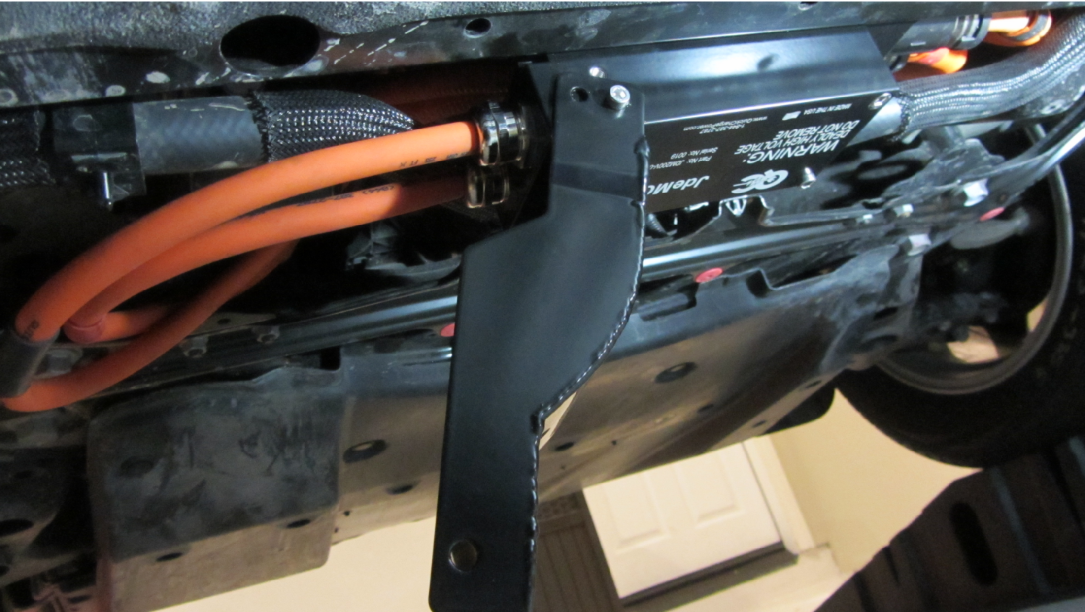

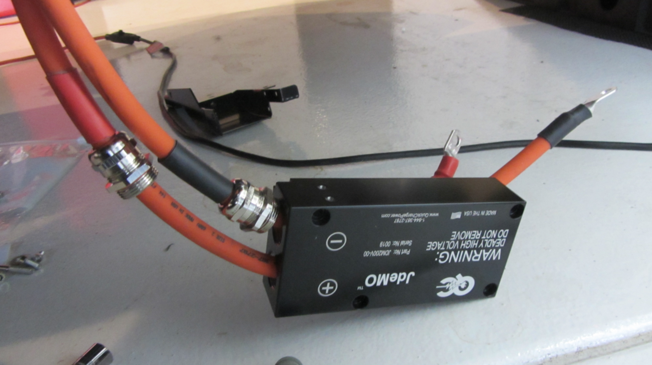

(for those who aren't familiar with it: QCP's JDemo kit adds CHAdeMO DCFC capability to 2012-14 RAV4 EV and MB B250e, and it taps the traction battery pack by adding a "bathtub" to replace a cover that's on the OEM pack, then replaces cable bolts with studs to allow mounting extra cables to where the LDU cables would normally bolt to the HV pack. It's a bolt-on solution that doesn't cut anything except the plastic underbody cover (though it does defeat the HVIL switch on the OEM's cover, which is not replaced) and as a warranty-saving DCFC kit, it was a good balance of compromises. The RAV4 EVs are all long out of warranty now, though . . . )
Reasons NOT to use a QC Power JDemo-style "bathtub" on the front of the RAV4 EV traction battery:
* The JDemo method is clunky. It hangs low enough to require that awful bathtub/cable guard arrangement.
* Fashioning/fabricating a "bathtub" cover that is IP67 is not trivial; QCP's bathtub appears well done, but duplicating it wouldn't be a snap, and testing it for IP67 is not easy without having a spare pack with which to spray it with water at pressure. It's located just above the pavement and at the front of the pack (and the opposite end of where it's located on a Model S!) so testing for water ingress is required. IOW, fab'ing it is expensive in terms of time/labor.
* A new HVJB is required for the DCFC contactors anyway, regardless of how you tap the pack. (JDemo puts the contactors up on top of the stack.)
For those reasons, the cost of a set of used Model S LDU cables is minor, and it's much simpler to connect to the existing (cut) LDU leads than to fab and test my own "bathtub" adapter.
Now, if you happen to already own a JDemo "bathtub", then perhaps reusing those taps makes sense. QCP doesn't sell the "bathtub" separately from the (USD$3,000) kit, so unless you have a JDemo installation you have to start from scratch. Adapting off-the-shelf Model S LDU cables + die-cast contactors enclosure is a lot simpler (and cleaner I'd argue) than the "bathtub" adapter + extension studs route.

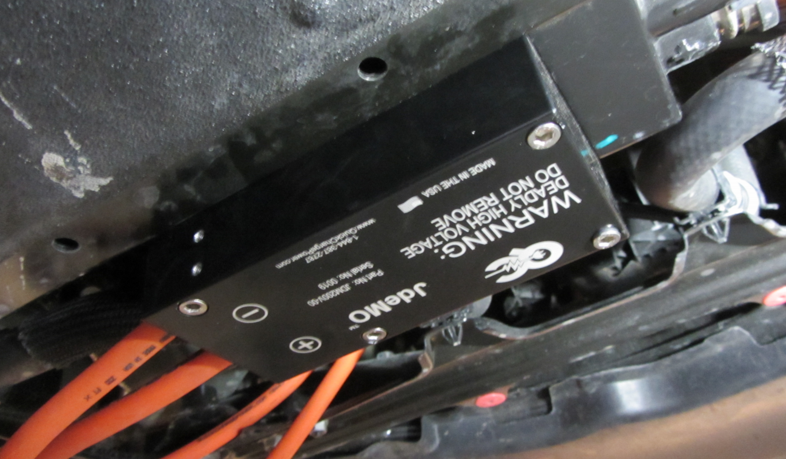

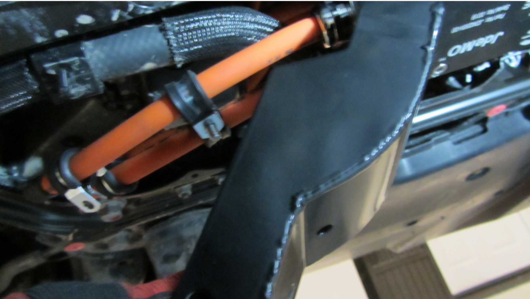

Here's a few pics of the "bathtub" installation (taken from the JDemo installation manual PDF):

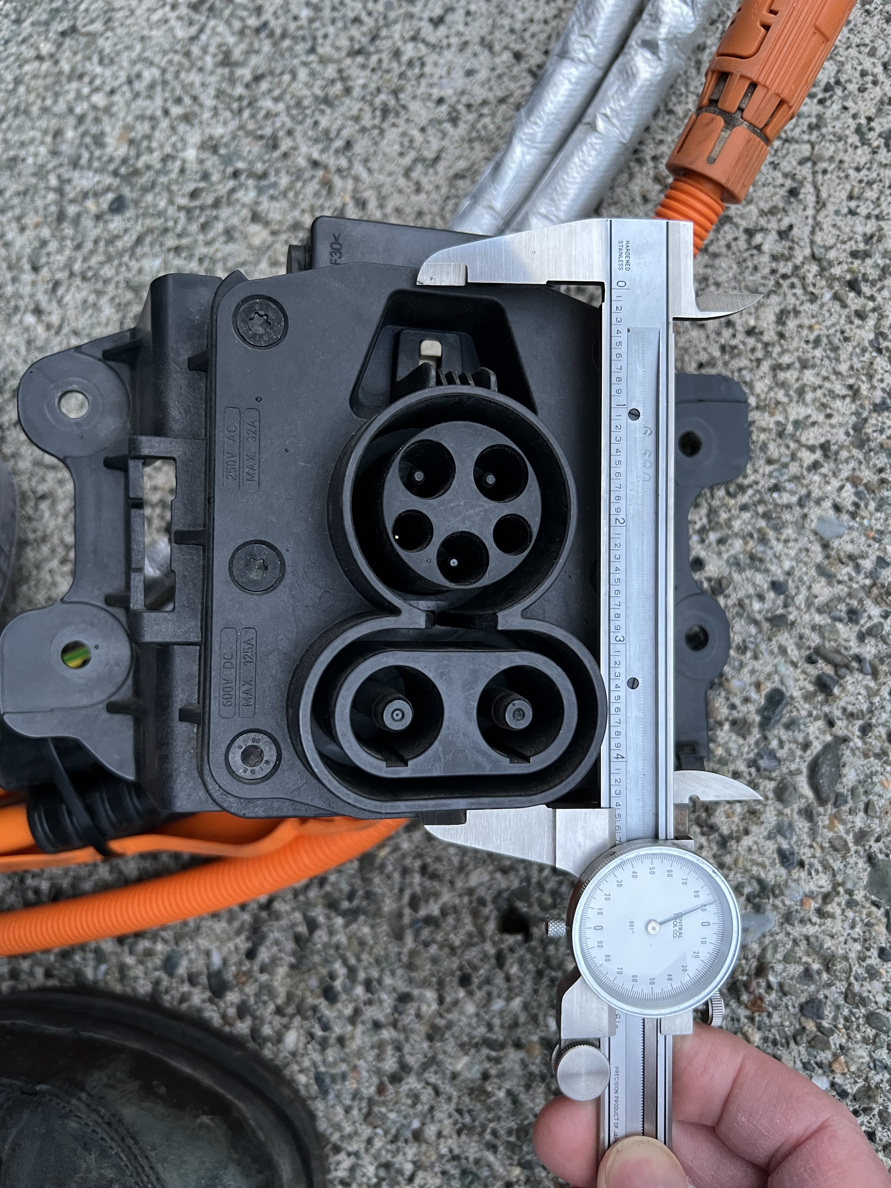

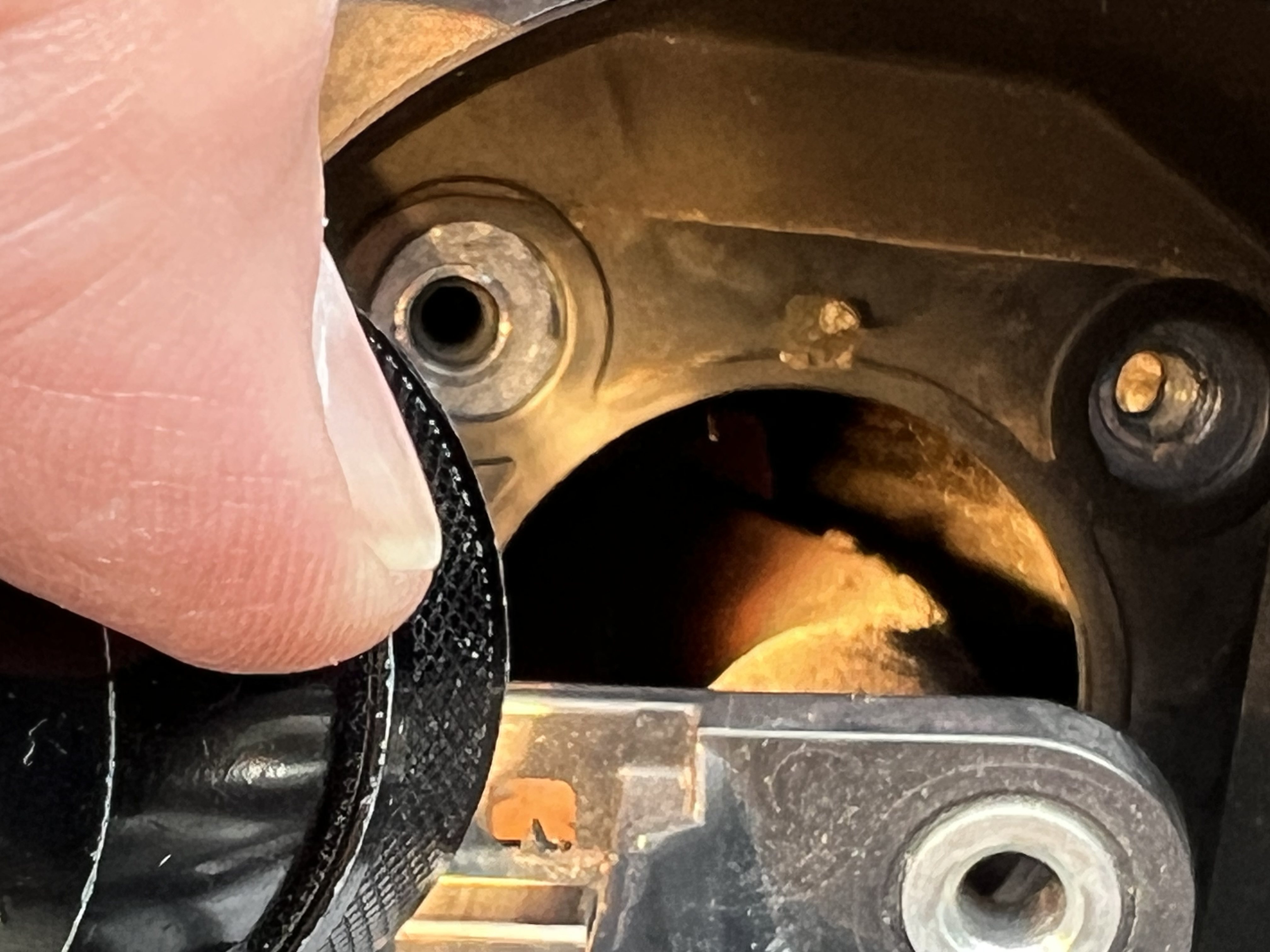

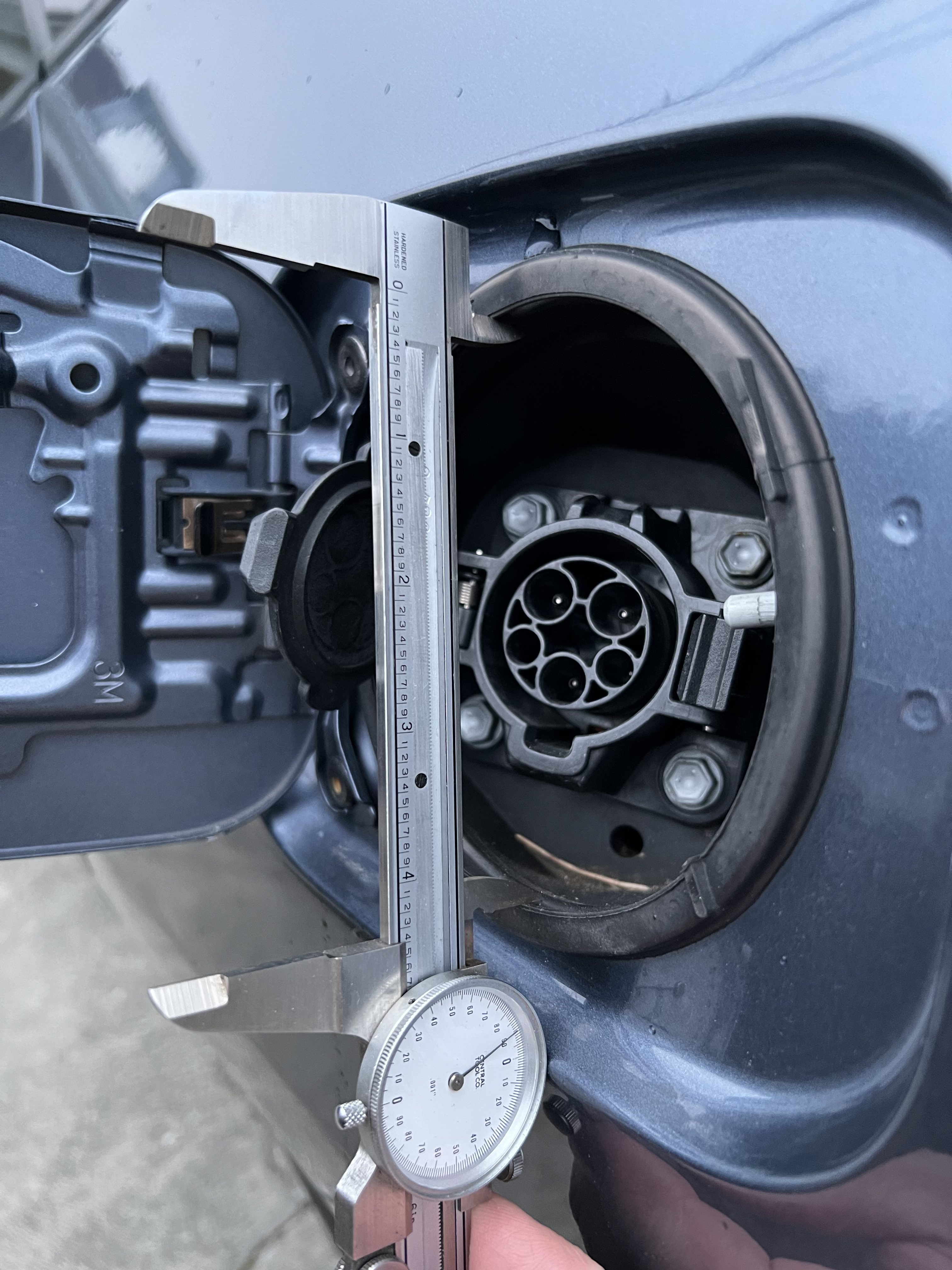

The CCS inlet port I have is from a BMW i3, and just holding it up in the fuel filler port area, it looks to be a tight-but-doable fit. The flap latch mechanism will likely have to go away, as I'll probably need that space. It will not surprise me to find I'll have to remove some of the sheet metal surrounding the current round gasket, squaring it up and removing the flap latch.
If you have a solution for mounting a CCS inlet -- ANYBODY'S -- to that space, I'm extremely interested. I wouldn't mind buying a different CCS1 inlet, if it fit the space better.

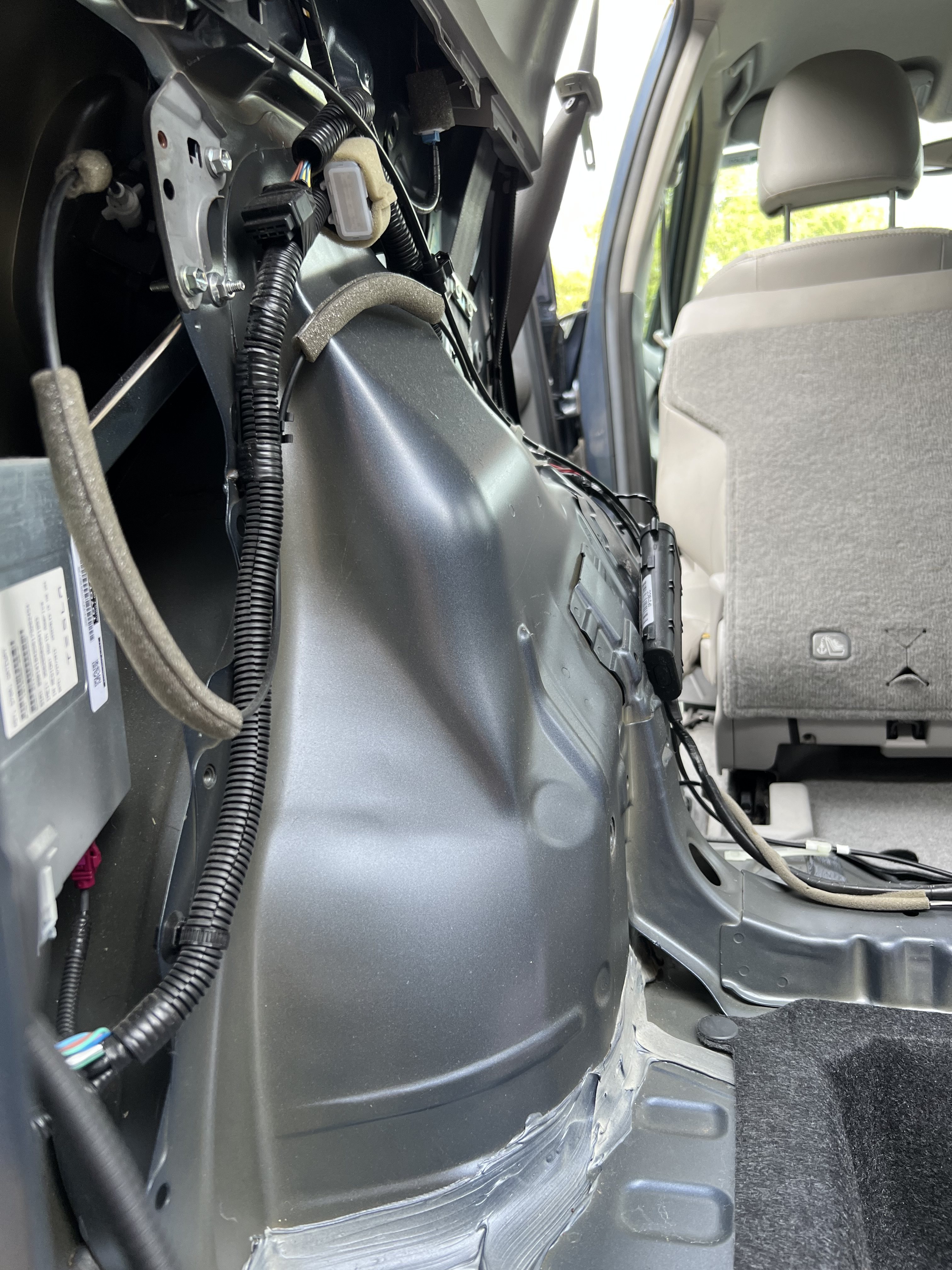

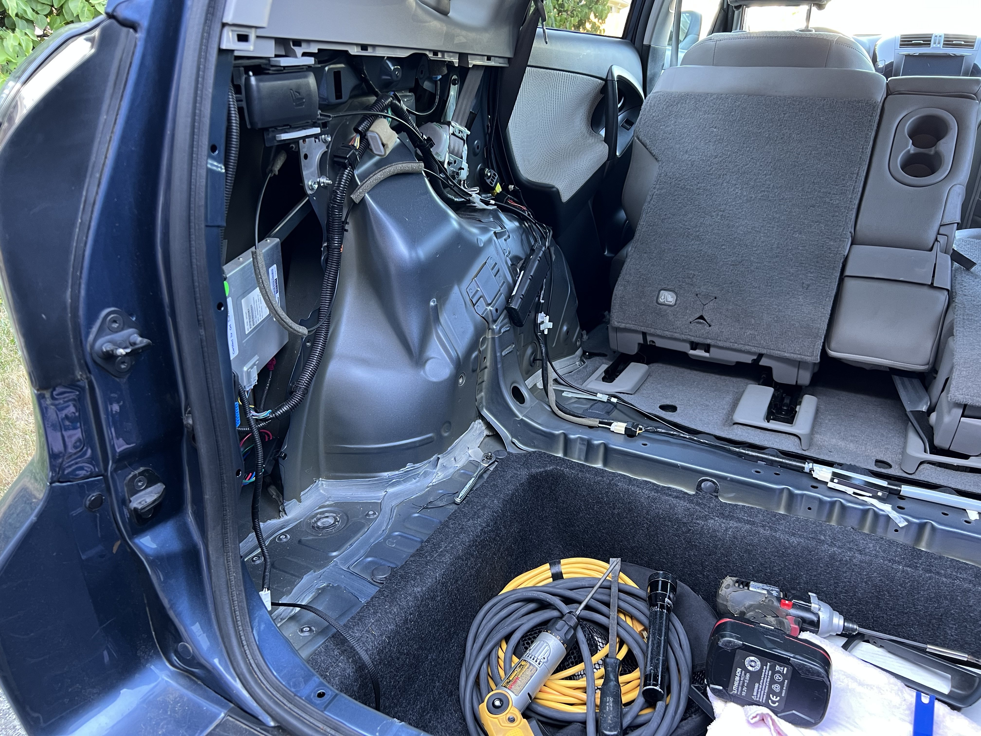

The cabling all runs down the front of the wheelwheel, outside the passenger compartment, and the new cabling should fit there nicely as well. I have not removed the inlet enough to take good measurements, but from a rough view there appears to be (possibly) enough room in the existing space to accommodate the CCS inlet.
If it occurs that a CCS inlet can't fit due to lack of depth, there's plenty of room inside to carve out an oblong hole, and from my cursory measurement it doesn't appear that this would entail modifying the plastic interior trim -- there is a little space (not much) between the side plastic panel and the metal behind it. The CCS' lock motor on the BMW part does not appear to fit well. How much metal will need to be removed will need investigation, and I've been sidelined by adding A/C to my residence :(
The following pics are with the interior side panel removed, when I added trailer/tow wiring and signal converter a couple of weeks ago:

What about possibly using a nacs Tesla connector that would fit the charger door opening more easily.....
Than use a CCS1 to nacs adapter each time we go to a charger?
Or even.... Since much of the Toyota RAV4 was based on the Tesla model s... Could we just source the missing fast charging parts from a wrecked model S?
I've attached photo of a fast charger held up close to our current charger port.

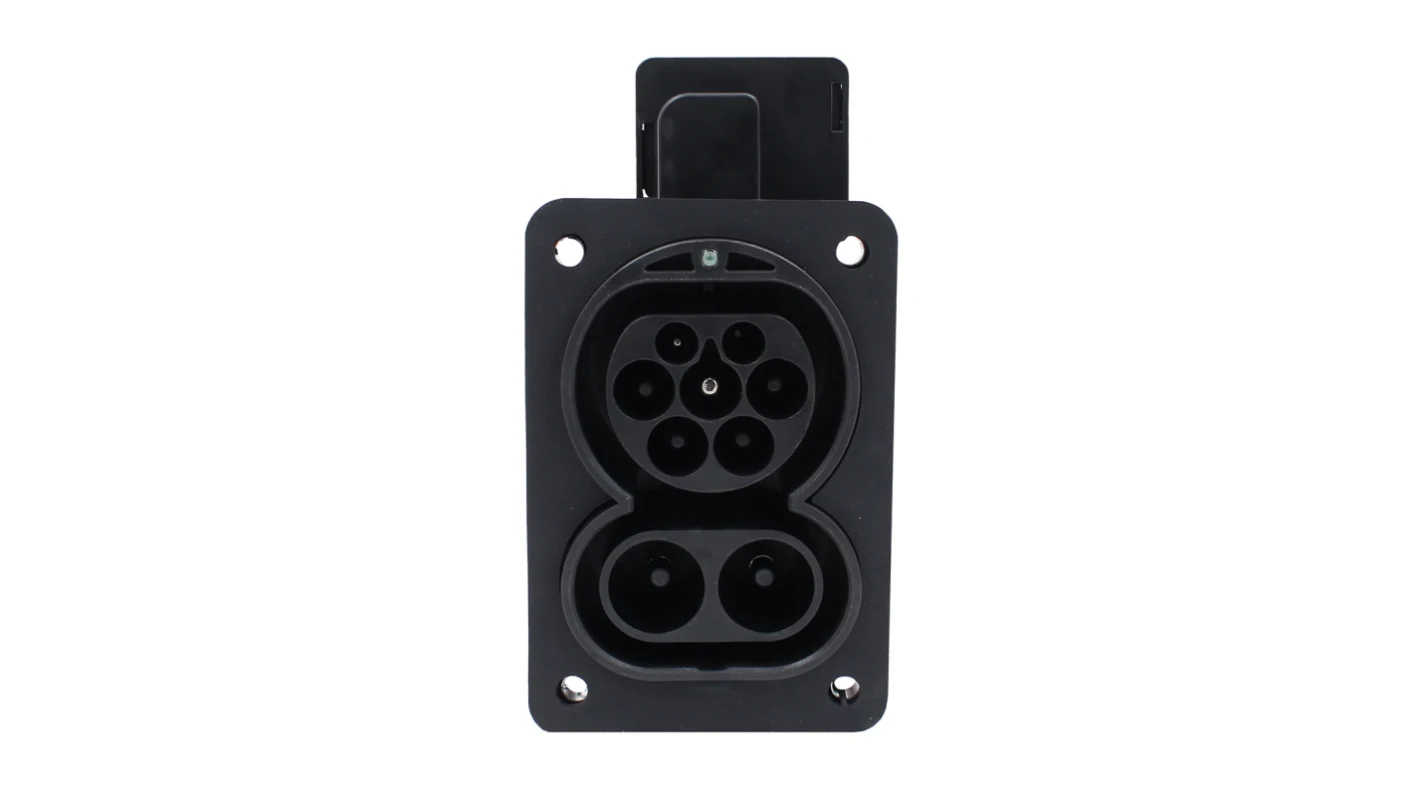

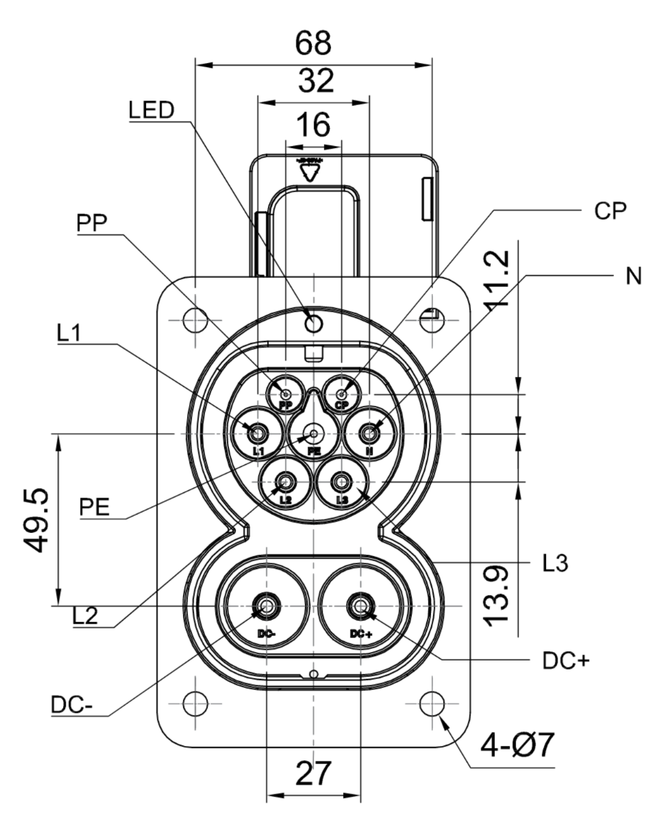

Attached is screenshot of a aftermarket connector I considered, if we still want to replace the J1772 connector.
This connector may be better than the one for the BMW i3, because it sticks out forward more.

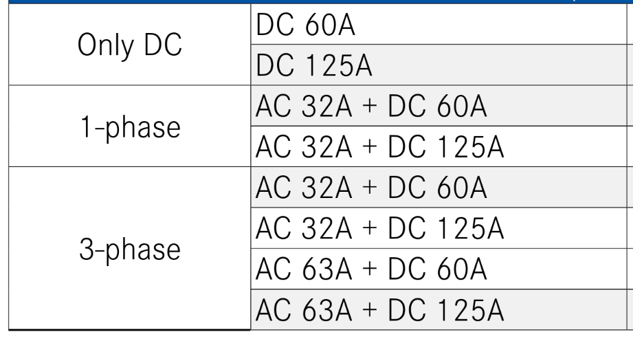

Our RAV4's AC wires are only 10 AWG and are suitable for ~40A AC; for 50kw charging -- what I'm planning for -- 125A DC are needed, which in turn dictates much larger leads, 1/0 AWG or 50mm2, so new leads must be run.
Since we didn't inherit Tesla's NACS nor NACS wiring, it's simplest to connect the existing 10 AWG AC lines at the existing J1772 port to the CCS1 port's AC leads (the top-half, the AC pins of the CCS1 are the same as J1772, physically & electrically). AC continues to feed the OBC just as it always has; DC gets routed to the new DCFC contactors. It's a CCS1 solution to a Tesla DIY EV, even though we are working with a semi-Tesla OEM build.

Shockazulu1 wrote: Tue Jul 18, 2023 10:58 am Attached is screenshot of a aftermarket connector I considered, if we still want to replace the J1772 connector.
BMW i3:
Is there an advantage to having the port project forward more? ATM, I don't know what space is available, and there's always going to be a trade-off: a port that projects forward still has to fit behind the fuel flap door, so it just moves the mounting flange back further. Put another way, the total distance front to back is likely to be the same.
Unless you're willing to leave the fuel flap off . . .

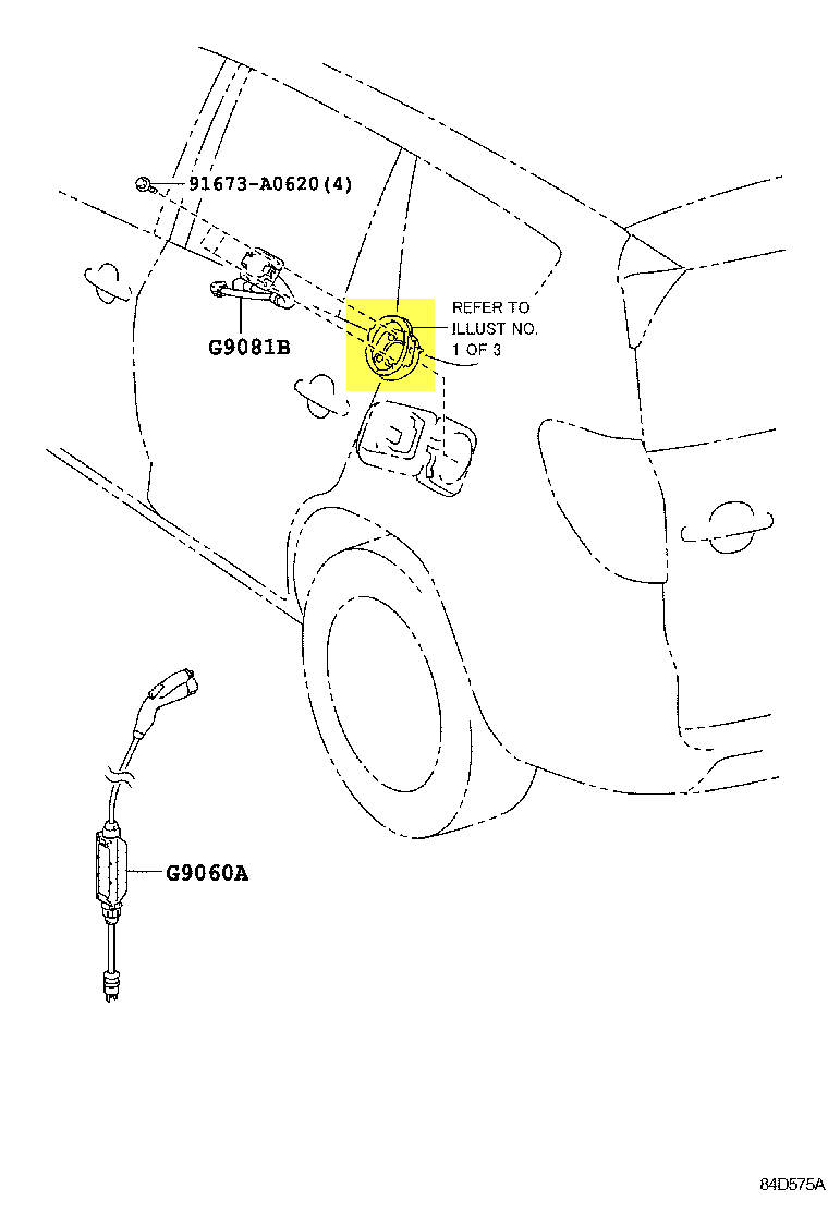

Shockazulu1 wrote: Mon Jul 17, 2023 11:10 pm If I can send you the adapter bracket for the charging port opening . . . Would also want suggestions for it's initial development.
If you remove the J1772 port on your RAV4, behind that is a bracket.
I intend to make a new bracket to replace that one.
I will 3d print the bracket with ABS plastic.

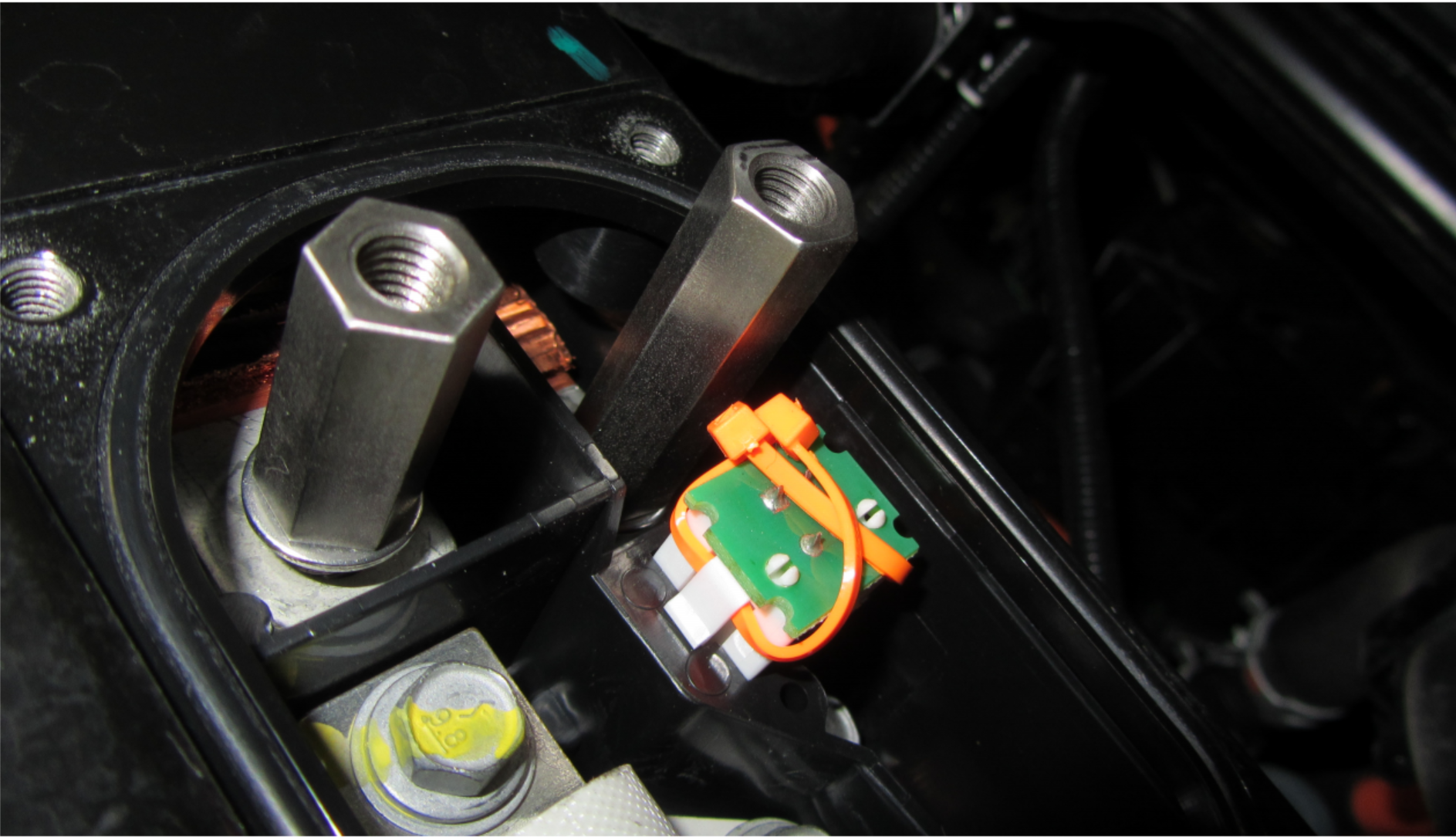

This?
The inlet socket and some leads, G9081-0R01x (three different part Nos., because the 2012 at least didn't have a connector nearby and you had to drop the battery pack to replace a melted J1772 socket -- Thanks, Blink!) bolts to what appears to be a free-floating bit of plastic with molded flexible rubber around it, 58446-0R010, retained to the round hole in the fuel filler area by a circular metal retainer 77391-0R010.
I must be misunderstanding what your ABS bracket will attach to. The circular opening where that thing I will call a "grommet" attaches is too small to accommodate my CCS1's face. Some metal will need to be removed, I'm pretty sure.
Some of the metal bits back there:
These diagrams are maddeningly difficult to get; Toyota is putting completely unrelated diagrams next to correct part Nos., and even diagrams from completely different vehicles :( Third-party sites do much better, but watermark their work.

Looking at the view of the charger socket area, it looks like everything is almost welded together.
May be difficult to create any space inside for the larger connector.
I'll make a attempt to take it apart when I get home from work today.

I'm reasonably certain that a CCS inlet will not fit within the current circular location. The bottom of the CCS connector is flat. Maybe modifying the top of the CCS port, eliminating the lock? Not recommended, but . . . what's your risk tolerance?
If you're not amenable to cutting metal at the fuel filler area, then you might look at installing at the grille area. Or try to figure out how to use NACS.
Well, the metal parts are spot welded and seam sealed: typical construction. There are two fitment issues:
* Is there enough depth? Can the cables make the 90° turn forward? There exist CCS ports where the leads exit to the side; they can be ordered "leads left" or "leads right", but I've only seen them for commercial vehicles, and it doesn't appear to reduce the depth requirement.
TE Connectivity:
https://ie.rs-online.com/web/p/ev-charg ... 83524?gb=b
Something I've just come across that might fit better is something akin to the Amphenol HVCO series of CCS inlets, in which the lock motor location can be selected from various options:
https://ie.rs-online.com/web/p/ev-charg ... 41919?gb=b
Datasheet: https://docs.rs-online.com/6228/0900766b81638f58.pdf
One issue I see -- which is also an issue with other CCS inlet ports -- is that the rated current for the AC pins is only 32A; as you know, we can draw up to almost 40A. Surely a reason to go with a separate CCS port somewhere else, leaving the OEM one in place. In that case, you'd install a DC-only CCS port, which is an available option:
I don't have time to look for a comparable CCS1 version of this today.
A 1-ph (CCS1) version is https://www.amphenolpcd.com.cn/products ... i-791.html, with 7 pins rather than 9.

You can't do much without pulling the wheel off, then removing the plastic wheel well harness cover. The picture I posted earlier of mine pulled out 2" is about as far as you can go from the topside, and you can't measure or really even see anything with only that much room. I can't pull the wheel off mine right now, so I didn't go any further.
