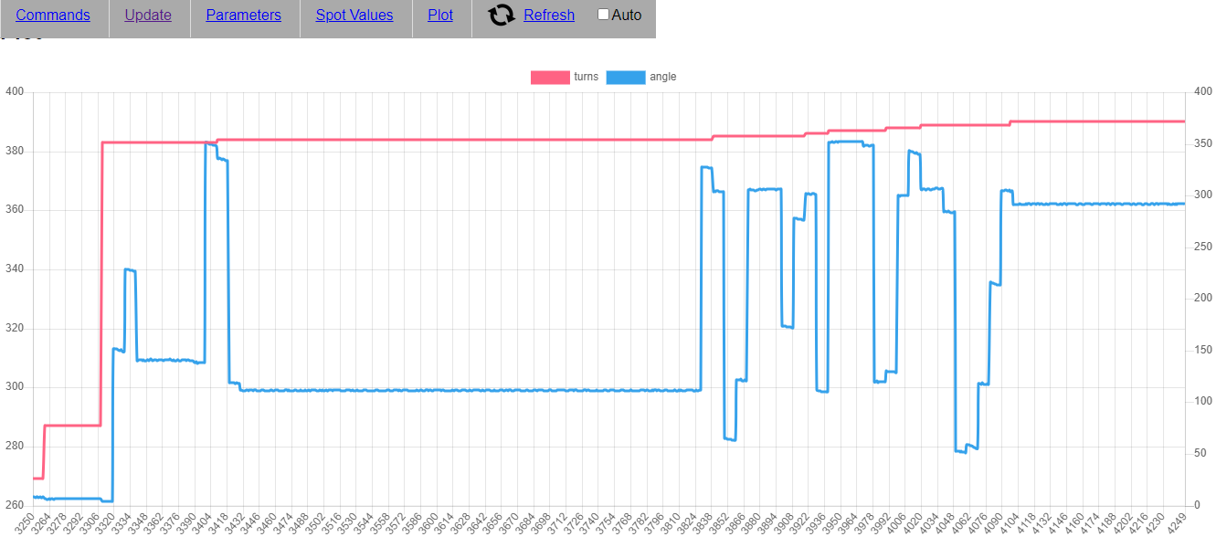

I raised the rear of the car and spun the wheels by hand in first gear. See image "manual turn". Feedback is rather choppy as expected but angle changes when the wheel is turned.

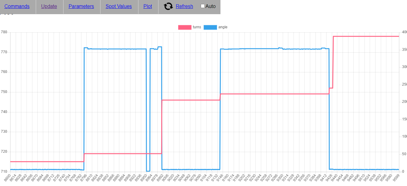

I tried giving some throttle in neutral. Just the slightest nudge in angle with every throttle input, then the output shaft bounces back again to the original angle. See image "acc press"

So you get inverter wine and current flow then? It doesn't really make sense but what if you add Resolver pinswap? Somehow sounds like the classic "field turns clockwise resolver measured anti-clockwise"DarkwingDuck wrote: ↑Thu Aug 10, 2023 4:52 pm One more note. I can still get the inverter to trip overcurrent by flooring the accelerator/throttle for a few seconds. Maybe that helps in troubleshooting.
Software should be backward compatible down to the first version. But always new parameters are added and you need to check for sanity
