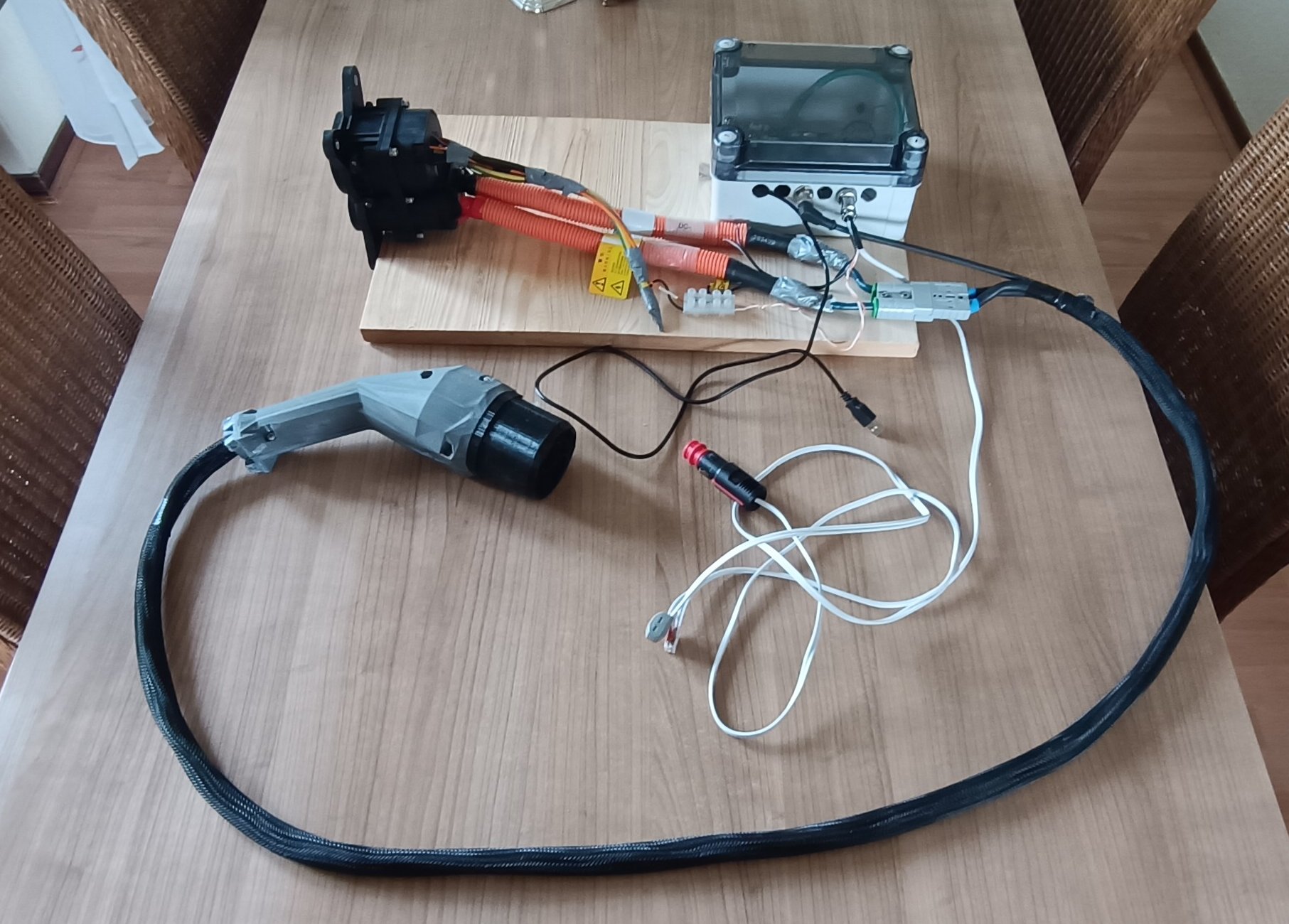

My latest wood work incarnation of CCS to CHAdeMO
Maybe one way of using this with a Nissan Leaf would be a little CAN bridge that grabs battery voltage from the BMS from PT-CAN and outputs it into a special message on CHAdeMO CAN

Post by celeron55 »
Battery voltage is available on OBD2 on the Leaf, right? How about a Bluetooth OBD2 adapter, and just make that woodwork thing read the values over bluetooth?

Re: Is it possible to make a CCS to CHAdeMO adapter?
Yeah, that should so. Just some USB Bluetooth dongle on BeagleBone needed then. And knowing how to read something

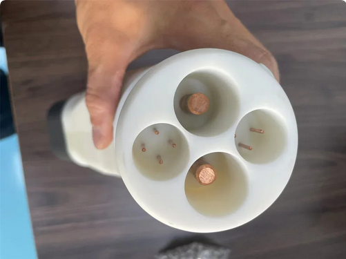

Hello
I've been searching for an adapter like this as I recently got my 2023 Outlander PHEV. Here in Western Australia the government is rolling out EV chargers without CHAdeMO support, while still collecting tax off CHAdeMO users, but I digress. I've had no luck in getting any replies from any government worker on this matter so either they know they've stuffed up and succumb to vested interests or they just don't care.
So it looks like a CCS2 to CHAdeMO adapter is what I need. Initially I was looking at putting a type 2 cable on one of those 10kw portable SETEC chargers but it's a lot of money for marginal charge rate.
I'm not sure if it's useful, or even a real product but in my travels I found this. It appears the rendering is wrong, it seems they have two plugs on the adapter, but the text does say "Use for connect the charging cable on a CCS2 charging station to a CHAdeMO vehicle that has been enabled for DC charging."
Talking to their sales team they say the unit is in production and is expected to be mass produced by the end of the year. Again, I have no idea if this is true or not or if the product even works.
https://www.aliexpress.com/item/1005006 ... h%21AU%210
However they do have a correct render for a CCS1 to CHAdeMo connector and an actual product for a CCS2 to GBT for what it's worth. While pricy, hopefully it is true and the answer to my charging problems.

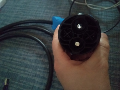

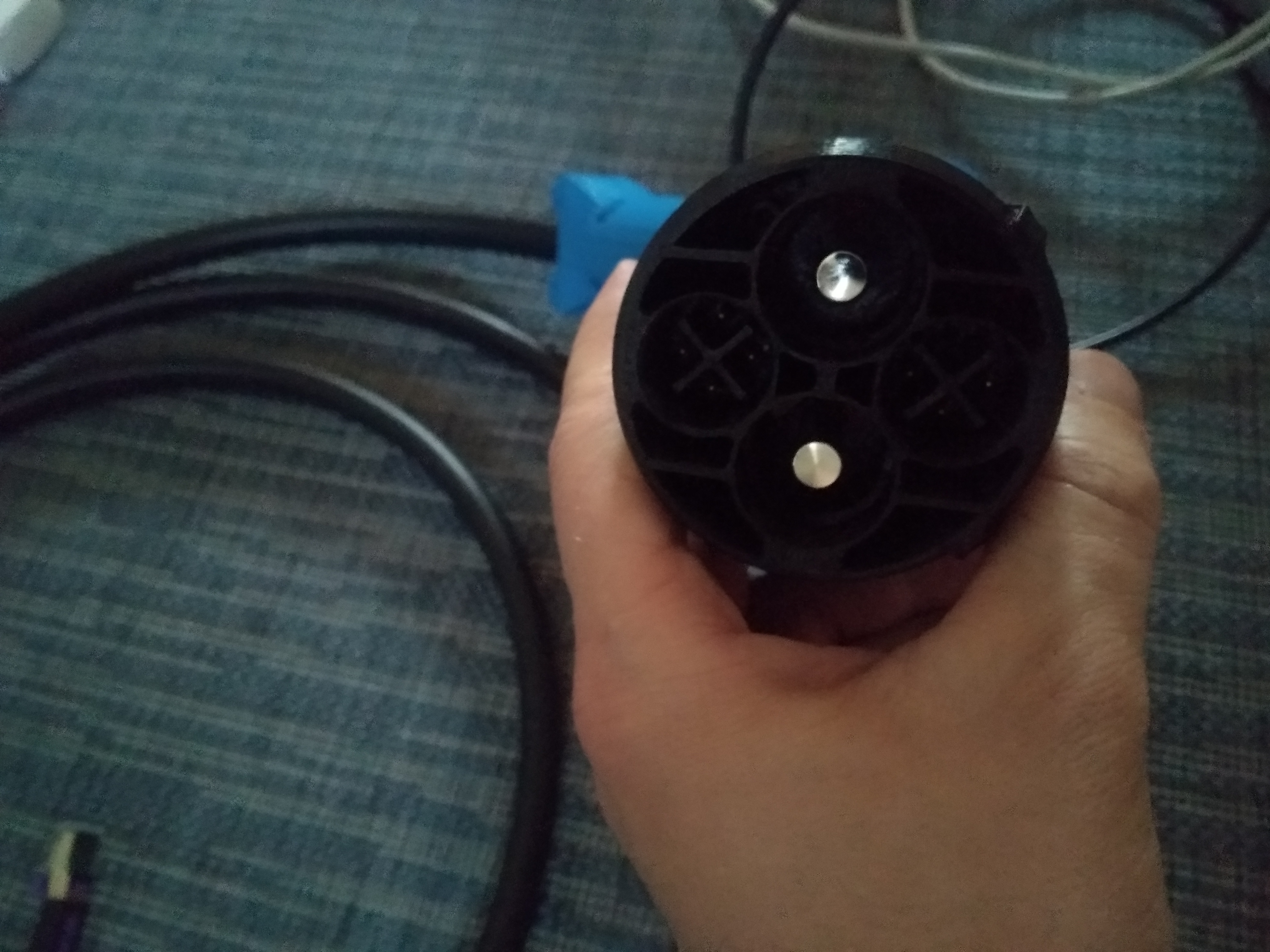

here is my chademo plug twin :)
I am working on ccs (car) to chademo (charger) adapter. I am planning use foccci board for ccs side and my developed hardware for chademo (charger) side.

uhi22 wrote: Tue Oct 24, 2023 5:31 pm Did not understand which variant you are planning. Charging a CCS car on a ChaDeMo charger? Or the other way around, like Johus Touran adaptor?
Sorry, on the picture is diy chademo male connector so its for charging Nissan Leaf from ccs charger - CCS(car side) to chademo (charger side) adaptor

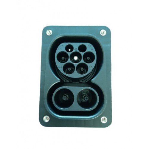

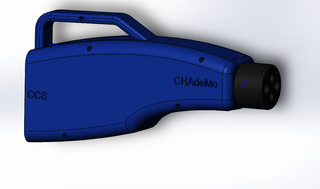

First attemp to design adaptor case for standard ccs socket from ali.

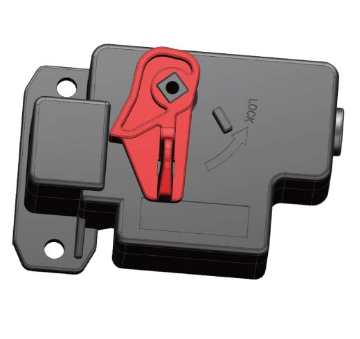

Post by explorer232 »
*Added ccs lock (Socket Actuator Uchen DSIEC-ELM ) to design

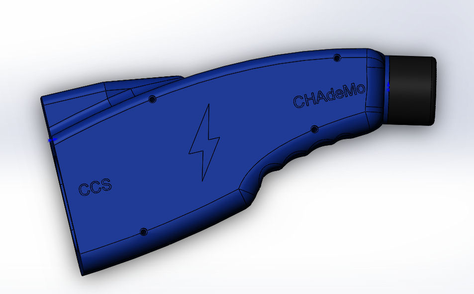

Post by uhi22 »
To reduce the bending moment on the ChaDeMo connector, I would suggest an angled connector 20 to 30 degrees instead of the straight line, so that the electronics, the CCS socket and the CCS connector is located below the center line of the ChaDeMo.

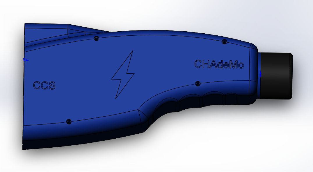

uhi22 wrote: Thu Nov 02, 2023 7:18 pm To reduce the bending moment on the ChaDeMo connector, I would suggest an angled connector 20 to 30 degrees instead of the straight line, so that the electronics, the CCS socket and the CCS connector is located below the center line of the ChaDeMo.
Thanks for your tip. Fixed

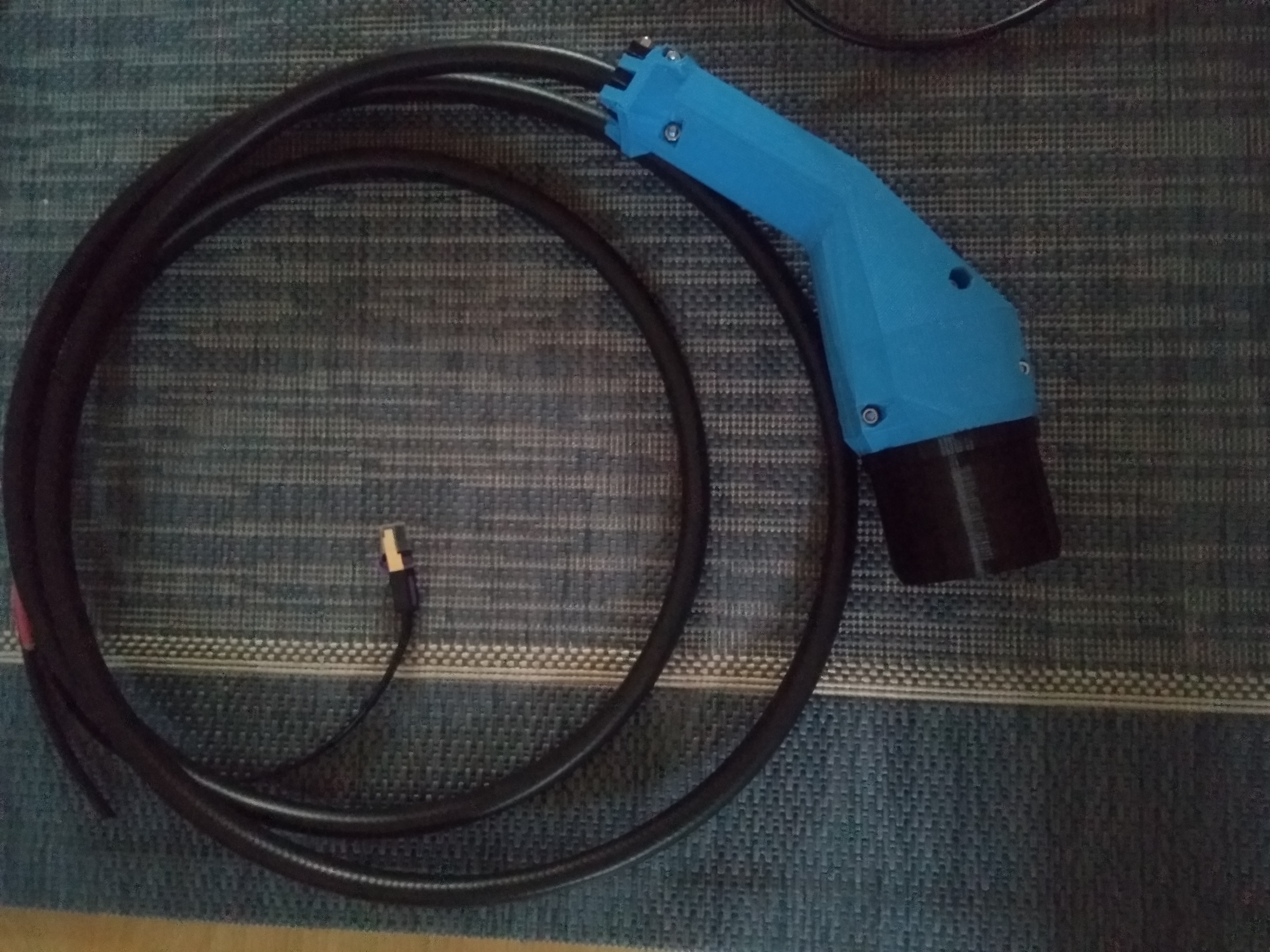

Files and information for building a 3D printed CHAdeMO plug, may be useful :
https://www.thingiverse.com/thing:121581
