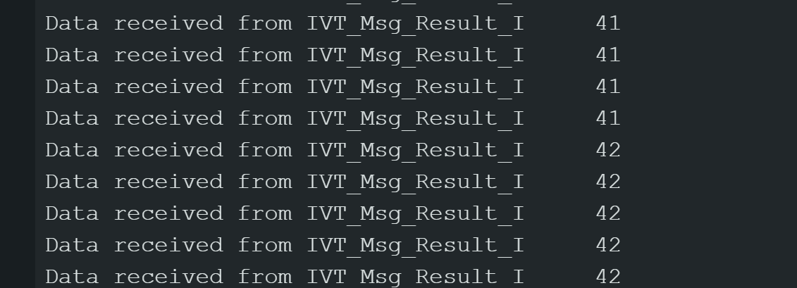

0x620 ID just changes on itself - load or no load.
Data received from IVT_Msg_Result_I	-37
Data received from IVT_Msg_Result_I	25
Data received from IVT_Msg_Result_I	150
Data received from IVT_Msg_Result_I	37
Data received from IVT_Msg_Result_I	12
Data received from IVT_Msg_Result_I	0
Data received from IVT_Msg_Result_I	125
Data received from IVT_Msg_Result_I	-25
Random data on 0x680 too - continuously counting with some delay..... :?

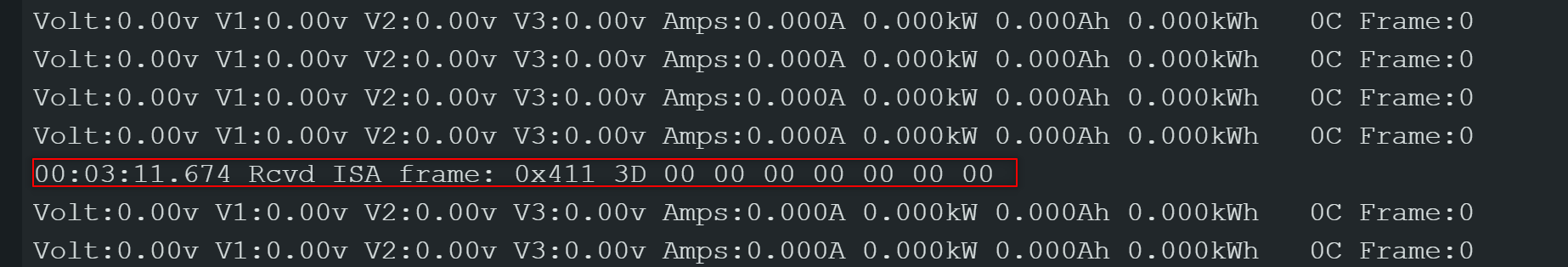

royhen99 wrote: Wed Sep 27, 2023 9:10 pm It looks like 0x620 is the current reading. You could try send 0x3D on byte 0 of ID 0x411 to reset to factory default settings, check CAN ids at this point and then initialise as before.
Tried this without success. :( Within the ISA.cpp there's deFAULT function. Added the case to the code. Triggered it, but no result. Still only receiving 0x680 and 0x620 IDs. Initialising after that doesn't work either.

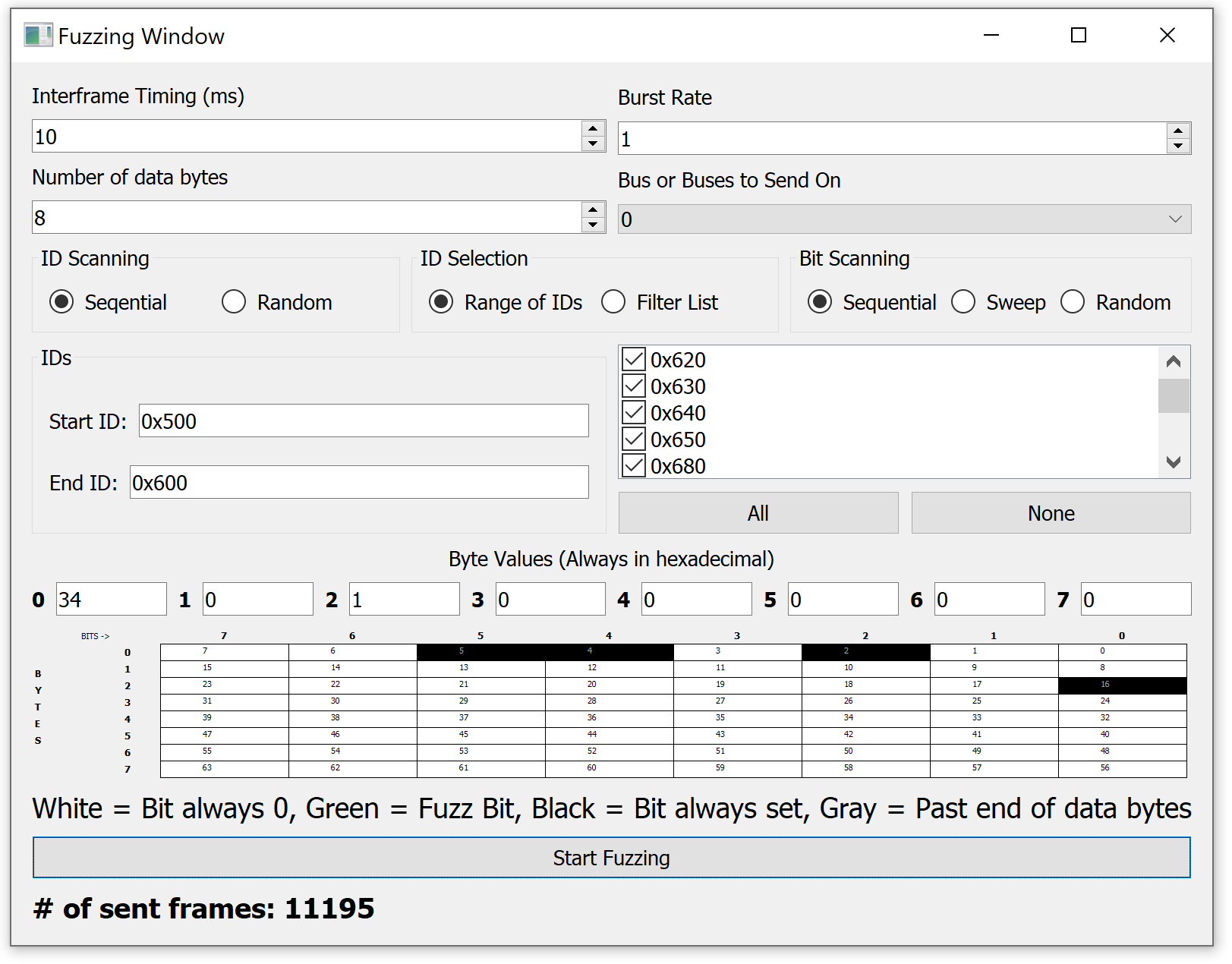

For future somebody who will get in the similar situation and not a programmer just like me....
Setup SavvyCAN using this...https://openinverter.org/wiki/CAN_bus_with_Arduino_Due
Watch the video in the wiki to get yourself familiar with the SavvyCAN interface
Follow this tutorial for fuzzing.
You'll see a live data from sensor when connected.
I decided to "fuzz" with the STOP command over a span of IDs to ensure I do not miss a response.
Turned out that my Command ID was 0x600 and Response ID was 0x610. I essentially ran the fuzzing until the sensor accepted the STOP command and stopped transmitting data and sent back confirmation.
Confirm by requesting data from sensor, e.g. request sensor version
Send Factory reset command to the command ID discovered above - data: 3D 0 0 0 0 0 0
...and voila, sensor transmits data over default IDs, ready to initialise.
After initialisation:
Connected 12.09VDC to V3 input:
Amps are a little jumpy, but rather close. I think it's because my load is much too small (only 0.04A) for a 1000A sensor, cannot find anything larger in the house to test with.
