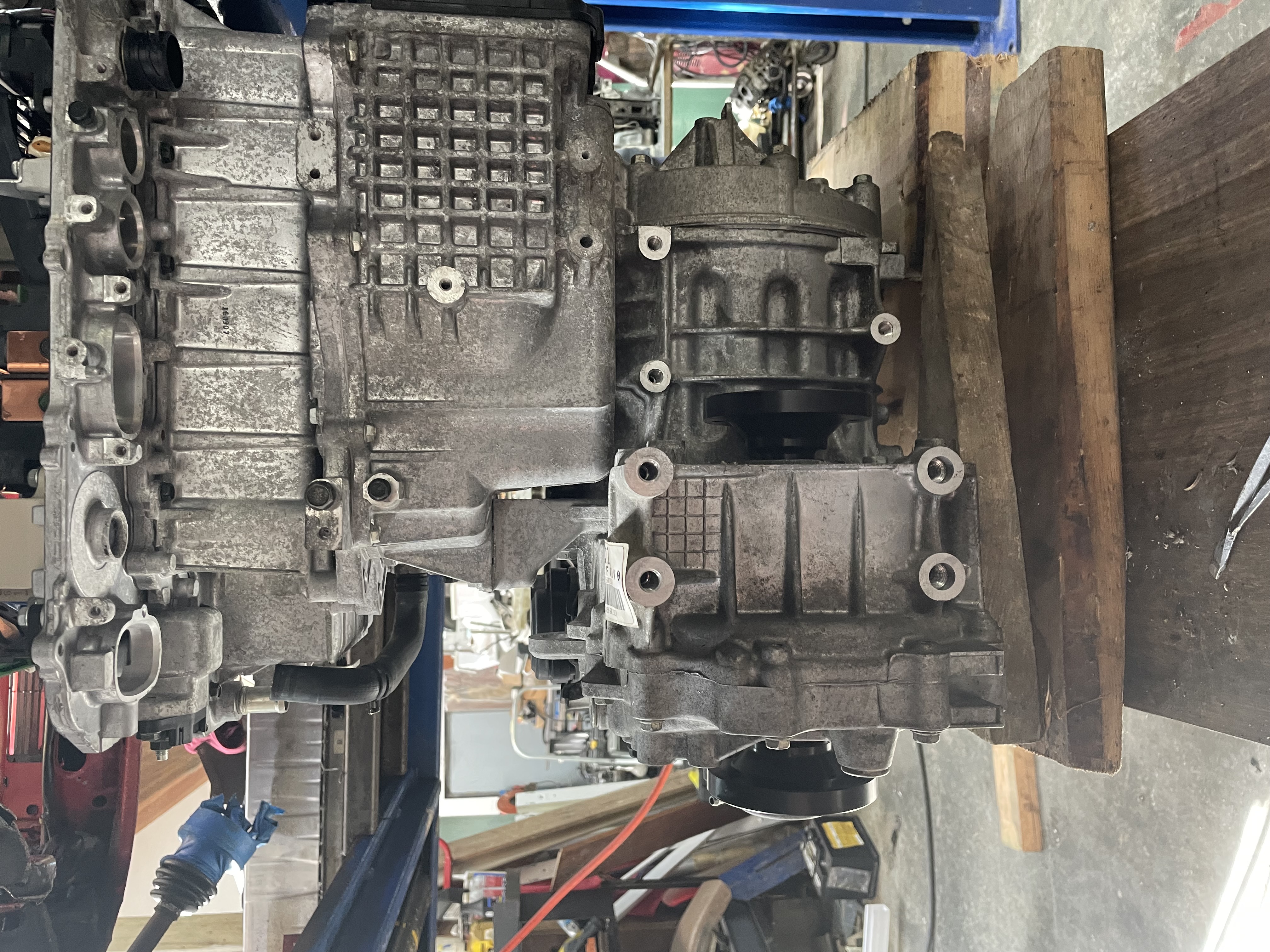

Got the 2 side motor mounts mocked up!
The leafs torsional mount is on the back of the gearbox, so I’m going to make a cradle that wraps underneath the gearbox. the cradle will mount to the front beam in the engine bay and the engine mount just below the firewall. the leaf mount will then float on that.
and it fits! axles connected and are at happy angles, Pdm clears the hood!
for the drive shafts, I removed the inner carrier barring from the leaf stack, pulled the seals and replaced them with 56x36x8 shaft seals. 56mm is the bore id on the leaf, 36 is the od of the vw flanges. after that popped the stub shafts in and slid on the flanges! Then the vw axles just bolt right up to the leaf gearbox!
also swapped the power steering rack for a manual one 💪🏽

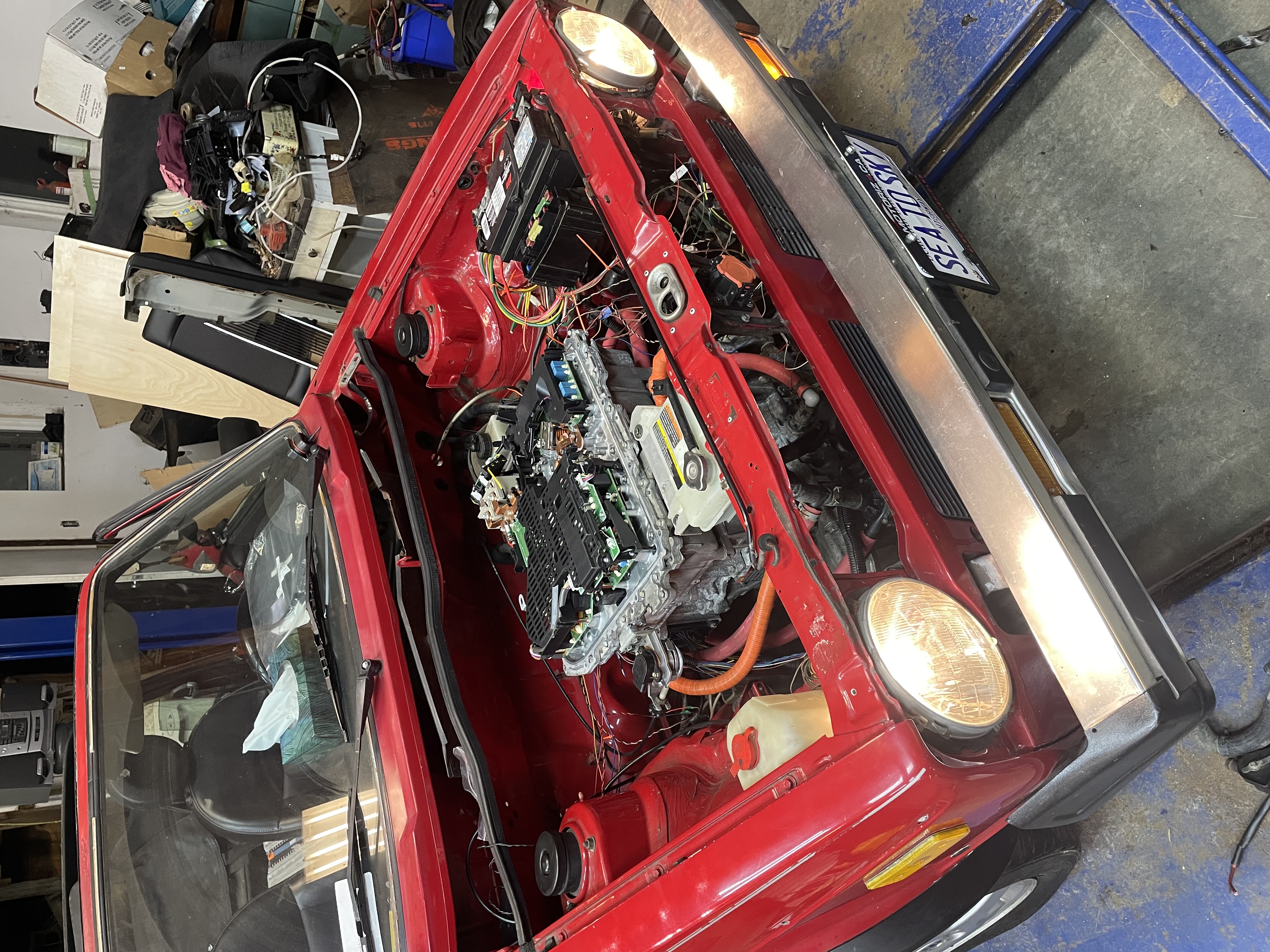

Honda throttle sensors mounted on the side of the leaf.
Melted off the plastic end on the stock vw throttle cable, will have to make a bigger crimp/end for a secure connection on the sensor cam.
for the 12v wiring, re used the leaf battery tray, relay box and 12v cables.
Stock leaf coolant tank mounted and water pump.
coolant series loop through the heater core with some 3/4 hose.
bottom cradle is mostly done.
Links from the body mount near the driver side lower controller arm bushing, to the beam spanning across the front.
Then the gearbox bushing bolts to the cradle.
It also acts as a skid plate for the gearbox, as it dose sit a little low.
next up is mounting the zombie where the original ECU was under the kick panel on the passenger side. Then clean up lv wiring.
went for a quick test run, all the power in forward, almost no torque in reverse, could barely get it off the lift

cleaning up wiring, coolant, etc. engine bay is 99% done
hv battery and interior wiring next and then off to the races

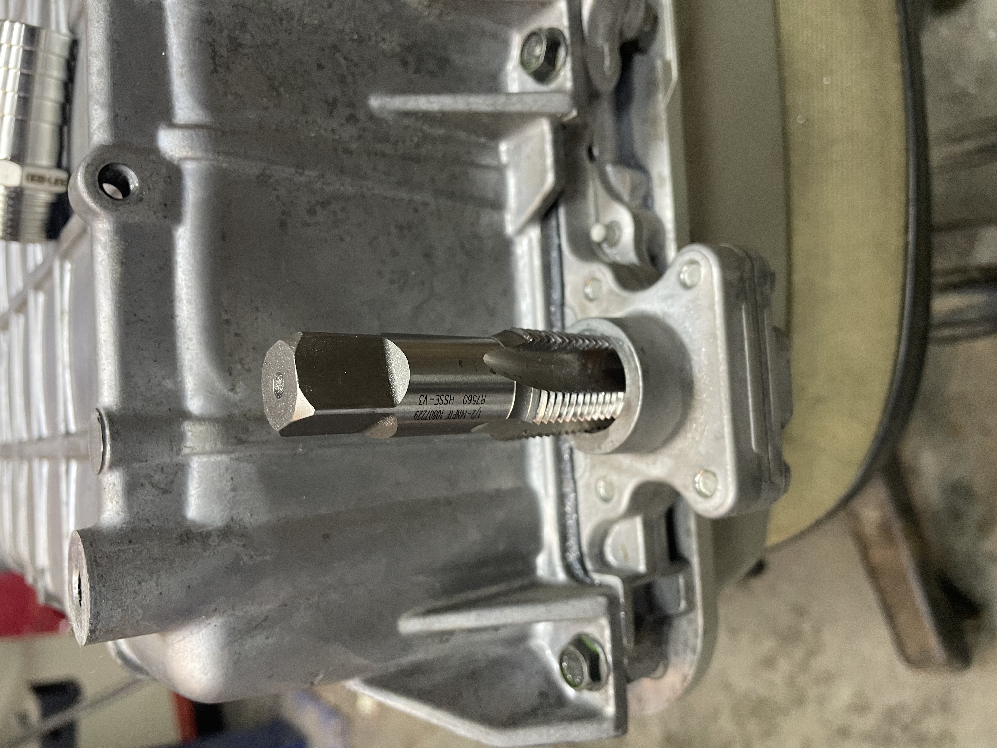

Tip on if your pdm is missing a coolant spigot, 1/2 npt tap fits perfectly !
