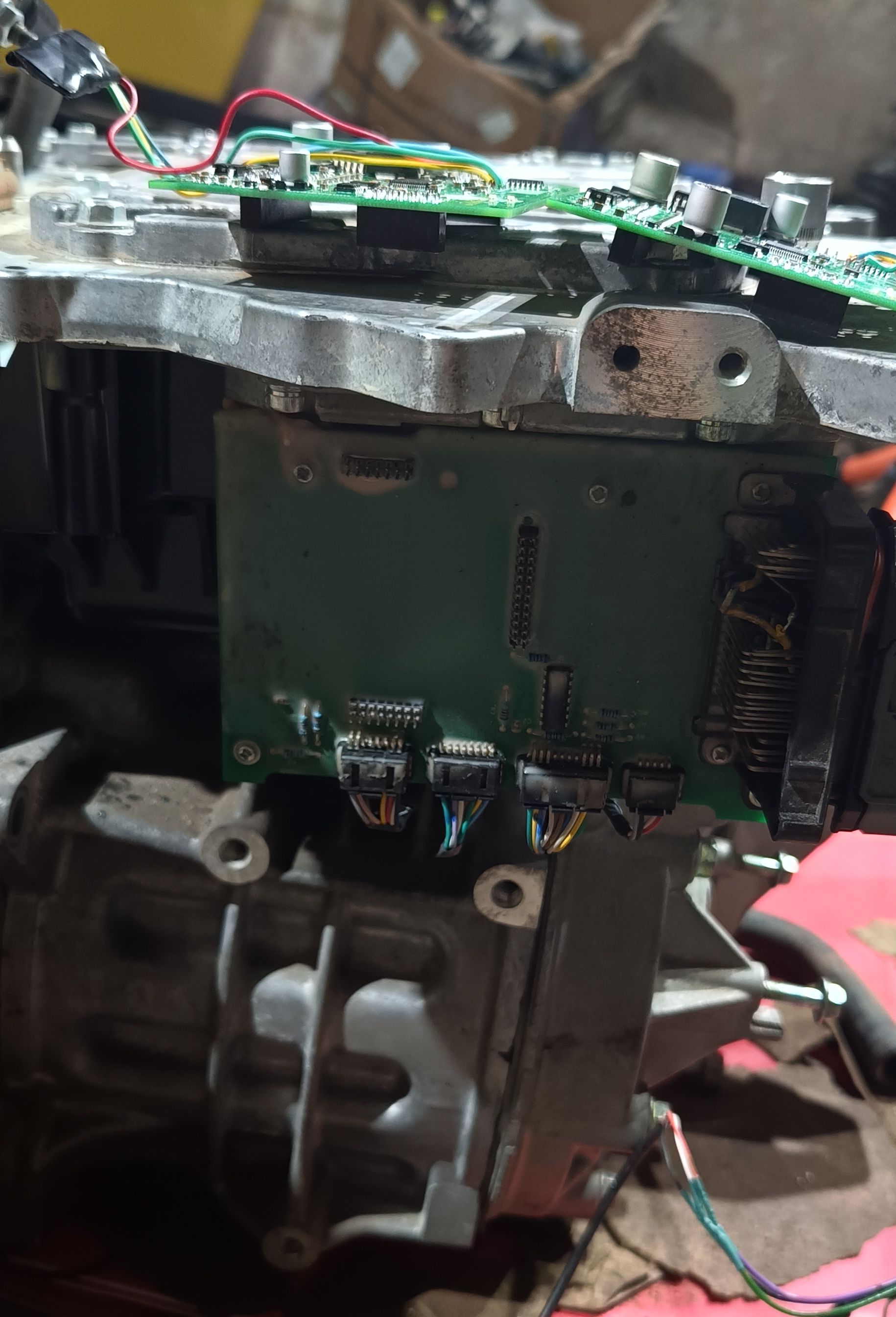

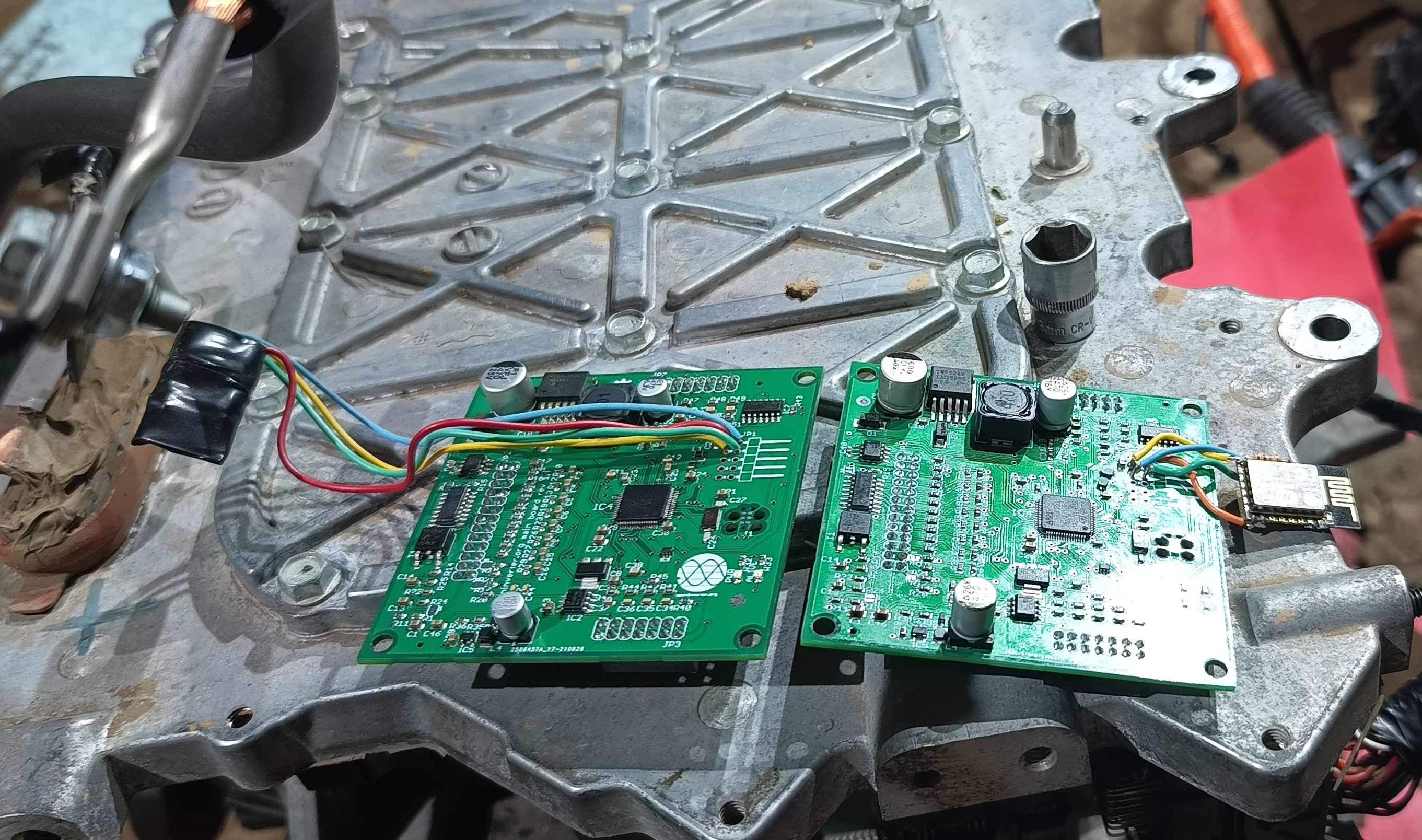

I recently downloaded the files for the manufacture of the v3 board from a new one and after I received them from China, I came across a strange behavior of the controllers. they didn't want to work with the old settings! coincidentally, it started with a new em57 motor and I thought that the motor was defective or there was a different pinout in it. I tried to switch on the phase wires and the resolver sensor in different ways. it always turned out that the connection should be the same as before, but the syncofs is exactly 180 ° (32768),
I suspected that I made a mistake soldering the wires from the brain to the drivers, something got mixed up in places. However, today I got my old motor, an old inverter and an old v3 board. firmware 5.27 is running syncofs 0! but as soon as I put a new brain, the correct value is already 32768!
So?
Where is the error and what is it? The sine cosine signals did not change here, I checked the angle graph by rotating the motor in one direction with my hand, in both cases it is depicted the same way.
