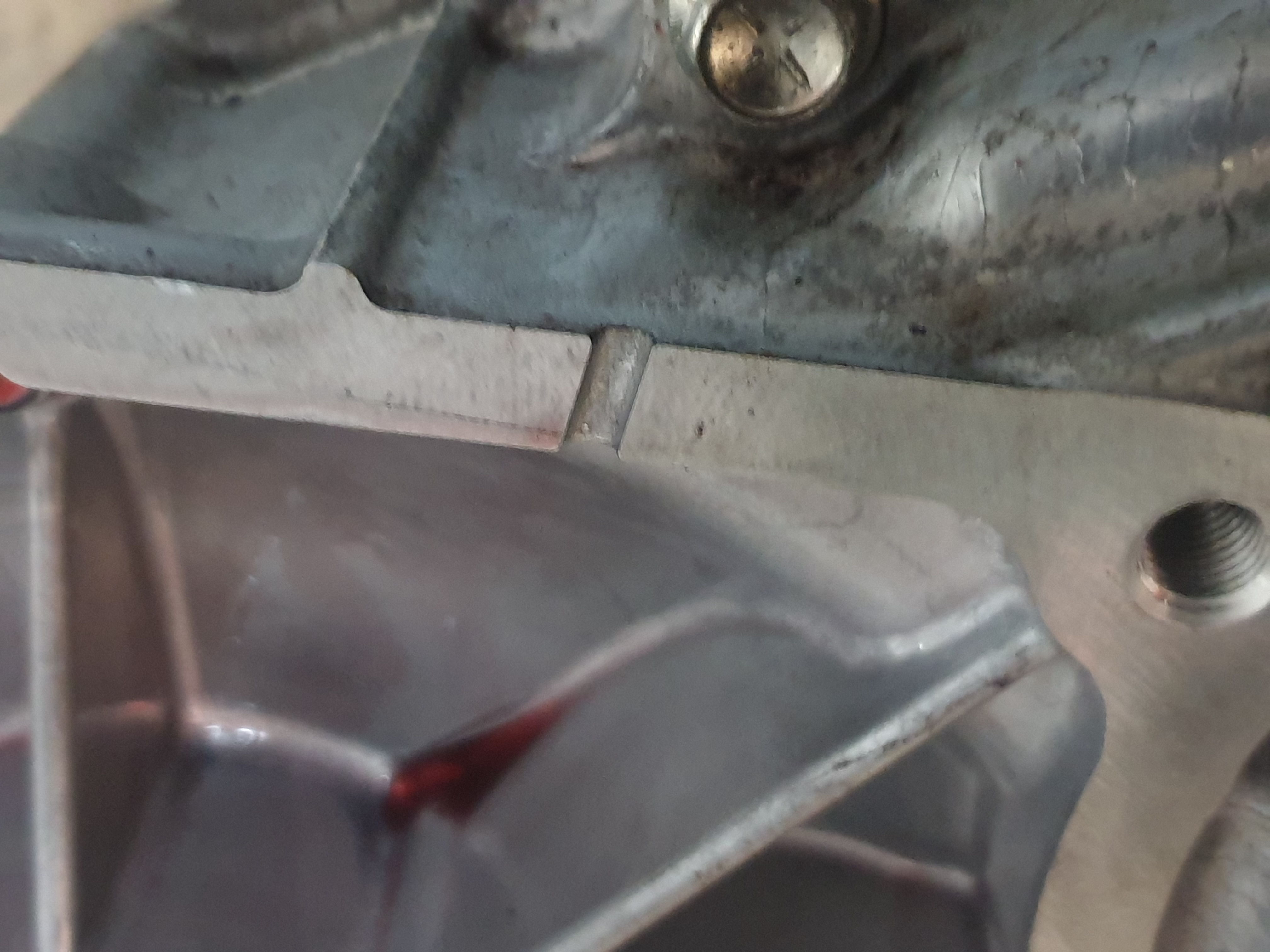

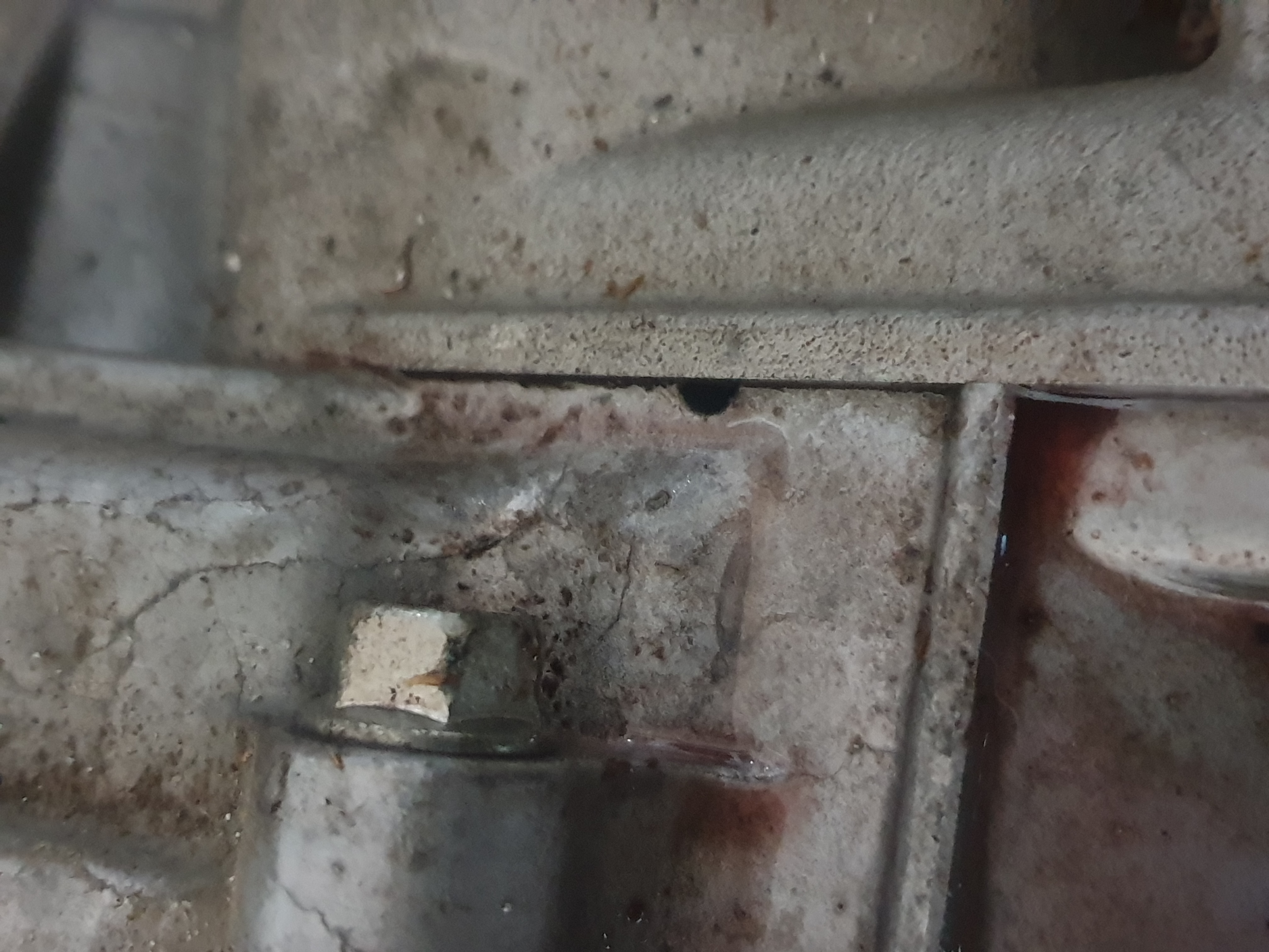

Can you guys that already installed Outlander rear motor help me with something?
There is a problem i noticed with motor and gearbox leaking oil. There is a small breech in motor-gearbox seal in position downward when motor is in its OEM position. It seems this was done intentionaly. It could be this port is a simple breather. I could be tumbling the motor in incorrect orientation when handling and some oil went into space between motor and gearbox. Is anyone out there can confirm for me that using the motor in original position doesnt cause an oil leak?
Original motor orientation:
Some photos of the breather???
Posts: 2963
Has thanked: 330 times
Been thanked: 848 times
Re: Mitsubishi Outlander rear axle
Correct, this is gearbox venting.
Posts: 3796
Been thanked: 413 times
tom91 wrote: Sat Sep 30, 2023 8:54 pm Correct, this is gearbox venting.
Yes but that thing is facing downwards. I would imagine venting would be oriented to the side or upwards.
Does anyone finds any oil leaking out from the gearbox in the orientation that is in OEM? Or is this just because i had the motor upside down for a long time :)?
Posts: 2963
It is up and down, on the gearbox inner its up and the outside case is down. so moving the motor about can cause oil get in the cavity and then move it again and it can then leak out.
Posts: 3796
tom91 wrote: Sat Sep 30, 2023 10:22 pm It is up and down, on the gearbox inner its up and the outside case is down. so moving the motor about can cause oil get in the cavity and then move it again and it can then leak out.
So it is not a true leak? I wil try to get the motor in position tomorrow and see how i will install it. I will report more...
Post by Turbopete »
I have the motor mounted in the OEM position ( all be it running reversed ) and have had no leaks in just shy of 2000 miles.

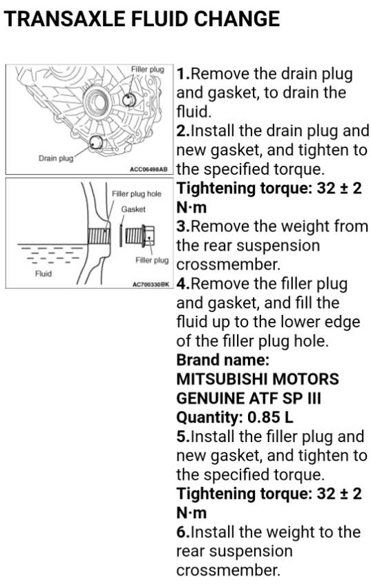

Hi folks!
Do you know/have information which gearbox oil can be used for lubrication in Outlander RWD gearbox?
I recorded this information, but i no longer know the source:
Outlander PHEV transmission oil replacement:
60.000KM or when is changing color(red to black)/smell(burned)
Front F1EKA - 3,46L
Rear F1E1A - 0.85L
Use ATF SP III MZ312096K 1L or MZ312096 20L.
Post by bigmotherwhale »
You can probably use any fully synthetic ATF SP3 fluid you can find, I cant imagine it would cause any issues, especially if you change it regularly.
Post by aot93 »
I used MANNOL MN8209 ATF SP-III and have had no issues.
