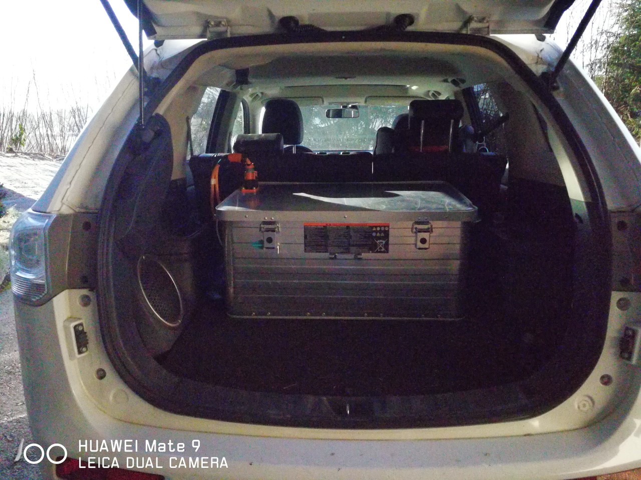

Hi X30!
I have done it with an extra pack on my Outlander and iam superhappy.now i go 120 km on pure EV(same voltage,84 ah cells Comes from Nissan 30Kwh)
So i can say ist very easy Installation only connect to rear Inverter put a fuse,contactor,and one Diode (for charging with OEM charger) thats all you Need!
There is no Need for PCb or hacking the CAN !!!!
Remember:
The simplest Things are the best.
Coming back with schematics and photos of mine.
Cheers
Thomas

The extention Battery is connected with a contactor wich will active after 2sec. after Ignitation.
For charging:
If i switch off IGN. also contactor of extention Batt. is off.
I Bridge the contactor with a strong Diode so charging current goes over Diode !!!!

The two Batterys coexist by voltage!Even if the voltage is not the same +/- 5 Volts you can connect via contactor.No current jumps no sparks!
In my case the main battery deliver 1/3 and extention battery 2/3 driving current and this effect ofcourse the SOC meter!
In Fakt you will benefit the mileage of one cycle ,also you extened battery life.
Remember:
Cheers
Thomas
